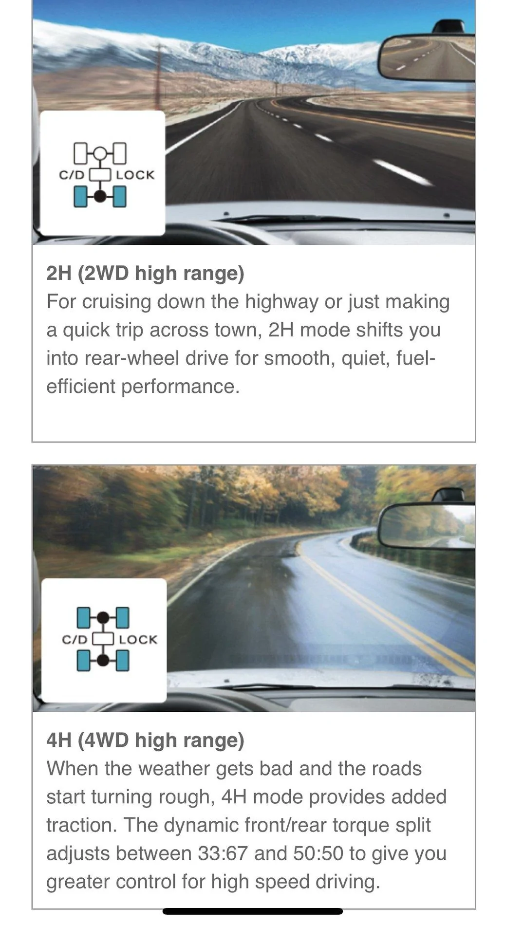

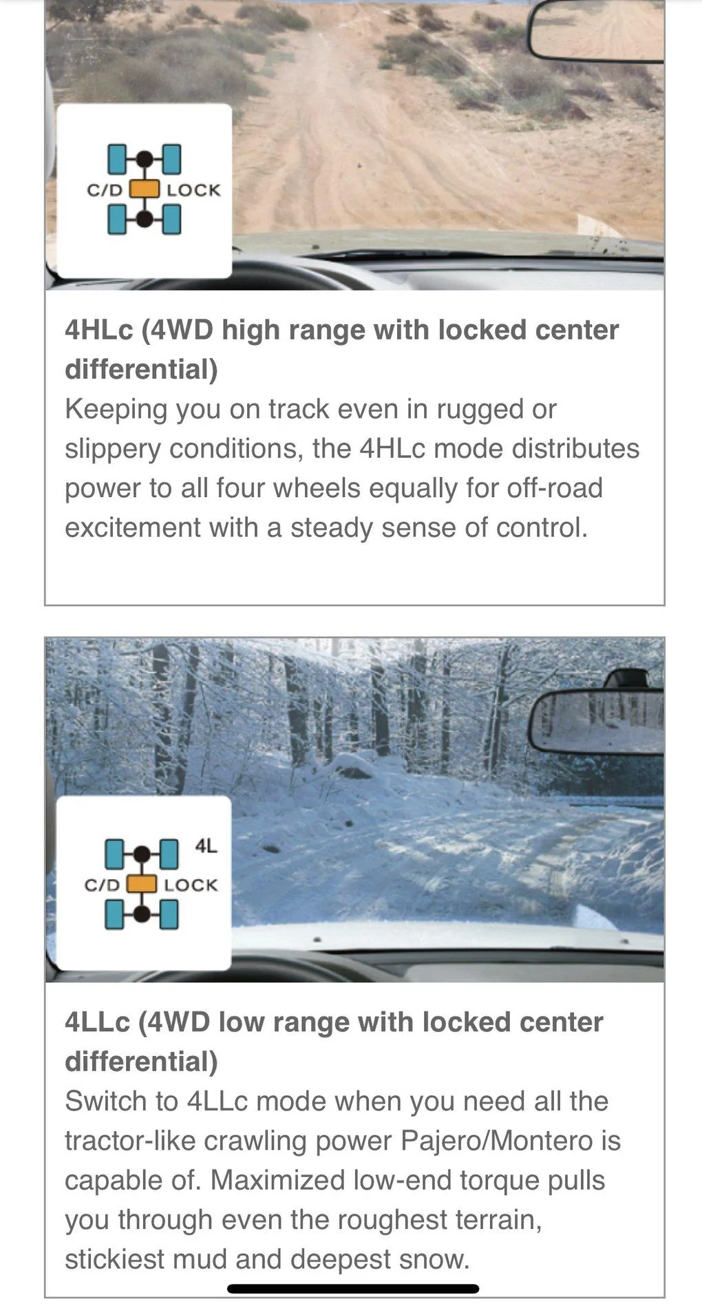

From the BlueOvalForum user /r/My93SHO. It seems as though our very own /u/Escape_Artist actually deciphered this!
Now, I was not honestly familiar with what a transfer case lock was. So I did some reading... sounds like the basic gist of it is that a jeep/most other vehicles the transfer case is locked by default. Meaning just like how with diff locker the left and right tire move at the same speed... a locked transfer case means the front axle/IFS(que the damn chairs lol) and the rear axle have to move at the exact same speed. Hence the jumpiness that I'm sure you've felt if you've ever tried to drive in 4x4 on a high-traction surface. By unlocking the transfer case, this allows the axles to receive different amounts of power, so you could be in 4x4 even on paved surfaces.
Sounds pretty fucking cool to me!! Now this is all speculation we can't see it well enough to be sure that's what it is... but odds are pretty decent IMO.
Edit: Iā€™d assume itā€™s similar to how Mitsubishiā€™s system works;
Ford Bronco Locking Transfer Case 60E9D253-062A-4E31-AB51-914029FA63BE
Ford Bronco Locking Transfer Case DF1ABA4F-B3F5-445B-949A-5A652F44F9B2

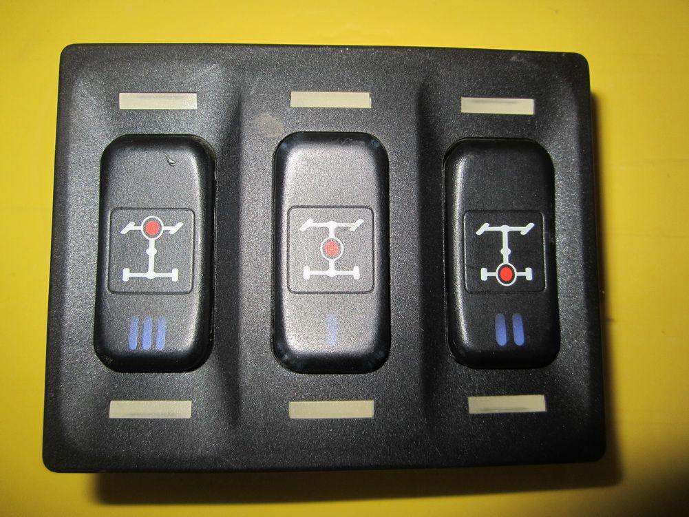

Since their are 3 pictures of what appears to be locking diffs it would make sense that one is for the transfer case
Ford Bronco Locking Transfer Case c1235903be31b2fd7eb48a50e2ac3429
Also that's my picture from the interior leak thread lol. They must have stolen it for the blueoval forum

One key thing is on the Mitsubishi system, when not locked, you get a viscous limited slip center differential (sort of like what Subarus have all the time). I'll be curious what the center diff is on the Bronco when NOT locked. On the Raptor in 4A, it's sort of a clutch type LSD, hopefully it's not just open when not locked on the Bronco.

To me, button on the right of the rear lock looks like ā€œturn assistā€. Lexus has the feature in the LX570. Basically a ā€œcutting brakeā€ to allow tight turns offroad. That looks like a curved arrow on the image.

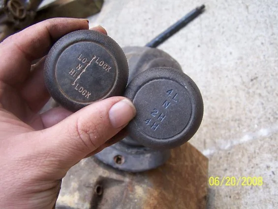

Kinda the same as it was in 78 (left knob, and no diff locks back then of course).
They didn't use locking front hubs either, they were permanently "locked" in.........
Ford Bronco Locking Transfer Case 00125

For what it's worth, Jeep's NV242 (Selec-Trac) works more or less like Mitsubishi's system.
2-hi (rear wheel drive only)
4-part time (4 wheel drive, locked center differential)
4-all time (4 wheel drive, open center differential)
4-low part time (4 wheel drive, low-range, locked center differential)
@Jalisurr I didn't know Super Select had a viscous center in 4H, that's good to know.
