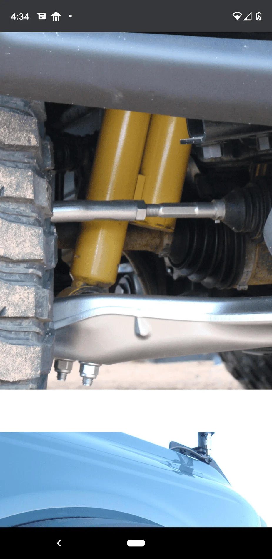

I recently saw pics of the overland concept. I think the engineers at ford overlooked how the shock is mounted to the lower control arm. The lower shock eye mounts to the control arm via a bolt with machined flat ends. The bolts protrude through the lower control arm!! I can see the nuts getting messed up after a couple of wheeling trips...
Normally, the lower control arm has tabs welded/formed on the top face, I have not seen any ifs that is "designed to be an off-road vehicle", have this configuration.
Thoughts ?

I know they are testers, but I think the main components (suspension, engine) are finalized. I don't seem them redesigning the lower control arms (think of the entire supply chain building parts now). I saw some exposed shots a while ago and I saw the same two nuts of the lower shock mount protruding from the bottom of the LCA.
I feel like they could have designed the lca like every other IFS and have tabs on the top of the arm for the shock bolt to go through.
The went to a forged aluminum design to save weight for what?

my thoughts are these are pre production rigs stricken with supplier delay issues of several types. these bolts, the lack of proper springs etc. are indication of the issues.
but I do agree those bolts ain’t right!

This was a prototype Sasquatch I believe. Couldn't imagine that would be left for production.

I was just discussing this with a buddy and we think the bolts can be flipped. But now that I think of it, might want to NOT do that. Think of steering rack bolts, you put them in from the top so you can at least still steer if the nuts fall off. This would be the same situation. Wouldn't want the bolts to fall off and have your shock hit your CV or tie rod lol..

Can confirm, the badlands non squatch at super celebration west had the same bolts in the LCA.

I'm sure it's engineered great. As someone who works on their own vehicle and has replaced/upgraded quite a bit of stuff, I see things I know will be a pain to work on after several years use. At some point those bolts will need cut off because of damage if you ever want to remove them. For most, it's a non issue.

I am a mech engineer myself and this design seems overlooked. They chose a forged design, so that is why the shock mount is the way it is (a traditional shock tab is impossible into to forge into this design since it is in a different orientation).
For those of us who will wheel these broncos, this will be a problem. My LCAs on my tacoma are all scratched up . Not because of negligence, but because that is what happens during adventures.
