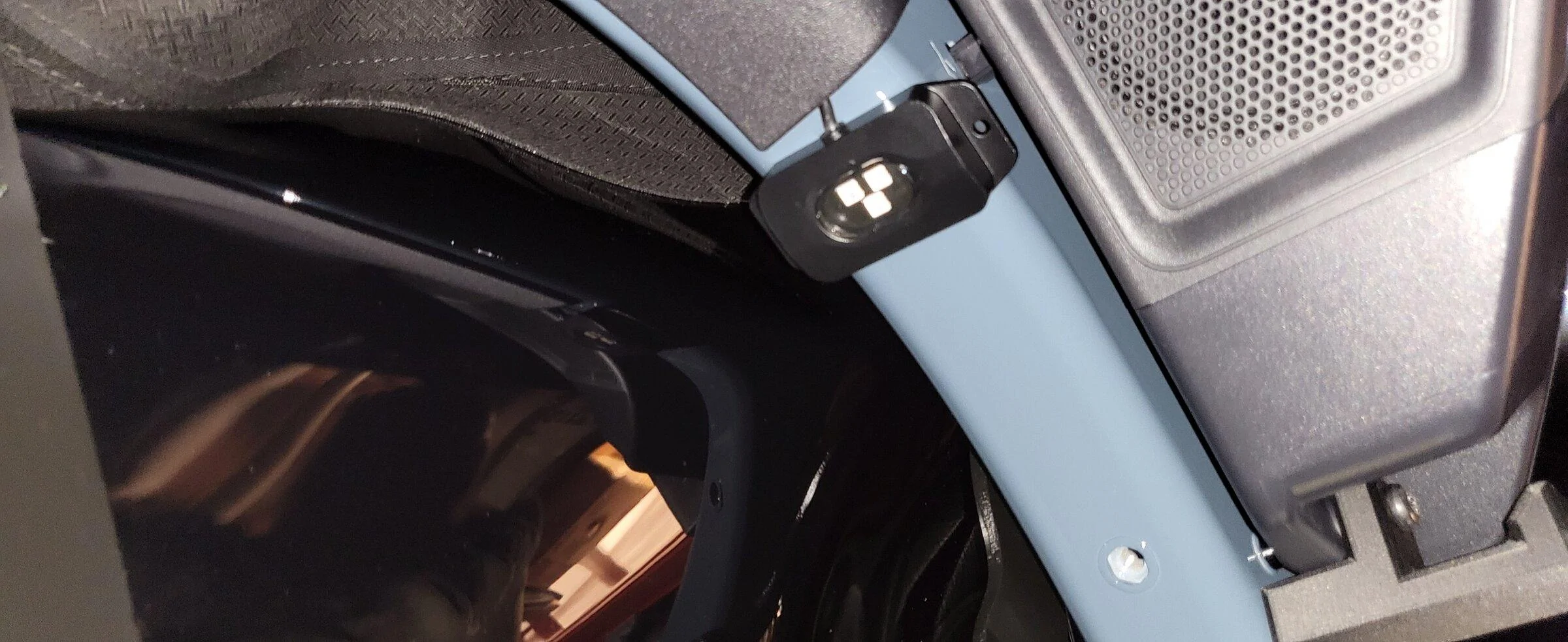

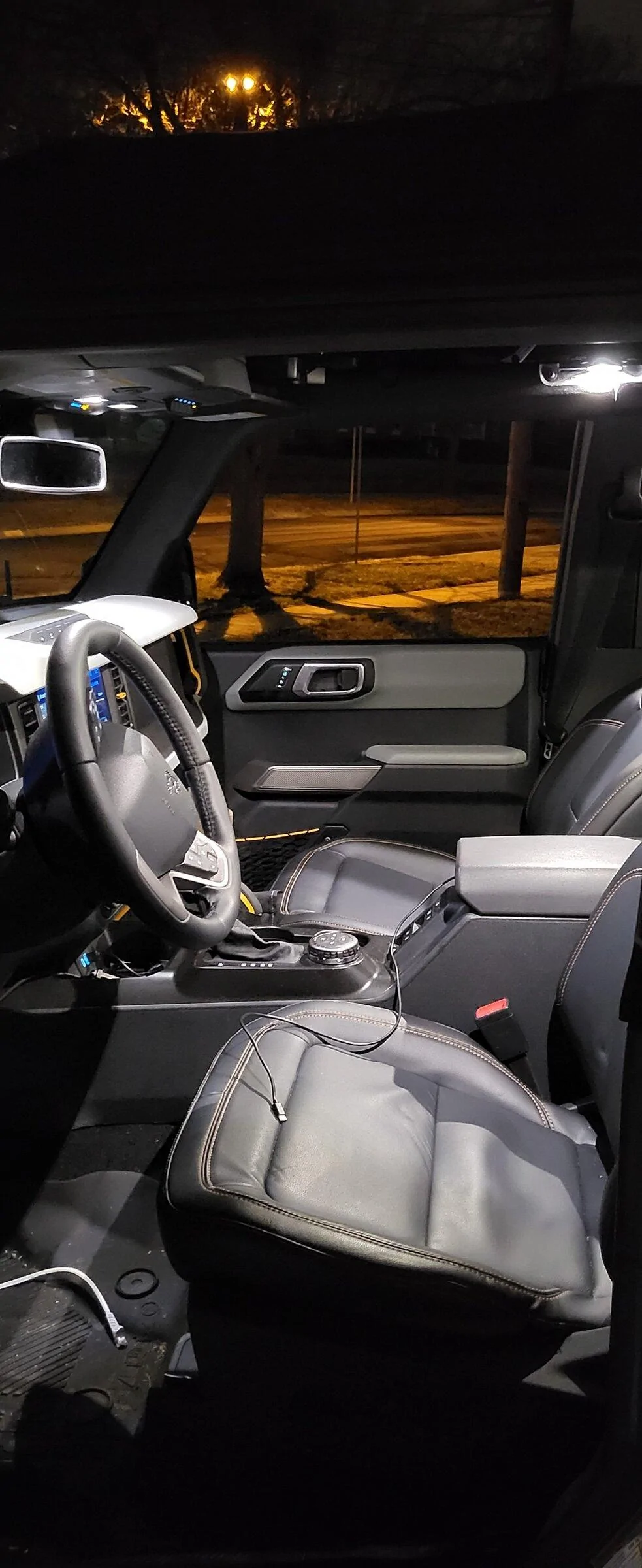

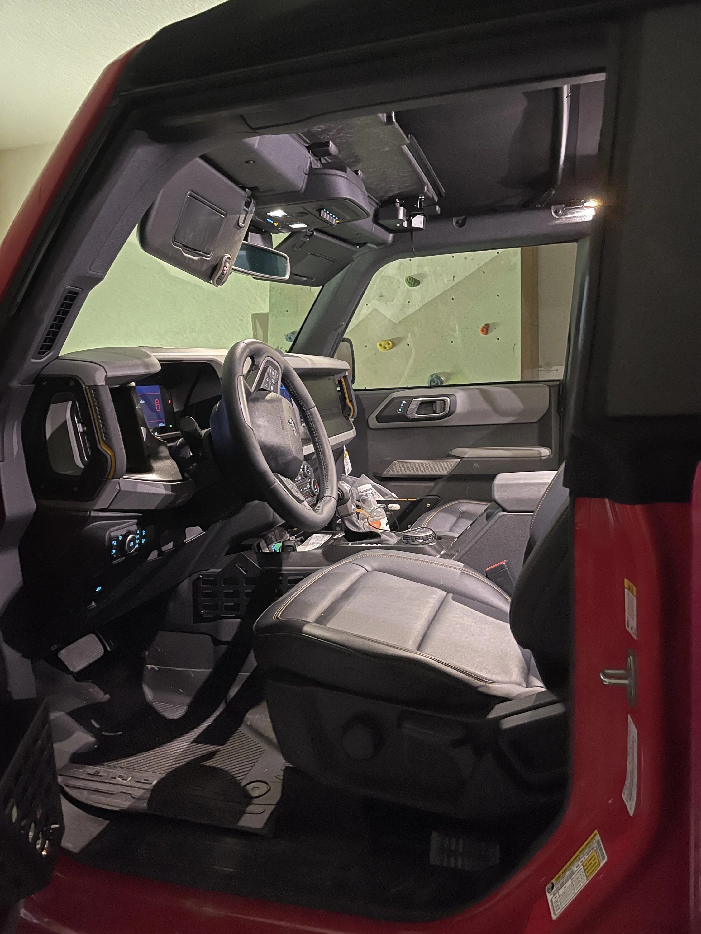

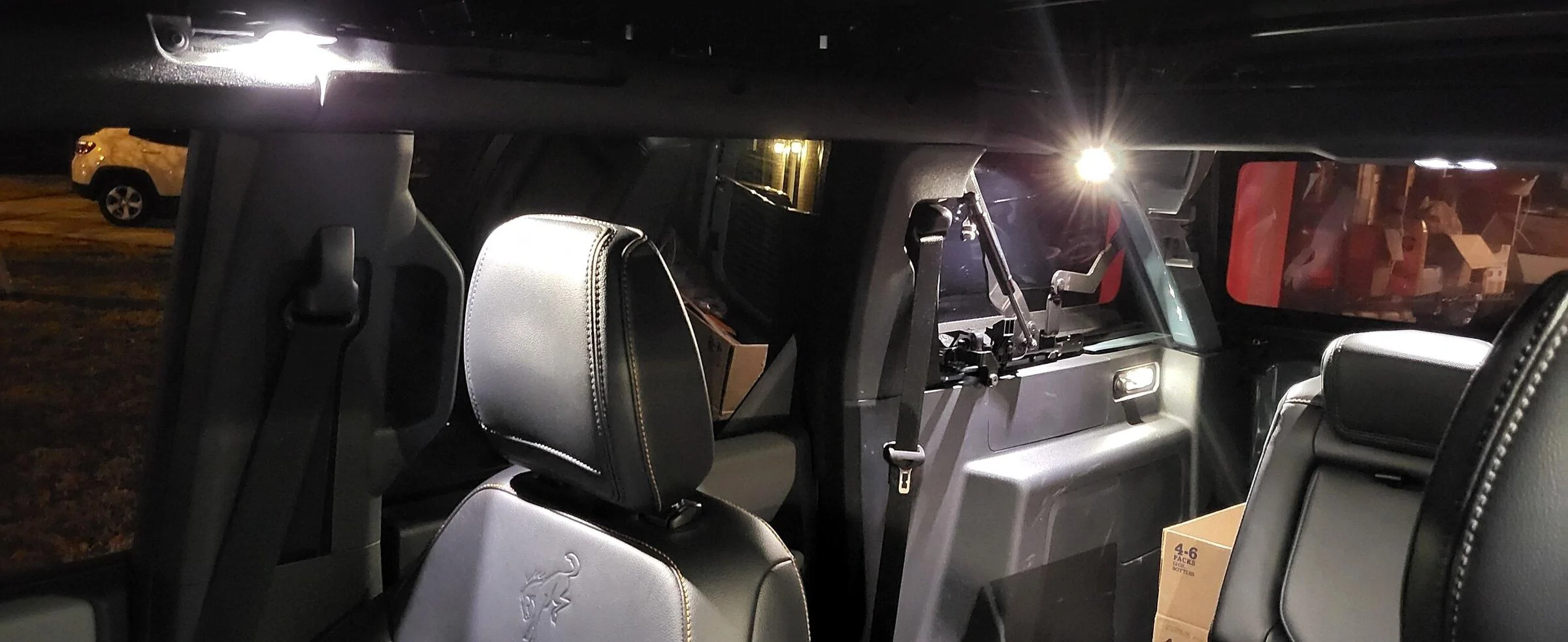

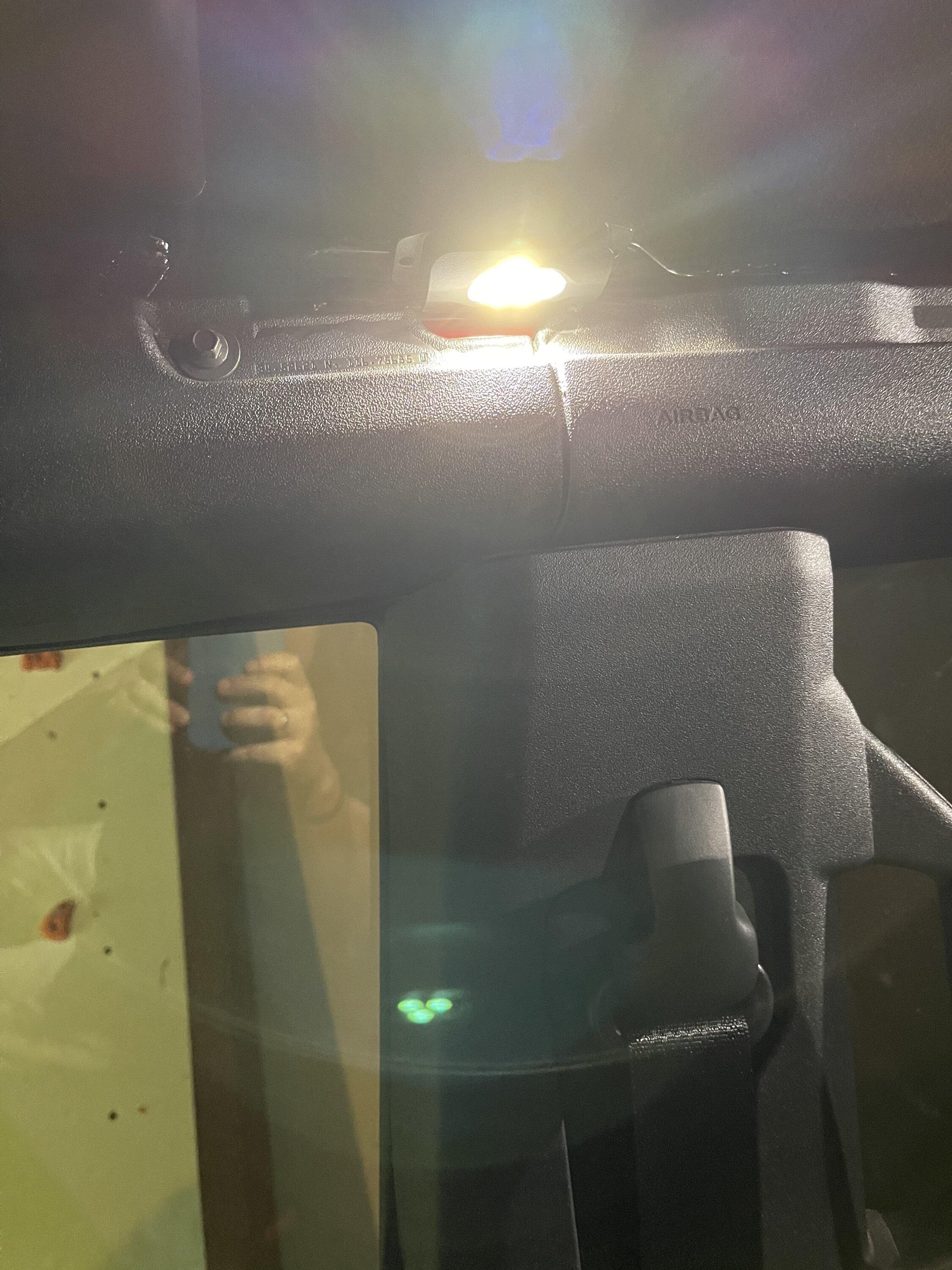

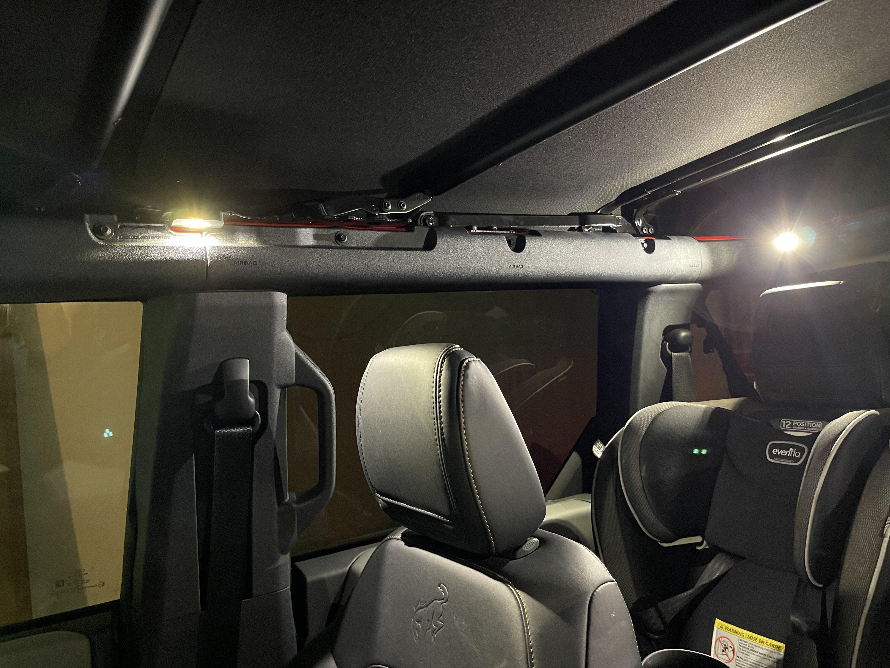

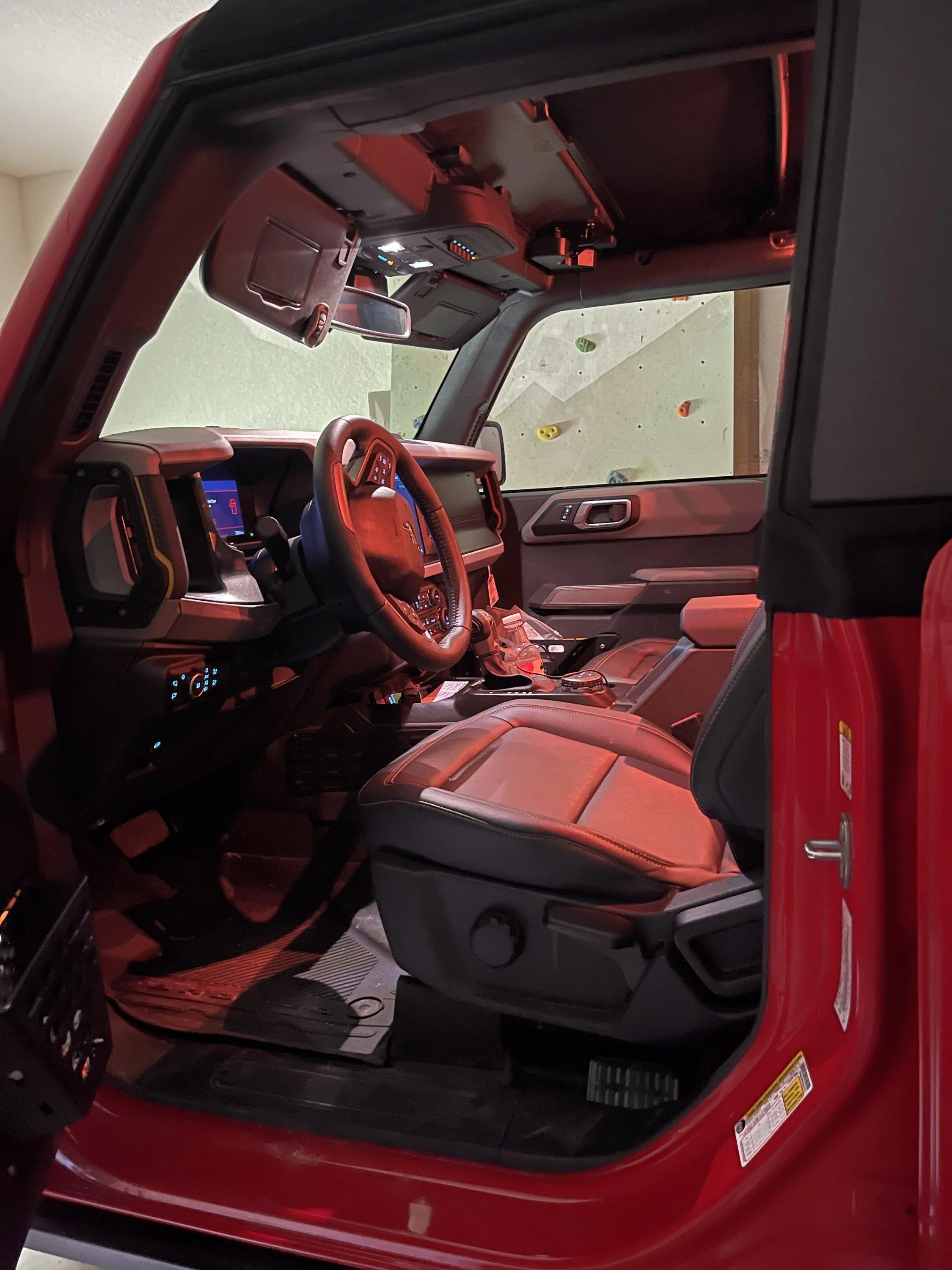

Having been unhappy with the interior lighting of the Bronco, I upgrade the interior lighting using Govee LED under lighting kit. https://www.amazon.com/gp/product/B0969PDDP5/ref=ppx_yo_dt_b_asin_title_o04_s00?ie=UTF8&psc=1 and wired it to Aux 6 Switch. The default setting is white but it can also be set to any color or sync with music( I will never use that feature, but is there for those who want a disco Bronco). I couldn't be happier with the results, its like daytime in the car when I turn them on. I can also dim the lights using the Govee app but for the most part I never have the need to open the app. The default white full on works for my purposes. Hard to beat for $50 in parts and a little sweat equity.

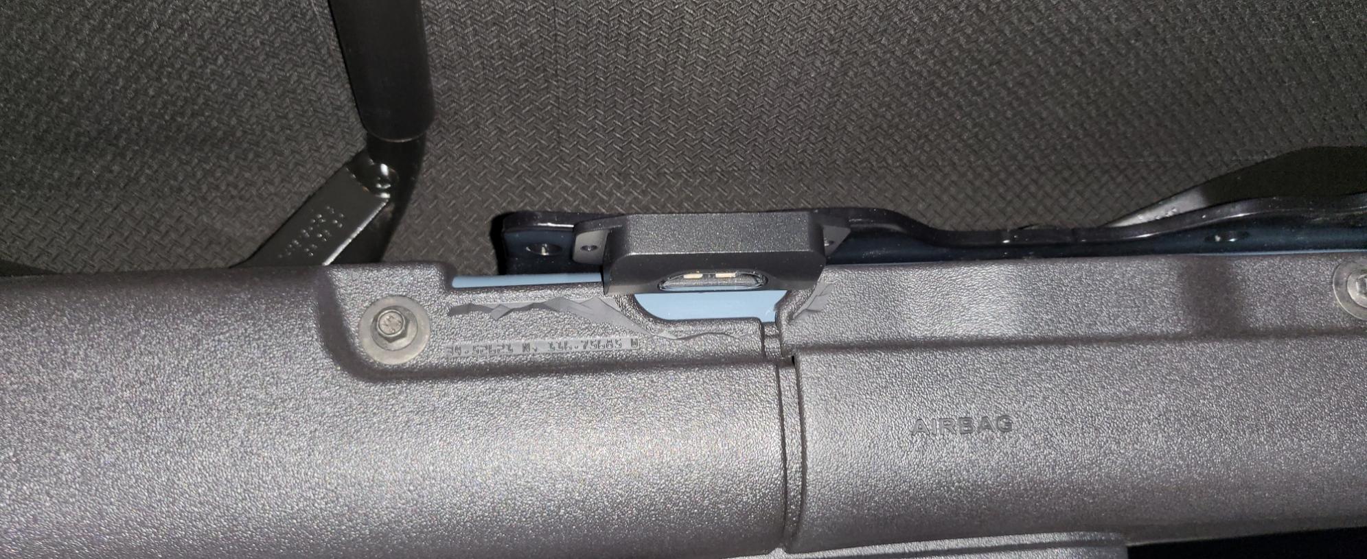

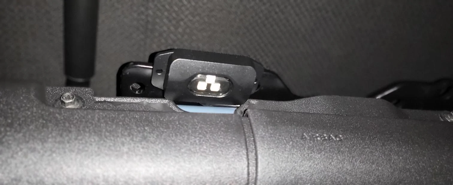

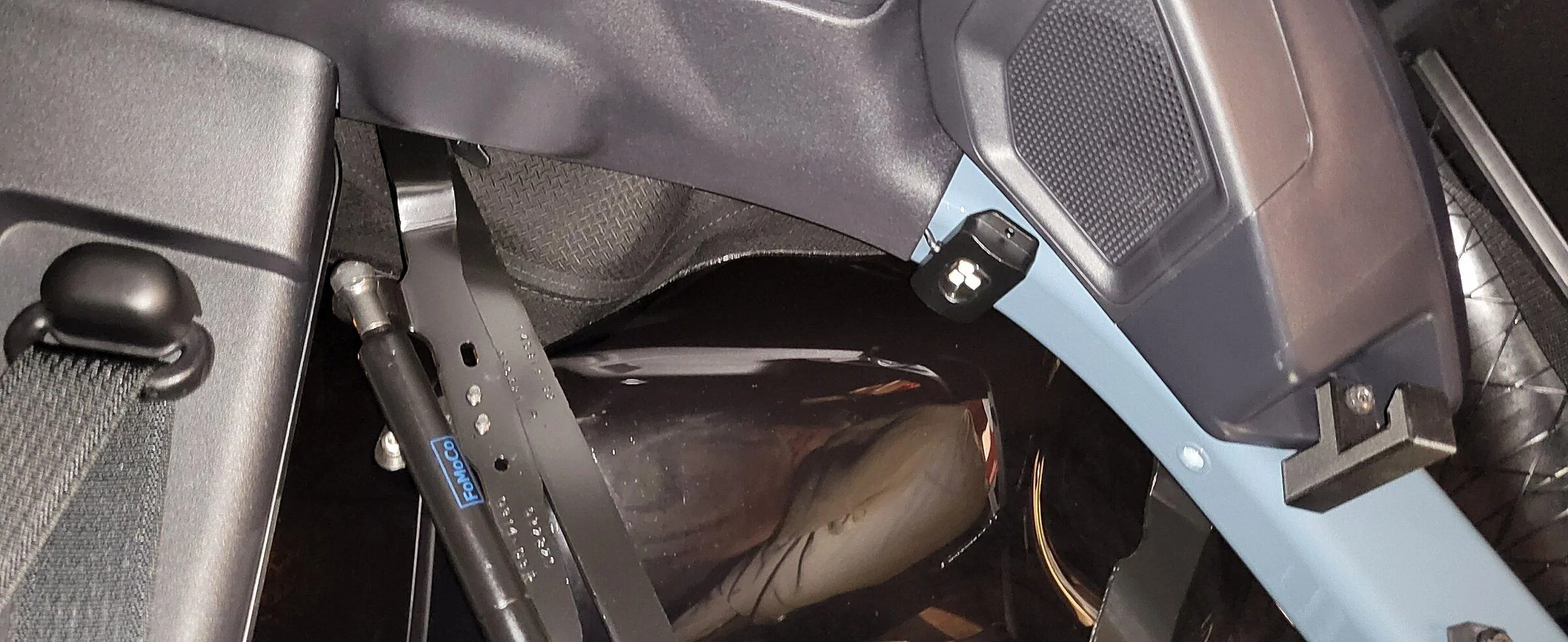

The whole process took be about an hour an half to wire. I used the Aux 6 switch and wired it to the rear white/orange aux wire in the passenger side rear. I had to remove both covers of the air roof air bags to fish the wire along the roll cage (yes, made sure to secure the wire to not interfere with the opening of the air bags) to the rear cover of the roll cage. The covers are the only trim pieces secured with bolts. The rest of the top trim and side trims are all held in place with body clips. I pulled down the rear roll bar trim piece to store the LED driver/Control and fished a wire down the passenger side pillar to tie into the Orange/white aux wire. I stuck the lights on above the airbags on the soft top front brackets using 60lb double sided tape and the rear lights on the rear roll bar just behind the passenger seats. The install is clean and you hardly notice the lights until they are on.

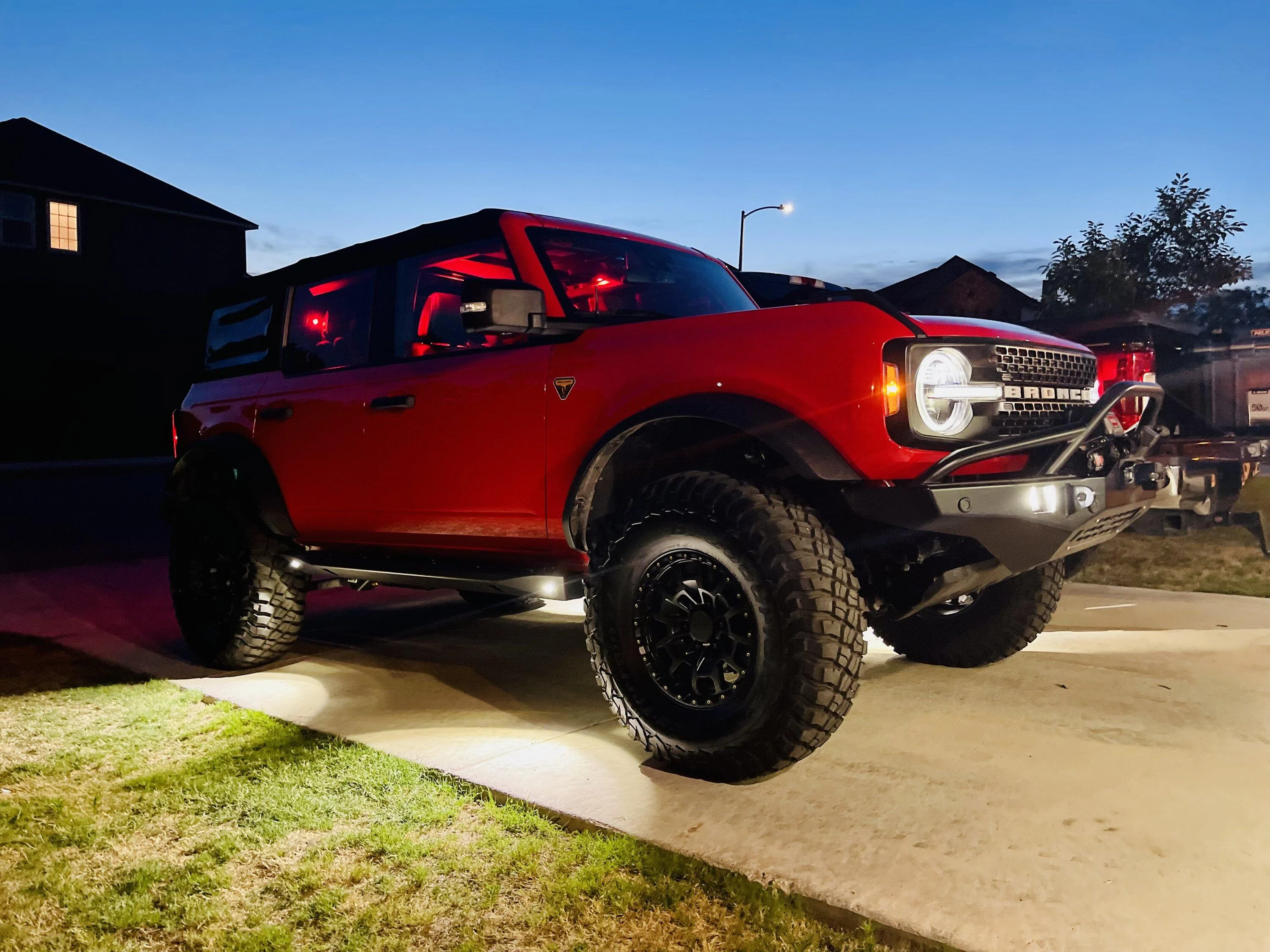

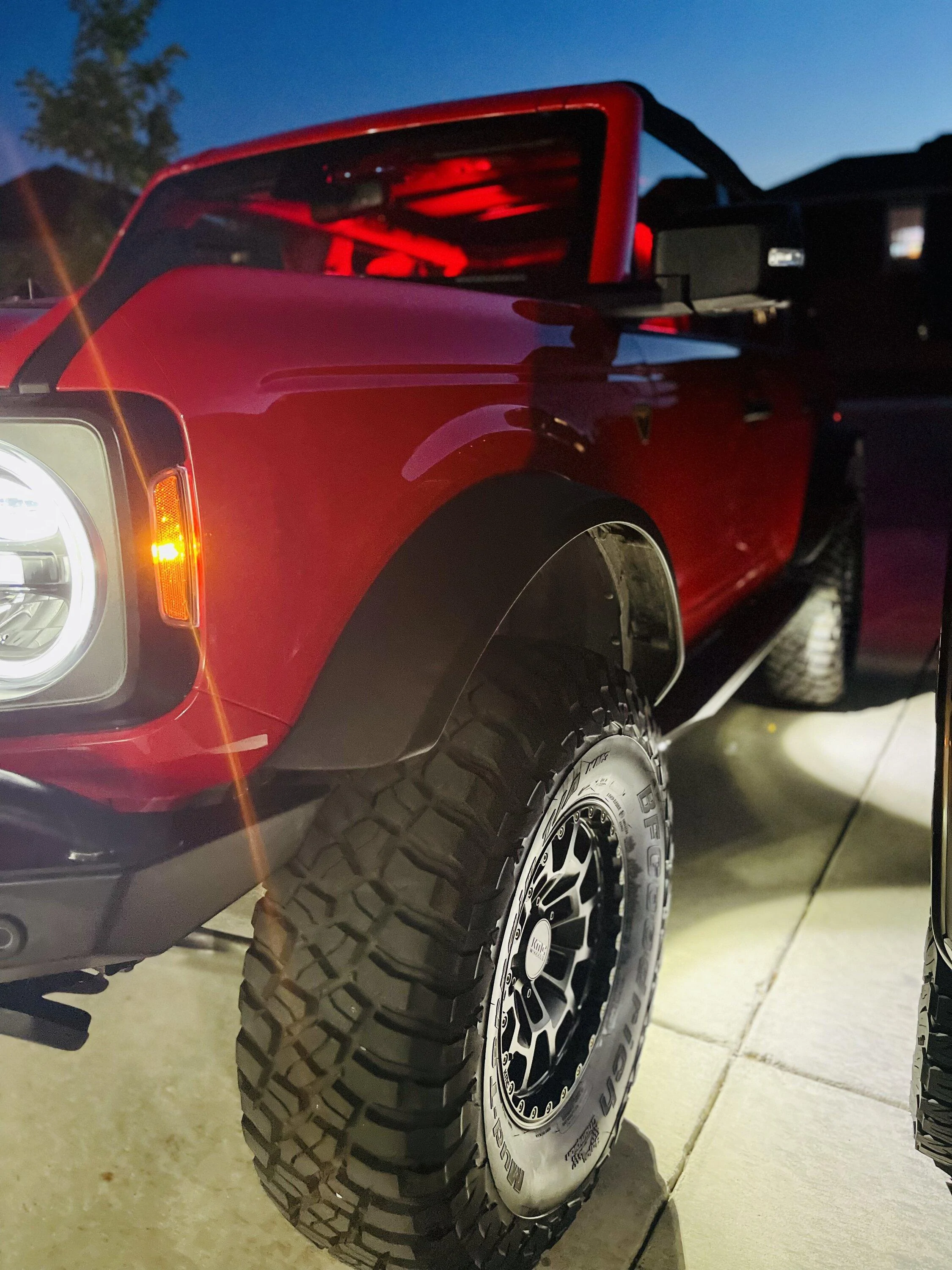

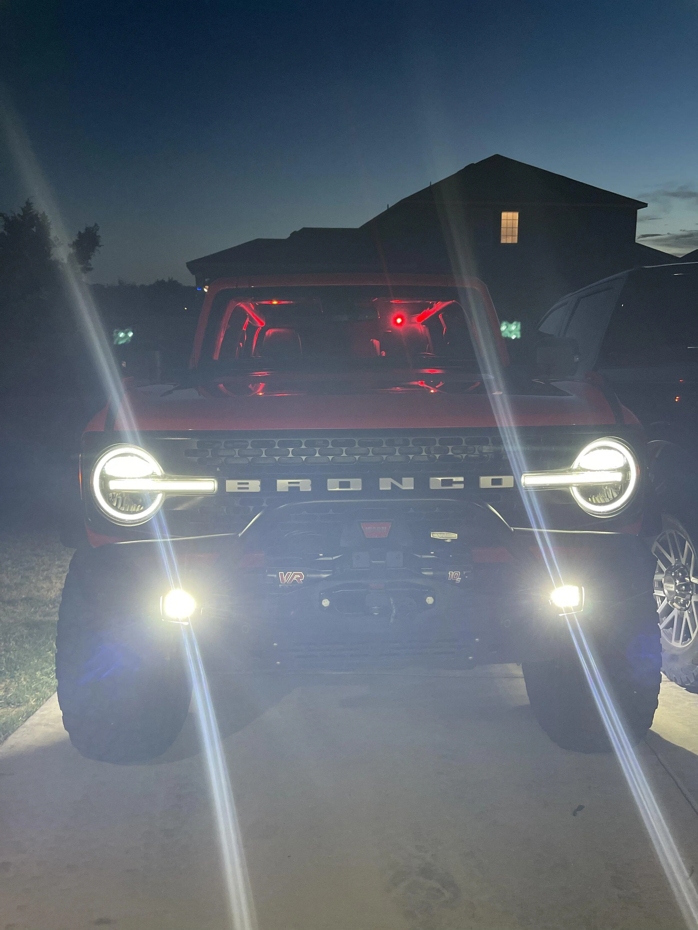

Had JCR sliders with lights installed with my Govee interior lighting

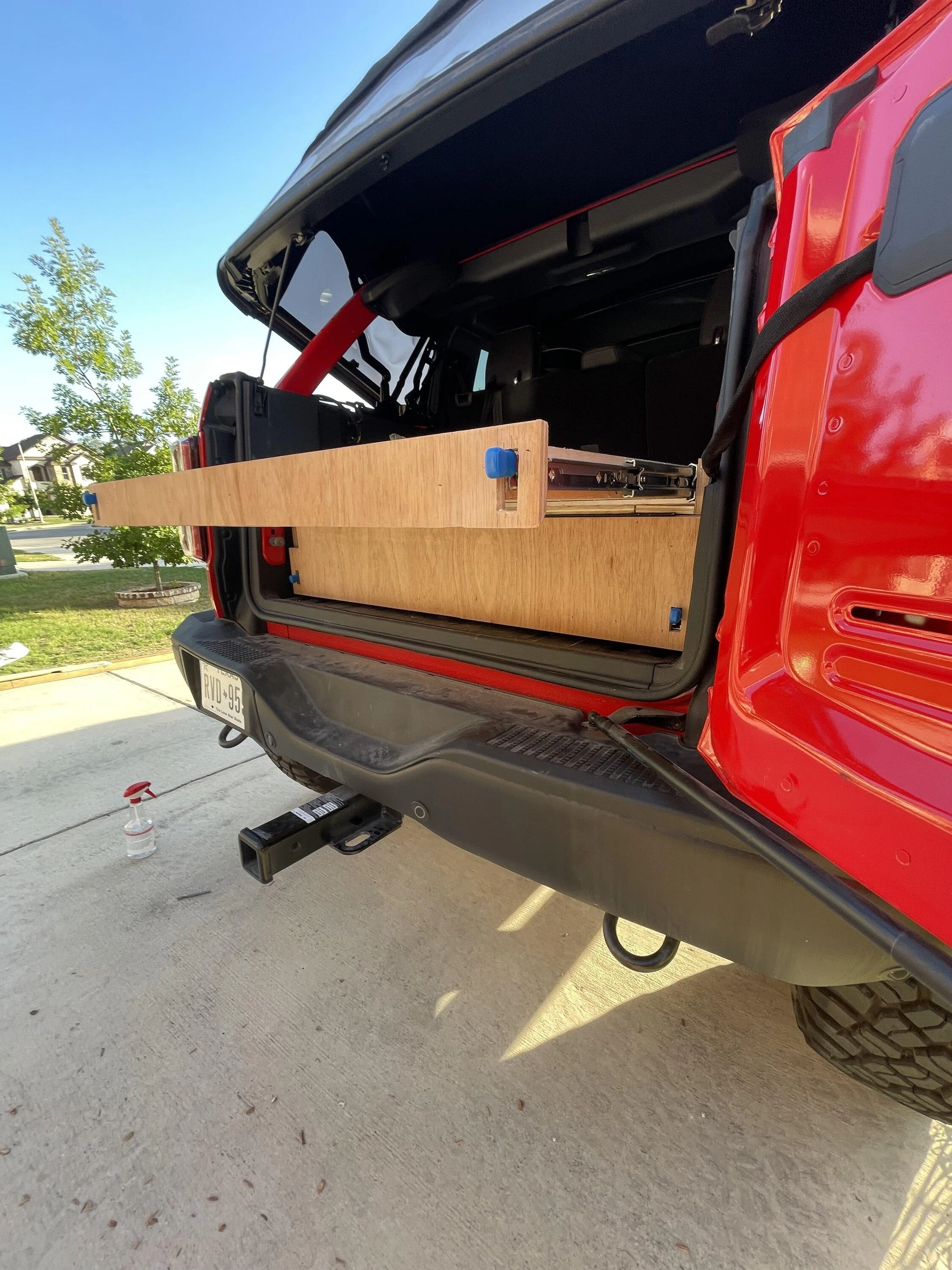

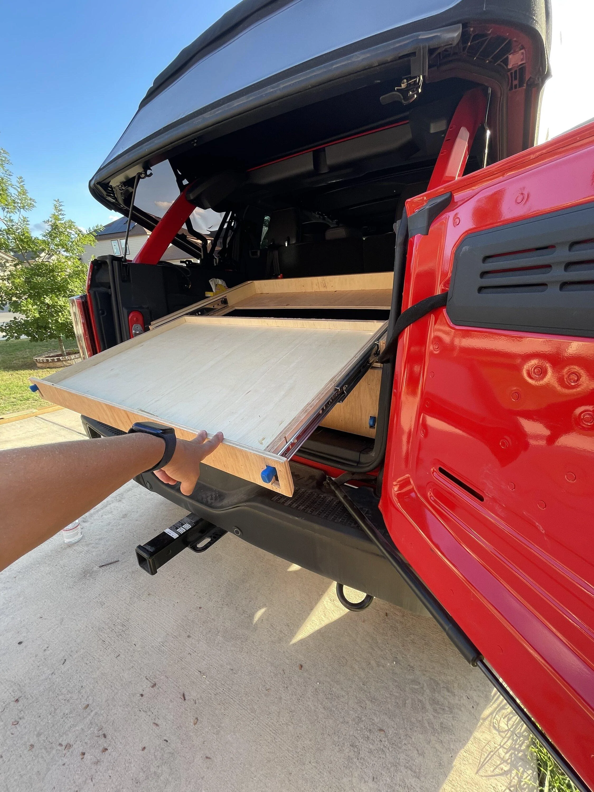

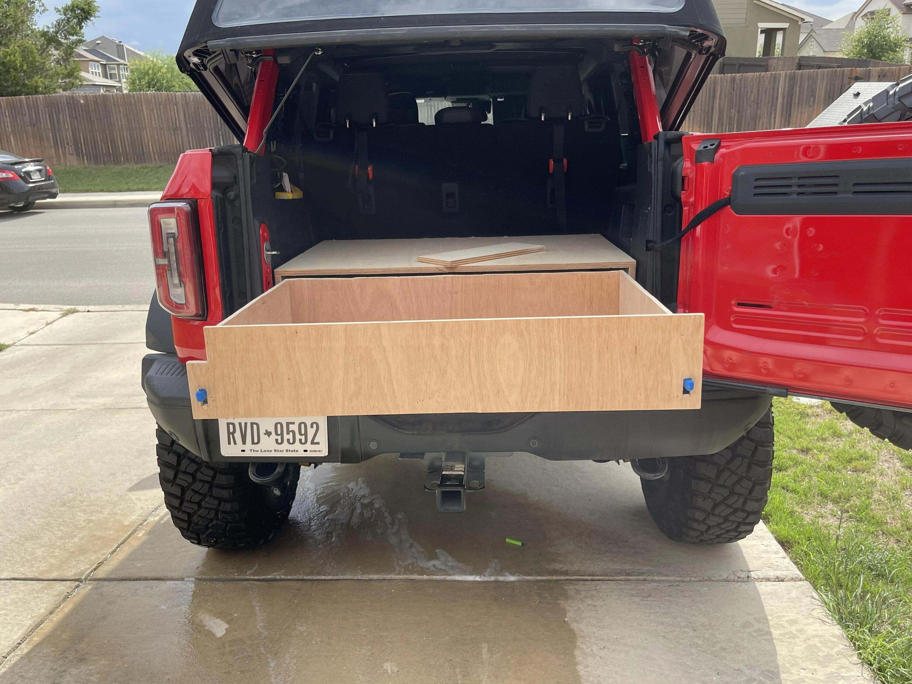

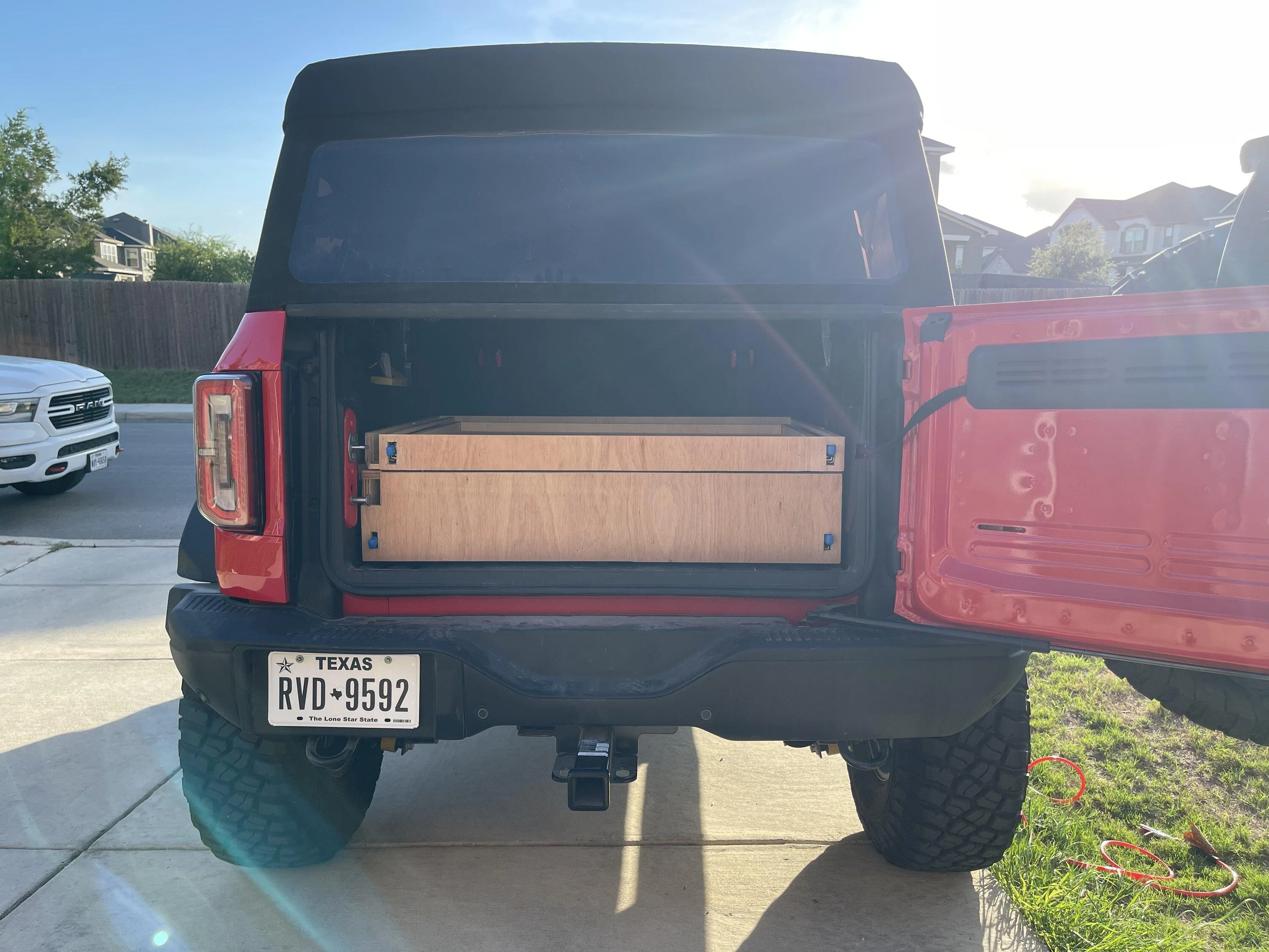

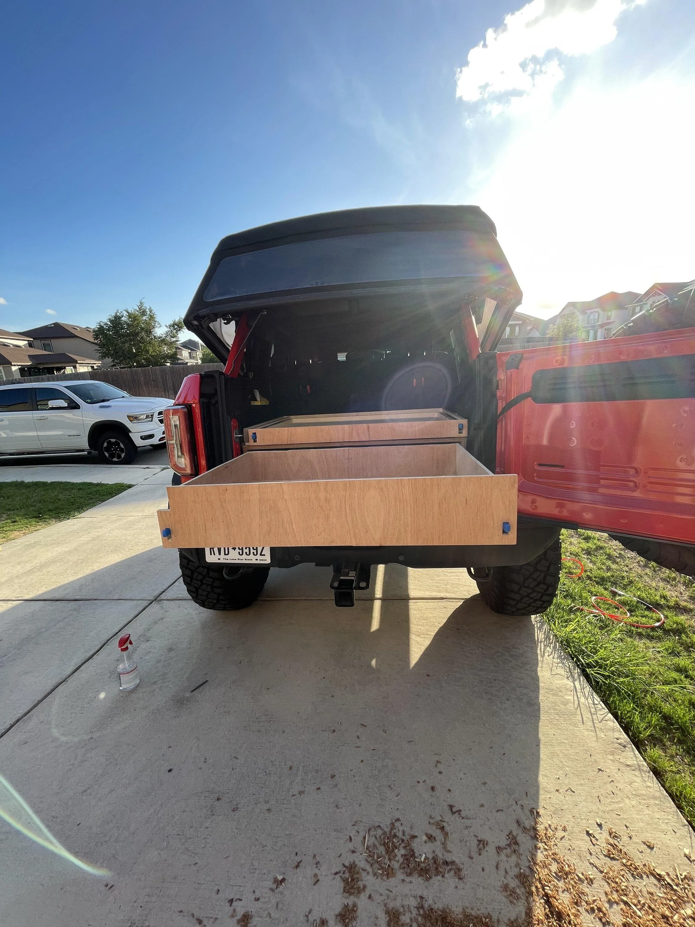

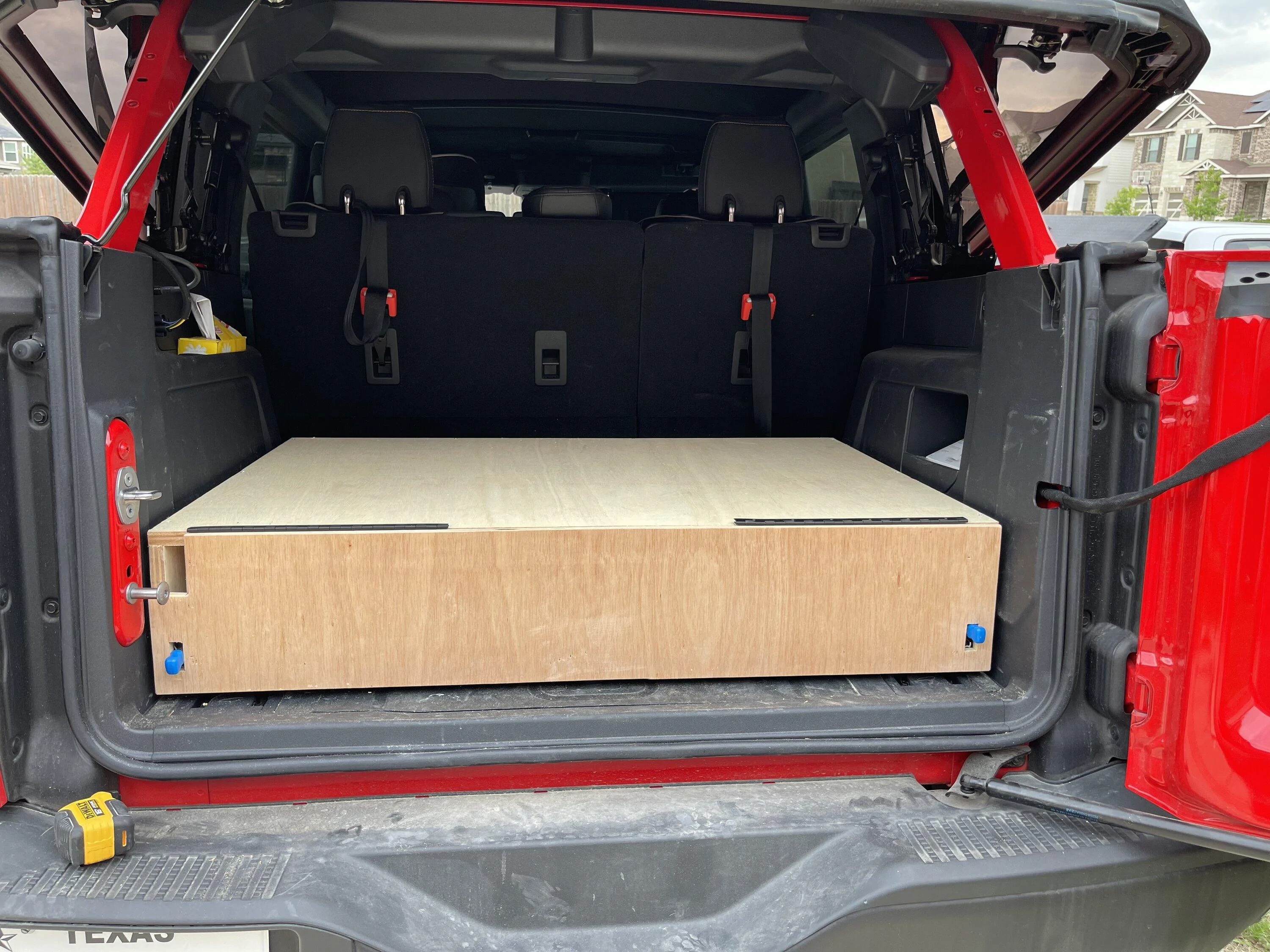

Got off work early today and spent a few hours building the first part of my rear cargo drawer. Hoping to finish the mounting, and pull out/flip down refrigerator/cooler slide tomorrow.
