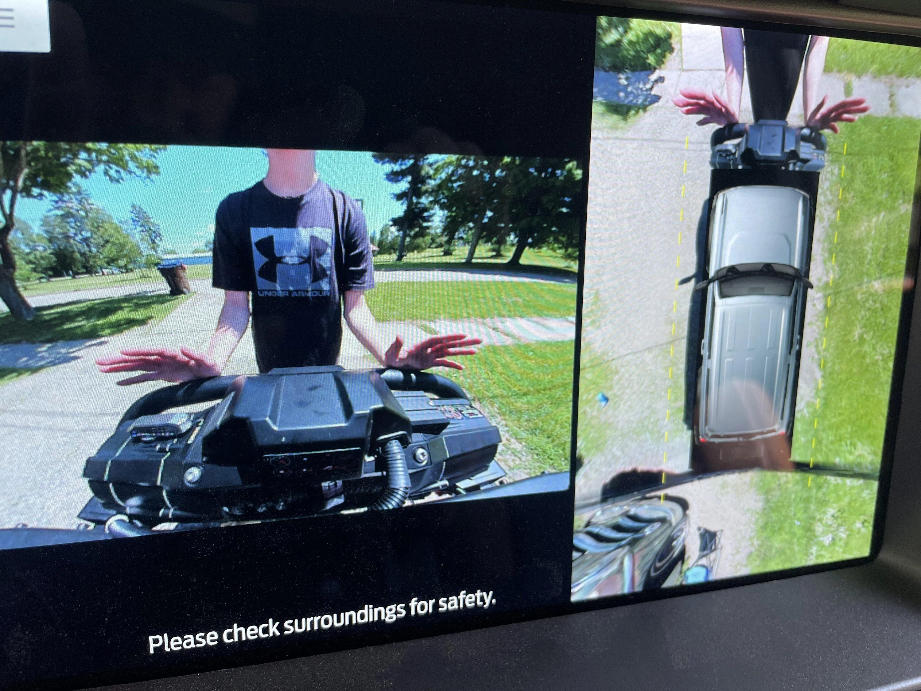

If you don’t relocate the camera you see the back of the winch period. Unless you relocate the control pack. But still not much of a view. I moved my camera to the top of my grill and drilled holes to move my parking sensors on the ford warm setup. Not perfect but cost nothing and I can use the camera for seeing over hills which is the most I’ve used the front camera to see what I’m dropping into. Here’s my views after moving the camera. Literally was just the back of the winch before.

I have a light bar on my front bumper, and it looks like it's 5 sizes too big in the 360 degree camera 🤣
Overall though, it doesn't impact me enough to lose sleep. The front camera is still useful, similar to what you posted with the winch.
