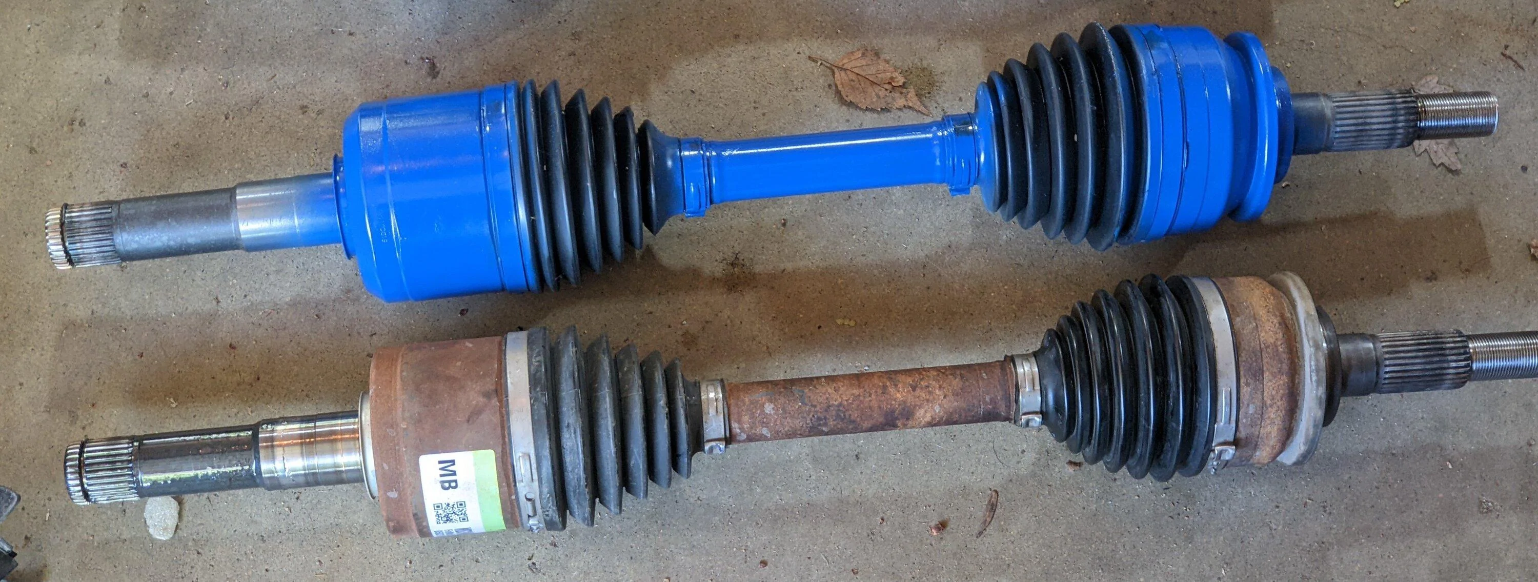

So your saying the m190 half shaft will work with the m210? That side note is one reason Iā€™m waiting as it adds significant costs. It also claims you need a new front drive shaft as well. Did your driveshaft bolt on as well?
The CVs are larger on the m210 axles. The drive shaft is likely upgraded in strength as well, but I didn't check when I had them both out.

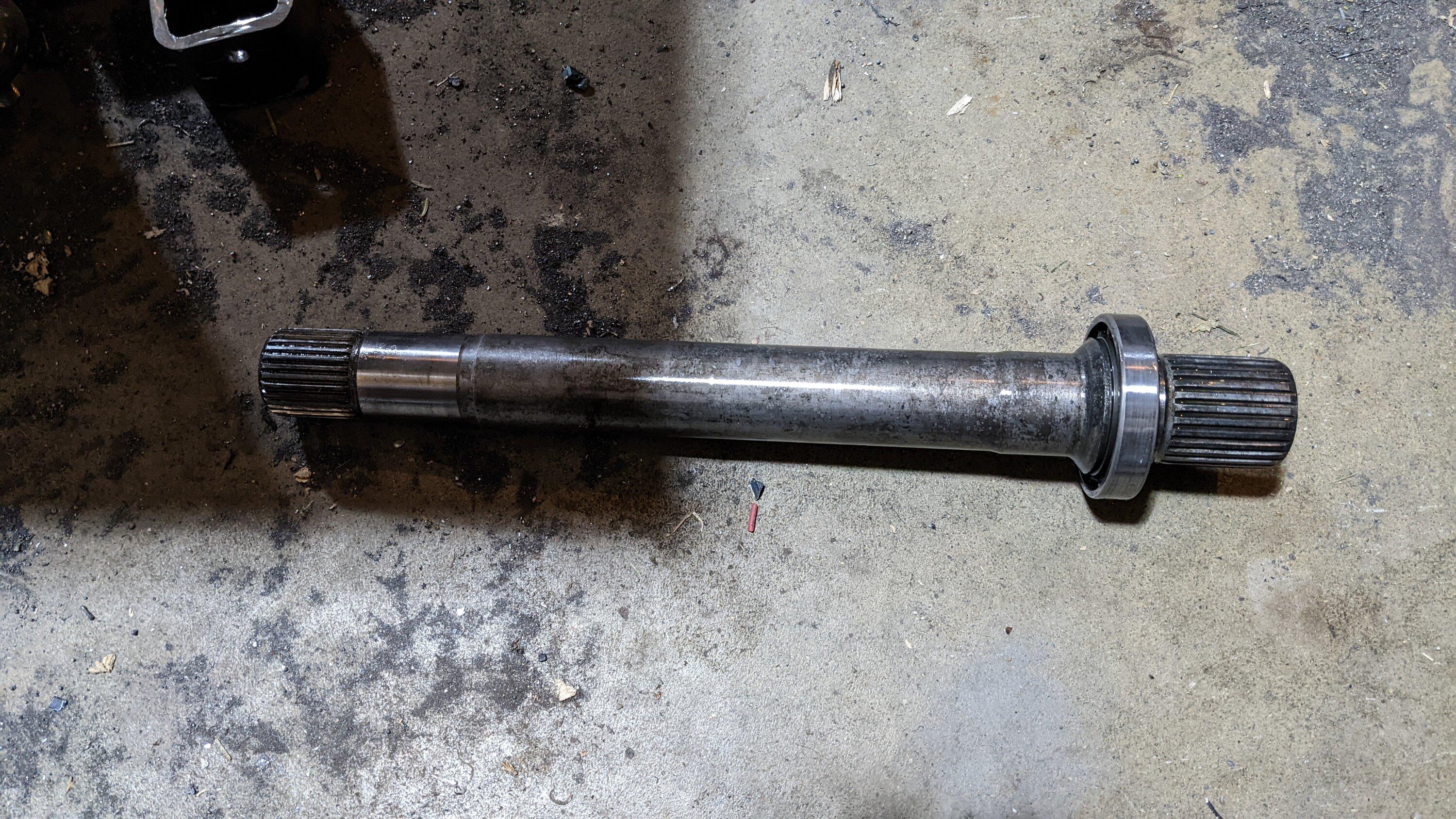

I tried a bunch of code from Dgorsett's AB data and couldn't make mine happy. I'm beginning to think it's something deeper than what Forscan sees.
As such, I gutted the inner axle shaft out of the FAD housing and will be bolting it to a stub stuck in the inner side of the RR crash bar pocket up inside the frame next to the exhaust tomorrow. That makes the ECU happy and will suffice until my dealer appointment on the 18th - unless Ford gets back to me with a solution first.
There's only a snap ring holding the bearing in the housing, and once removed I was able to tap it out just hitting it on the floor.

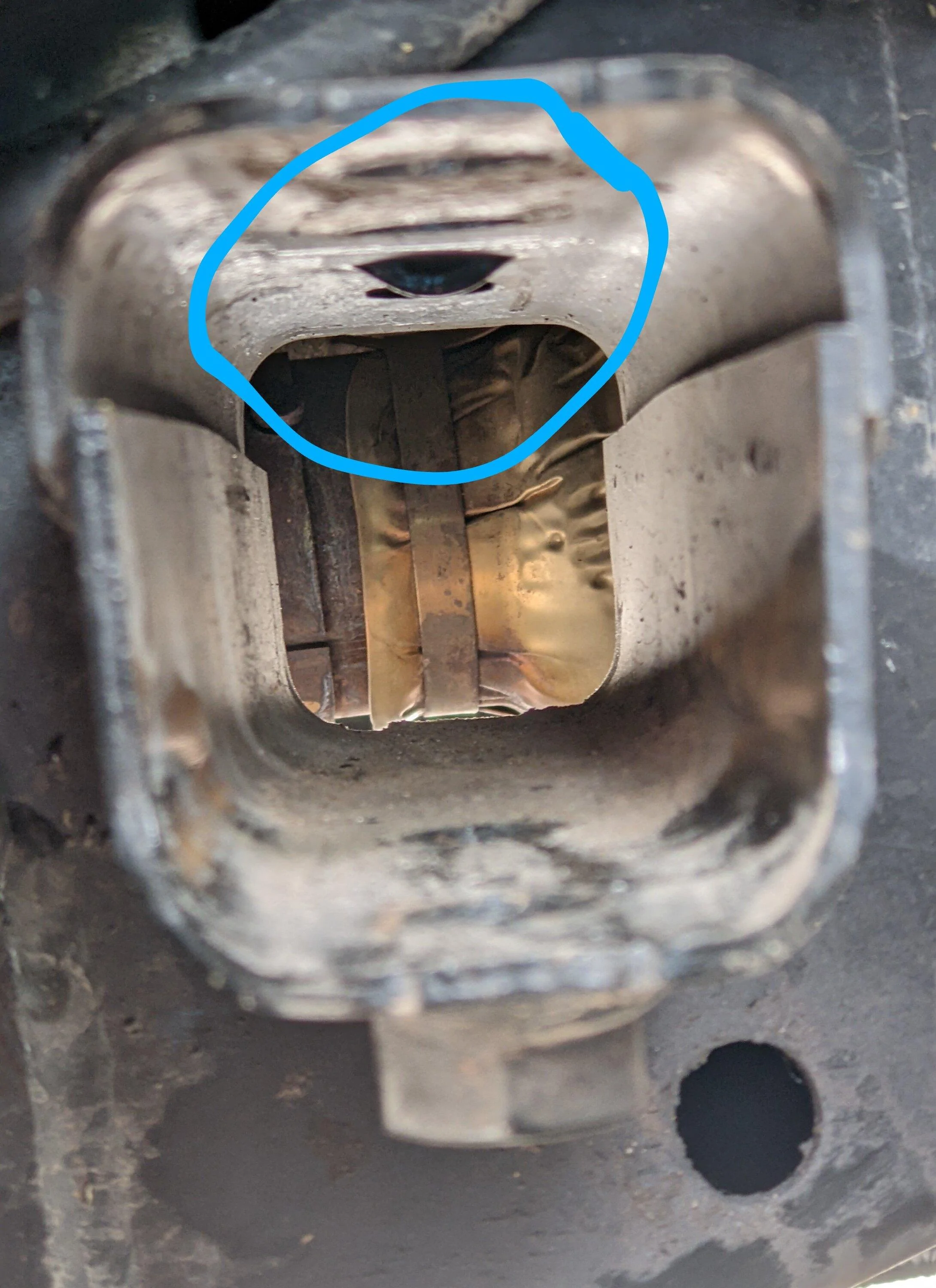

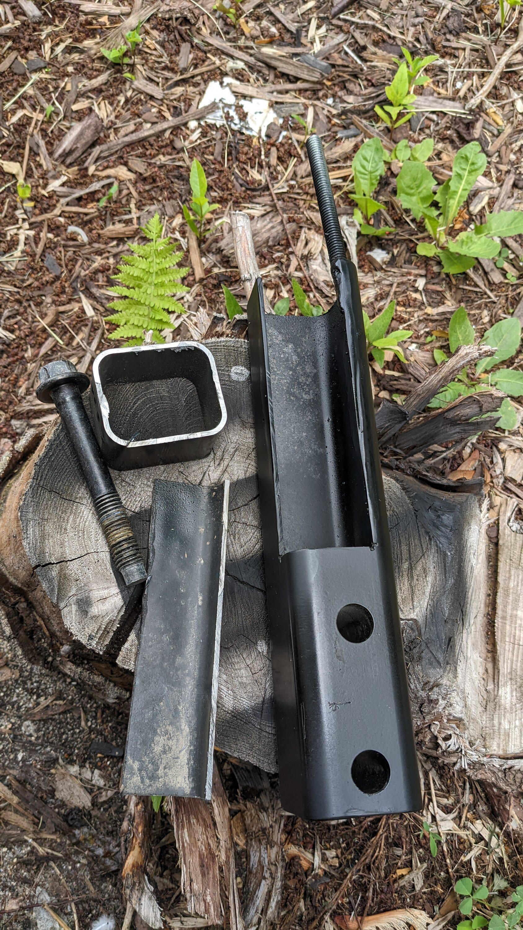

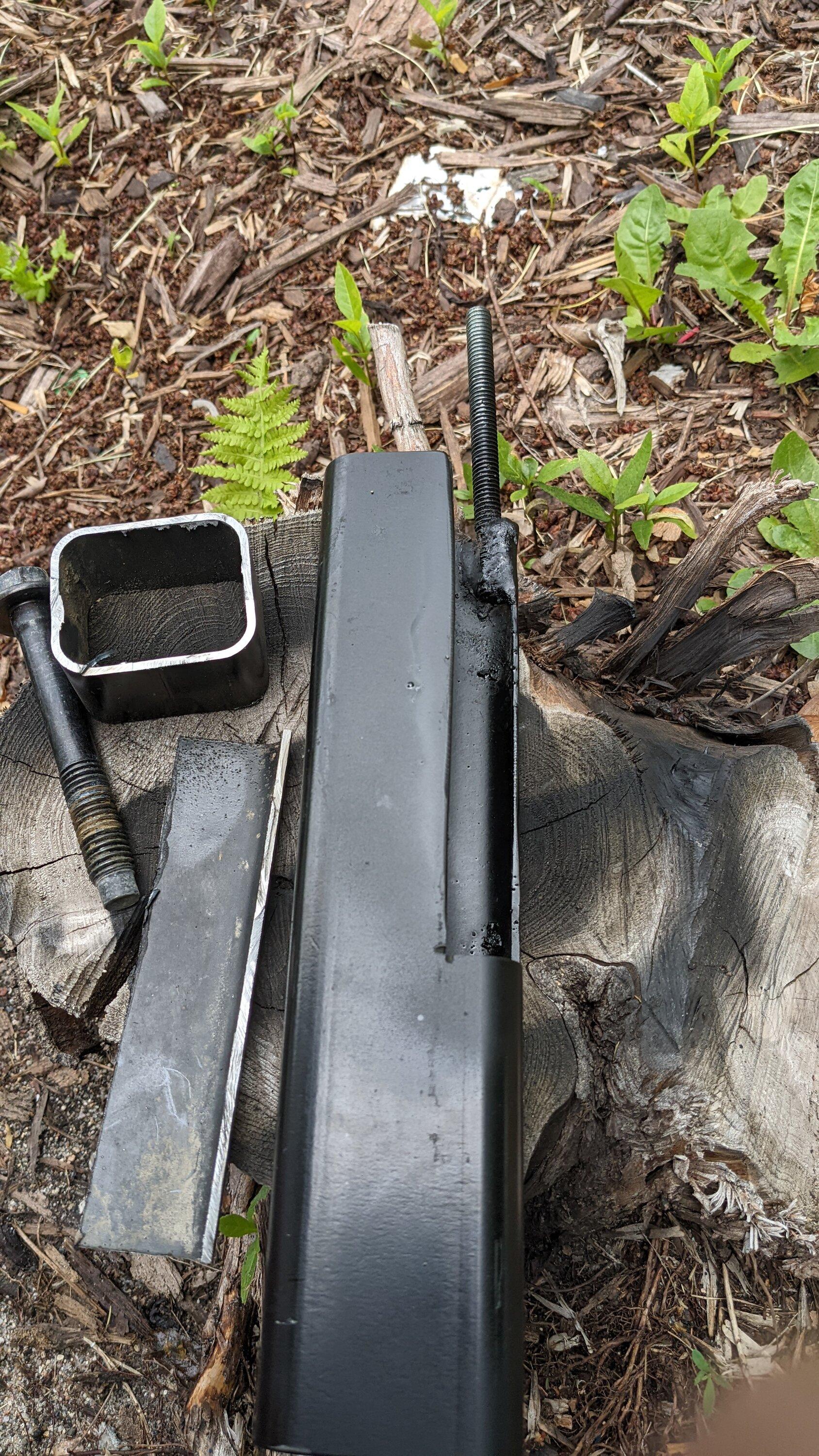

As previously mentioned, I made a bracket to hang the gutted FAD to as a temp fix.
Started with the factory crash bar and cut it so it would fit reversed into the frame pocket without protruding into the wheel well. Then cut a dual-purpose notch out of the (new) inner end so it will clear the depth stop that's stamped into the frame tube and allow access to weld in the beheaded carriage bolt.

After cleaning up the edge so it'd still fit down the hole, I hit it with a quick blast of paint.
