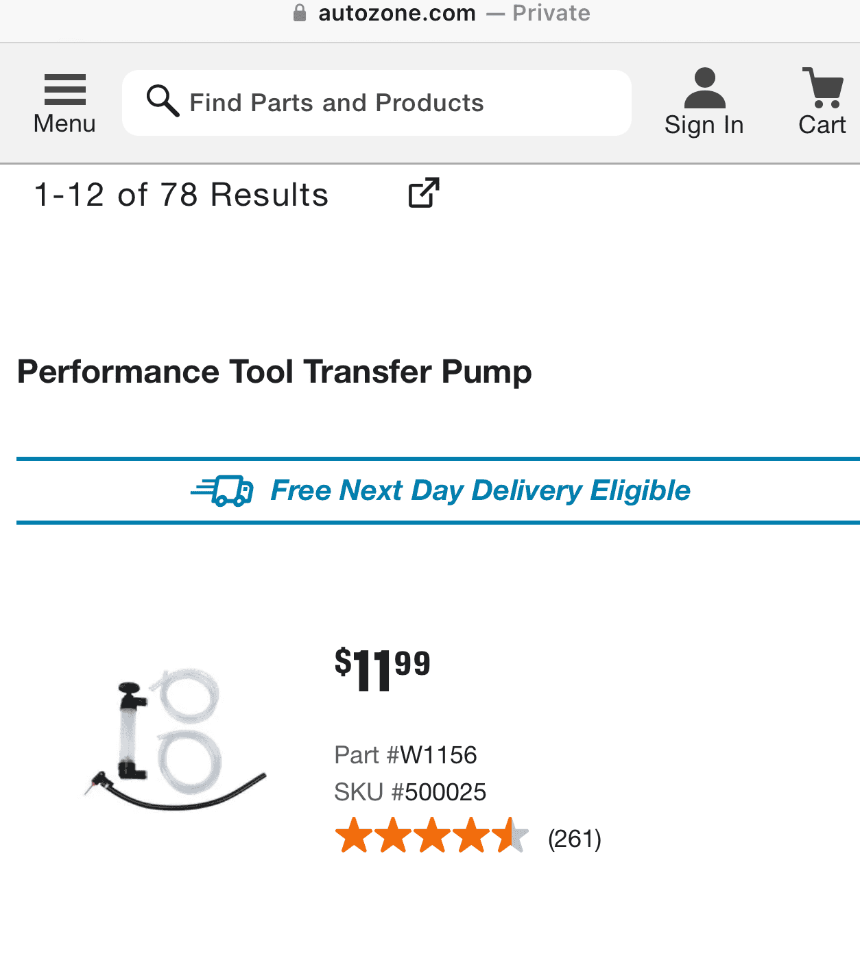

It’s cheaper on eBay, I bought two 1.6 liter bottler for $80, and a cheaper transfer pump from autozone and just pitched it when I was done. Just be careful pumping, the hose fits in the fill hole but will seal the hole and potentially over fill.. lesson learned.
