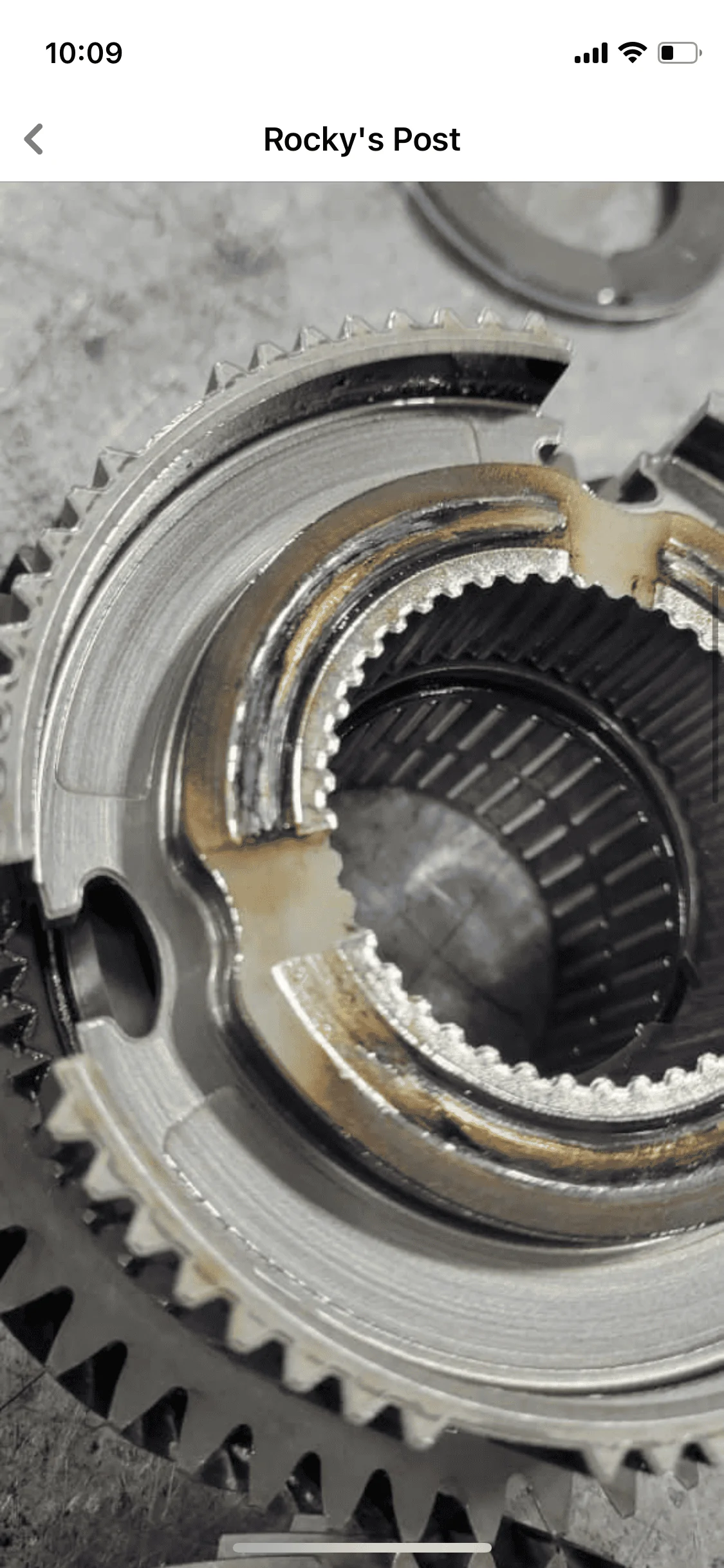

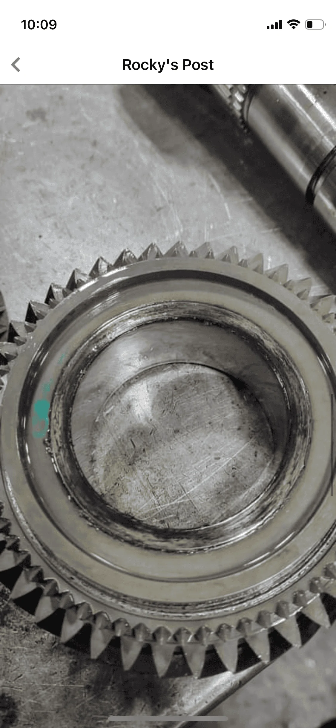

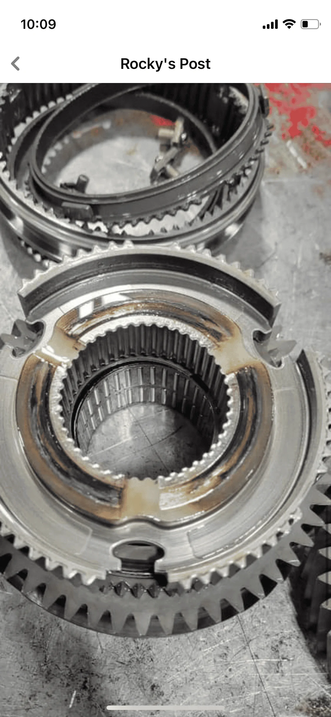

I’m not sure this was ever posted here but an owner in a FB group posted that they had the TSB performed and the sound went away.
They included these pictures of the 5 and 6th gear having “friction weld” burn marks on them. Oil was also visibly discolored with metal. I screen grabbed those pictures of the gears. Not my content so I can’t offer much more of an explanation. This owner reported the dealer replaced these gears as well.

I had my entire transmission replaced and it went away for awhile too
Going back on the 9th for the TSB
I like others agree with the theory that either low oil or incorrect oil is the culprit. Starts as a minor then progress to a full time sound with some evidence of damage.
edit: I’d like to think they would have checked the oil level on a new trans but I’m also a firm subscriber in if u want it done right u need to do it yourself, unfortunately we can’t to our own warranty work.
