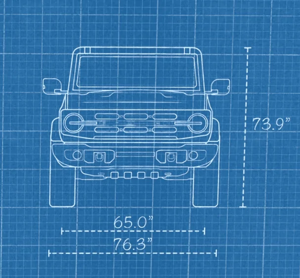

Should be easy to figure out a decent guess about the length of that roofline from doing some geometry. From a Roadshow Video. 65"/(19 squares) is ~3.42 inches per square. 17 squares so roofline is ~58 inches across.
Ford Bronco Max Lightbar width? 1618201047015
Also worth mentioning that the build and price included lightbar is 40 inches and seems to fit between the rack mounts so that would be 12.5 squares across on this so ~43 inches across by that logic.
Since you're hoping for a larger roofline it makes more sense to assume conservatively. So I'd just say assume the roofline is at least 55" across.
Thank you! This is very helpful info.
That 73.9" high - Do you know if this is with the 35" tires and Sasquatch package?

I don’t remember offhand, but this is where I got it from
