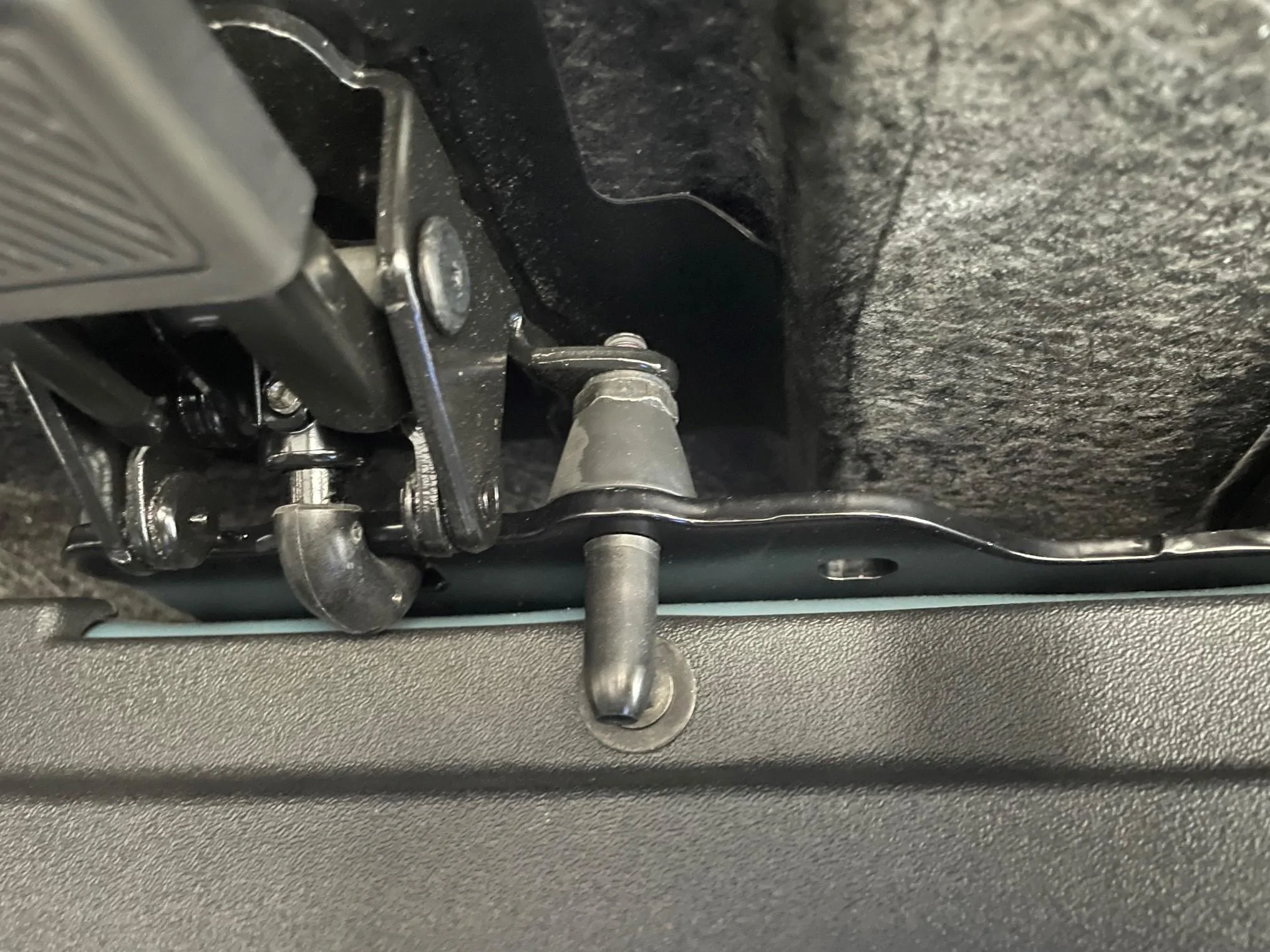

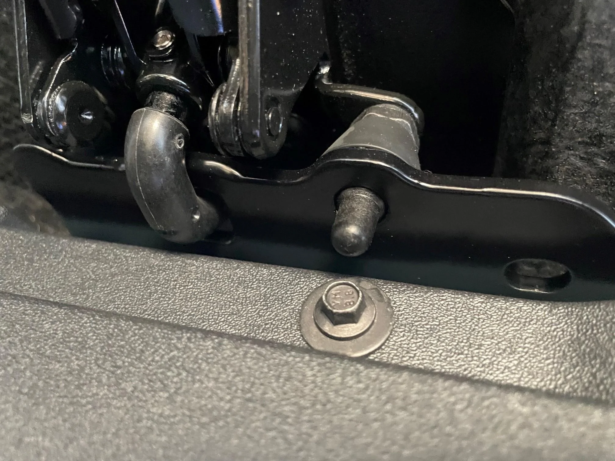

I ran by Autozone yesterday and grabbed a couple 3/8" rubber end caps for the guide pins. Put them on last night and tested this morning. Zero clicking, popping, etc from the roof on a series of bumpy and unmaintained roads. I've popped the panels on and off several times and the end caps stay in place! Now I just need to trim their length for final fit.

I had the same popping sound. Seems like it is coming from the same place as everyone else. I pulled the roof off and placed black electrical tape over the holes, then used a punch to create an opening. In total, I think only 6 points to tape over, two above the front visors, and two on each side above the front seatbelts. Tested for a day now and NO more popping.

You only did this on the 3 removable panels, right?
Is it still holding up ok?
