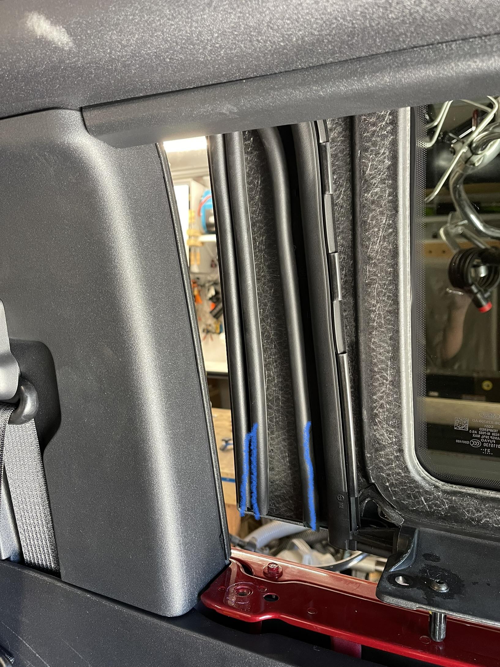

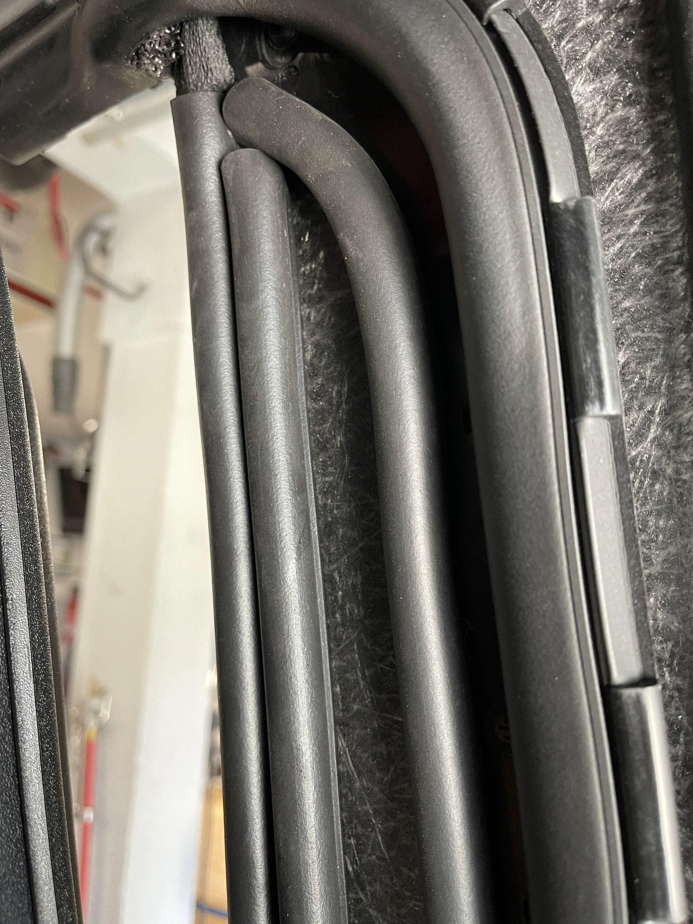

I purchased D-shaped strips of rubber gaskets and applied to the inside of the hard top where it meets the door side pillar. This has dramatically improved the noticeable wind noise on the interior. I highlighted with blue markings to indicate what I added. I will add links of what I purchased as well.

Can you clarify where this is?
Is this the very rear hatch, front panels, or middle section? (2 door or 4 door?)
Thanks

Can you provide a link to the product?

So you put on 3 separate pieces? and how far did you go up? Thanks

I’m sorry but your photos totally lack perspective - I have no clear concept on where you applied the “product”. A shot from further away may give perspective.
It is the where the rear clam shell mates with the B pillar on the 2-dr.
Understood. Sorry. I didn’t take too many photos as I wasn’t sure if it was even going to work. Only after I realized the benefit did I decide to post this. I will update the thread next time I remove the top.
