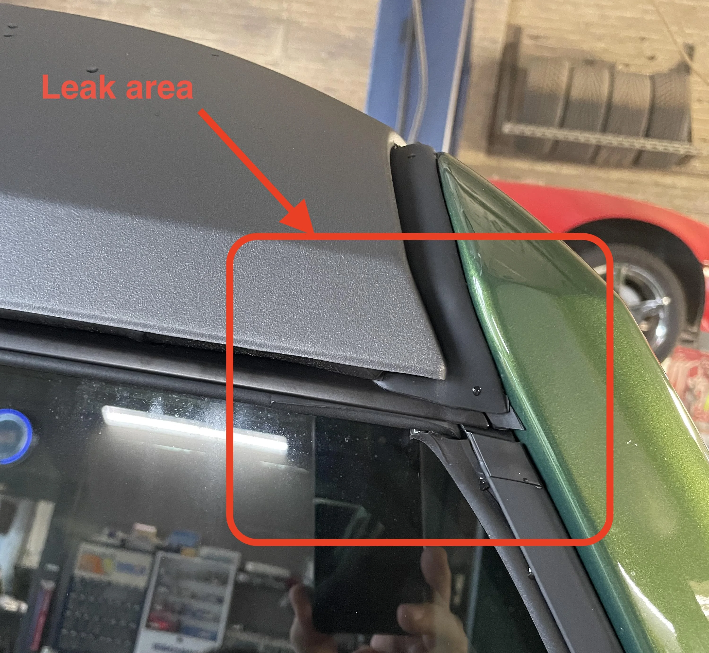

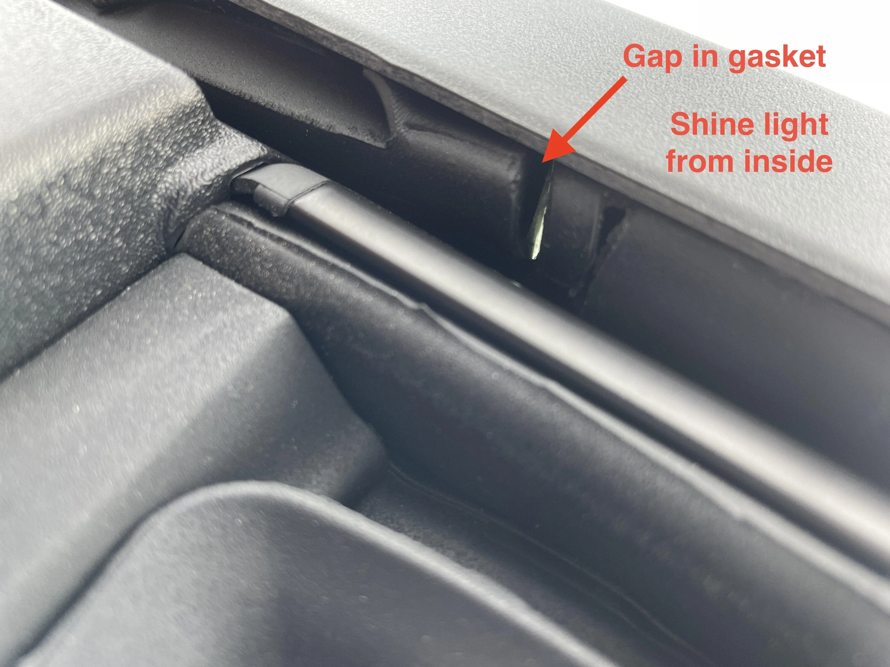

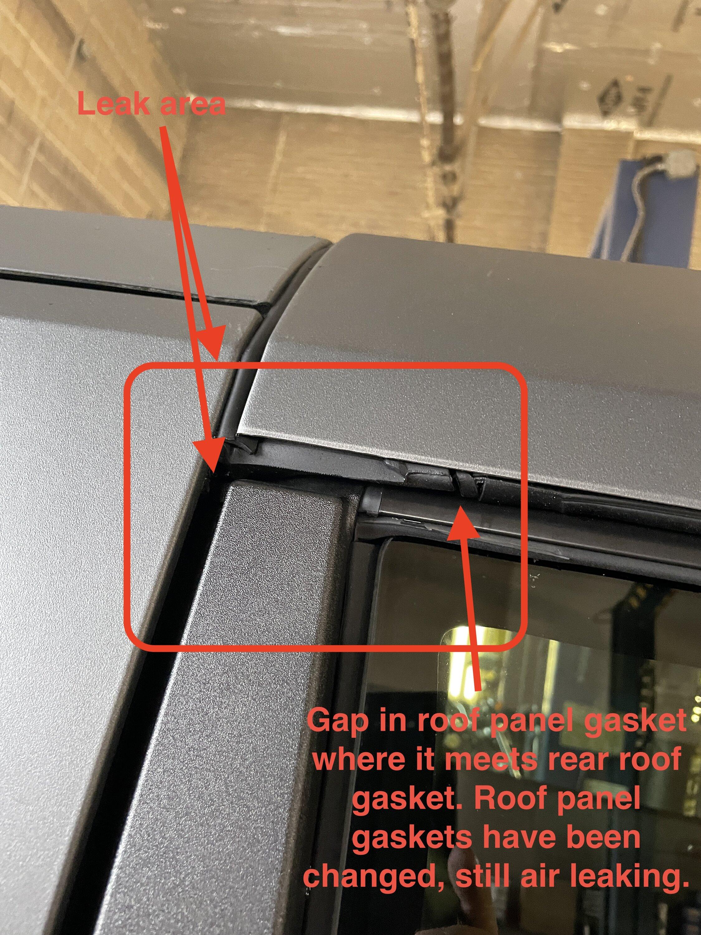

This is the first problem I found using a light from the side. The dealer changed these roof panel gaskets and the gap is better but still leaks.

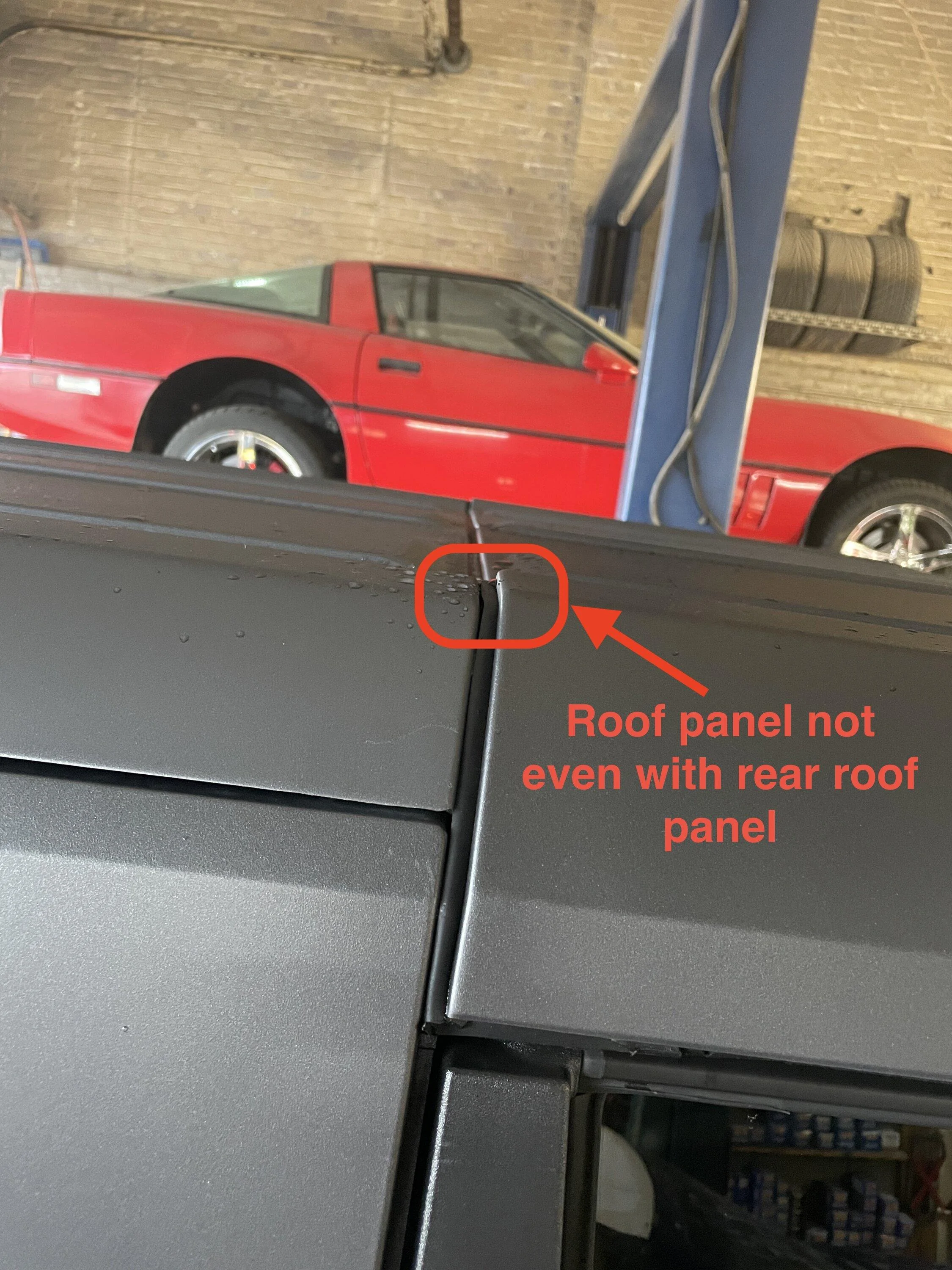

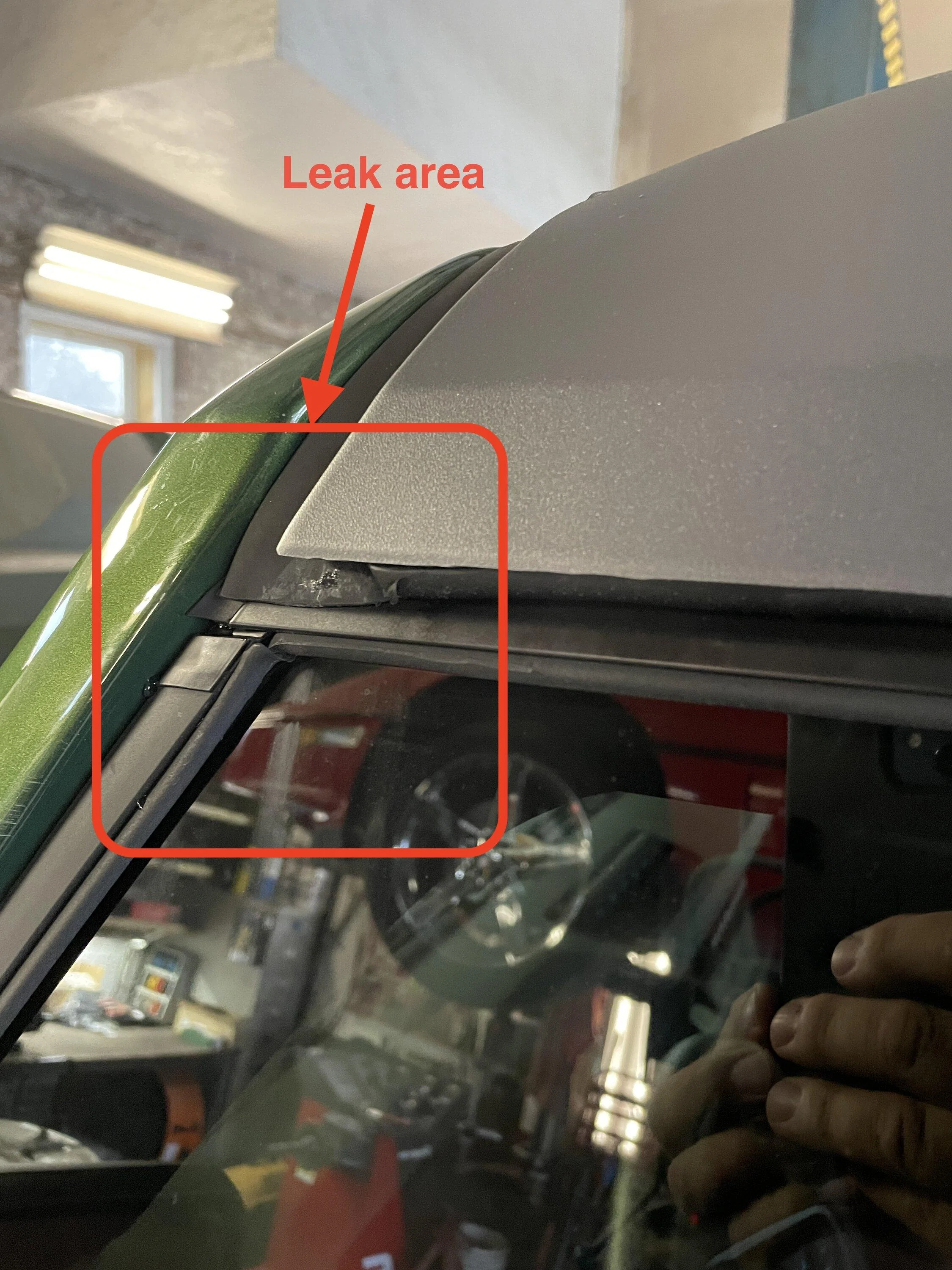

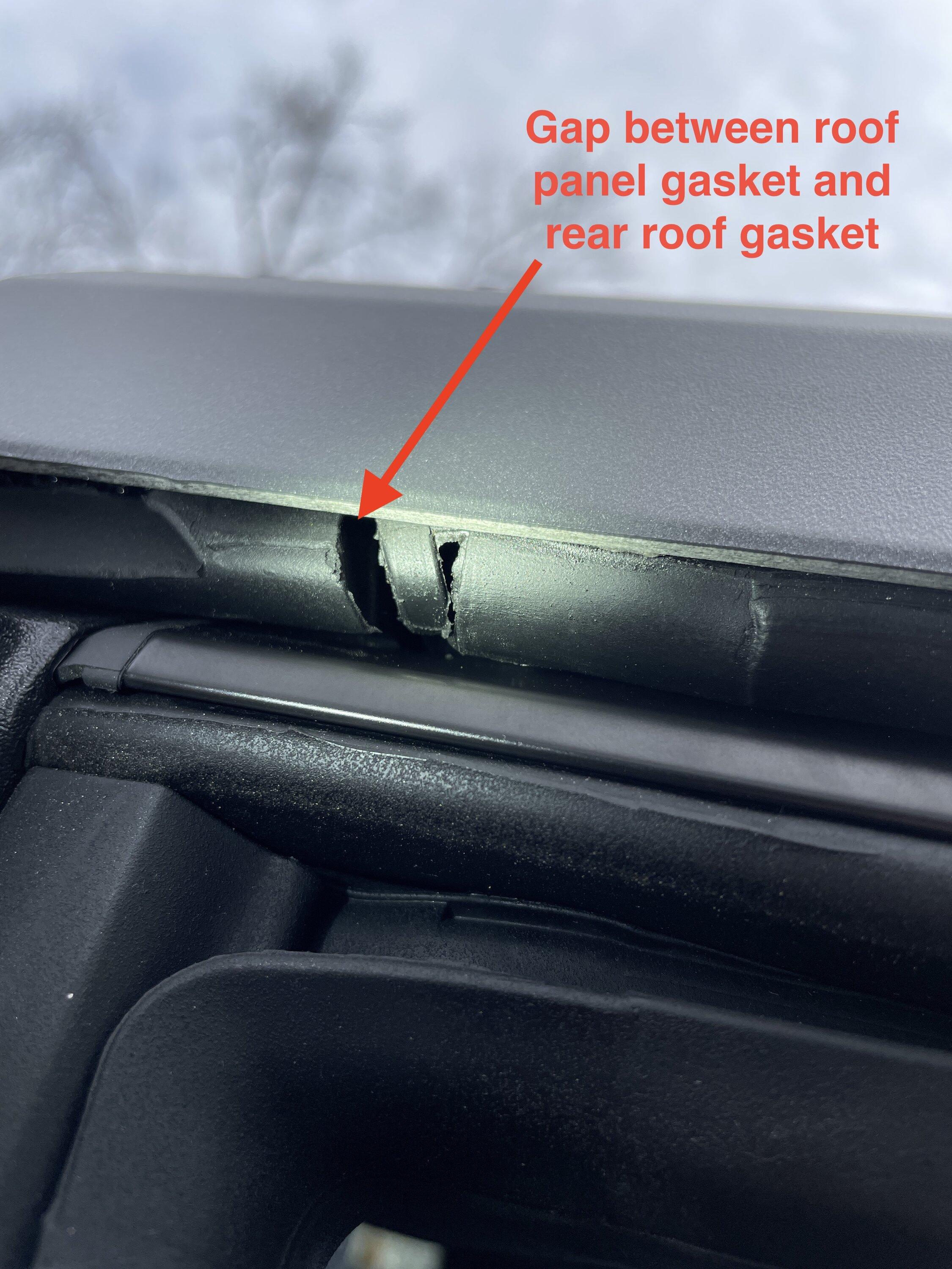

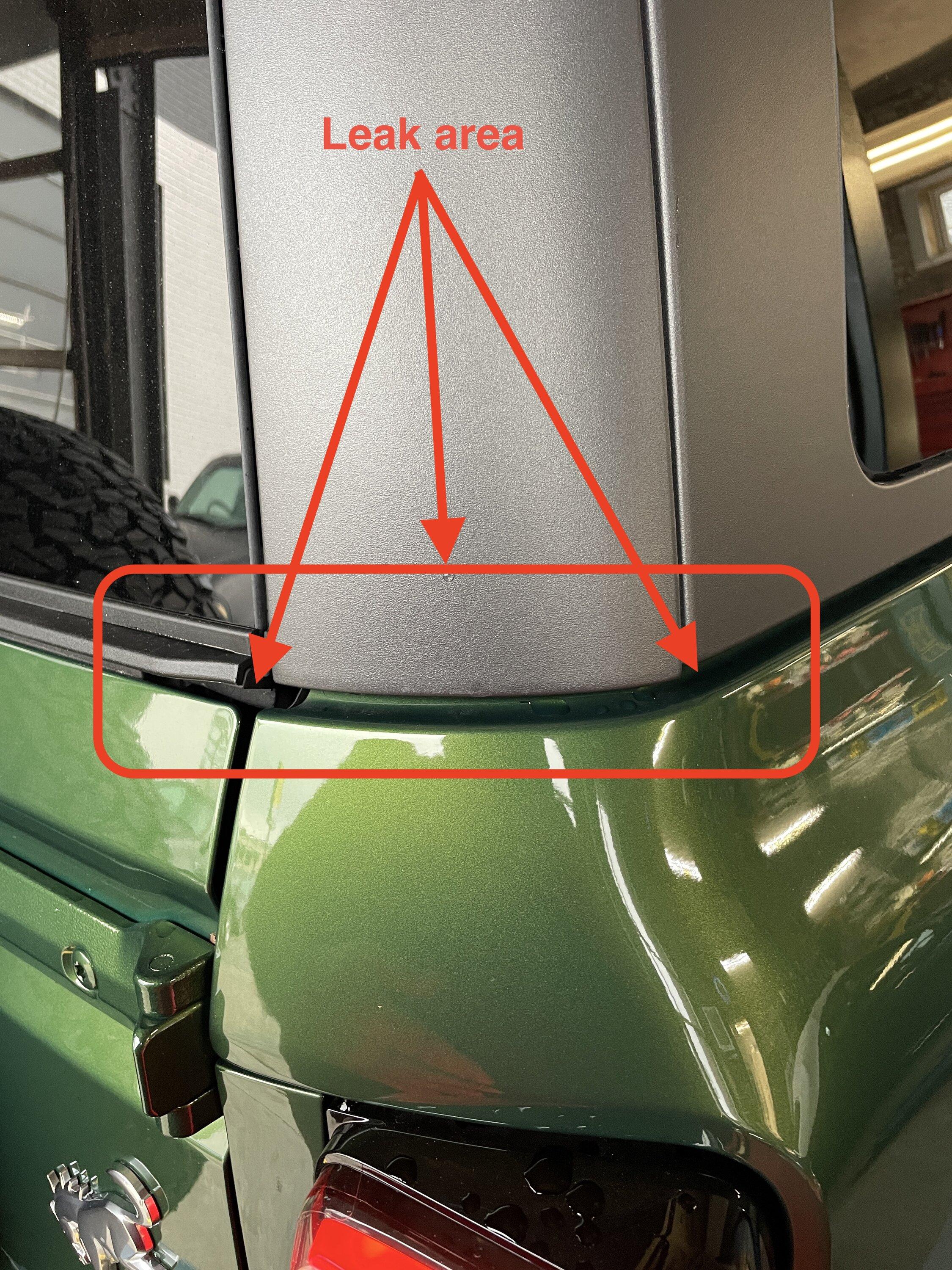

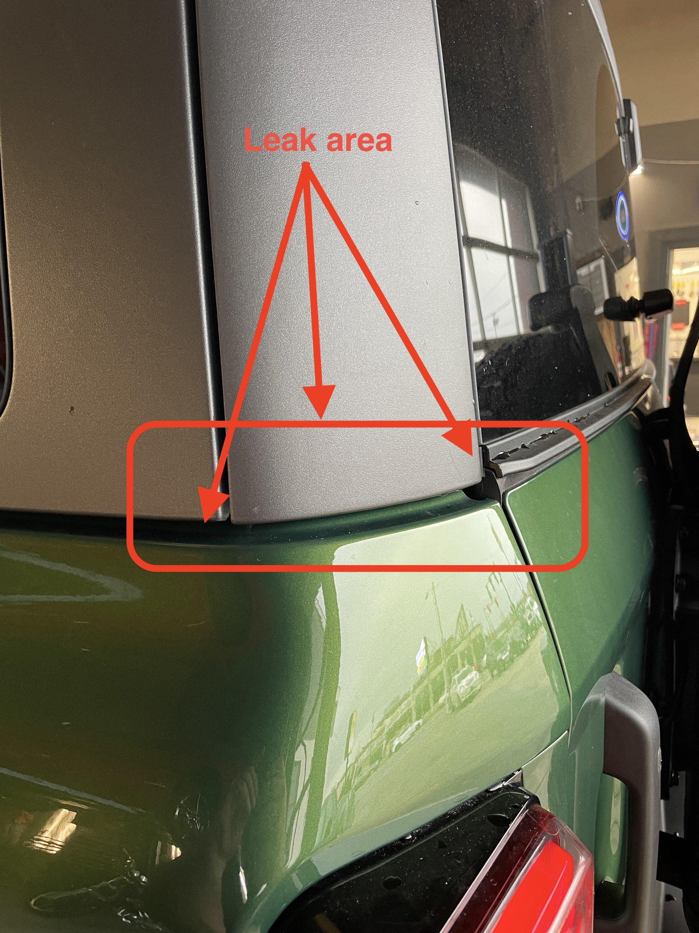

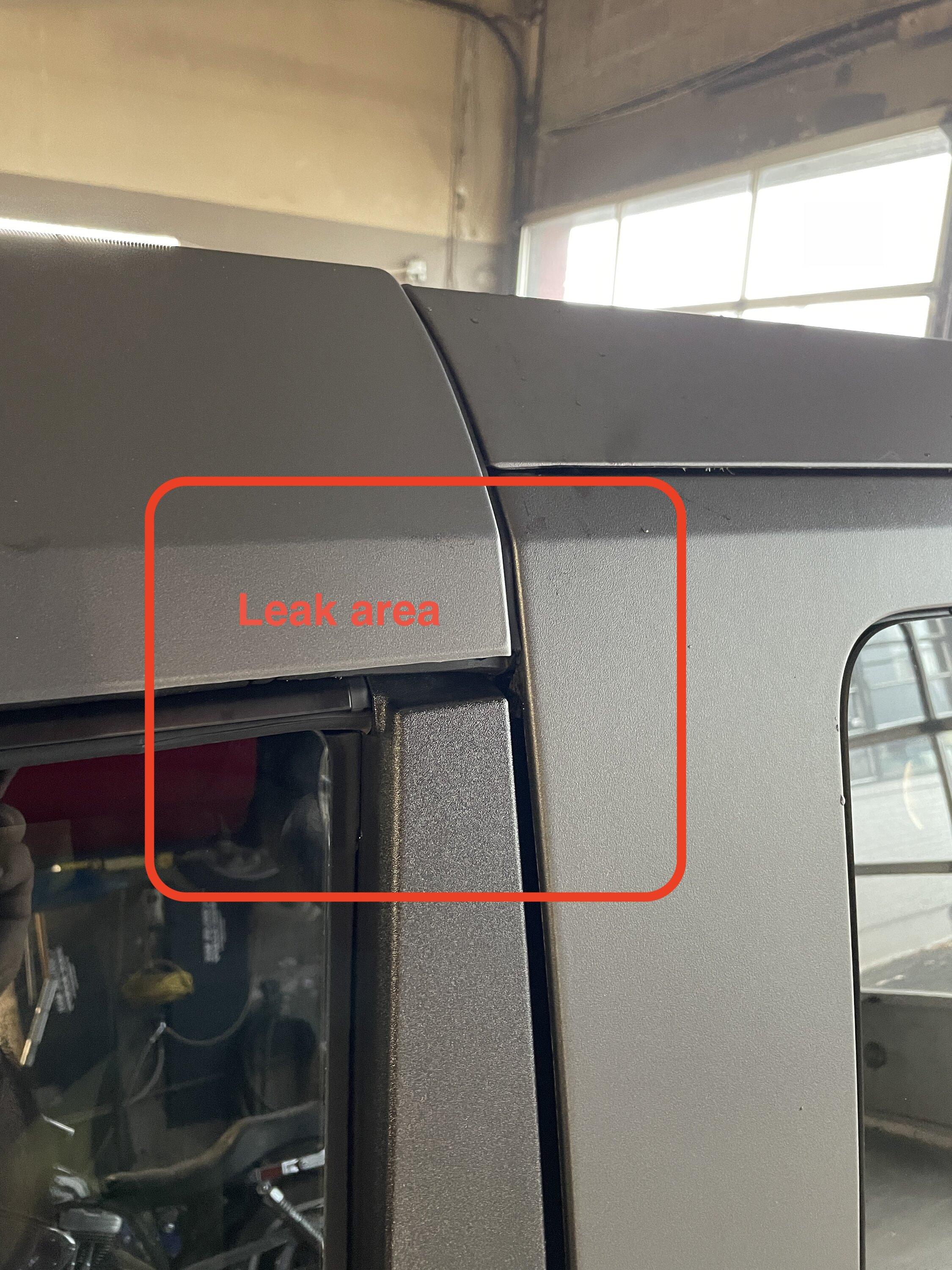

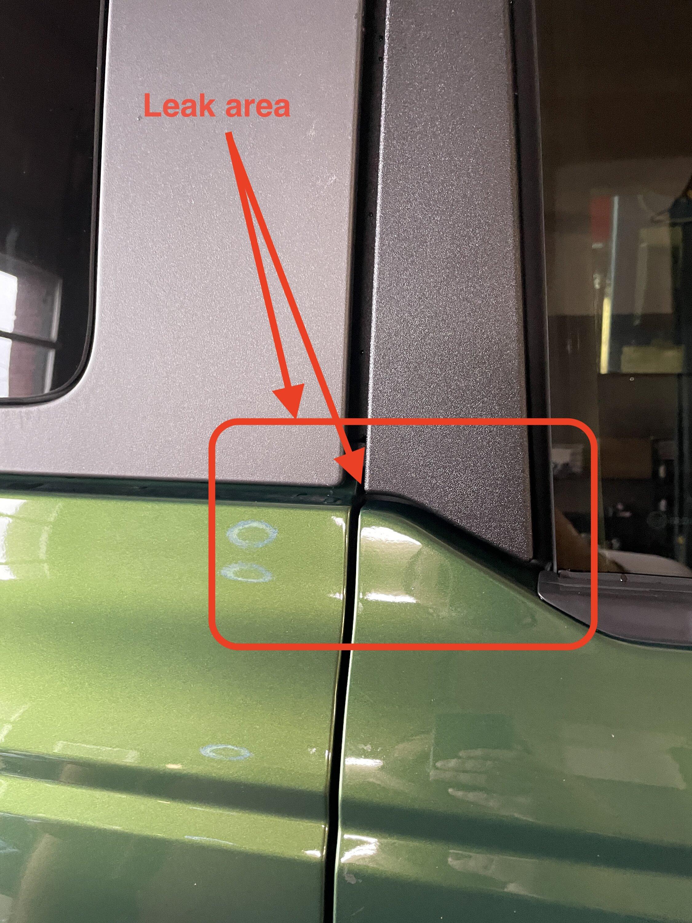

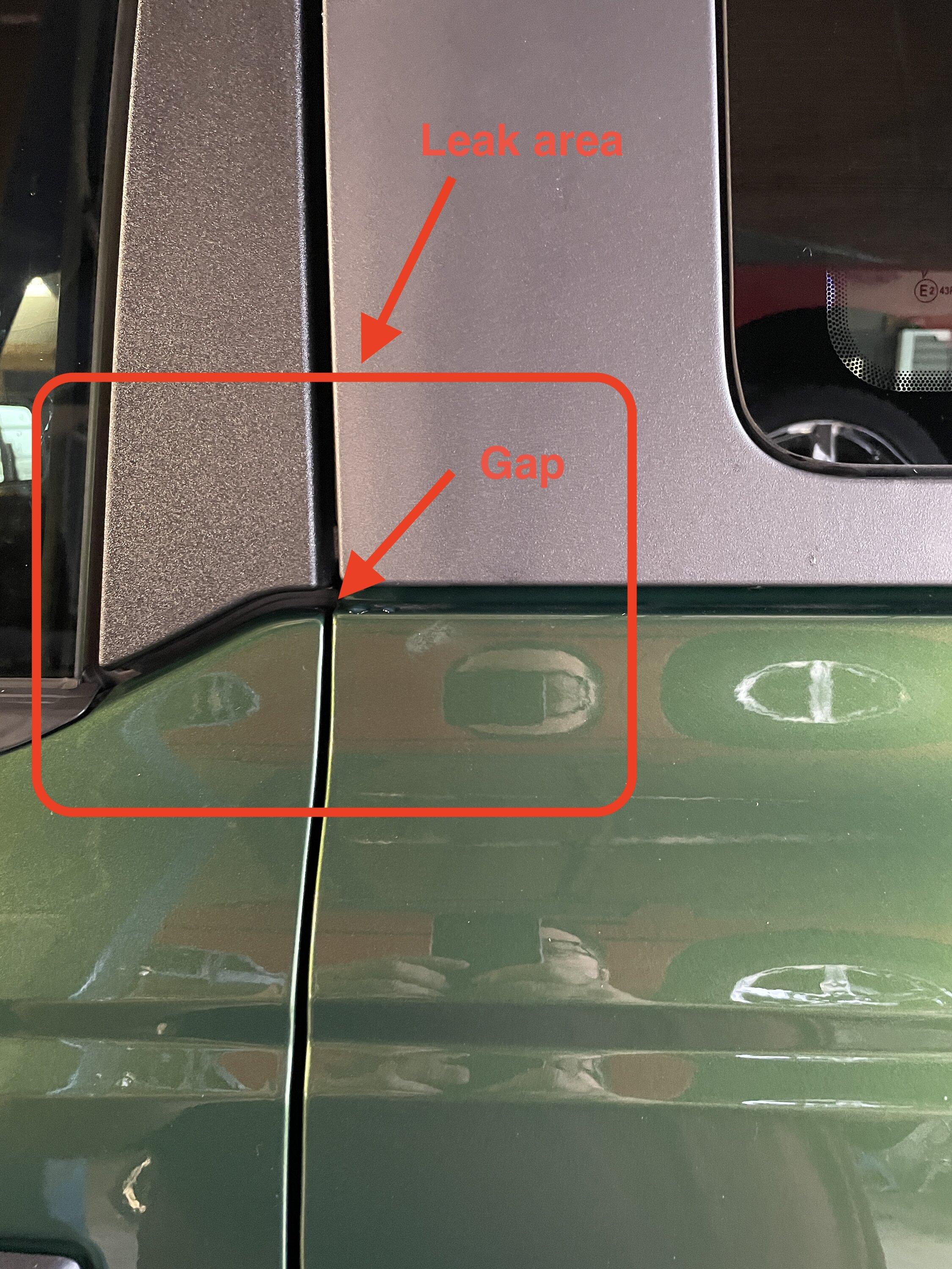

Now is a series of pictures I took today and I found all of these leaks in less than 1/2 hour. I used a smoke machine, but if you do not have access to one I will explain how to find them without.
Using a smoke machine start the vehicle and place the fan speed to high and also make sure your climate setting is for fresh air not recirculate. Then close all doors and windows this will create pressure inside and using a smoke machine from outside the vehicle run smoke over the gaskets, door seals, window seals and so on and you will see turbulence in the smoke where there is a leak.
No smoke machine no problem. Same as about but also put the A/C on and get it cold, again make sure it's not on recirculate. Get a wet rag or paper towel and wet the back of your hand with the rag. Now run the back of your hand about 1/2" away from the gaskets, door seals, window seals or where ever you suspect a air leak. No leak your hand will be warm as soon as there is air leaking you will feel the cool air and be able to pin point the problem area.
Check all these areas.

The removable front panels are about 1/4" higher than the rear roof and I do not really see much adjustment to align them but I did not find any leaks on top of the roof, but I believe these panels need to be tightened down to align properly.
