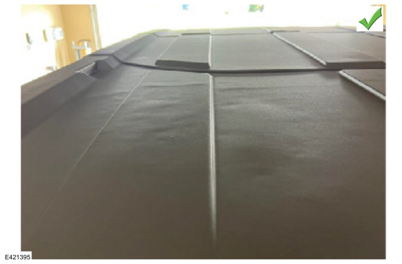

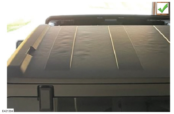

Just an FYI, Ford has updated the GSB about Bronco roof concerns to include delamination issues.
General Service Bulletin Download[PDF]:
https://www.bronco6g.com/forum/atta...712170/?hash=f5bd3568933a773eef10bf78e9ff1d21
Delamination of hard top outer layer (Warrantable)
• Raised patches on the hard top with no distorted grain pattern or discoloration (Figures 16-17)
Figure 16
Ford Bronco {thread} {filename}
Figure 17
Edit: I've also attached the whole GSB just incase anyone wants to see what is and is not warrantable according to Ford.

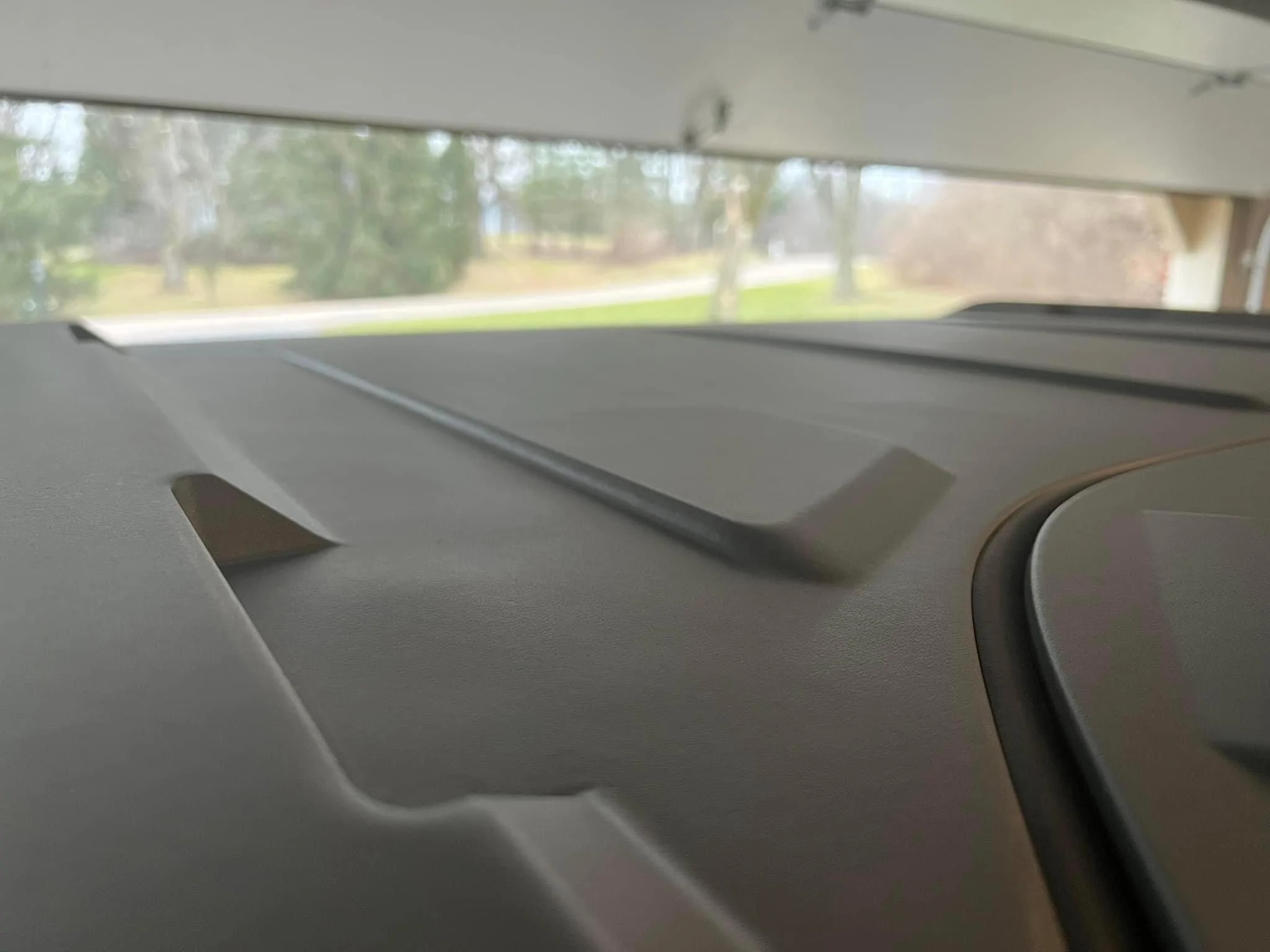

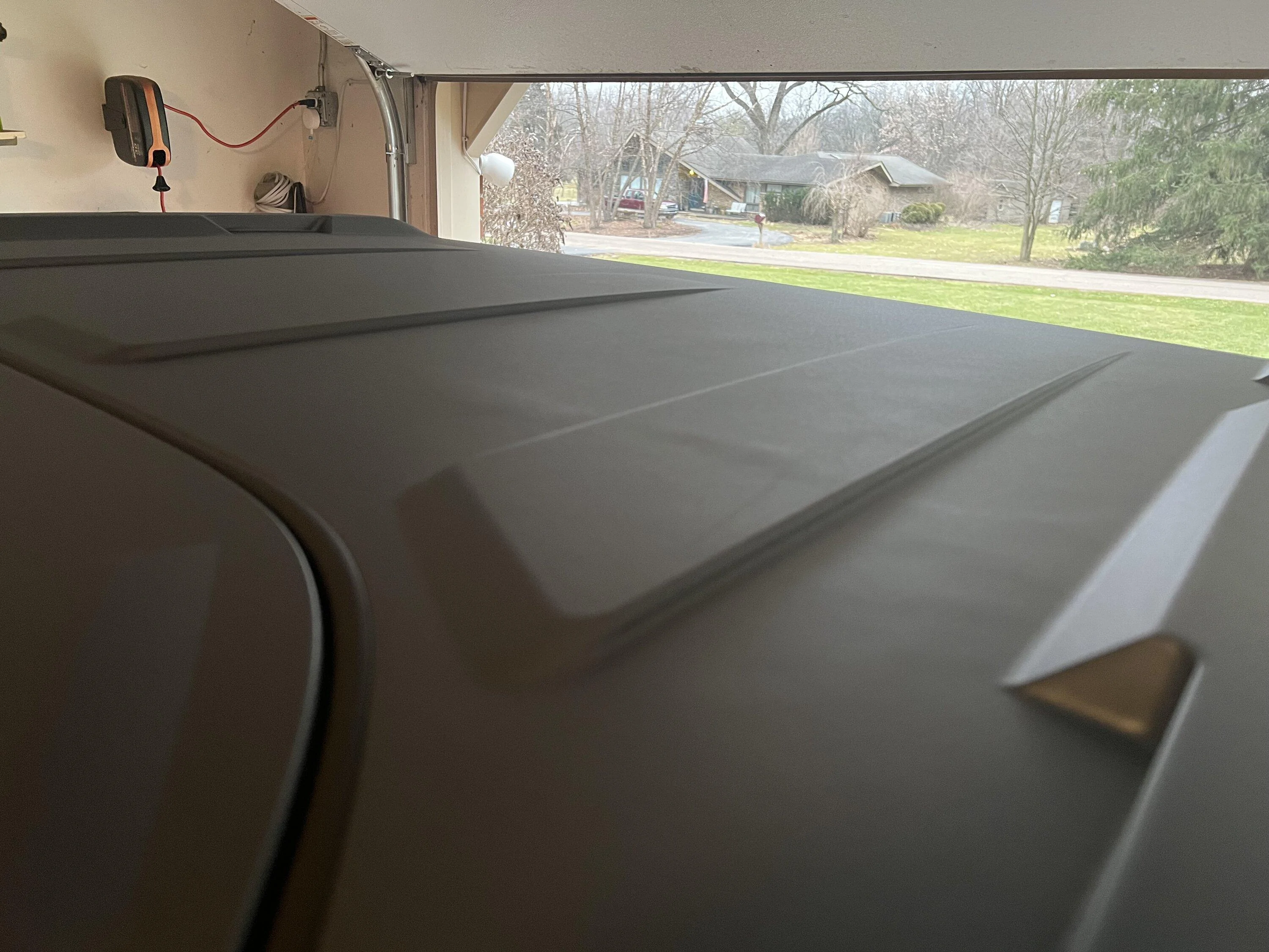

I’m going to take mine in and see what they say/do.
Ford Bronco MIC Hardtop Delamination Issue now covered in General Service Bulletin -- Bronco Roof Concern Analysis  -- 1/05/24 Update IMG_5234
Ford Bronco MIC Hardtop Delamination Issue now covered in General Service Bulletin -- Bronco Roof Concern Analysis  -- 1/05/24 Update IMG_4134
Same issue here, Same problem, Since it is my 3rd top replacement can not wait to see the next one.
