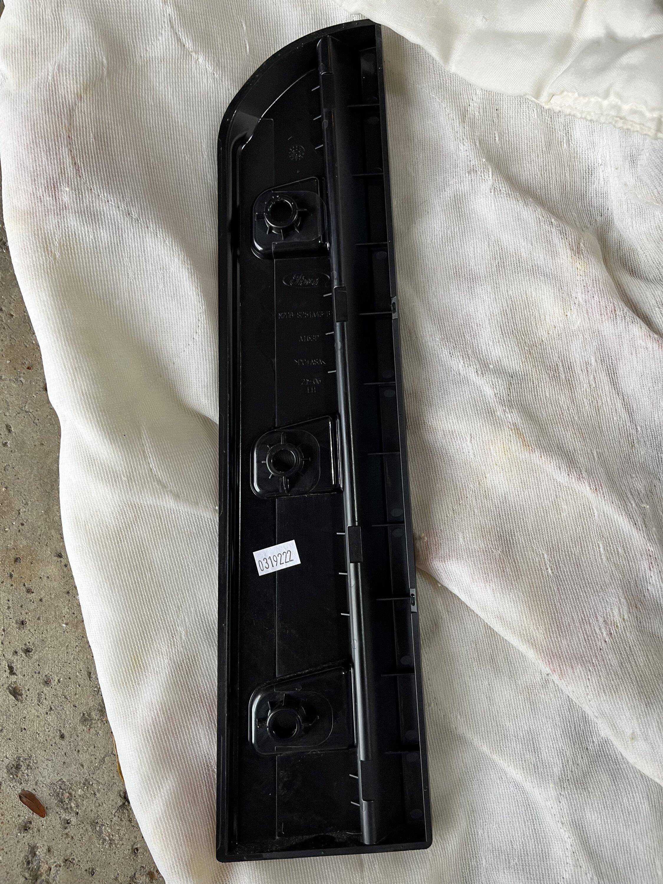

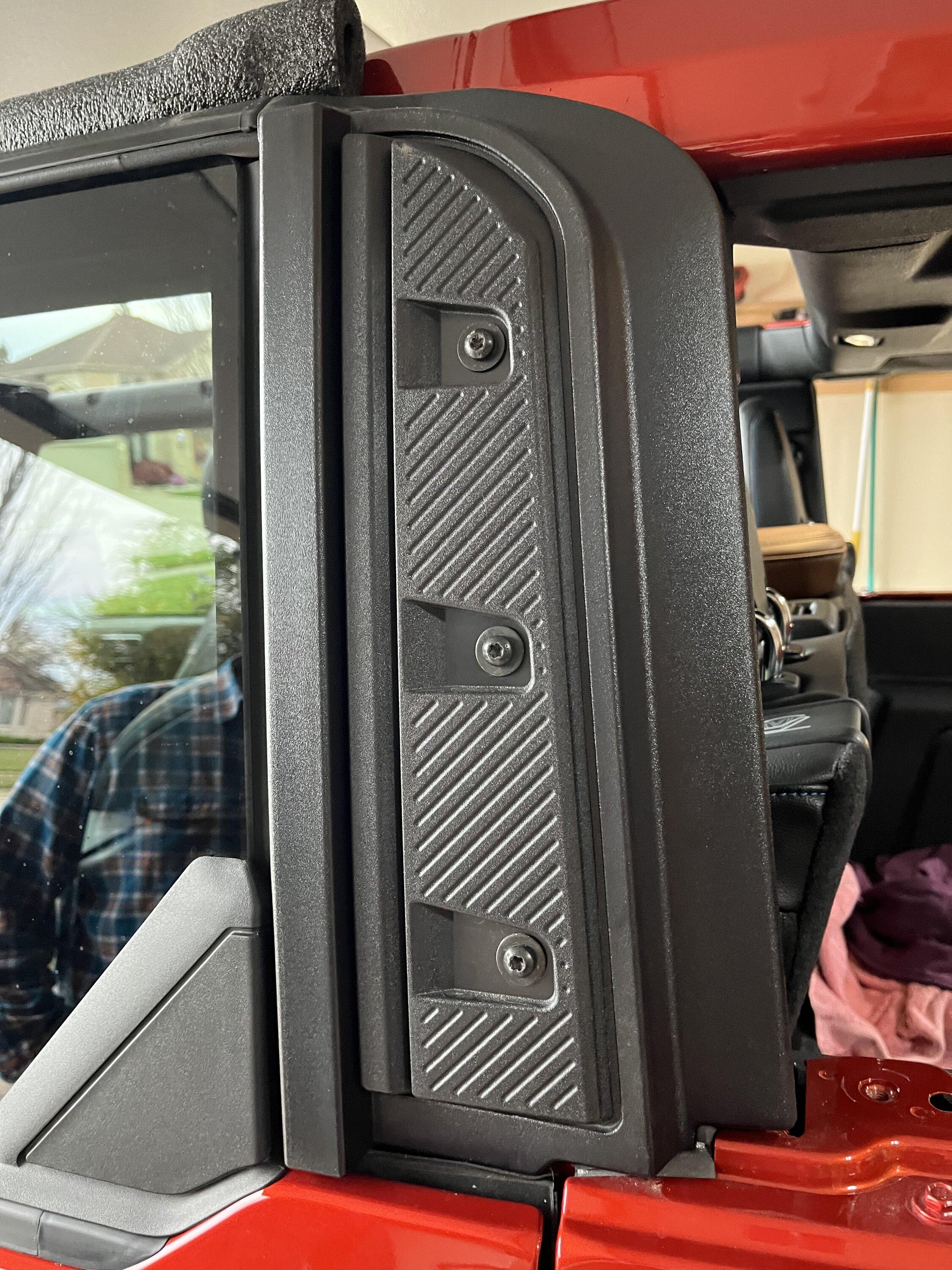

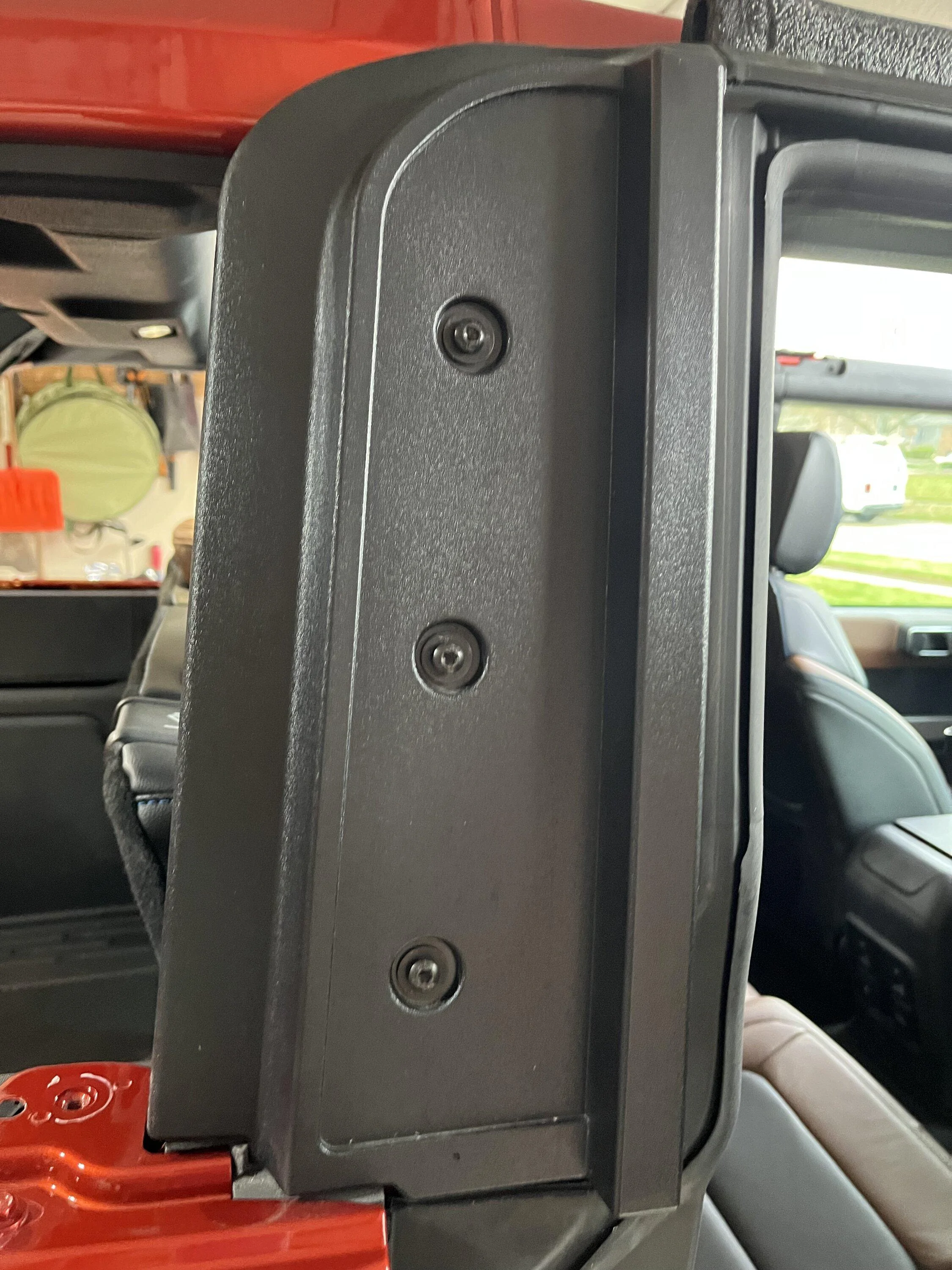

Missing C pillar part.
Did all but the rear panel. When I removed the top rear panel I discovered a missing plastic filler piece on the right side of the C pillar. Attached are photos. First photo is the left side with filler, second is right side missing the plastic filler and last is the filler removed for photos. I can’t see any function for the part other than a filler which may be there for wind noise.
Anyone else missing this part?

That’s odd. Appears to be a mfg defect?
Yep. Right side missing the ”filler”. Did you have it on yours? It didn’t look like the roof would fit back on if I put all the gasket material on the side with the filler so I stopped and will take to the dealer. I tried looking up the part number (M2DB-S254A43-BAW) on the filler but couldn’t identify or it.
Ford Bronco MIC Noise Reduction Guide - wind sound- aka more (or less) cowbell please 7738AB3D-6541-4697-BB4D-24545F7D7965
I am missing that piece on both sides. Let us know what the dealers says.

Yo wtf. I’m missing both of mine.

That’s for the soft top, if you have a hard top you don’t get them. Quite a few brackets different. Had to buy them all when bought a 2nd hand soft top for summer. Cost savings by Ford.
