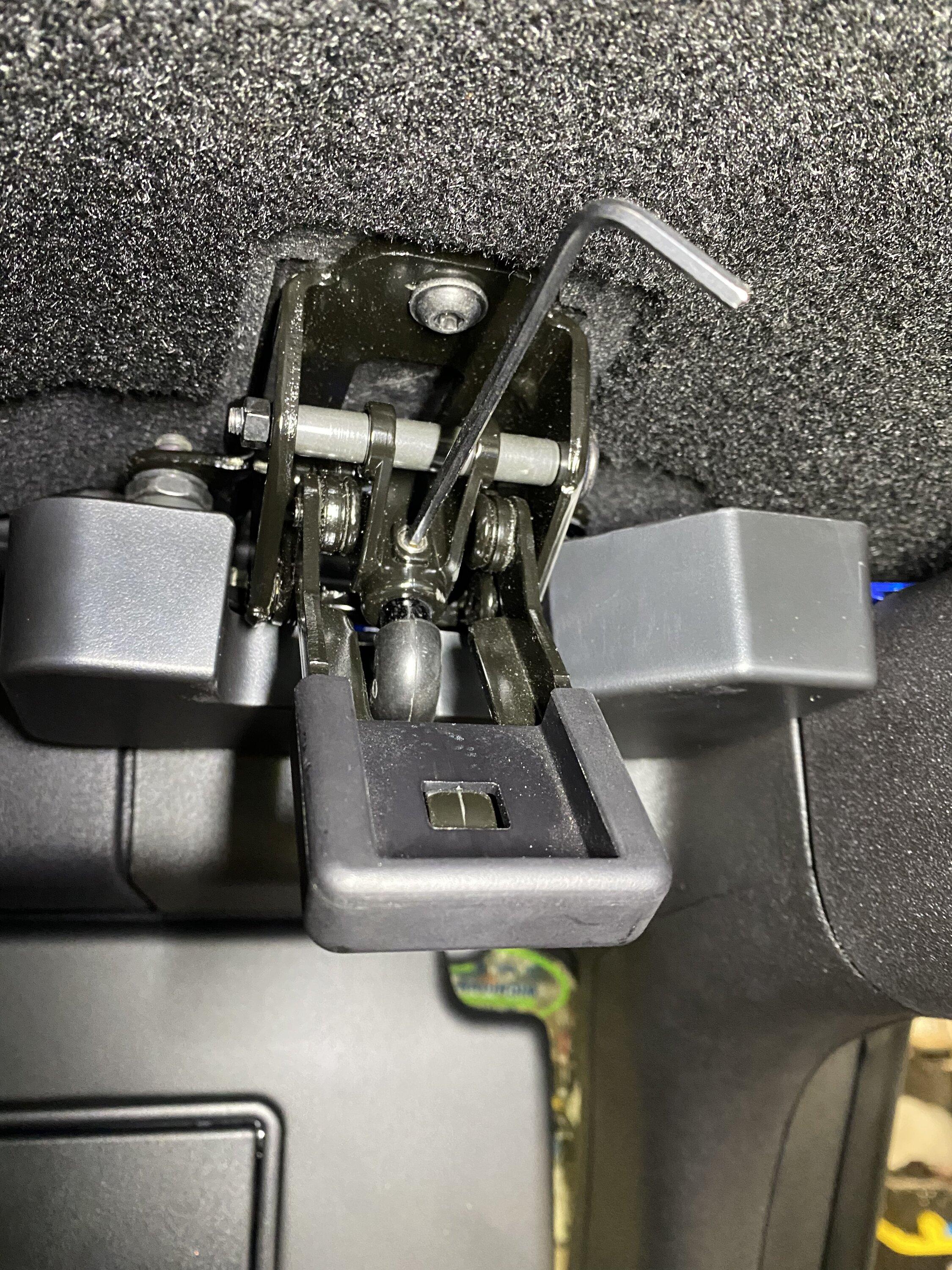

Thanks to the OP and contributors. I have a May 21 build OBX and have not had issues with wind noise. Live in the Midwest, no leaks in the car wash.
My wife came out last week and jumped in the truck, door not closed light came on and she slammed the door. Door rattles and wind noise like crazy. Followed the thread on loosing the 2 10mm nuts at the bottom and moved the window back. 5 minute fix to cure the problem. Thought it would be built to withstand slamming the door without the window coming loose.
Well we have the temperature drop and a snow storm. What better time to take the Bronco out. Sound like I was in a windstorm with snow coming in by the roof. I now understand wind noise.
I loosed all the roof clamps, 3mm Allen wrench, and turned the threaded j hook in one turn. Wind noise gone. The gaskets collapsed in the cold weather. A little more tension fixed it.

I installed the missing part on the passenger side and my wife says it’s definitely quieter. It definitely fills a gap.
I guess you removed the clamps from the panels to turn the J hooks in? My J hooks don’t have enough clearance to turn.

initially I put a plastic shim (bottle cap) under the J hook. Gave me a idea how much I needed to clamp down the hook. Had to tighten 3 of the clamps. Test drove and wind noise went away. After I found tobworks came back and removed the clamp to tighten.

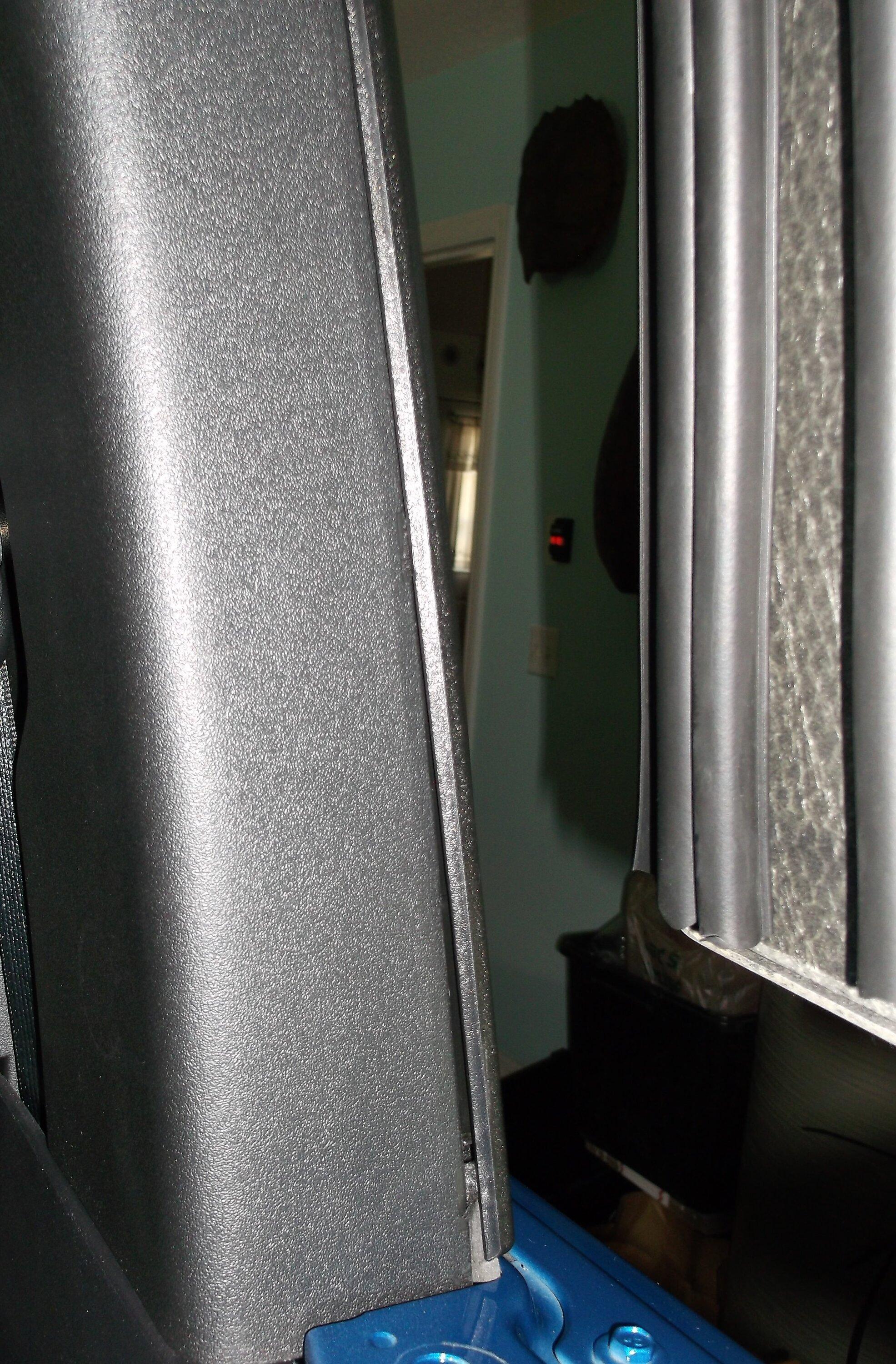

Finished up this project today and when I had the rear clam shell off, I noticed the interior trim piece wasn't seated correctly in the groove of the B-Pillar trim piece with the 3 bolts. It was the one side where it sounded like the window was cracked. Not sure if it was the culprit, but it is worthwhile for others to check to ensure the trim pieces are aligned properly.
Overall, I want to thank @orion1224 for taking the time to write up the informative post. I'll be taking it on the highway for test cruise to see if it made any difference. I didn't have a big complaint on noise and I'm used to wind noise on my Jeep. With these simple steps, they can only help. In my case, the passenger B-pillar was the source of the excess wind noise as if a window was cracked.
