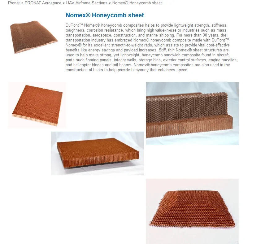

I would venture to say this is the material that a lot of the members on this board are claiming is cardboard. It took 2 minutes to search and find this, and I really don't believe an advanced car company beholden to its investors, would produce $40-60k vehicles with cardboard reinforcing the top...just sayin
It makes sense that the interior would be a Nomex honeycomb. The problem isn't the guts, it's the shell and edges.

Weight. The core is essentially to give distance between the outer shell. The more separation between the top and bottom the greater the bending load they can carry.
Ya. The core doesn't do squat unless you pierce the skin, like in a shoot out or some such. o_O
Aircraft parts are built the same way.

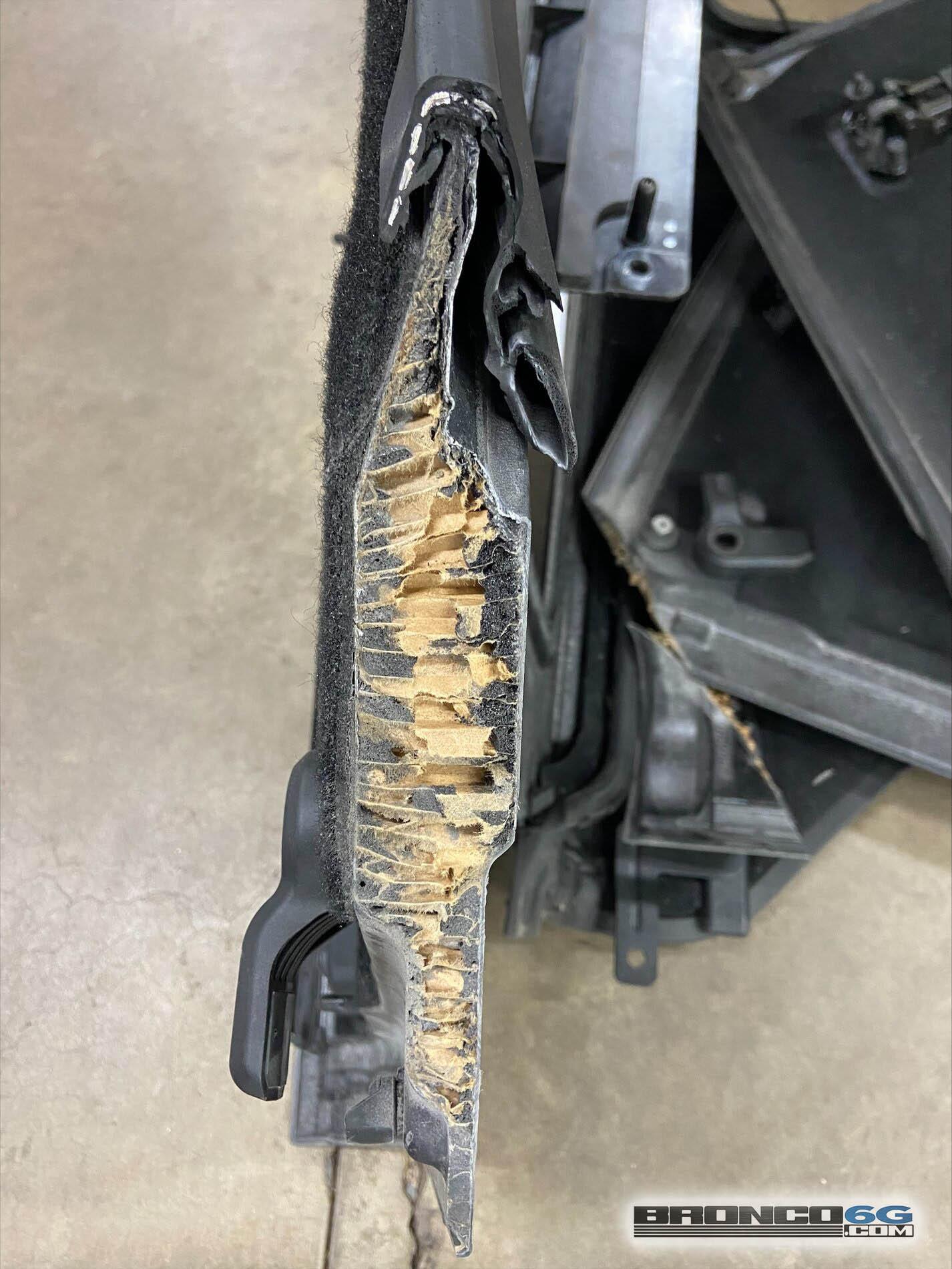

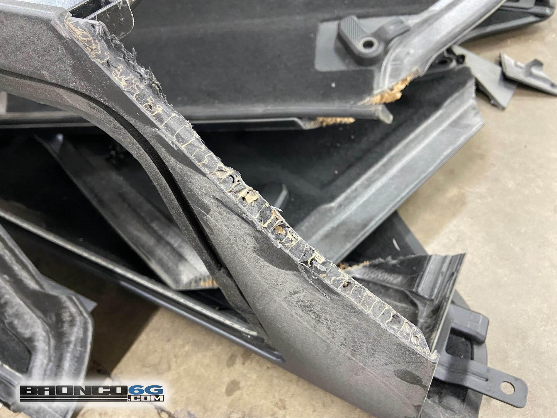

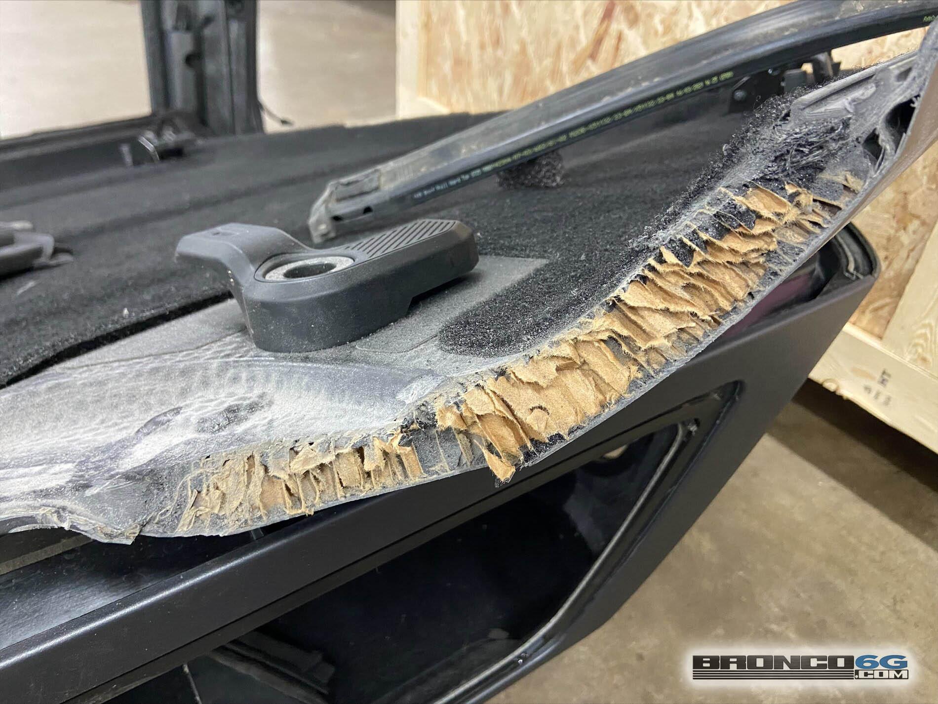

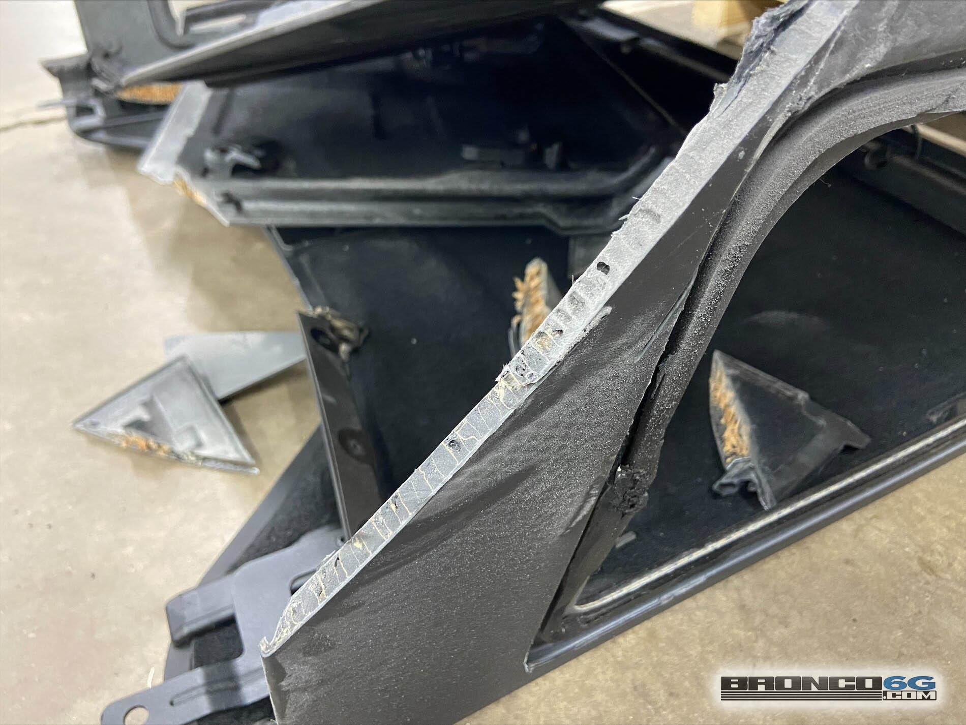

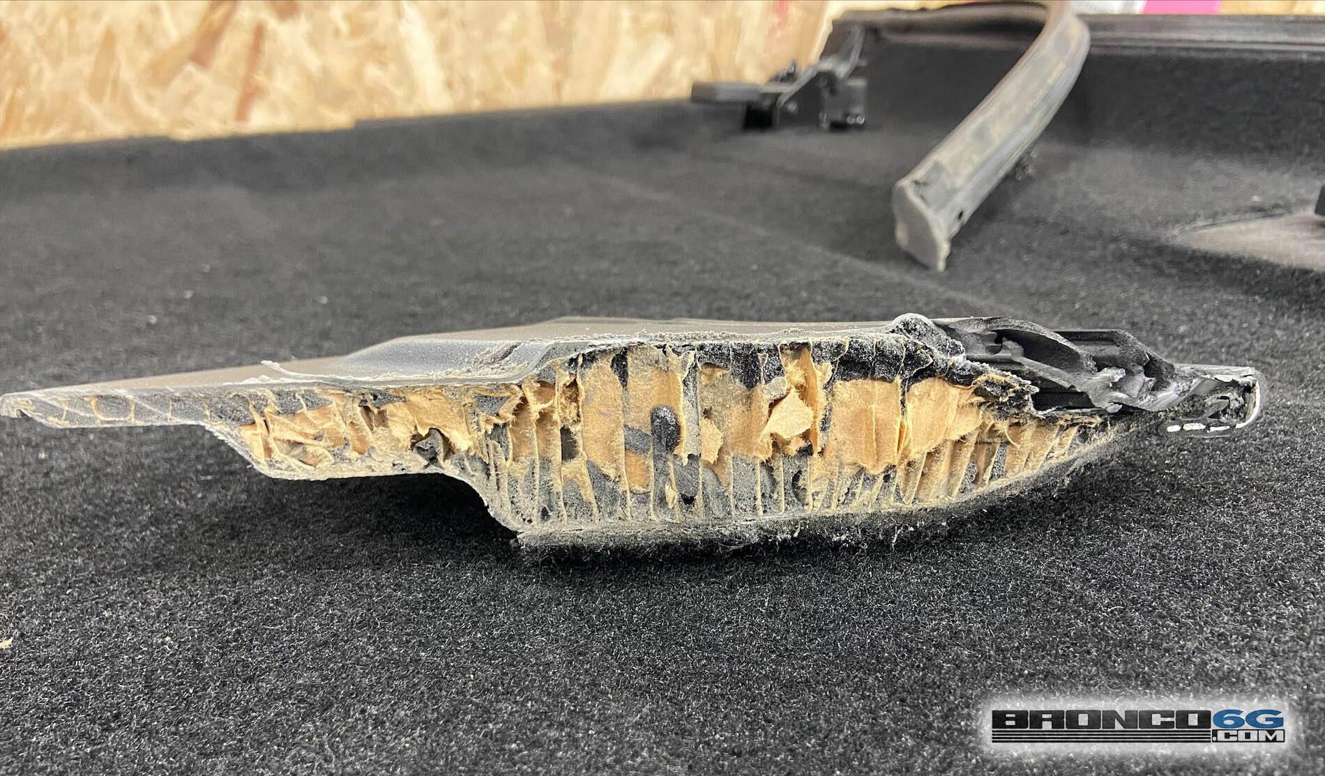

Hello! My store recently replaced a MIC 1.0 top for one of our customers, and part of the replacement process required us to cut up the old top panels. Would anyone be interested in seeing the inside of the MIC top?
Edit: Below are some pictures that I took of the MIC 1.0. After inspecting the top and seeing just how thin that outer shell is, I can see why the honeycomb structure of the top was showing through when exposed to extreme heat/moisture.

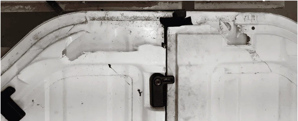

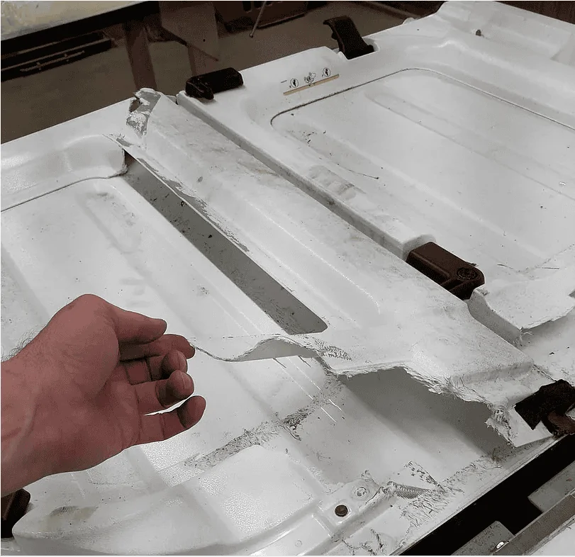

Anyone come across a Jeep Wrangler hard top that has been cut open or damaged? I would like to see what foam fibers or sound deadening material that Jeep has used to insulate their hard tops. Not sure how they have been holding up over the years either? I found a couple of photos of someone repairing a damaged top on the "EXPEDTION PORTAL Forum". It appears that this top has a hollow core and fiberglass skin. When you search "Jeep hard tops" there are so many aftermarket companies making insulation panels and sound deadening material. Doesn't seem like Jeep exactly has their act together either. :rolleyes:

Many people criticize the MIC top; without having ever been through the challenge of creating a complex composite structure themselves. It's magical that Ford created something SO LIGHT (easy to handle/remove) that you can DANCE ON (or sleep on).
It's not easy, so be grateful for the cool rig that we'll all get to enjoy.
Great pics of that complexity in this post. Thanks!

This is what composites look like. They are light and strong, and you will find similar construction in the next plane you fly in. I like it!

Also regarding the Bronco composite honeycomb top. The issue isn't the composite nature some other people mentioned, rather it's the execution. People are comparing to an aircraft. Hey get in an aircraft with composite wing that is delaminating and tell me about it, lol.
