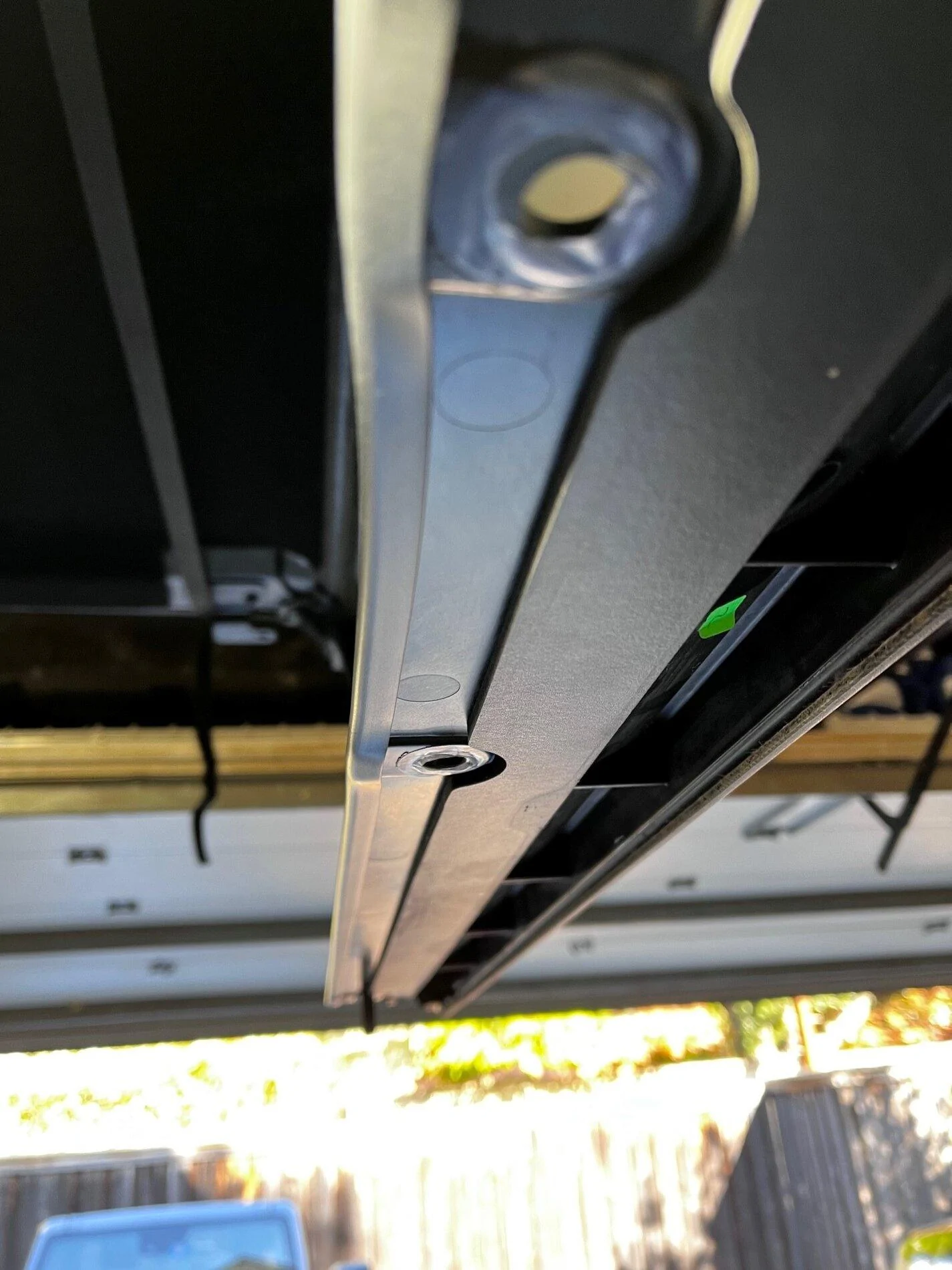

When removing or re-installing the MIC top, the inside edge is roughly finished and can scratch your roll bar.

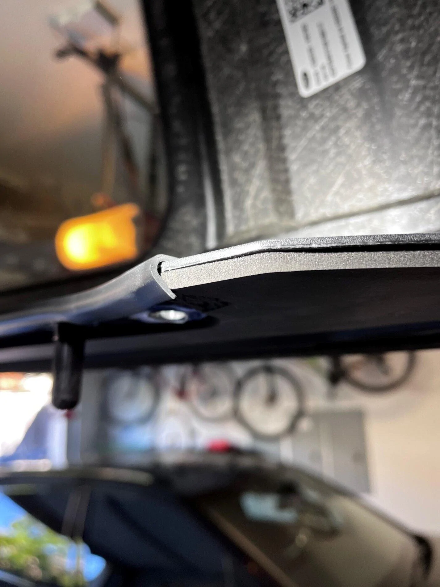

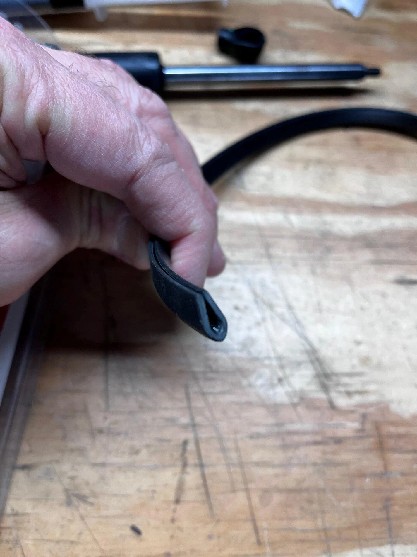

I measured the MIC top inside edge at the rear (the part that was scratching up my rollbar at the c-pillar) at 3/16". The rest of the edge, however, was only 1/16". The stuff I bought was too narrow at the critical part near the c pillar (you can see in the pics how it is splayed open). BUT it stayed in place. I used a heat gun to warm it up and push it into place.
Here are pics of the product I used and the installed result. For what it is worth, I do NOT believe it will interfere with a proper top-to-body seal when I put the top back on (but I have not yet done that, so I guess I will find out).
