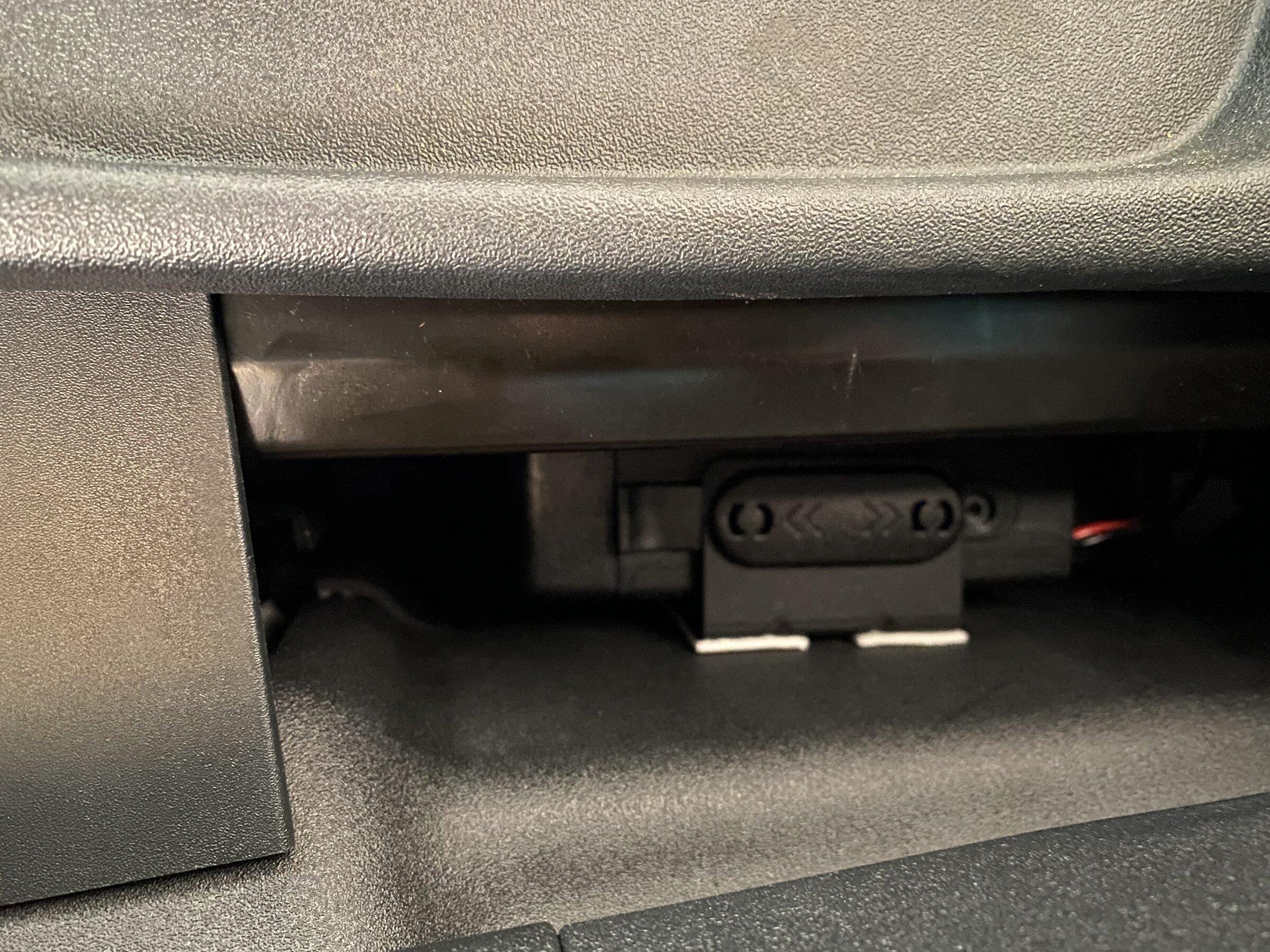

I was able to fit it above the glovebox, its tight but it fits. I'm waiting to get a proper mounting pate then I'kll take some pics

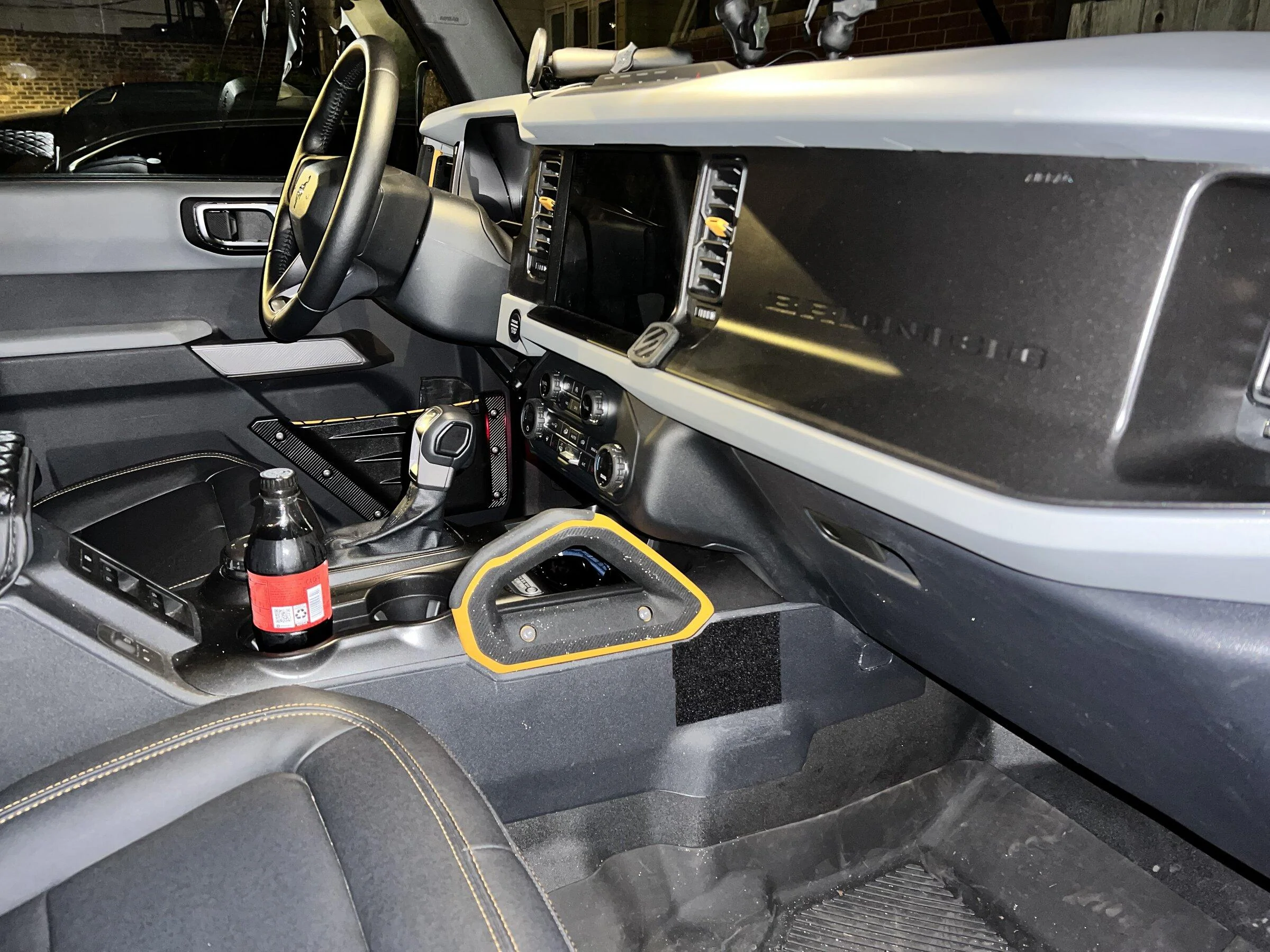

Can't wait to see it. I went out and looked at it today and the center console is definitely a no-go. I'm debating the area you are referring to or trying to stick it on the passenger side of the console via velcro. Not the clean look I was hoping for, but not sure about drilling into the outside of the console yet.

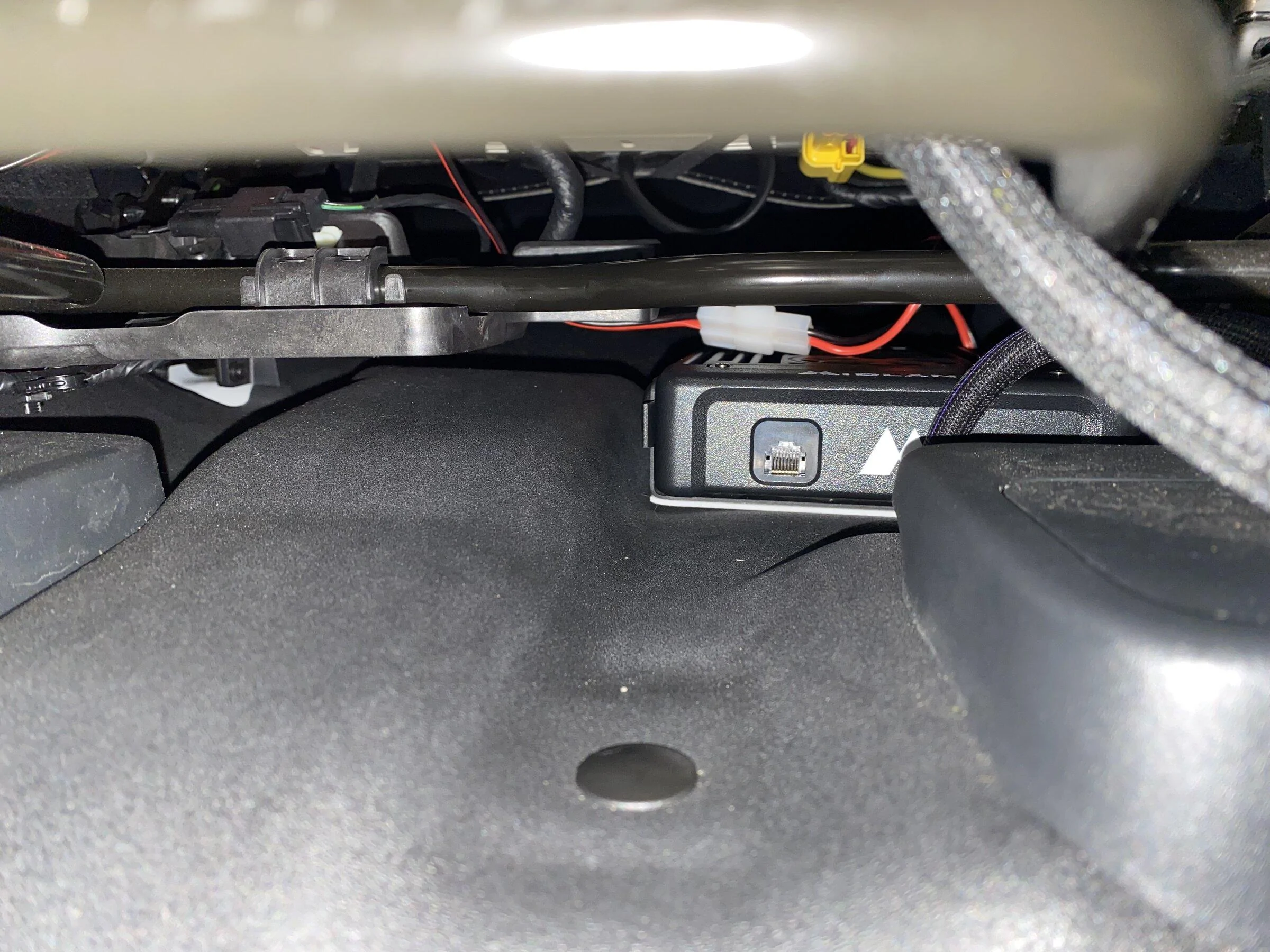

Here is where I mounted mine and it fit perfect. Almost like the demensions were made for this unit and the cat5 port fully accessible. I just used some double sided tape as I was not sure if I liked it when I stuck it there. I still need to route everything and zip tie.
Ford Bronco Midlands MXT575 Mounting ideas??? 050F01C2-E66C-45BE-A1F3-16A3C6DB49C4
That's where I have the WeBoost mounted, lol.

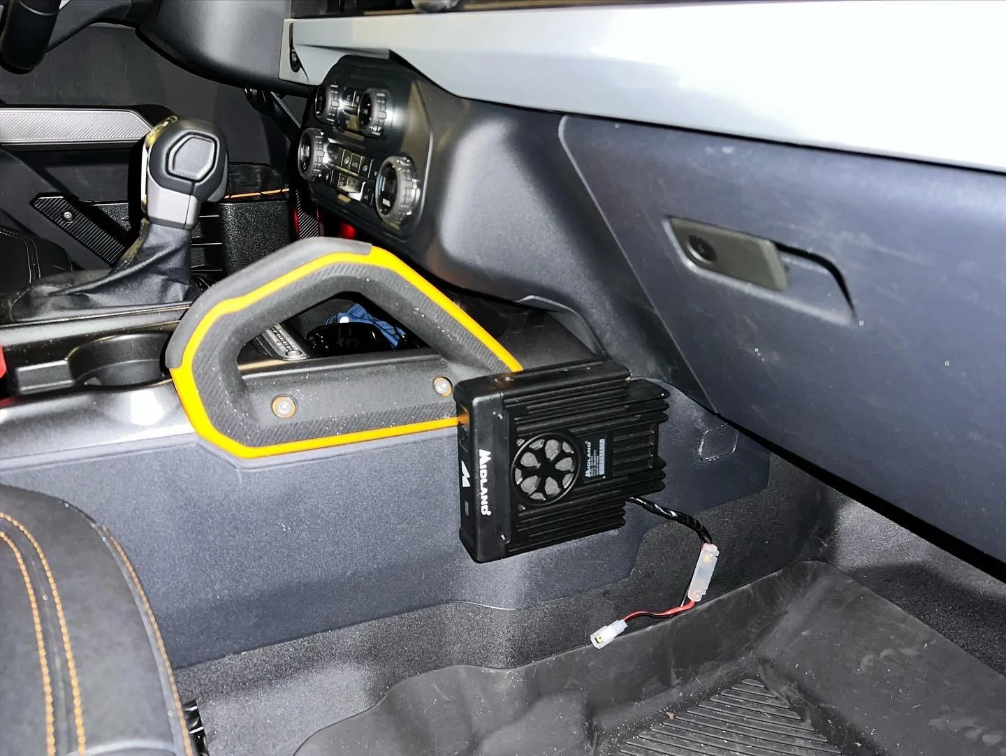

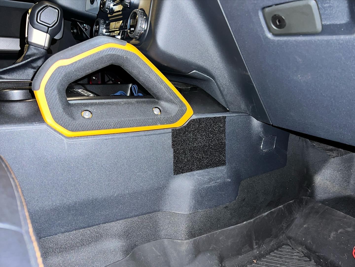

I ended up on the passenger side of the console for now. Hope to finish wiring it over the weekend. Not the cleanest look, but I couldn't find anything above the glove box I felt comfortable with.

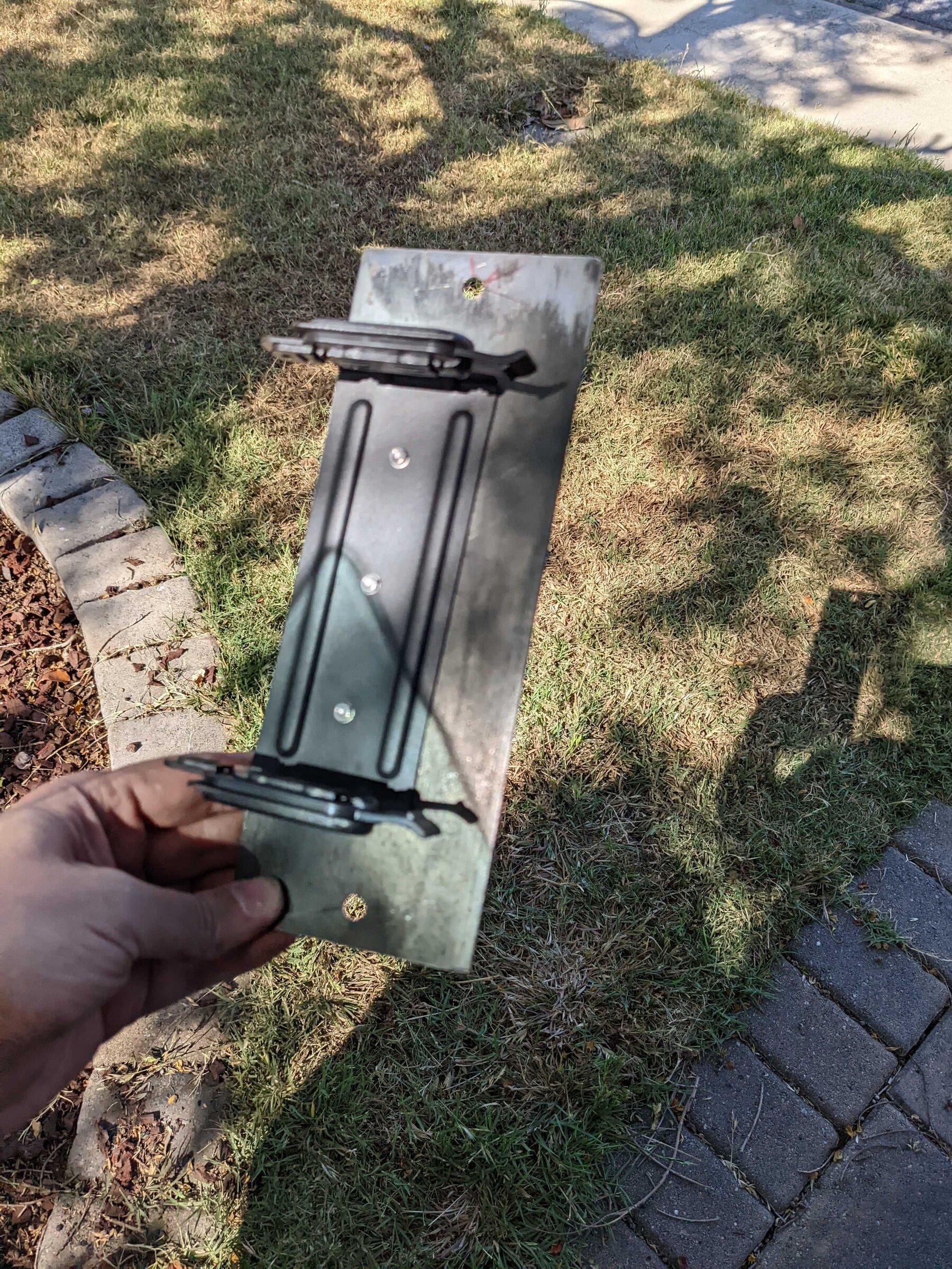

I finally got back to this today. I ended up making a plate from some scrap metal. 3.5" x 9.5" w/ 2 1/4" holes to mount to the rails above the glove box. sorry, no pics of it installed, since you really cant see anything anyway.

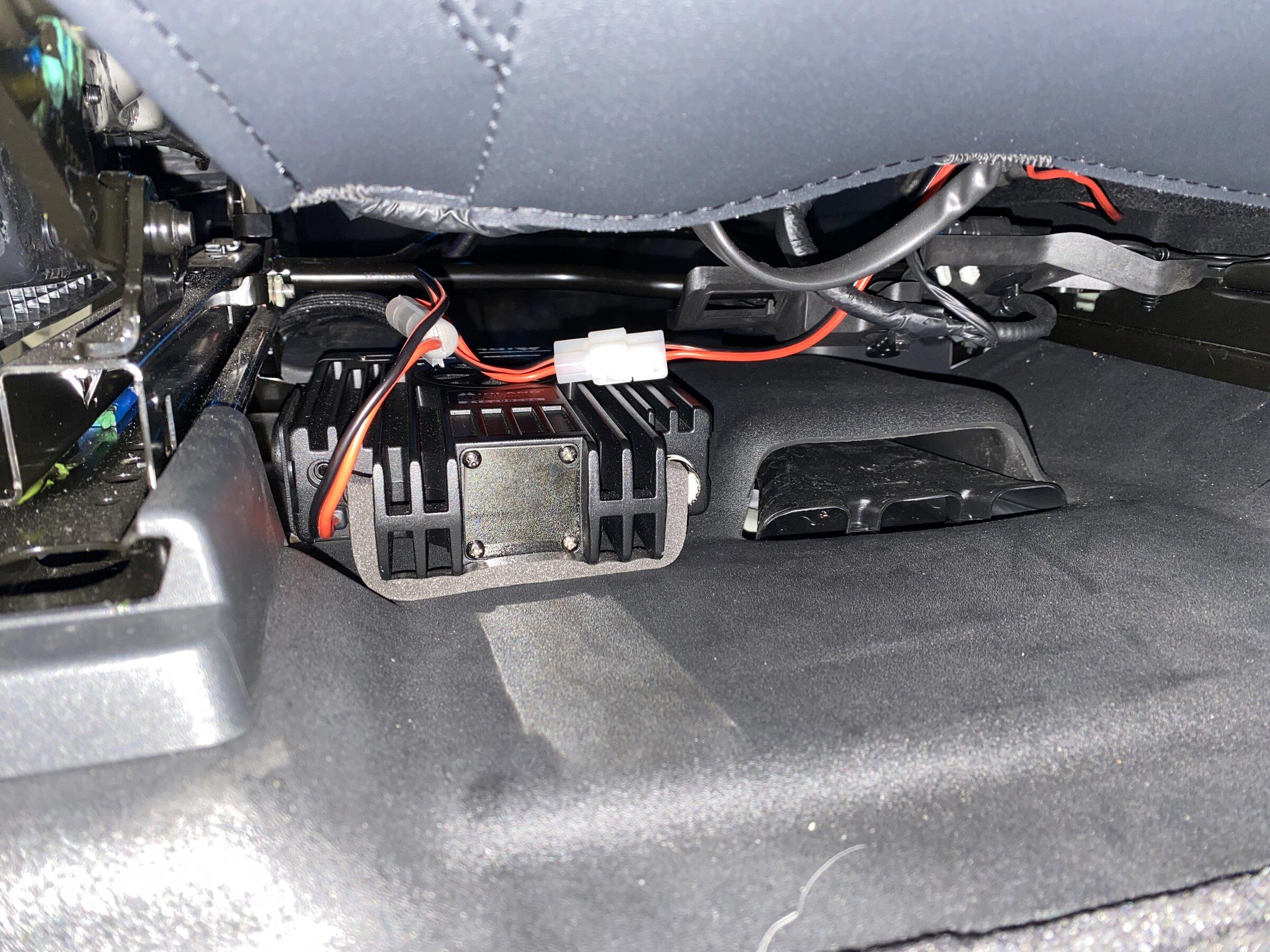

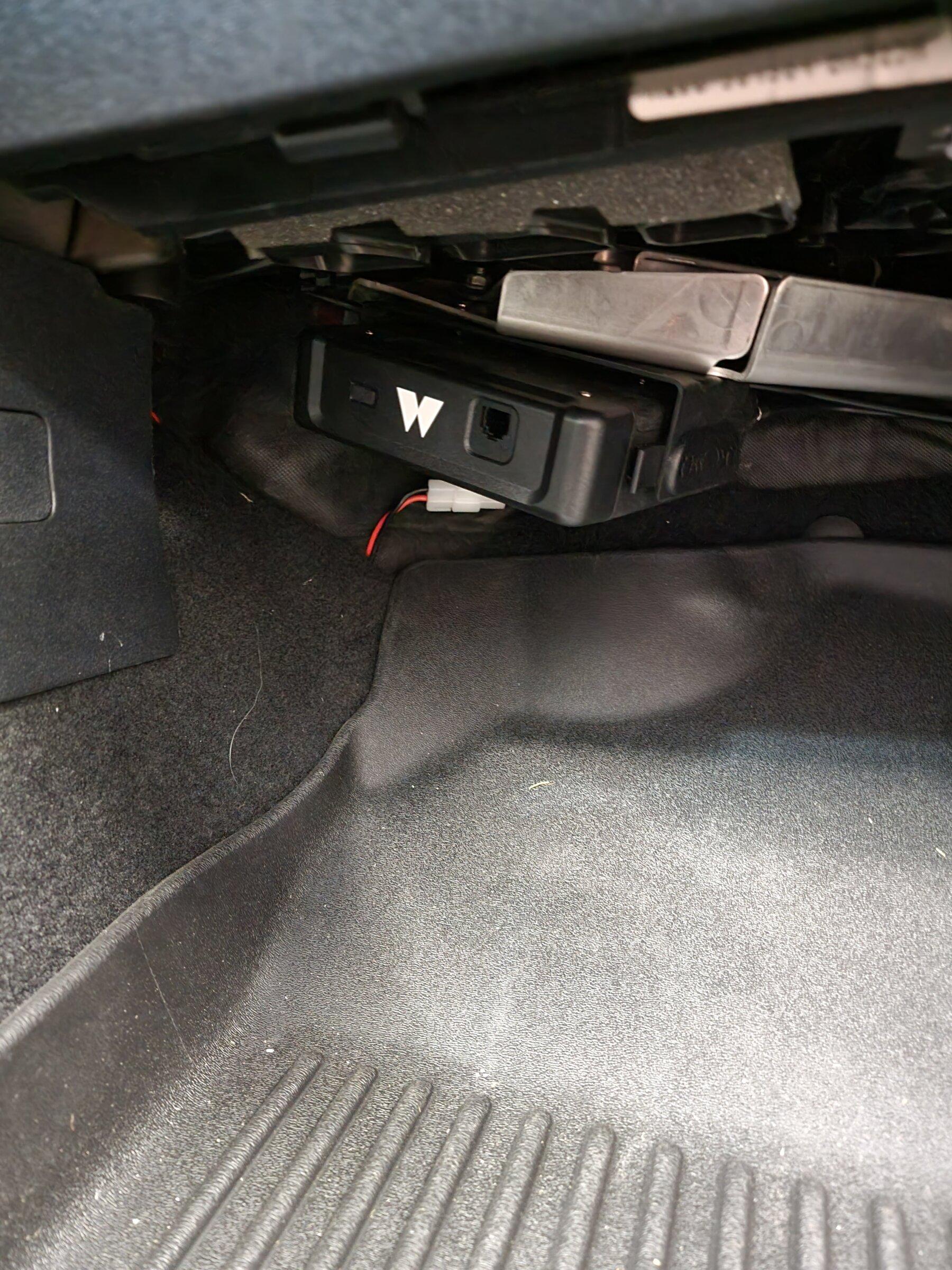

Settling for under the passenger seat for now.

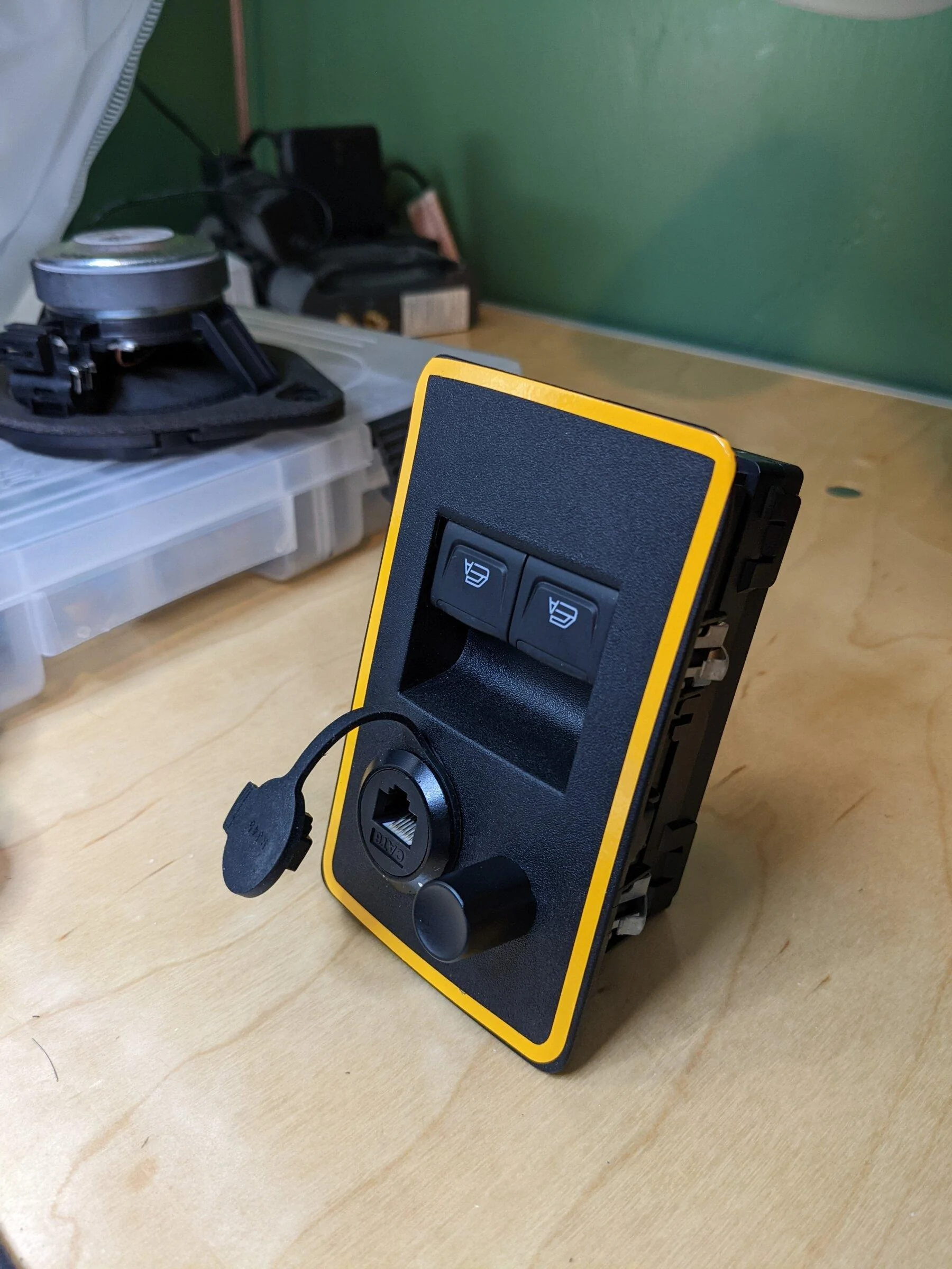

ok this turned out way better than I expected so I had to share. I'm mounting the remote cat5 connector near the window switches. The other dial there is for my sub-amp.

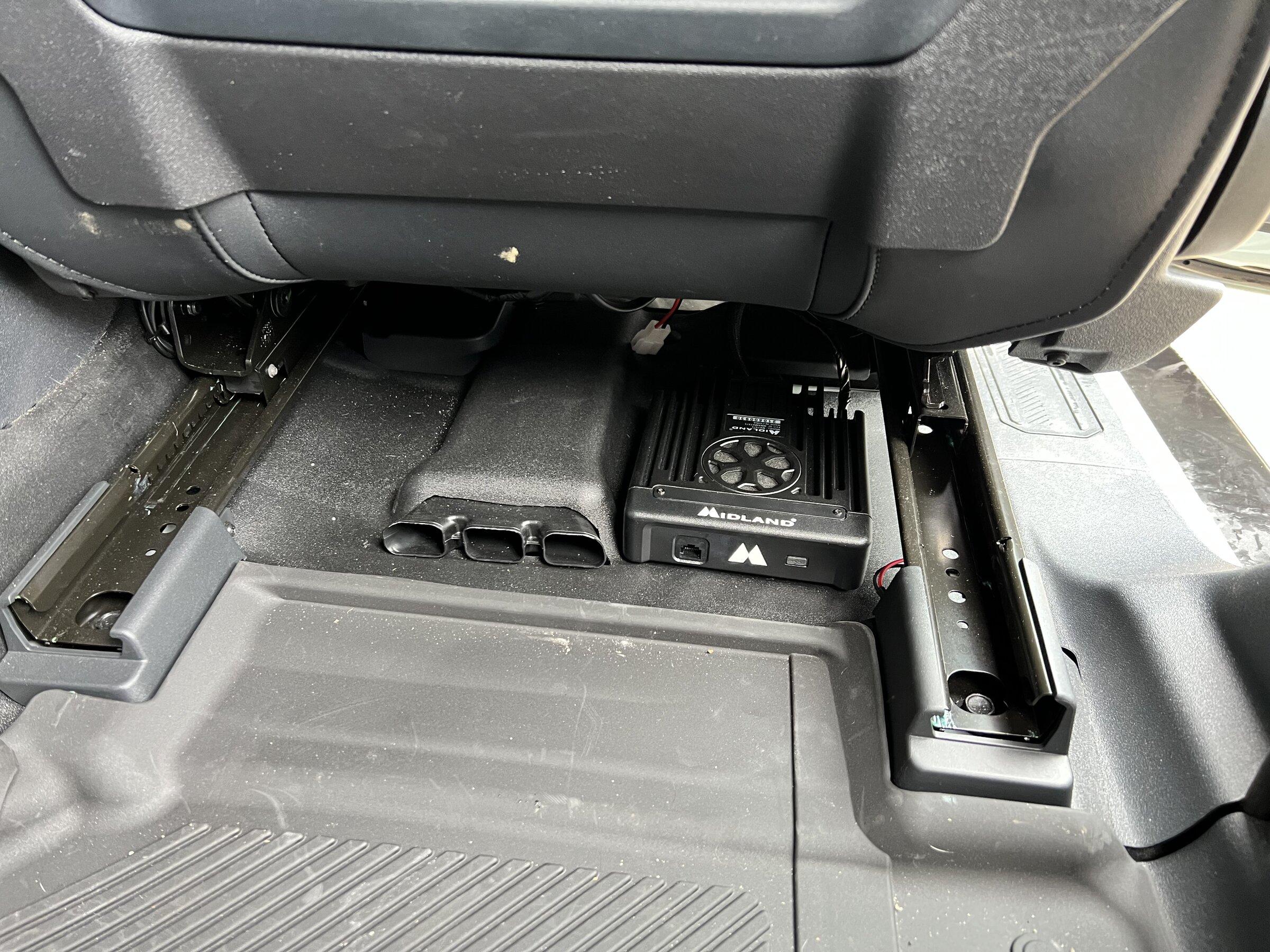

Mounted my 575 up under passenger dash. Drilled a couple of holes in a metal shelf/shield and mounted the bracket. Easy access to plug mic in and speaker is down firing into the footwell. Have both speakers active, mic and base, plenty of volume.

Where did you source the power?
