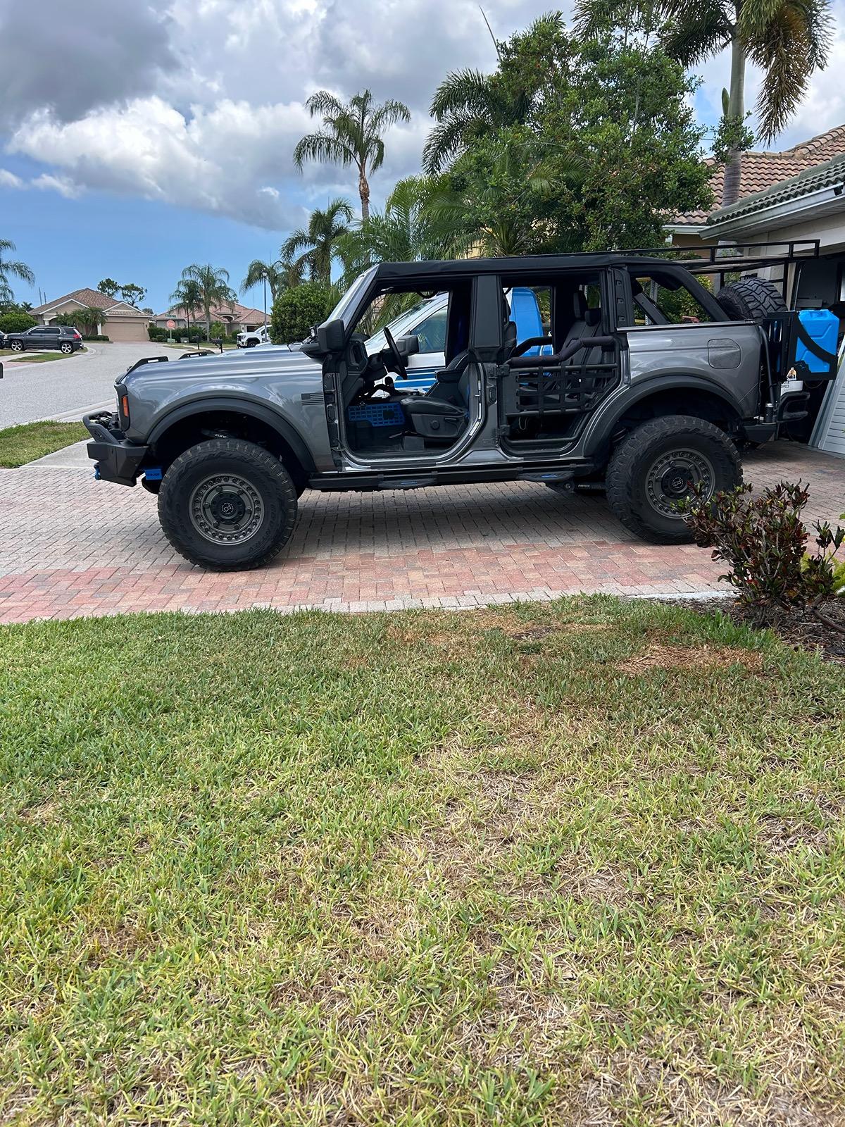

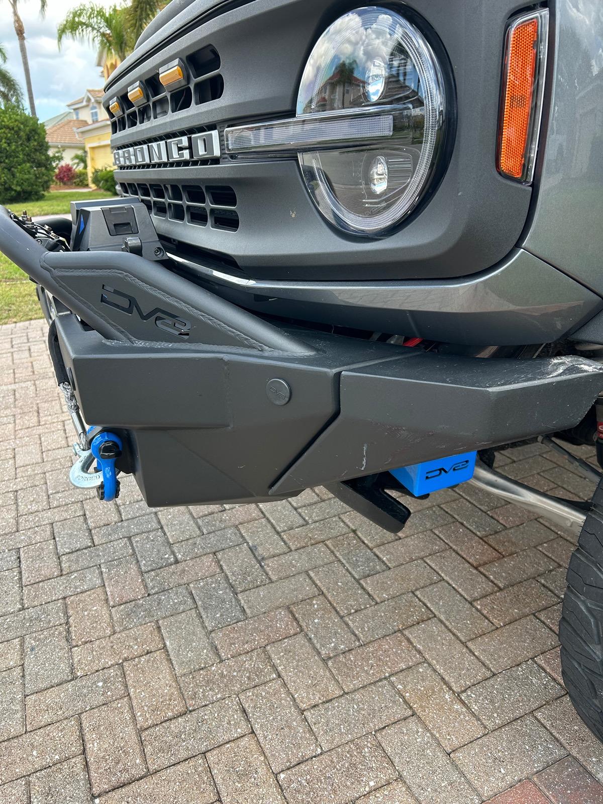

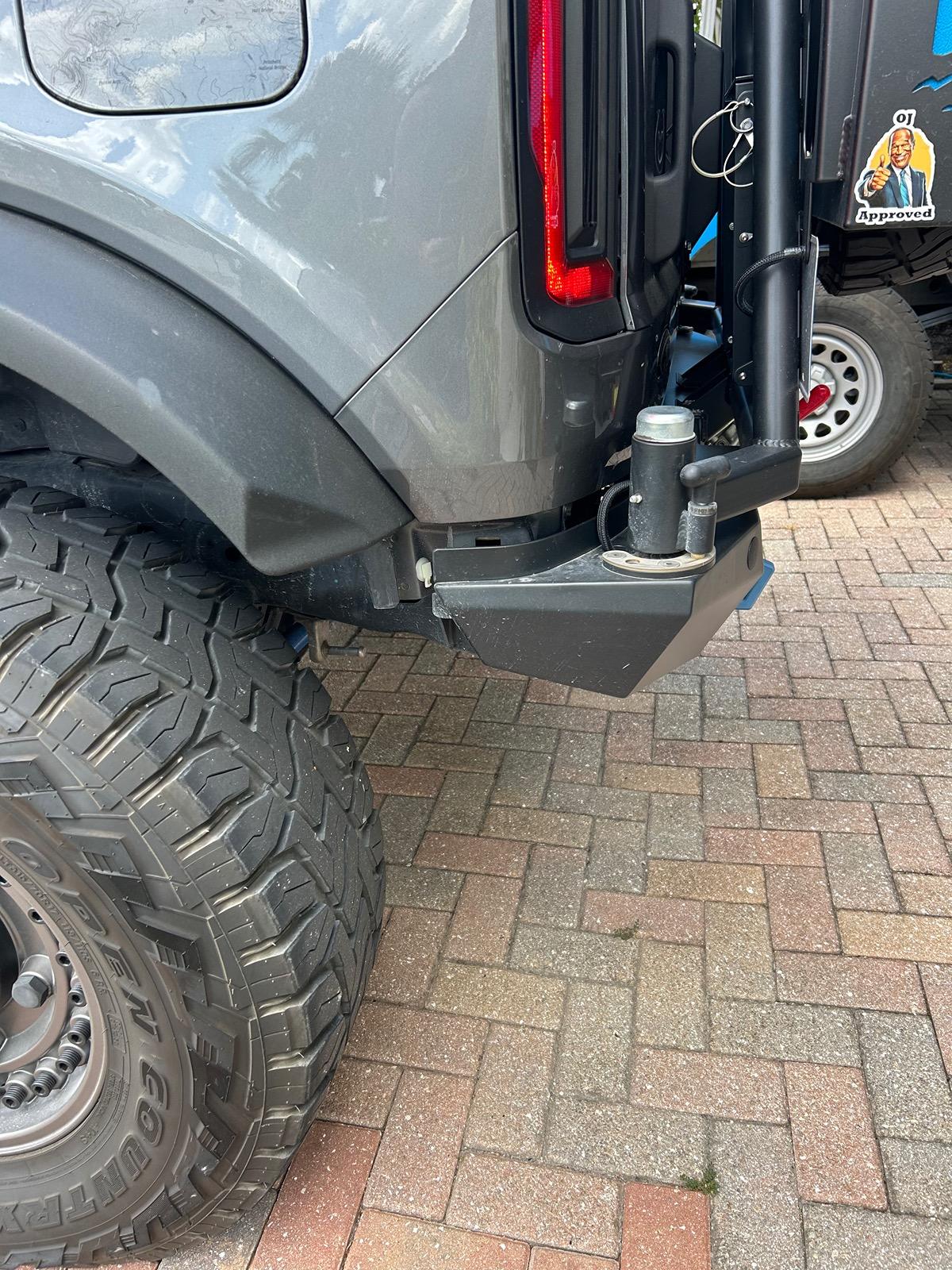

I put 1/2” spacers on mine just to get the winch wires to not be smashed going into the engine compartment. I can take pics later today and post them

Thanks! I'd appreciate that. Where did you get the 1/2" from? I was just doing a search and found some on Etsy but not too sure about that....

Well as I look at past purchases it didn’t come from Etsy or eBay like this YouTube video link says I’m going to include. I haven’t searched this forum but for the most part everything I have for mine has come from someone suggesting or advertising on this forum.
Ford Bronco Mikellis Body Lifts IMG_5500
Ford Bronco Mikellis Body Lifts IMG_5502
Ford Bronco Mikellis Body Lifts IMG_5499

Awesome thanks for the pix, nice build, love that front bumper!! I saw that video too, appreciate the link! I tried to look up that place he bought them from but I may have typed in the wrong thing as I couldn't find it. It doesn't seem the 1/2" is too noticeable.
