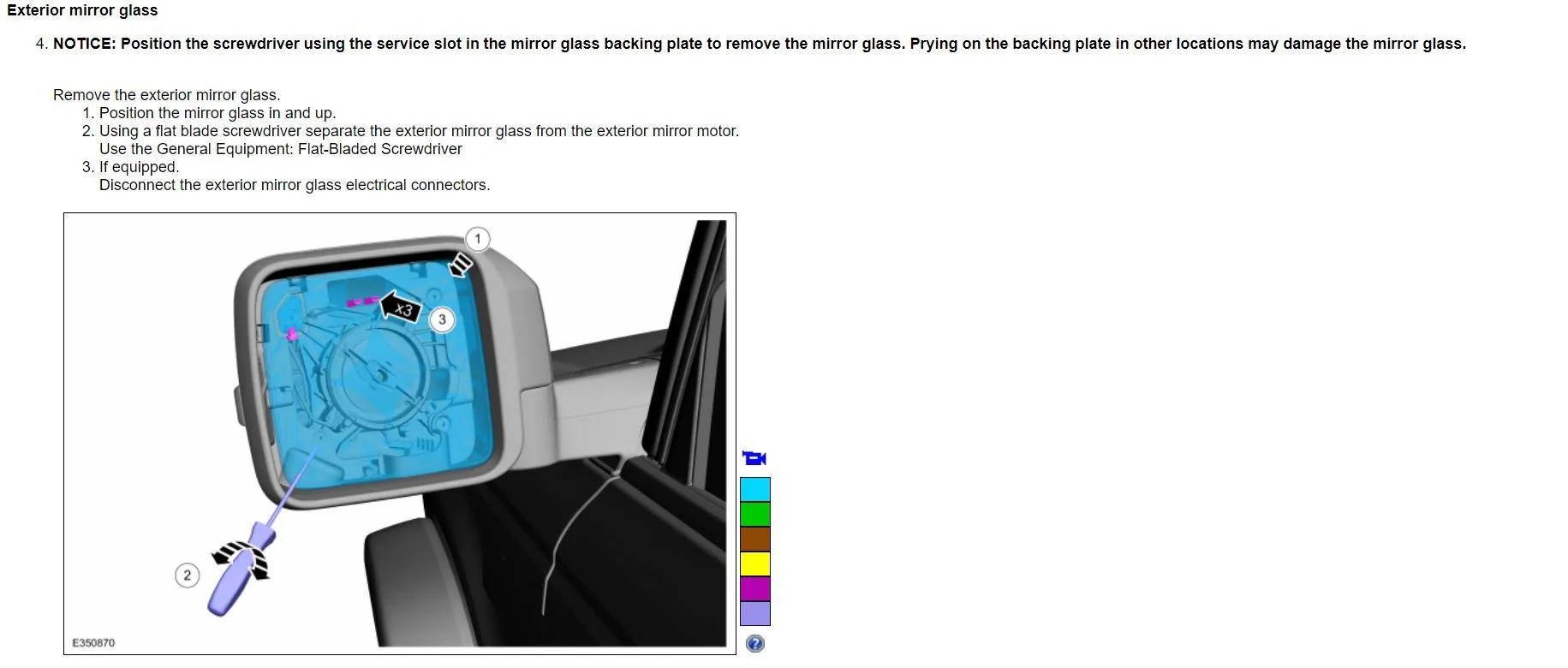

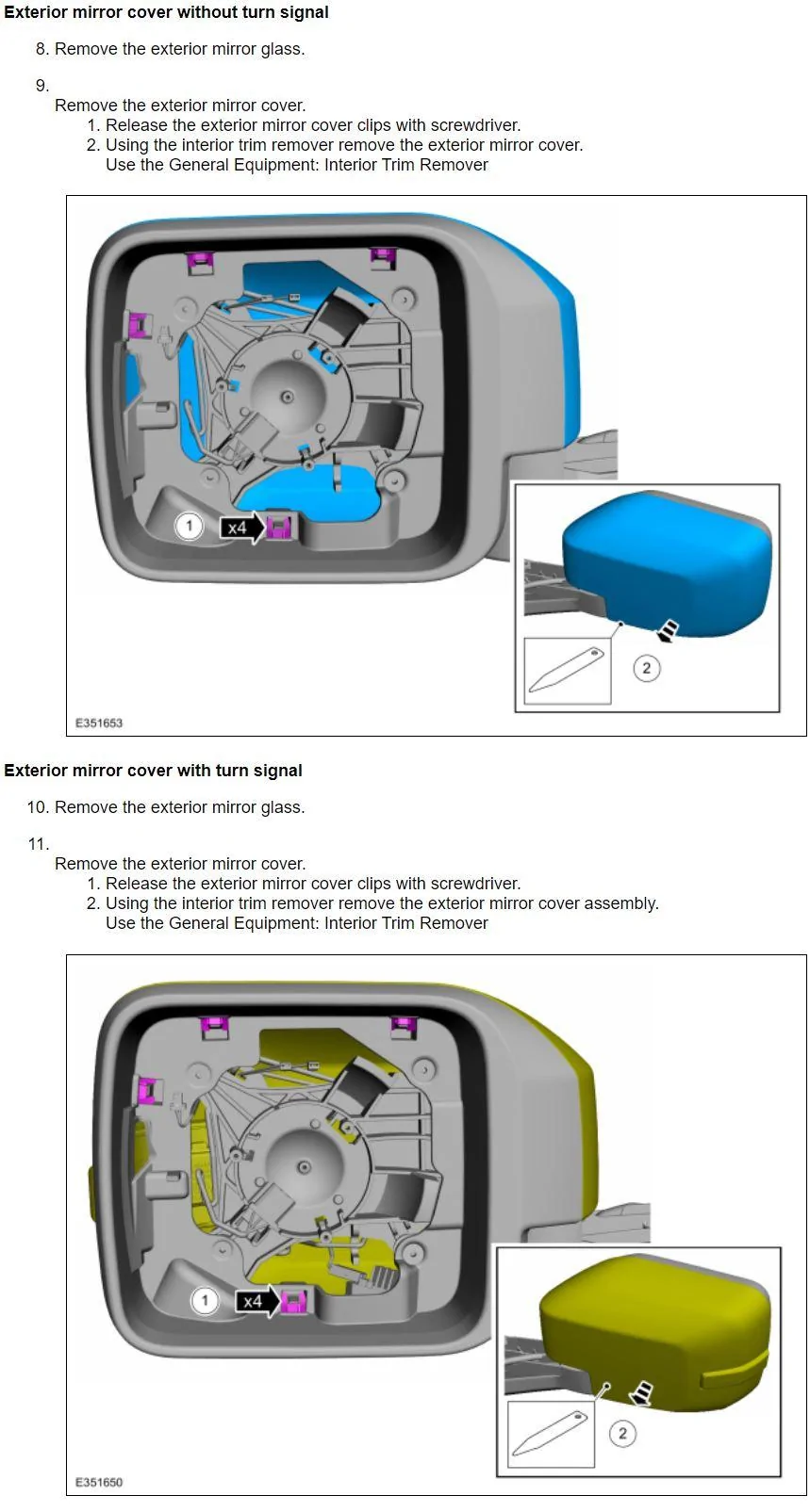

It would help to remove the glass so you can actually get to the tabs but it can be done without doing so. Procedures below for both options
Ford Bronco Mirror Cap Removal Instructions w/ Diagrams capture-
Where are you getting the schematics?

Appreciate it! That cleared up everything.
Funny... I checked Mitchell and AllData but never thought to look at the Ford Workshop

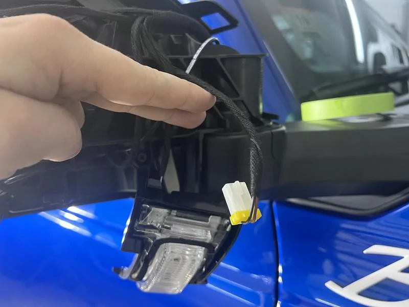

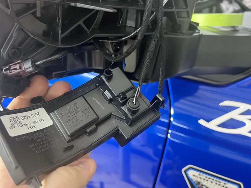

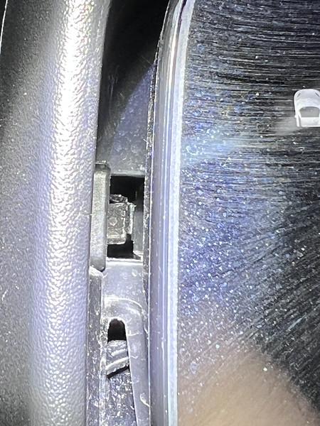

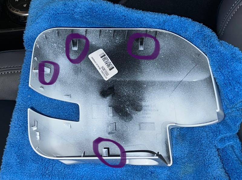

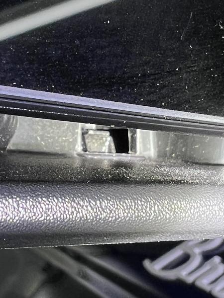

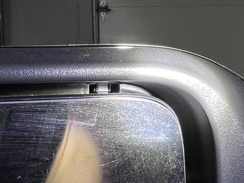

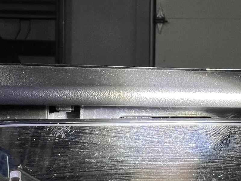

So I just wanted to update with some pictures from this install. I'm working on a video from the other side, and I'll try to have that up shortly.
It really is as straight forward as the Workshop diagram shows. You can pull the glass, but you certainly don't need to- I did not. Here are the same four points shown in the diagram:
And from inside the housing... Shown in the following order: Top inner corner, top outer, side, bottom
Originally, I mistook the center tabs as locking points for the mirror cap. They are actually tabs for the marker light, so you don't have to worry about those right now. Just go in with either a thin flathead screwdriver or a good pick and pull up on the locks for each tab. When you have it all the way up and resting on top of the tab it'll click. From there I started along the bottom by the floodlight- you can use a non-marring pry tool or just your hands pull the cap away from the housing. I then moved to the top and lastly the side by the side spotlight. It'll come free. From there you can unplug the flood light (or just unclip it and remove it from the housing), unclip the sidelight and let it hang and swap your caps. That simple.
Flood light plug:
Spotlight:
Ford Bronco Mirror Cap Removal Instructions w/ Diagrams i-vjMp3r2-L
Flood light plug:
Spotlight:
