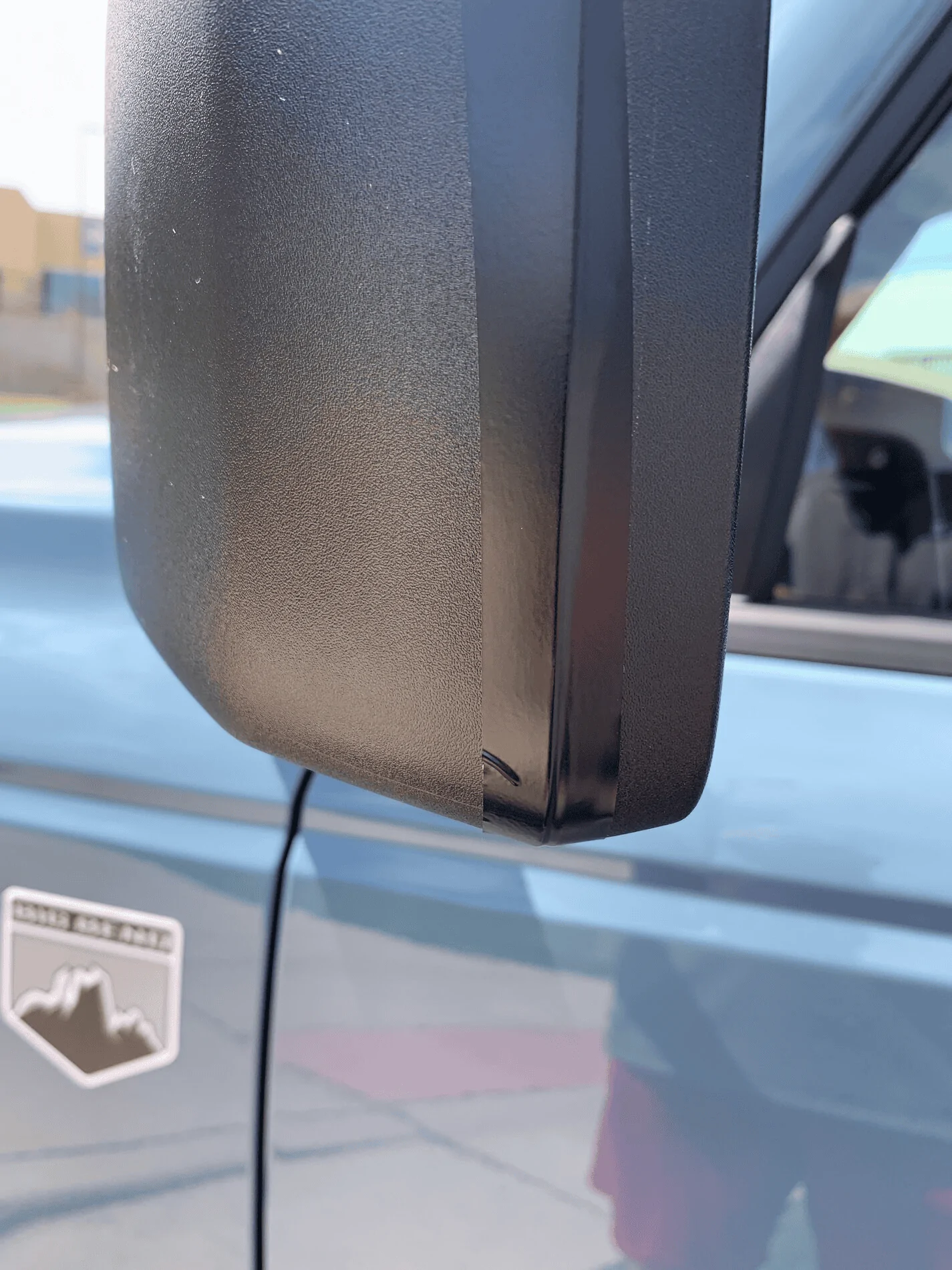

I posted about this before, but has anyone else that's taken delivery noticed a very loud whistle noise coming from the drivers side mirror?
My Bronco is a Black Diamond four door with the MIC top. The whistle is loud. Loud enough that it's disturbing when the top is on and the windows up. With the top off and the windows down, you need to fold the mirror in if you want to hear the radio clearly or have a conversation with anyone in the vehicle.
As I mentioned in an earlier post, if you place your hand on the bottom right corner of the mirror housing the whistling stops.
Has anyone else that's experienced the issue experimented with a fix? Maybe foam behind the mirror?
I'll try to get a video tonight so others can hear/see what I'm experiencing. I really like my Bronco and I know there will be a fix for the whistle soon enough, but I'd like to hear from others that have the same issue.

Was it you that experimented with electrical tape?
I remember seeing that just coving the seam between the two mirror shells resolved the issue.
Not a long-term solution, but a good indication of where the problem lies.

Need something on the corner of the mirror to create better aero. Something similar to the little canards or fins above the back window of an evo.

I drove this Bronco and it had a whistle noise coming from the mirror. I know that it was the mirror because it didn't do when you folded in the mirror. Not a real fix but narrowed down where it was coming from. So this not the just a problem with one Bronco.

If the tape works, I'll just wrap the mirrors in 3M vinyl. Small enough job that I should be able to pull off without yanking out to much hair.
Vortex generators are what they're called
