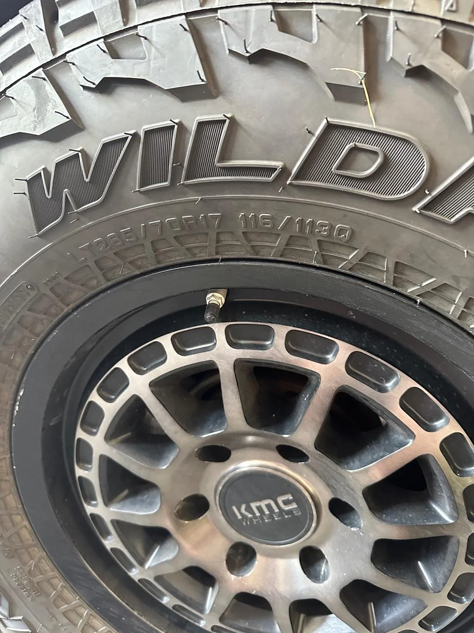

Front Tires
LT285/70R17 116/1130 Load range C

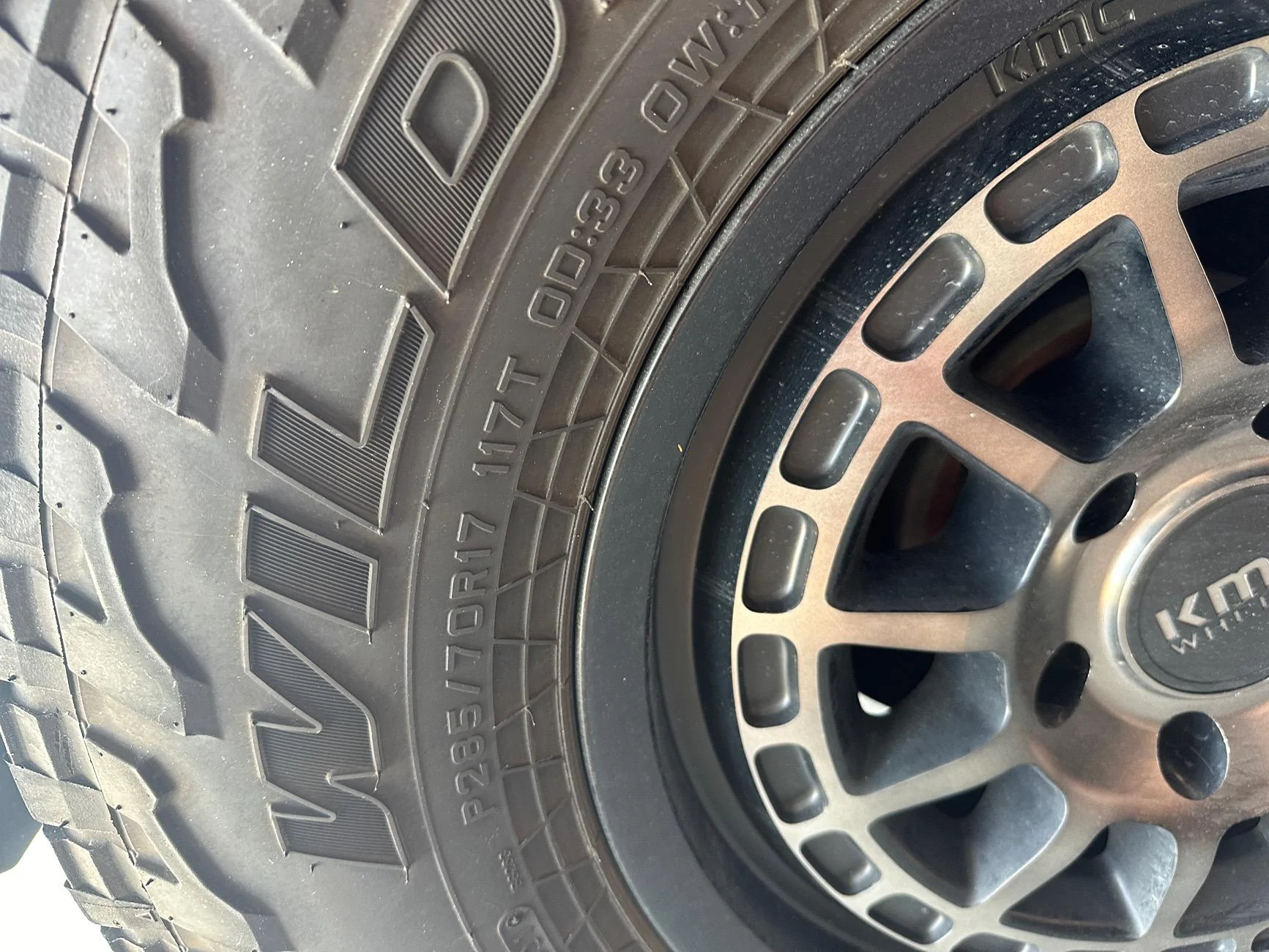

Rear Tires and Spare:
P285/70R17 117T Standard Load
Ford Bronco Mismatched tire rating IMG_2667
Is this an issue? I wasn’t up to speed on the different load ratings etc when o bought it and missed the difference.
If it is an issue, which ones should I match?

I would probably just make sure to keep the matching pairs on the same axle. (Front or rear). But it would be curious to measure circumference of each with a flexible tape measure or use a string. They do need to have the same roll-out especially if you use 4A on the highway.

I went to Falkens' website and discovered that while they are the same OD 32.8 the P tires are 50 # each the LTs 60#, so definitely keep them on the same axle, which messes up your rotation options. Oddly the P tire has a higher load carrying rating than the Lt. I might see if there was a way to swap out for the ones you prefer. I'm a big fan of LT tires for puncture resistance and sidewall strength.
