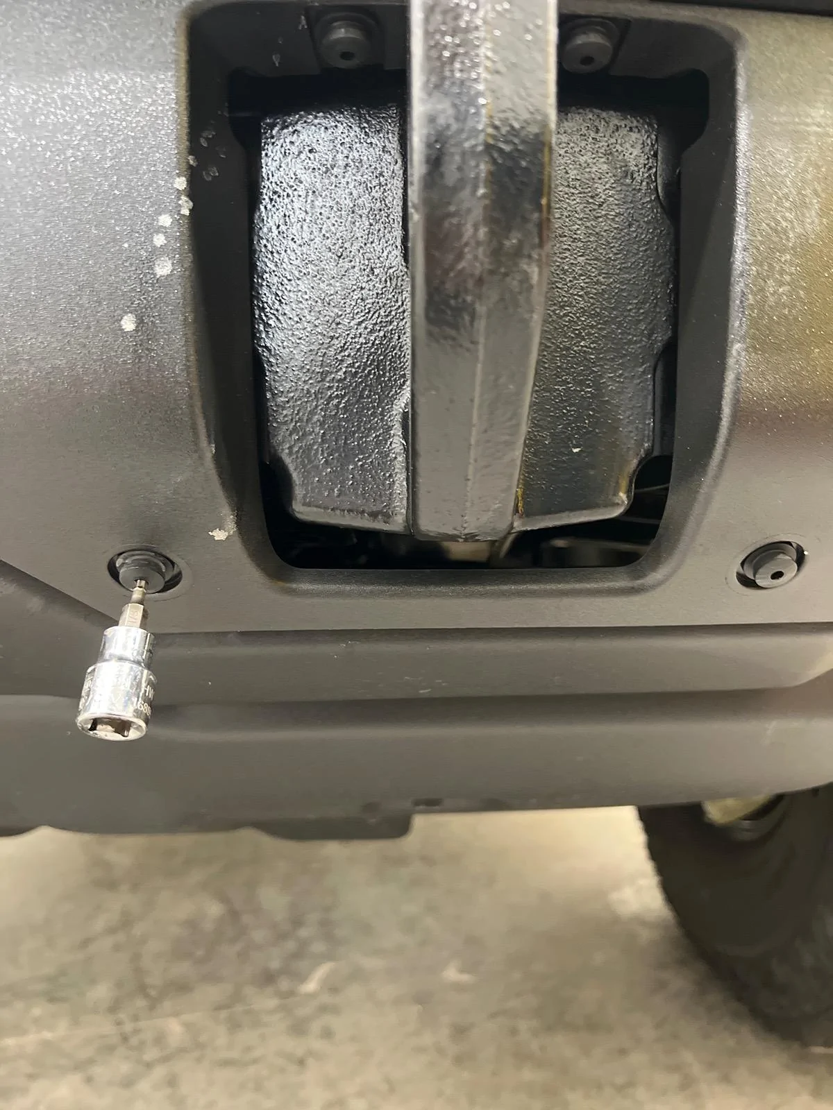

Can anyone advise what size hex screw I need to remove these modular bumper screws? Thank you!

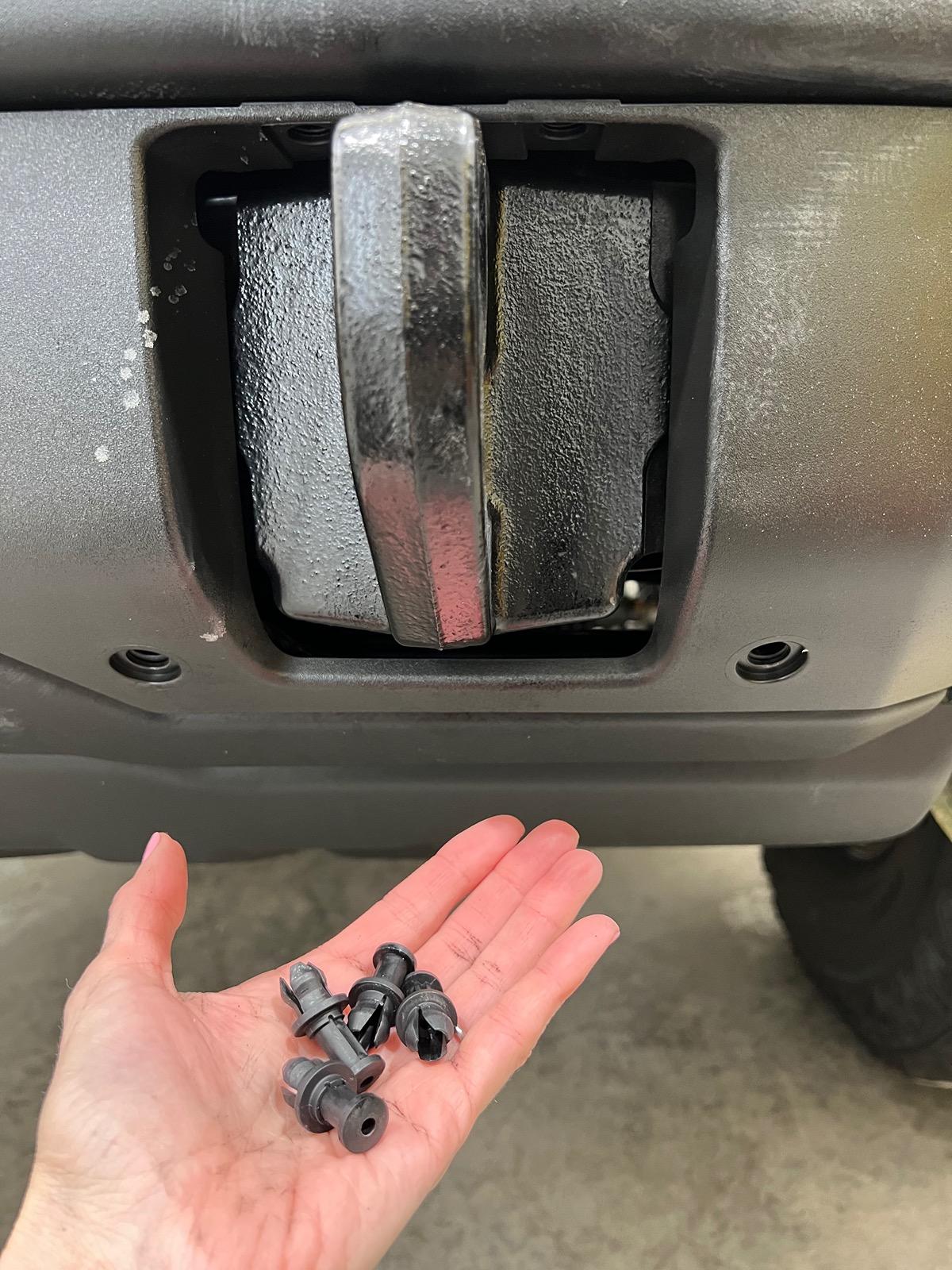

Those are push pins, doggy. Use panel poppers to get the middle out first then the rest of it will come out.

Those are actually pop out fasteners. You can pull on them hard or use a plastic pry tool to get them out

Somewhat random, but related question: Does anyone have a good source to get a set of those pop out fasteners? The modular bumper I picked up came with the plastic cover panels, but no pins.

Any local Ford dealer
Or you can probably buy them online.
Part number is W720521-S300
