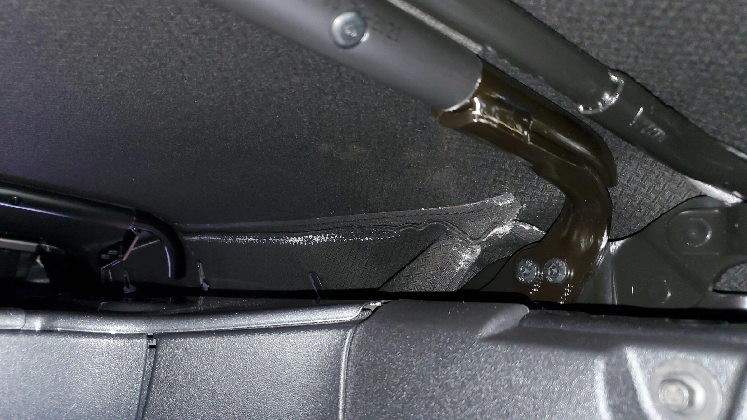

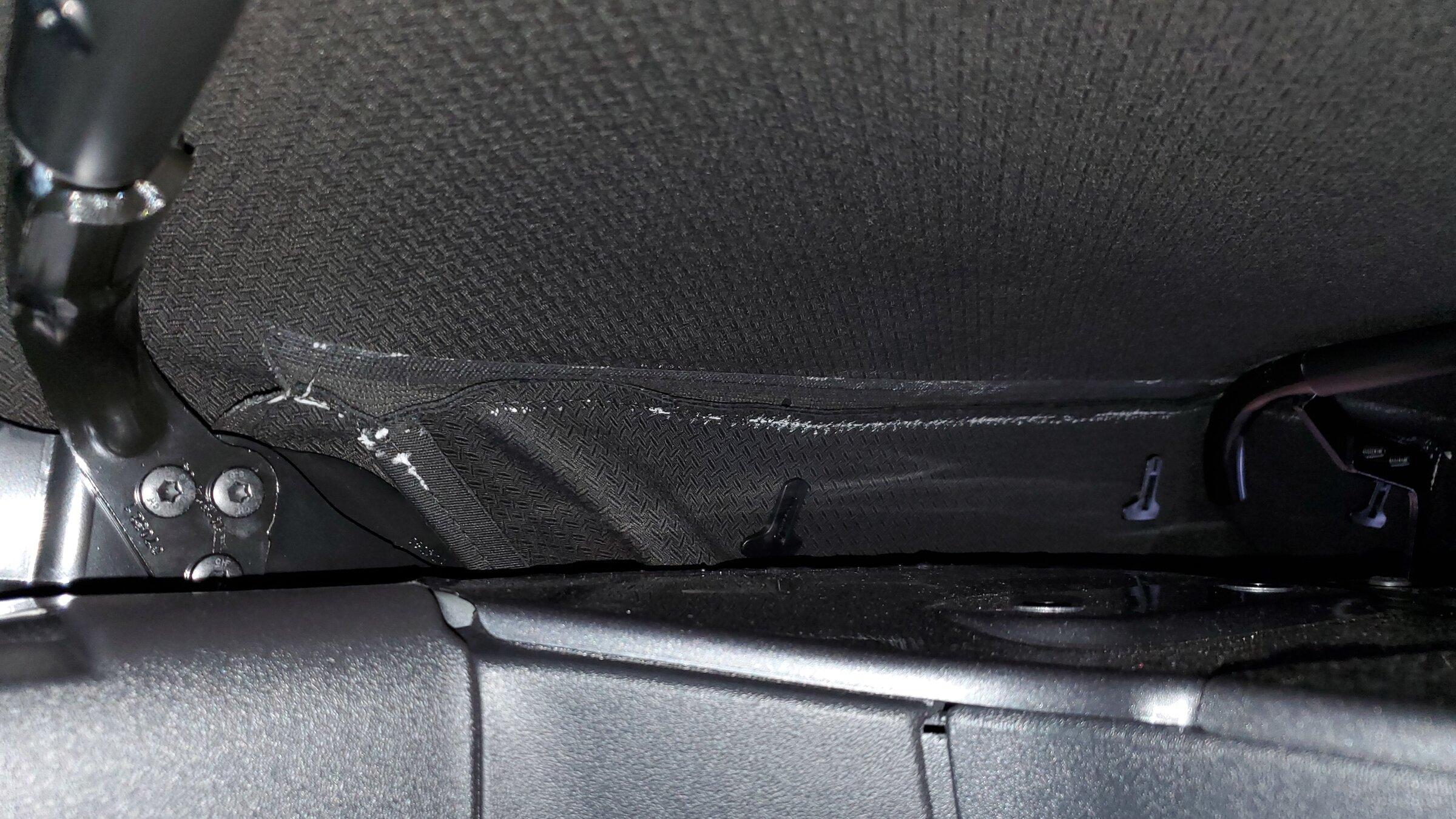

Hey All,
I have just over 2k miles on my 4dr black diamond, that I picked up the beginning of December. I wash the bronco almost as much as I take showers, but I also live in Oregon on a farm, so it's just the way I try to keep it new. I also don't have a garage, so it stays outside in the rain. I haven't scrubbed the inside of the soft top, because I haven't opened it up or even really got dirt inside. I've washed out the floors 2x with warm water, but dried it right after too. That mud comes out so easy. Just went to check on it this morning and noticed this white substance on the seams over the cargo area. It looks kinda like mold, but seems almost crusty when I touch it. It's not very thick, but seems like I'd have to scrub pretty go to get it off. Any ideas or suggestions?
I did attach a couple pictures of it in the snow, just for some context of what it's been through.

I'm in the PNW as well. Just looked at my soft top - have the same white "dust". It's only on the side windows and only on the threads. I don't believe it's mold - I think it could be a wax coating o the thread used on the side widows. I don't see it on the back. not sure your location - I've had snow and lots of rain and mine sits outside as well. I wiped/brushed it off and I'll look again in a few days.
In all my life - any mold I've seen that wasn't organic as in grows on food - has been darker in color almost black. Don't think it's mildew either as that's usually greenish in color.
I'm watching this thread and will post again in a few days.

It almost looks like salt creep. With all the salt that is put on the roads here in the PNW I would imagine that road spray would be getting on the top and the residual salt is simply creeping through the fabric. Anyone with a salt water fish tank knows exactly what im talking about.

I work in the aircraft industry and have seen this occur on headliners of multi-million dollar business jets. Moisture can cause the chemicals that the headliner is treated with (usually a flame retardant) to leach out and when dried create white powder residue, very similar to what you are seeing. Just my two cents worth.

Salt 🧂 for sure.
