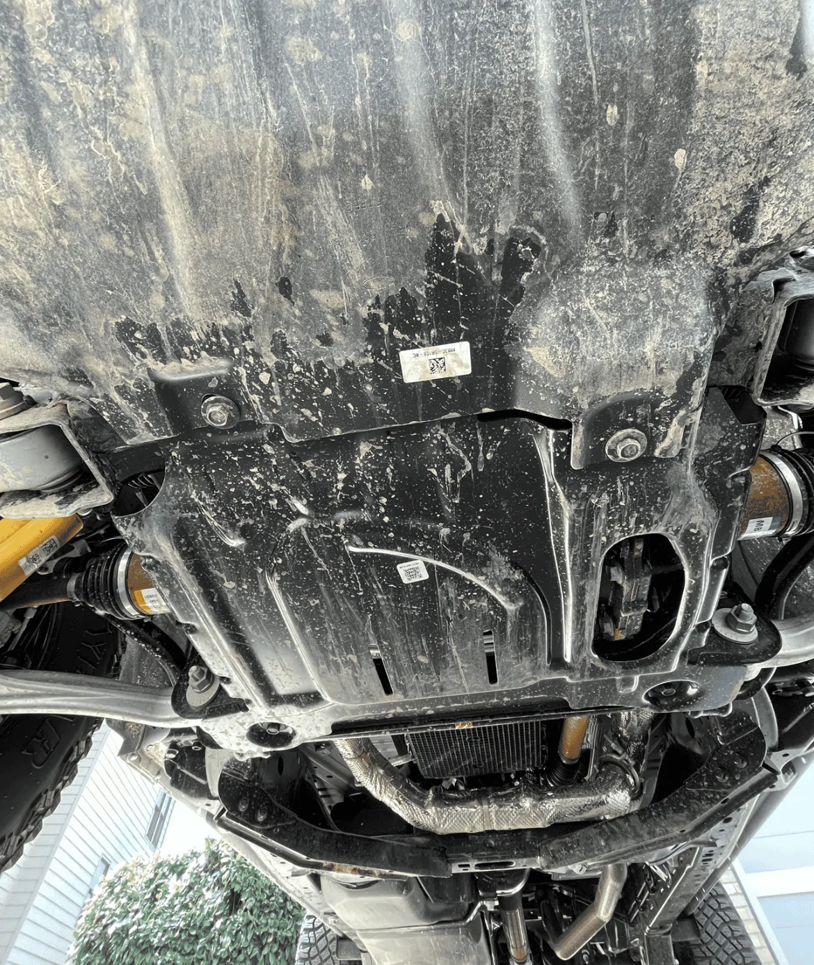

Yeah. Until I got my bronco and looked I was unsure. It’s sold like bumper and front bash is all that’s included, but that first skid behind the bash plate (engine skid) is definitely included

Thanks all. Gas tank will probably be my first add and the transfer case skid.
That fuel tank hang down is ridiculous (really my only complaint with the Bronco), I can't believe Ford didn't include a skid on the four door (my 2 door has one). Assuming you have a metal one on the engine (mine is plastic) you are correct transfer case would be next. The transmission is tucked up nicely, but has a plastic pan that may be vulnerable to a rolled rock or log. I don't care for any of the current transmission skids as they are mounted lower than necessary. One with a rise in front of the crossover pipe would be nice, it's on my fabrication list.

Yep, but comes with the mod bumper
Oh I wasn't aware that the front skid actually continued down below far enough to cover the engine. I thought it was just enough to cover from the bumper to front of the engine... Basically like a typical plastic air dam would do.
It’s a 2 piece design, but they come together. Probably wouldn’t be a bad idea to upgrade it though.
technically it’s two pieces. The front bash and the engine skid. Both came with my with mod bumper. If you bought the “complete” 4 piece skid set from ford, these would be two of them. The others are the transfer case skid ($50 shipped from ruxer) and the fuel skid (assuming you are buying the 4 door set; 2 door set excludes the fuel skid as 2 doors already have it)
