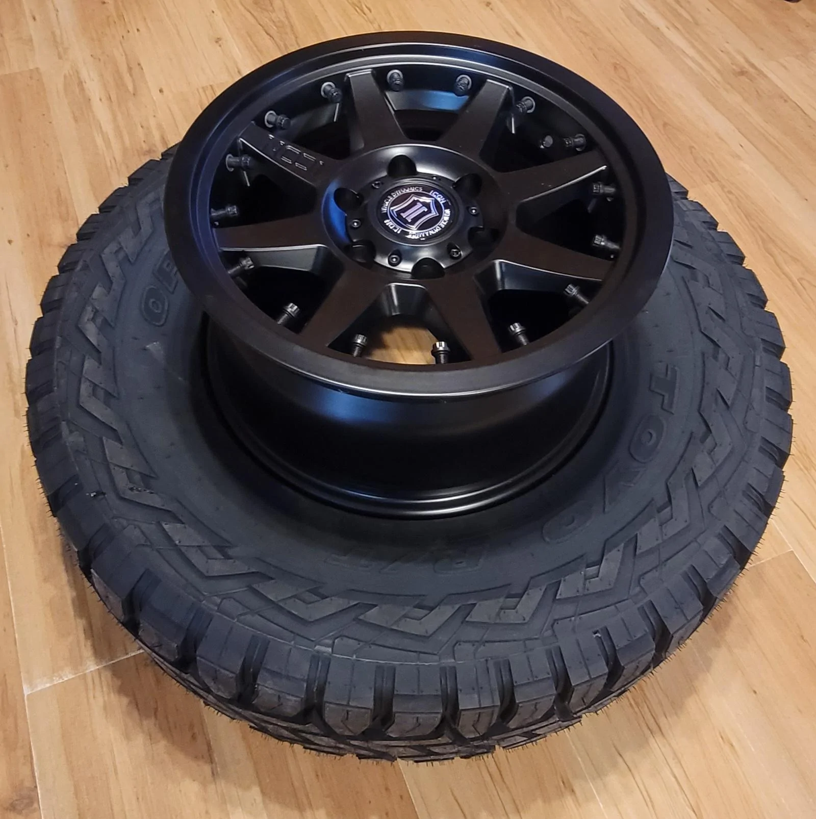

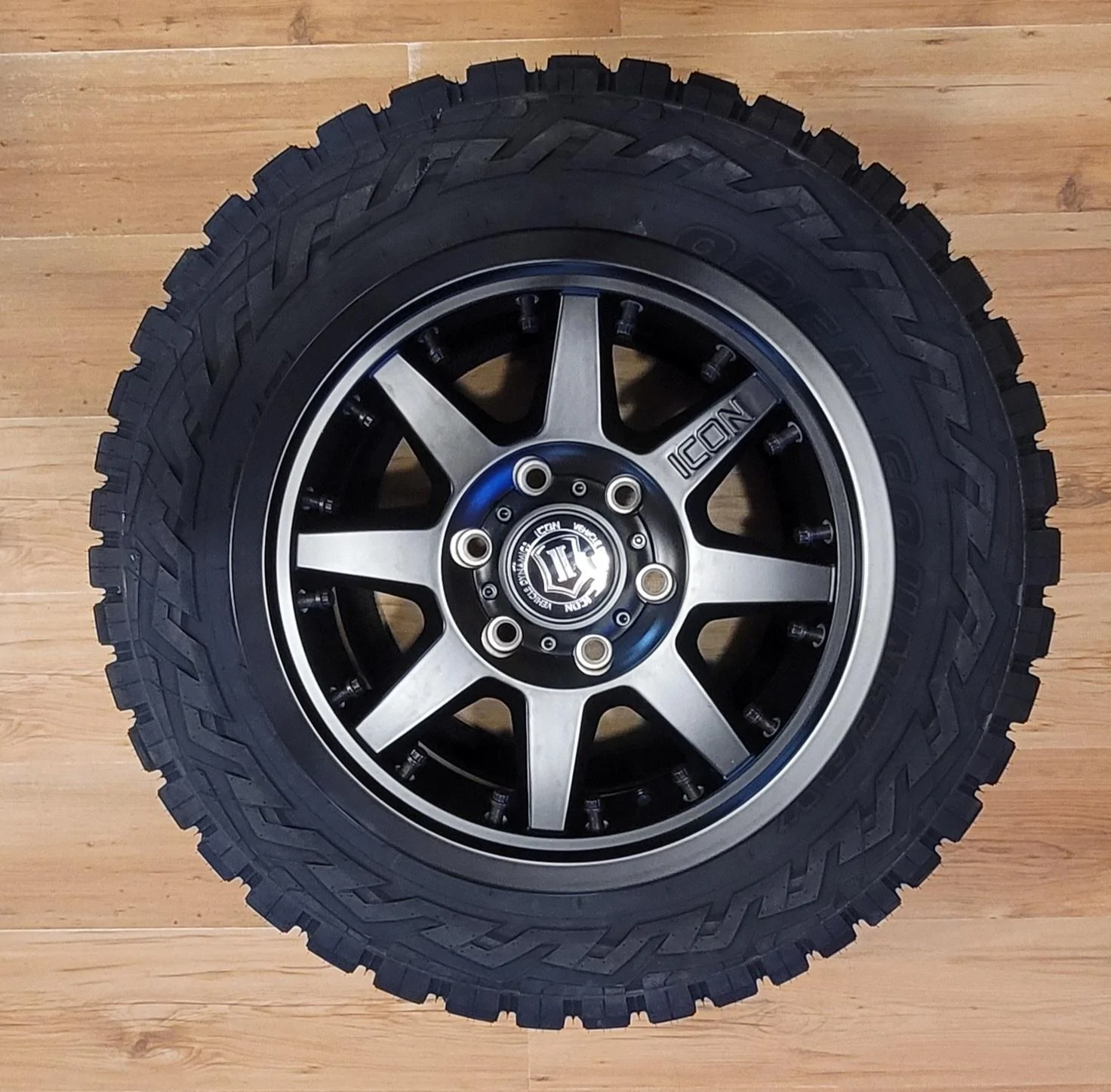

Ordered 5 Icon Rebound Pro 17x8.5 +25mm offsets along with 5- 315x70rx17 Toyo Open County RT tires from @Discount Tire . Unfortunately they wouldn't mount and balance the tires at their warehouse because they won't mount "beadlock" wheels. Has anyone else been told they wouldn't mount Icon Rebound Pro wheels??
