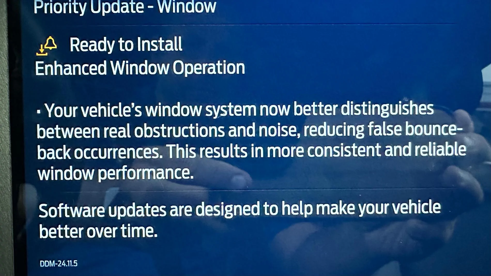

Looks like we have a much needed update coming Its about time
Ford Bronco Much needed "Enhanced Window Operation" OTA software update now installing IMG_4436

Finally, a fix! One of mine has been doing this quite a bit lately.

I am not sure what this patch is supposed to fix.
I think it fixes the issue that would happen when you're just trying to close your window and it thinks that it hit something so it opens all the way. It doesn't allow you to fully close your window when it happens and you have to do a window reset or restart the bronco to fix it.
I was hoping this was the change that dropped the windows automatically when you unlock the doors. Oh well.
When I went to the dealer last, I asked them to update the system, but that update didn't show as available for mine.
This was available for a while but they stopped doing it a few months ago because it was causing some other issues. I heard another fix is expected Q3 though

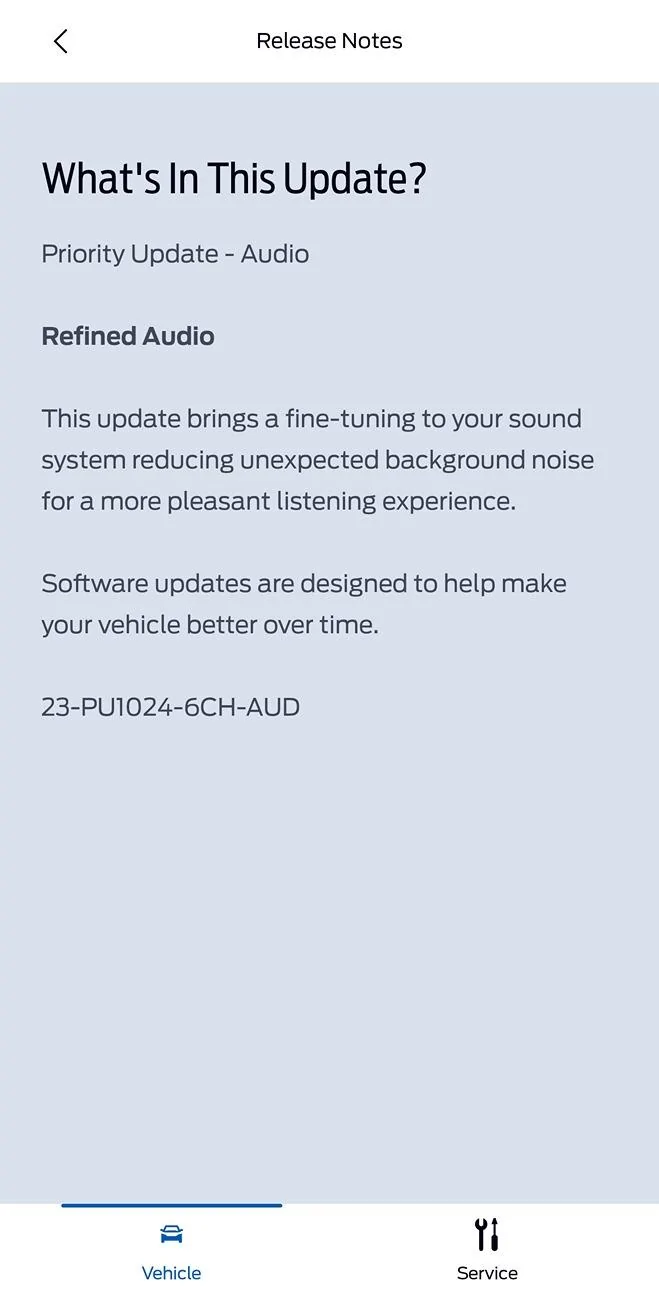

That's funny I did not get the window update but I got the audio update. Which if anything pulled bass from my sub and made it worse.
Ford Bronco Much needed "Enhanced Window Operation" OTA software update now installing Screenshot_20240709_111557_FordPass
