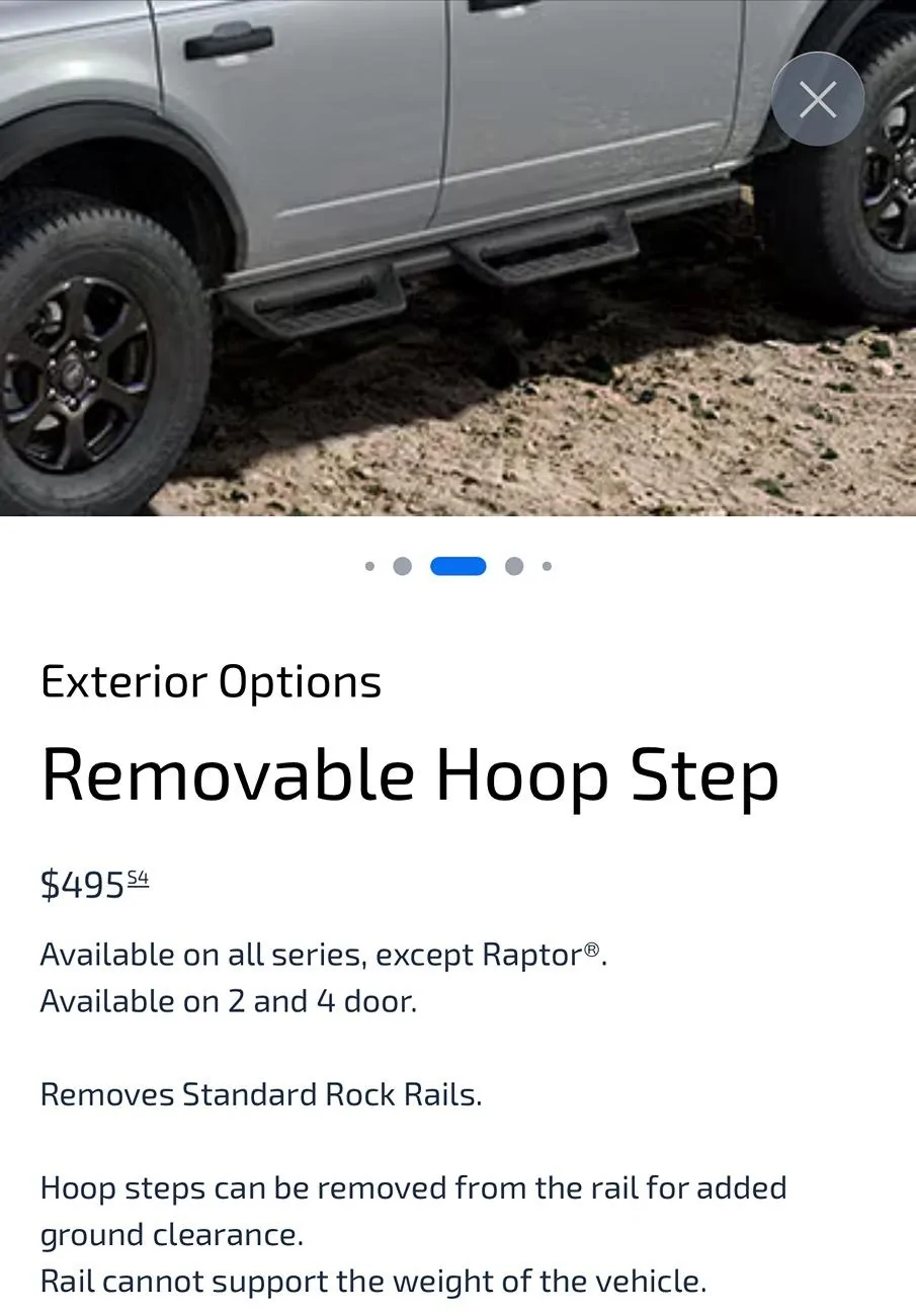

They are the factory removable hoop steps.

According to the description from Ford above, they replace the rock rails and the different rail will not support the weight of the vehicle.

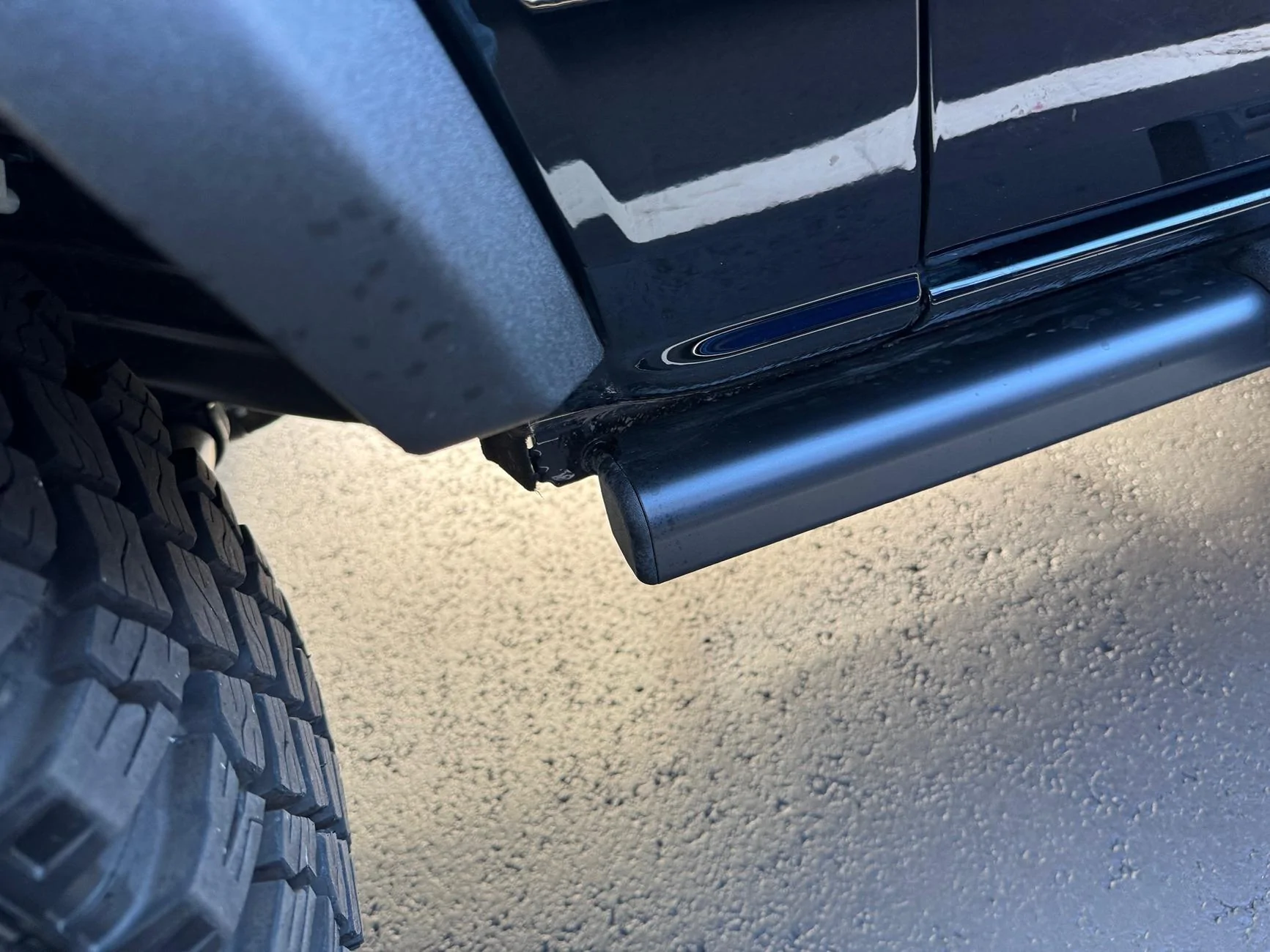

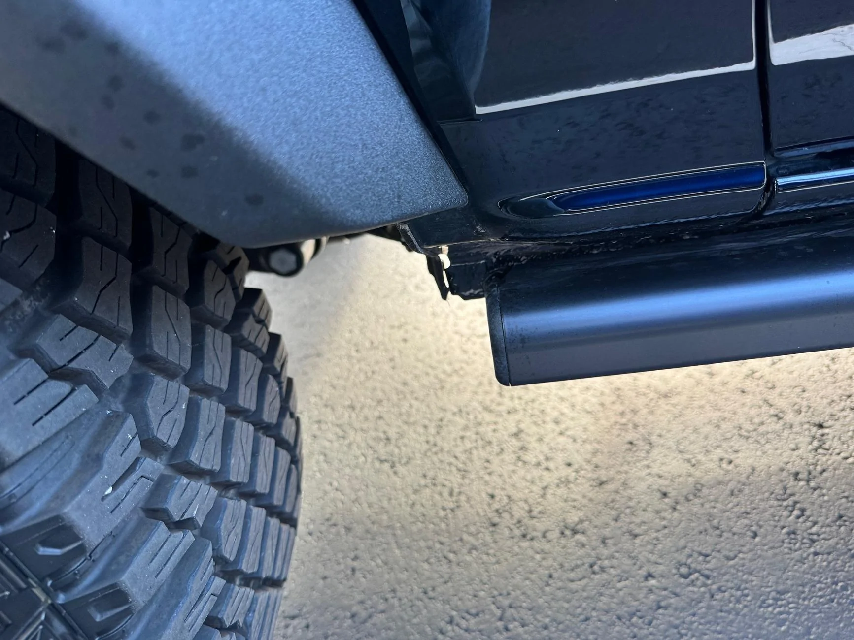

Here is the front of the rail.

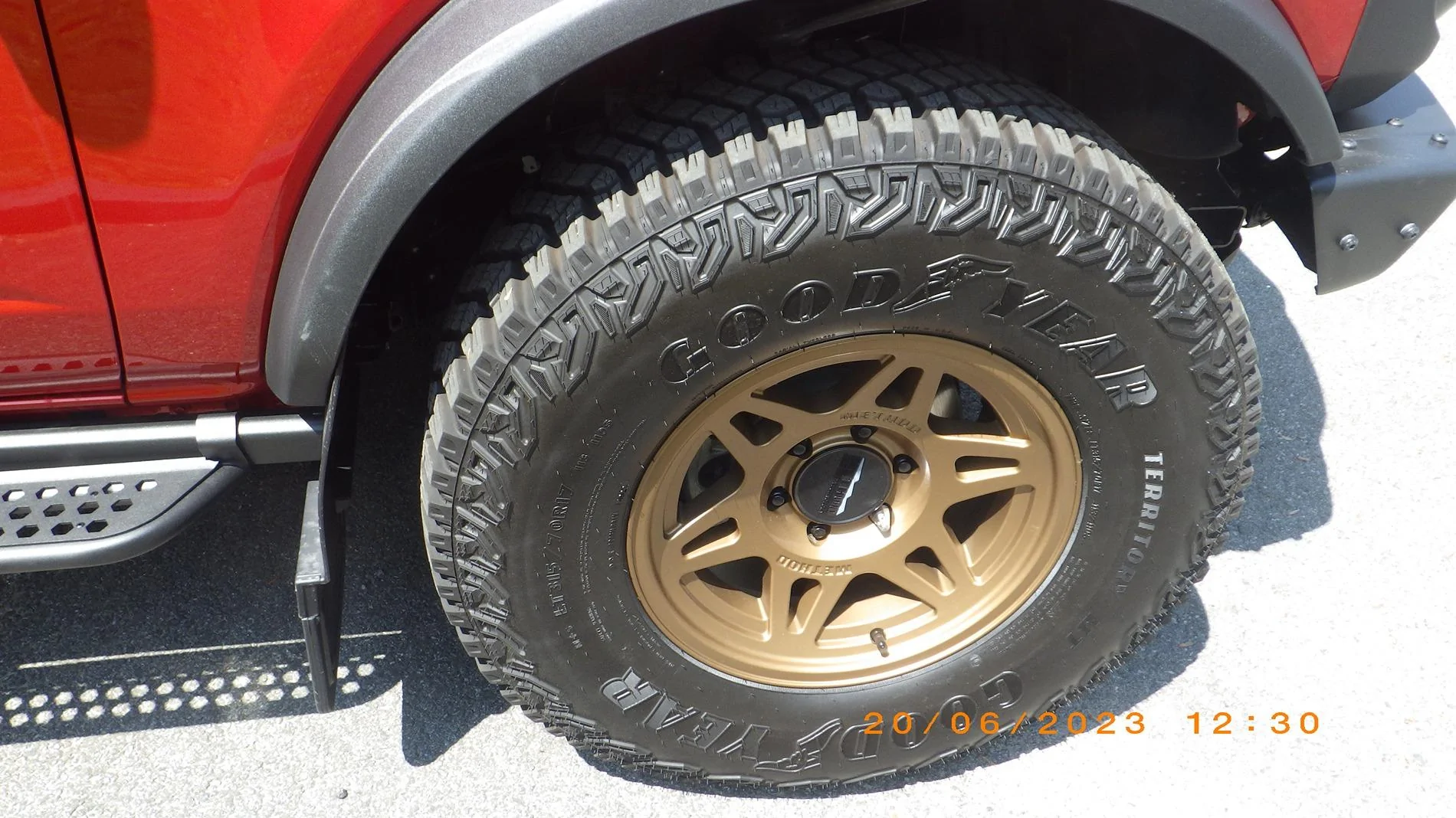

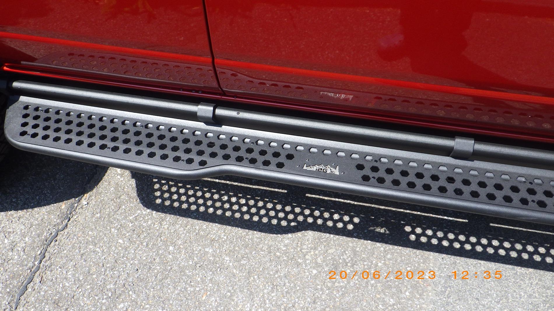

Hi My badland 2023 IAG FOOTREST CONNECTED ON ROCK RAIL OEM FORD and GATORBACK mudguards suitable for rockrail GATORBACKS CAN BE SHORTENED EASILY are intended for this
tracktoy

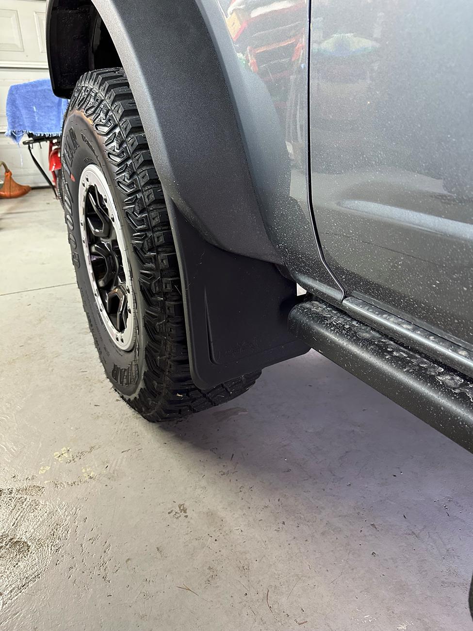

Mud Flaps do not interfere in any way with the hoop steps but can interfere with the rock rail so be aware of that fact. The only thing you need to be concerned about when ordering Mud Flaps is Sasquatch or Non-Sasquatch because of the width of the removable fender flare.
I have the IAG mud flaps on my BadSas with hoop steps. Installs easy and are removable if your going to wheel it.
