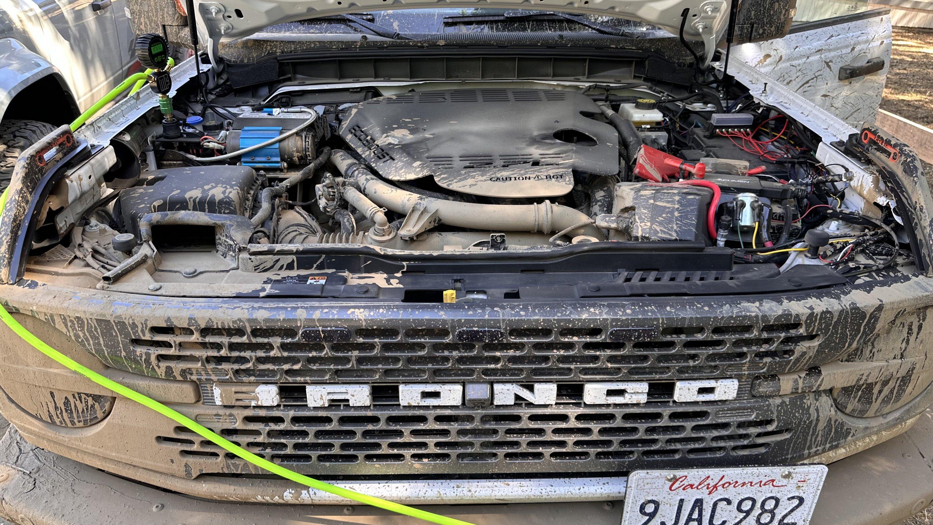

Last weekend we went out to hollister hills for some off road fun. Drove through a mud pit and everything was fine, but a couple days later I got the service charging system NOW alert.
I turned off the vehicle and restarted and the alert went away. This has happened 4 times now over the last week, and every time I turn it off and back on after driving a little bit the alert goes away.
What I am thinking is that the mud caked on the alternator isn’t bad enough to cause a failure, so once I can drive it around a little bit the mud breaks up and allows the alternator to charge the battery. I have a ā€˜23 badlands so I believe it has the upgraded shield.
What would you do in this situation? I don’t think it will be covered by the TSB because I already have the new shield, and it seems to be getting better the more I drive it. I’m a little worried taking it off road, but I do have a jumper pack that I can use if needed.
Is there something I can spray on to clean it without damaging the alternator? I’m afraid to hit it with water and make it worse.
Should I just take it out and clean it off? Hoping I don’t have to do that because I have the rough country hidden winch installed and would be a real PITA to do.

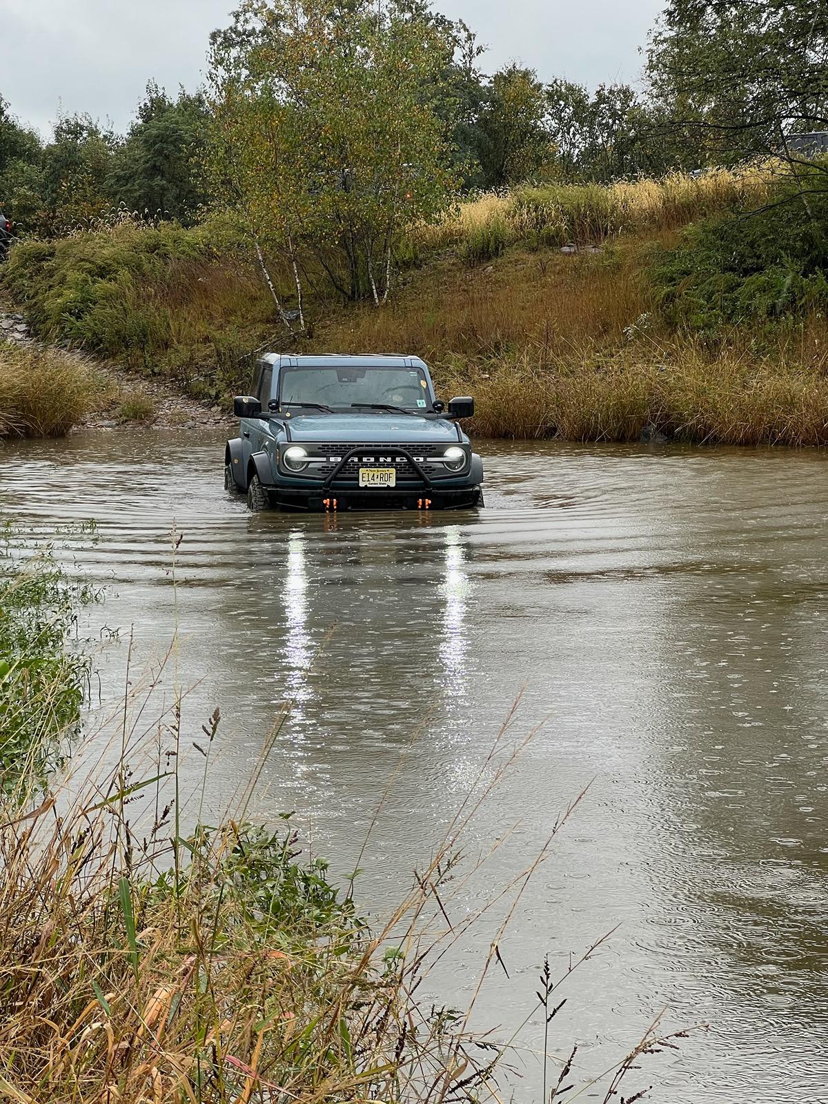

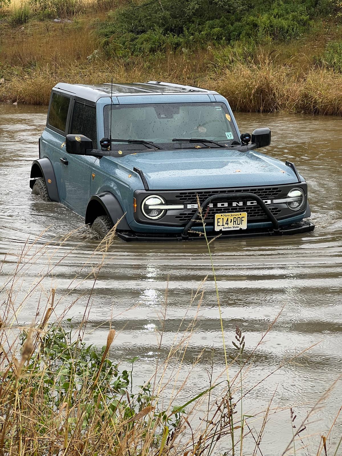

I had the exact same situation. I took mine in, told them the story, showed them this picture, and I got a new alternator, new cover, and new belt under warranty at 20,000 miles.

Mine's a '21, and it was done in half a day. They ordered all the parts when I had my oil changed, and I was scheduled and repaired about a week later. They even offered to do a free pick up and drop off, but I don't trust anybody I don't know to drive my truck if I don't absolutely have to...

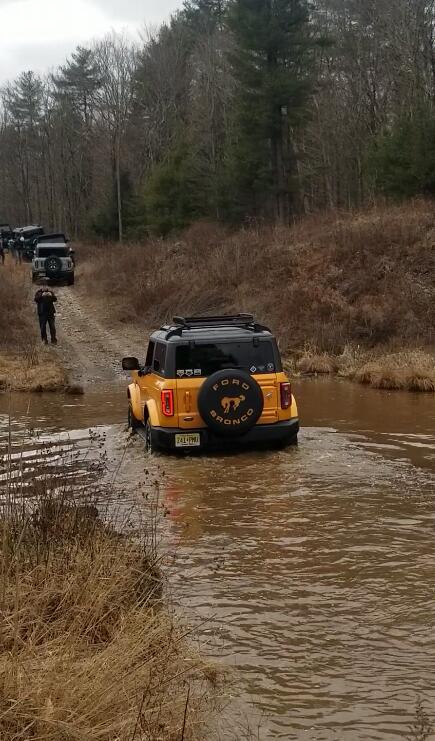

I sunk my first alternator in a mudhole and immediately knew i fugged up... 20 seconds out the other side, DINNGGGG.. Service Charging System NOW....
(terrible quality clipped from a video)
Ford Bronco Mud killed another alternator (or not?) 1719256693926-c
That was back last October at about 18,000 miles.. Warranty covered the replacement and performed the TSB shield update.
I did something similar 2-3 weeks back on the passenger side and no charging fault this time, so the tsb does help... ended up pushing a wall of thick Ozark mud up to the headlight and honestly though i was about to go swimming to winch myself out. thankfully i was able to get some wiggle room in reverse and go around the deepest chunk.
