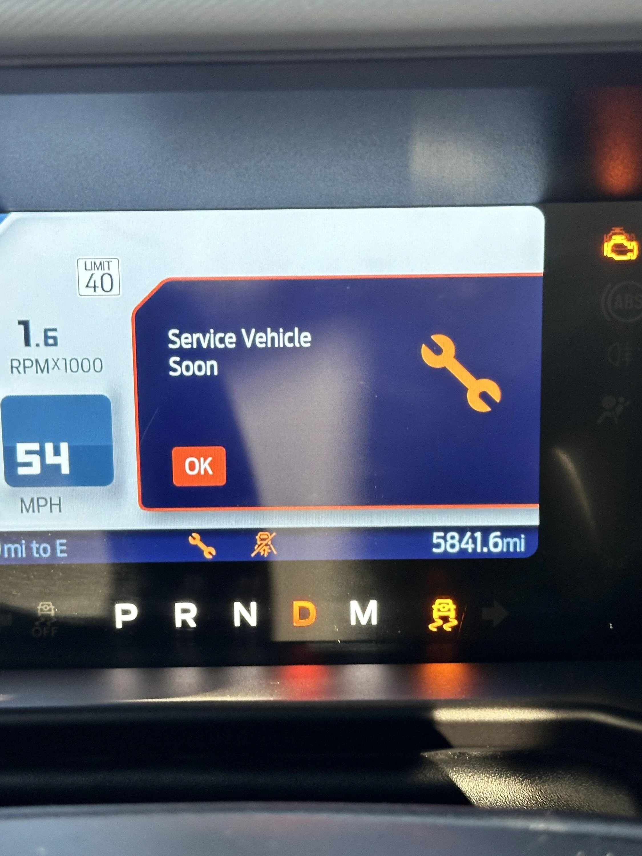

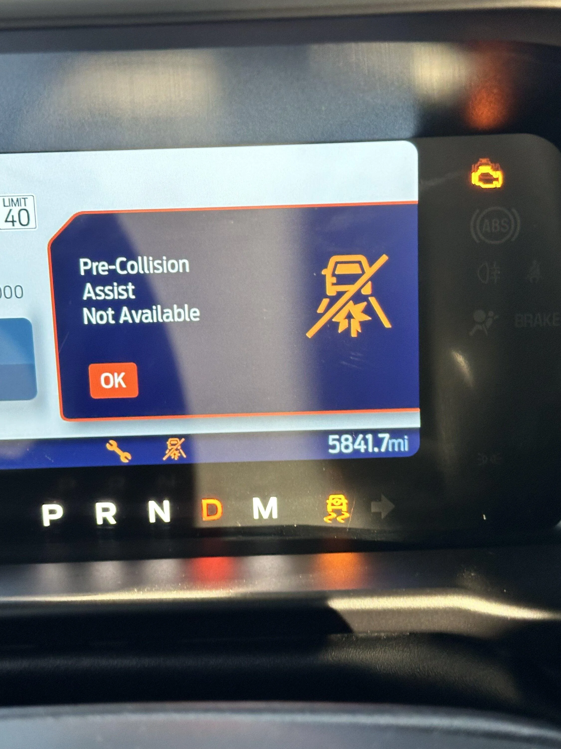

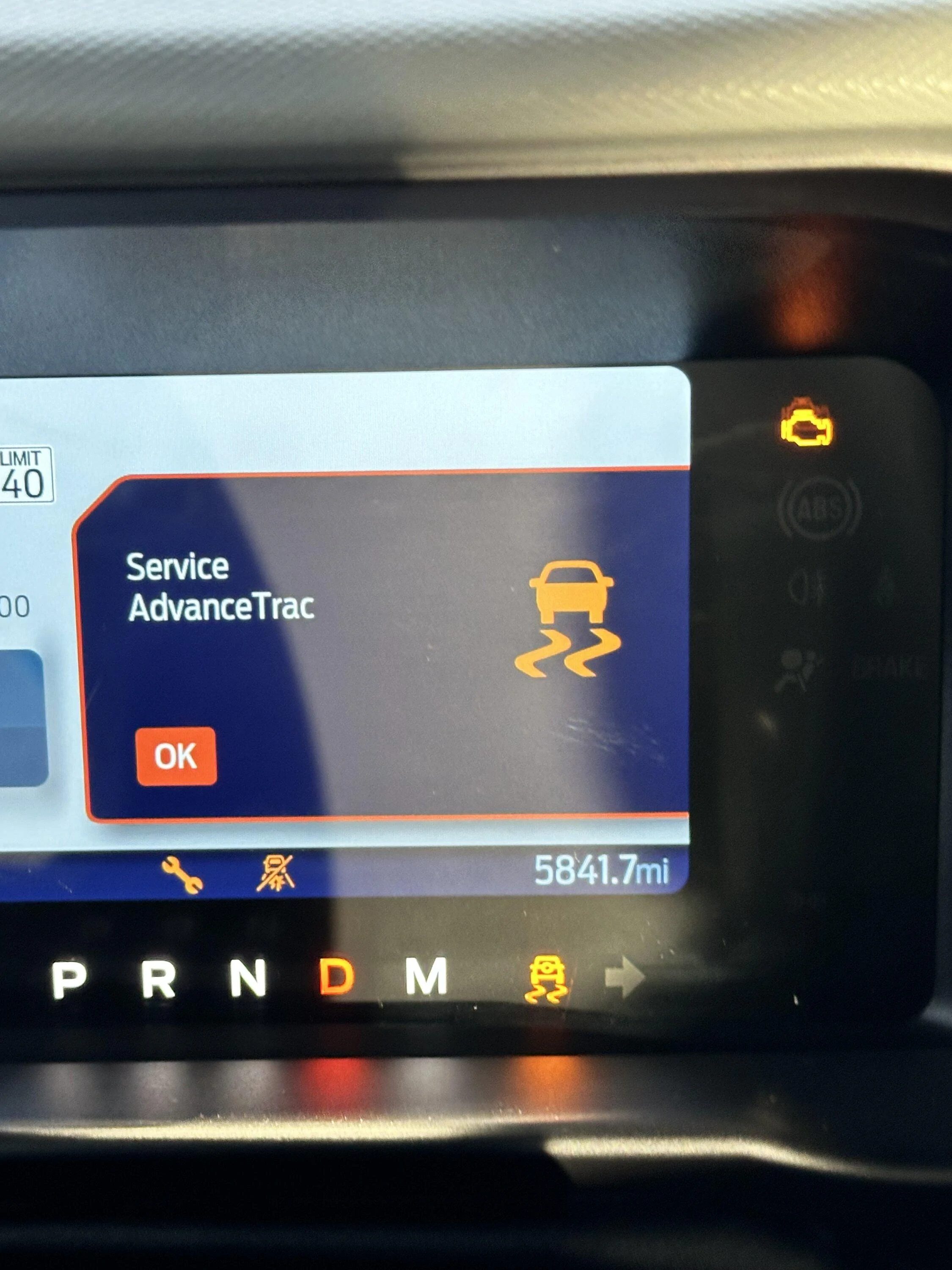

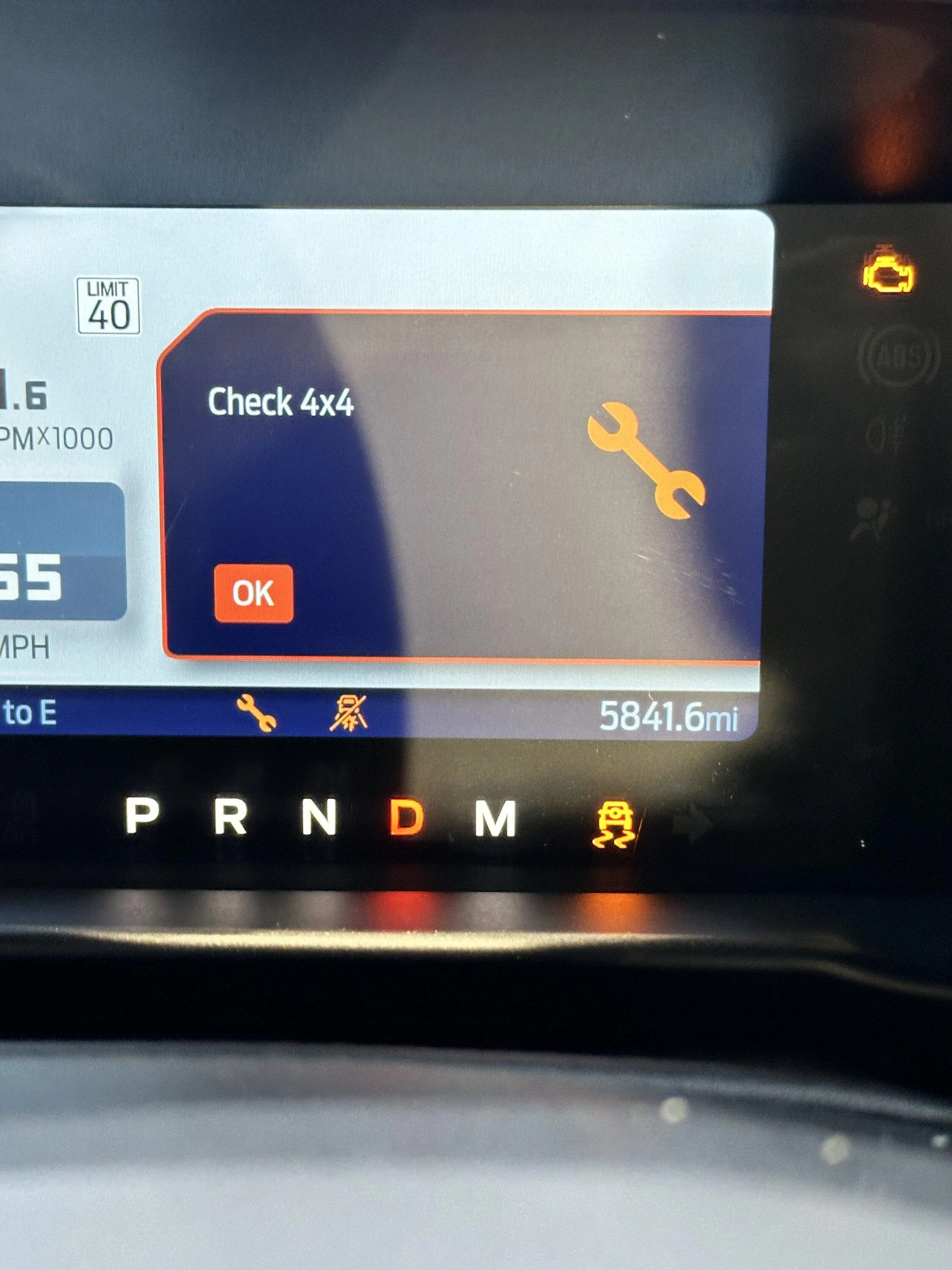

Yesterday I was just out running some errands and 3 miles into my trip my screen alerts me to the following:
Ford Bronco Multiple Failure Alerts! IMG_3364
Ford Bronco Multiple Failure Alerts! IMG_3365
Ford Bronco Multiple Failure Alerts! IMG_3366
Ford Bronco Multiple Failure Alerts! IMG_3367
These all came on within seconds of each other while driving down a dry but cold road in 2WD. After I got to my destination, shut down & then restarted my Bronco, there were no warnings in sight until...... about three minutes later. Then, a repeat of the original s#it show!
