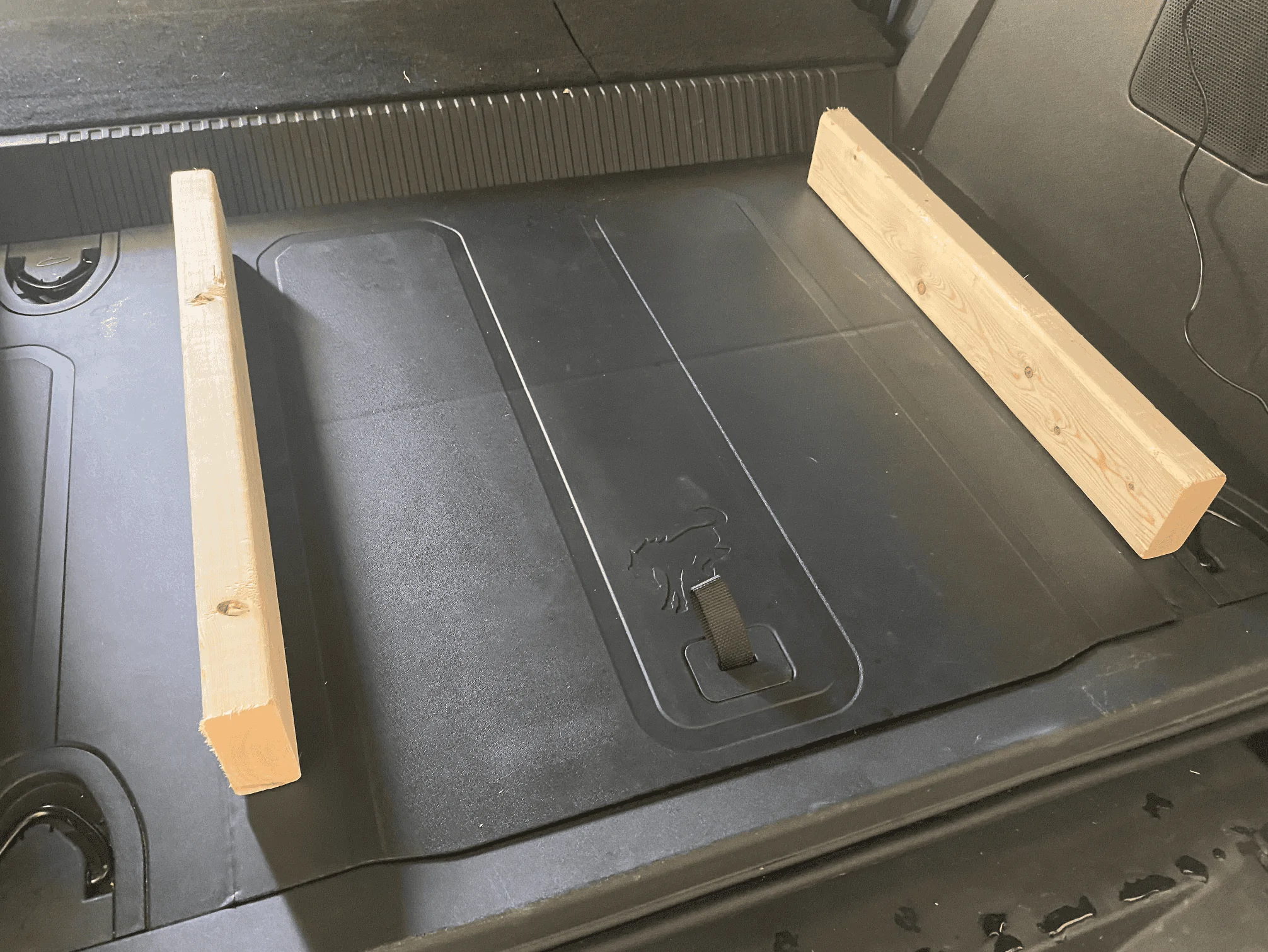

I cut 2 2x4's and spaced them out far enough so I could still open the sub floor compartment.

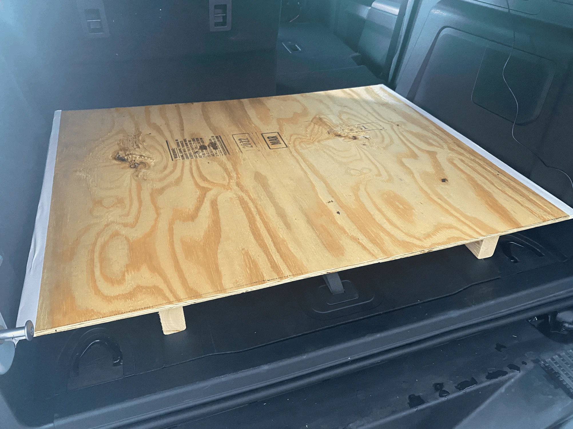

I put duct tape on the sides so it wouldn't scratch up the plastic when loading. Put in to test the fit of everything and then screwed down the deck to the 2x4's.
Ford Bronco My custom Sleeping Platform / Storage Area 3

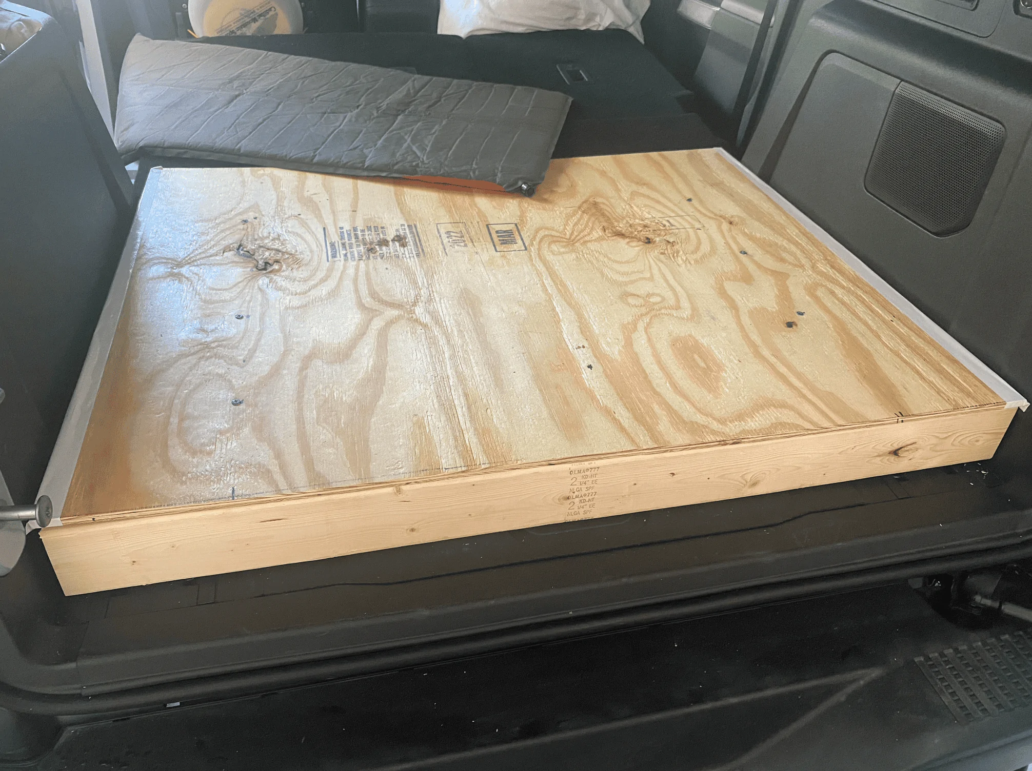

Take the remaining 2x4 and cut it to length for a front piece. Note that this piece is not screwed in or attached. Simply inserted in place. This gives it a finished look, hides the gear, and also gives it a lot of support. Can easily add heavy bins, coolers, fridge on this.
Ford Bronco My custom Sleeping Platform / Storage Area 4

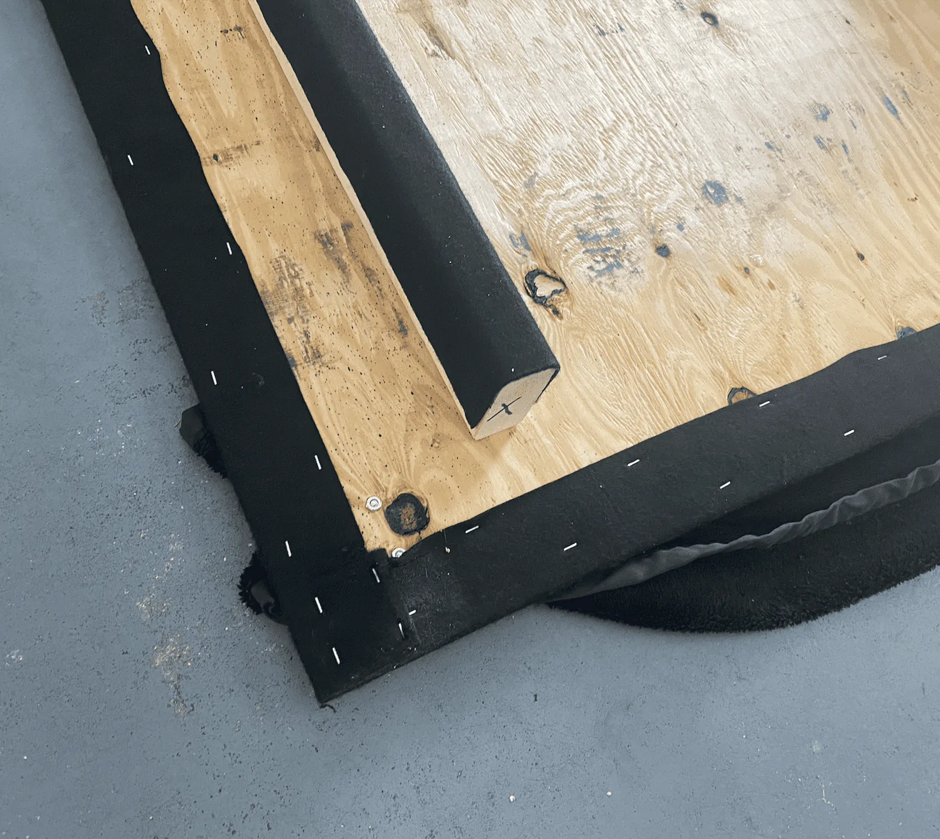

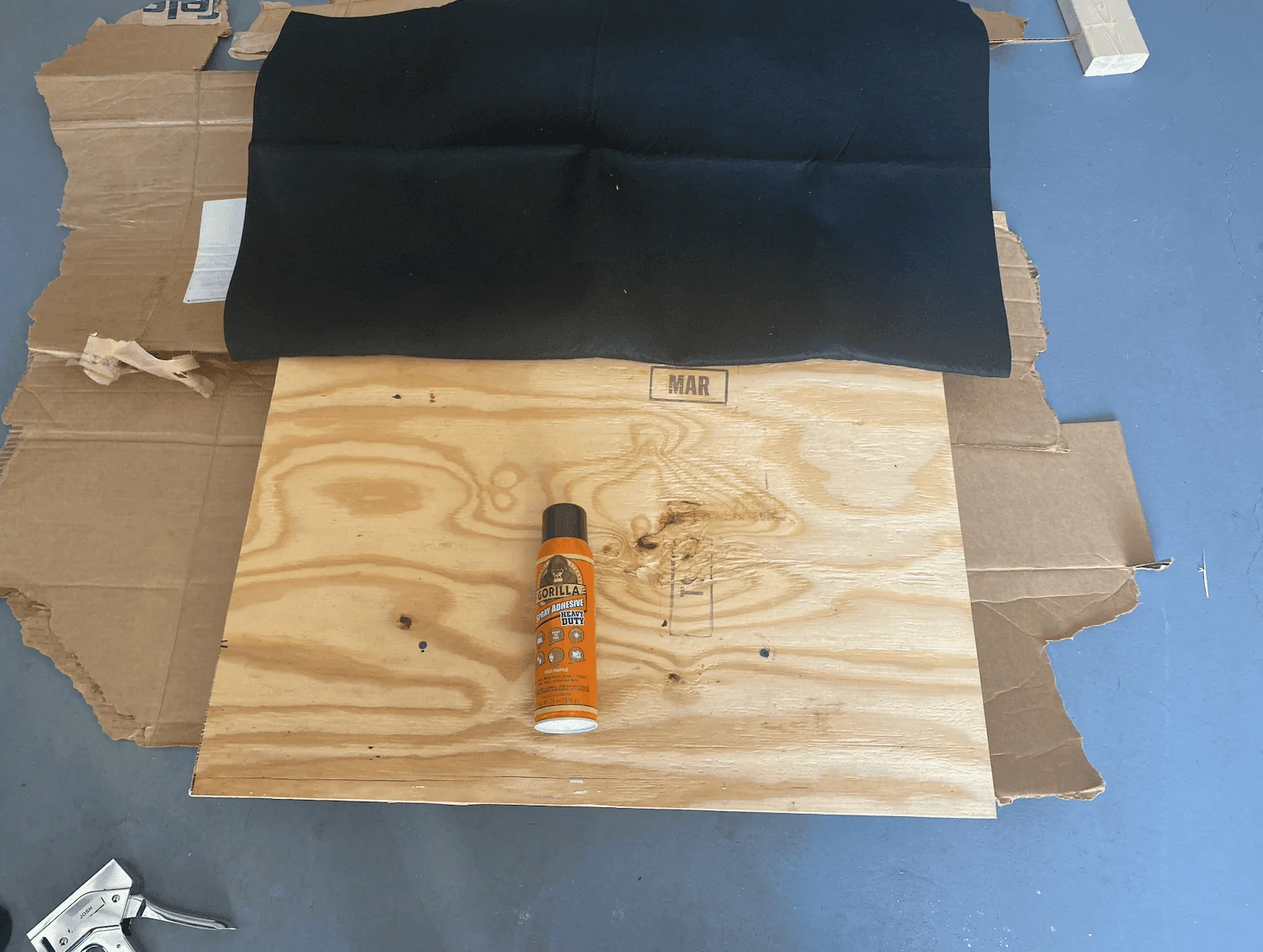

Time to carpet it. I used Gorilla Spray Adhesive and speaker carpet. I used one solid piece and glued half at a time. Folding the edges down over the bottom.
Ford Bronco My custom Sleeping Platform / Storage Area 6
Used a staple gun and stapled the sides down. Also used scrap carpet to place on the 2x4's so it slides in easy and doesn't scratch things up. I also cut a piece for the front of the 2x4 not pictured.
Ford Bronco My custom Sleeping Platform / Storage Area 6a

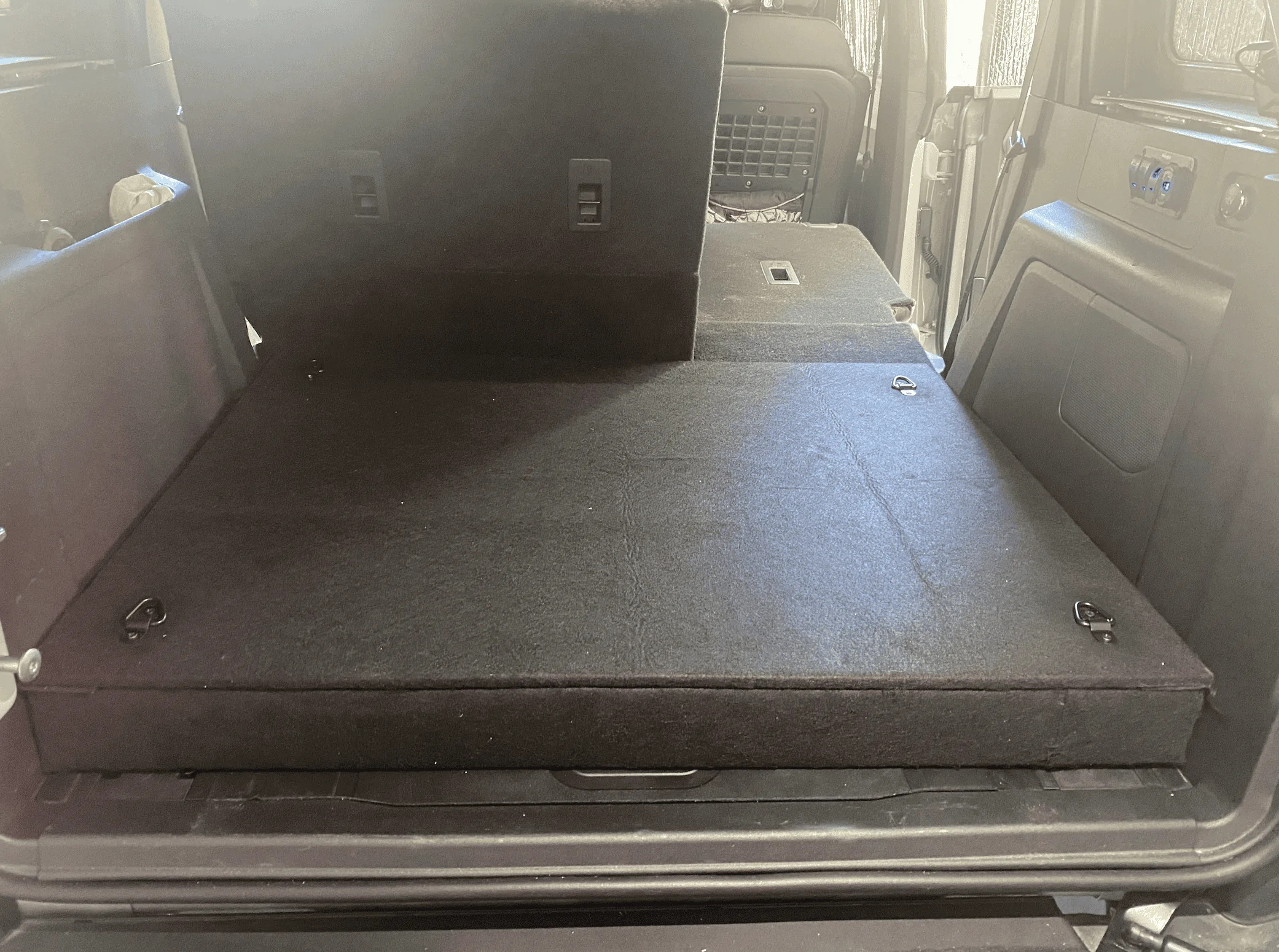

Wrapped the front 2x4 as well and added some tie down points. Everything fits great. Seats work up or down. Can close the tailgate just fine and the little "bump" doesn't hit anything.
Ford Bronco My custom Sleeping Platform / Storage Area 7

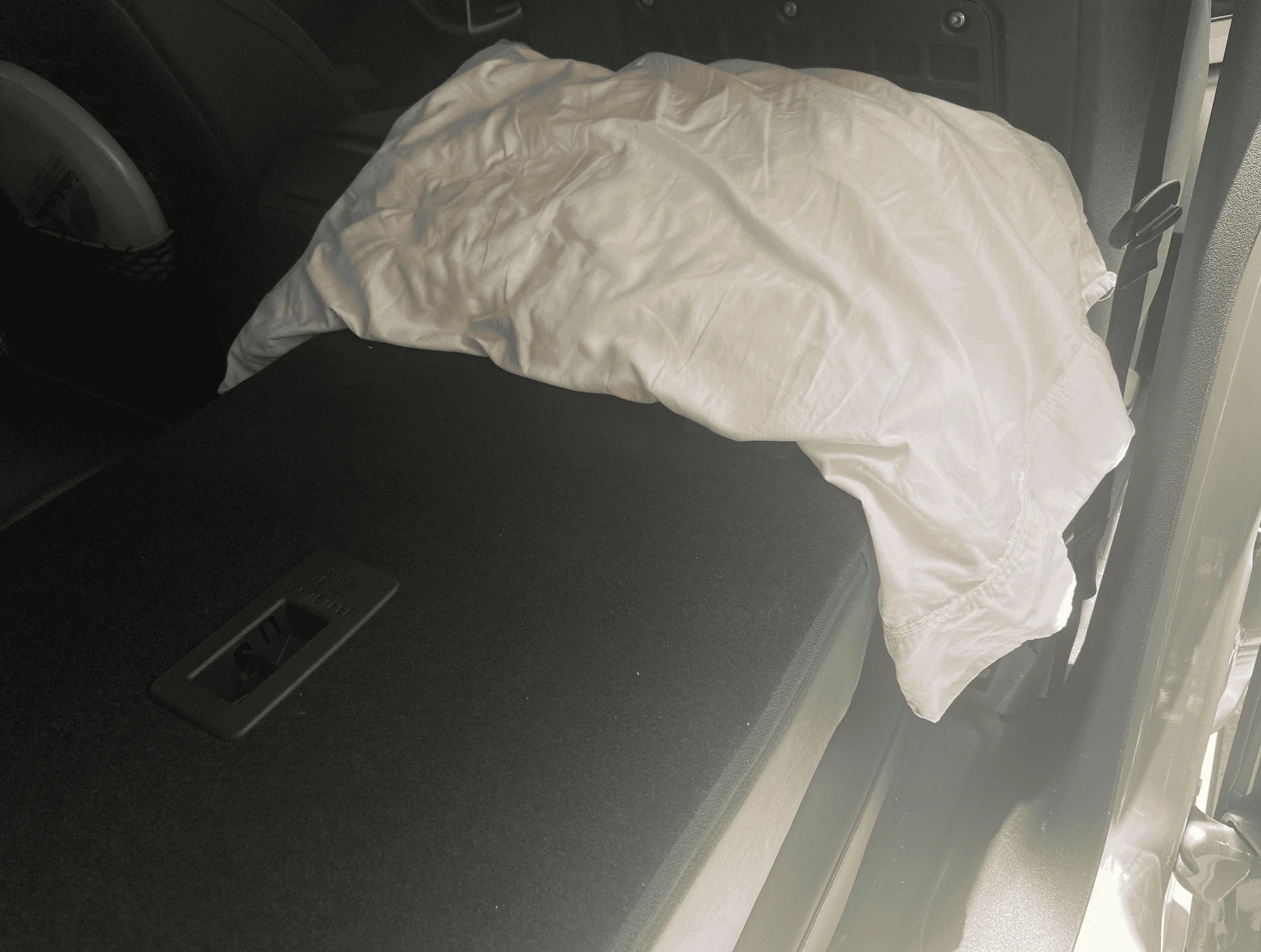

Run the passenger seat all the way forward. Then flip out the rear headrest from the lowered seat and can set a full size Pillow (My Pillow brand of course) on top and it fills in that gap perfectly. So no need to build additional stuff.
Ford Bronco My custom Sleeping Platform / Storage Area 7b

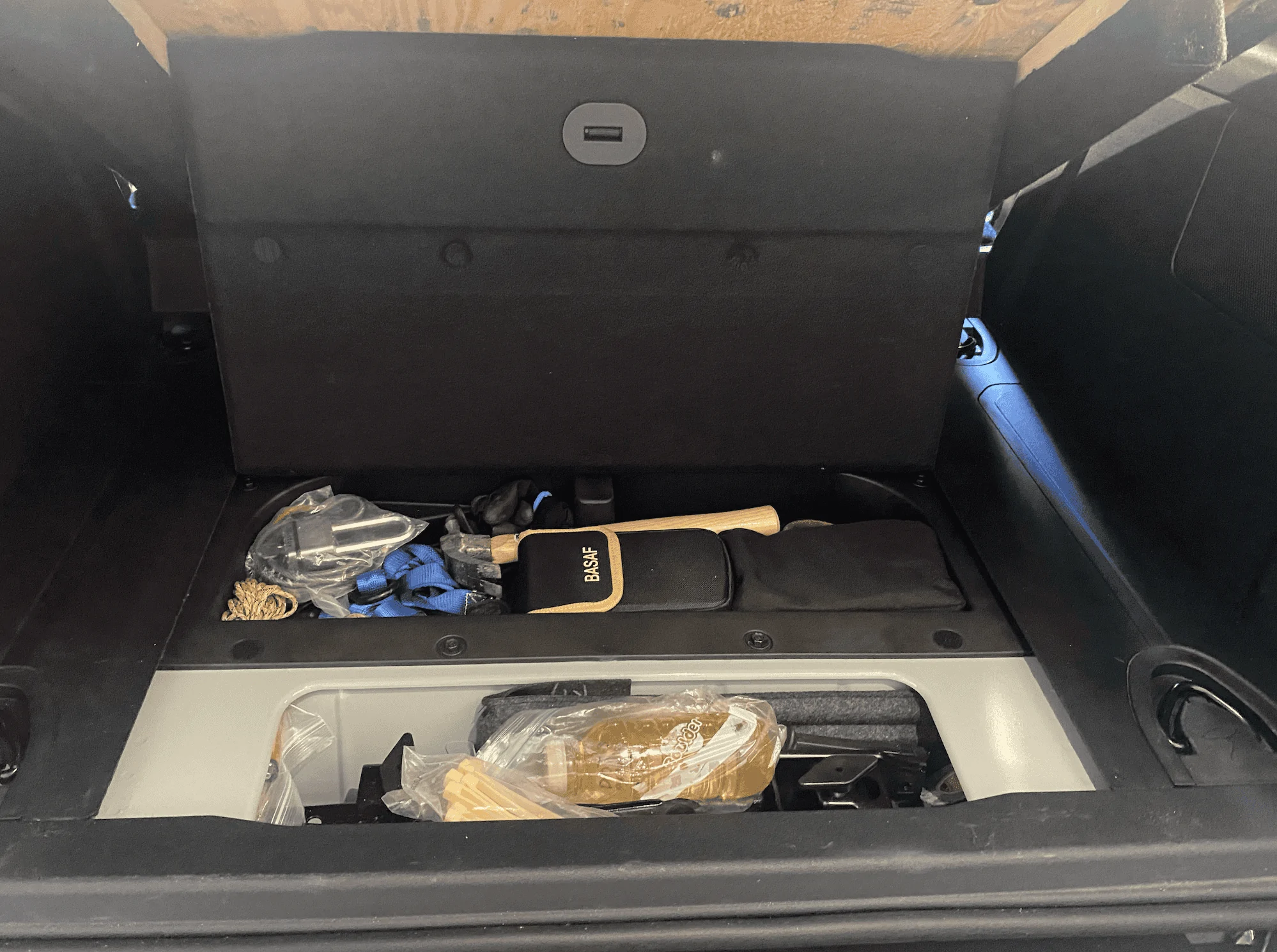

If you lift up the deck you can still access the sub floor storage. Added bonus you can prop up the platform with the sub floor lid!
Ford Bronco My custom Sleeping Platform / Storage Area 8

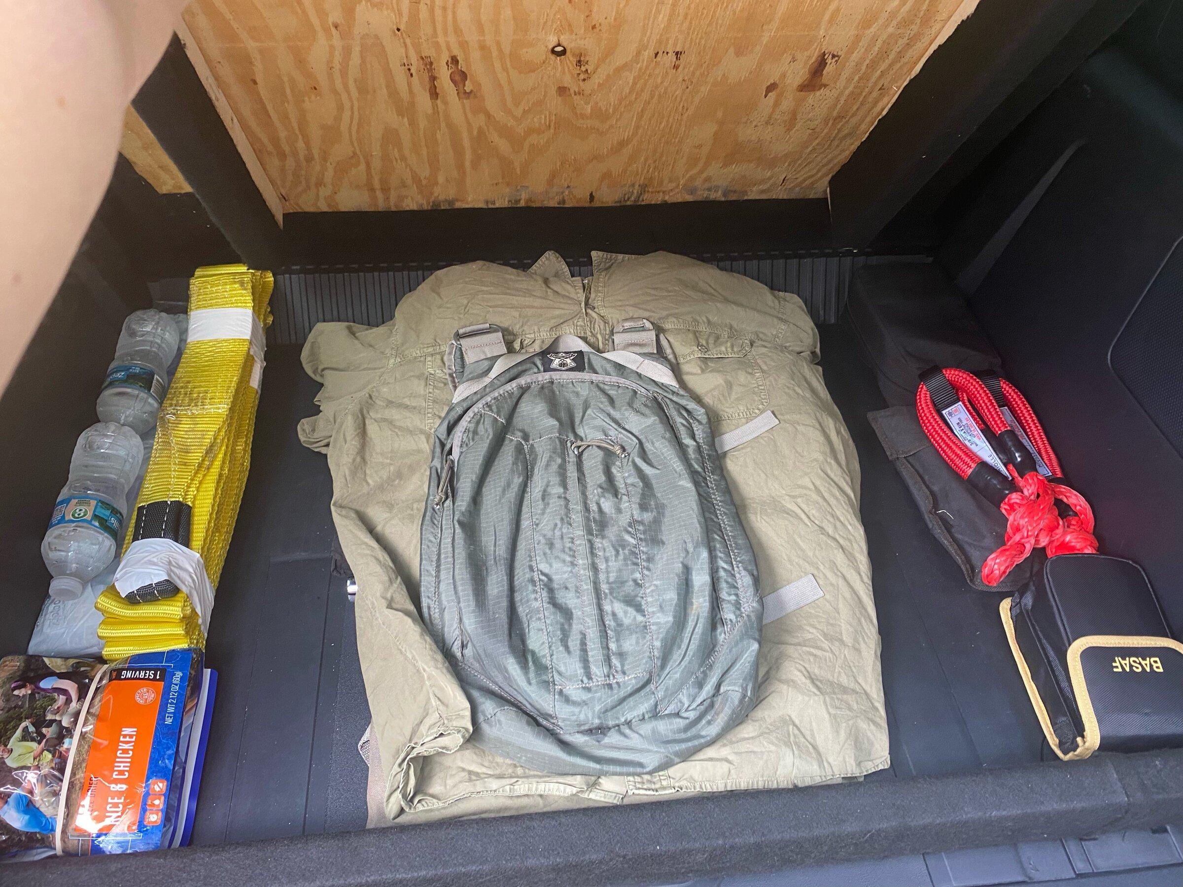

Additionally if you don't need to access the sub floor you use the front 2x4 to prop up the deck allowing you to get what you need.
Ford Bronco My custom Sleeping Platform / Storage Area IMG_4580

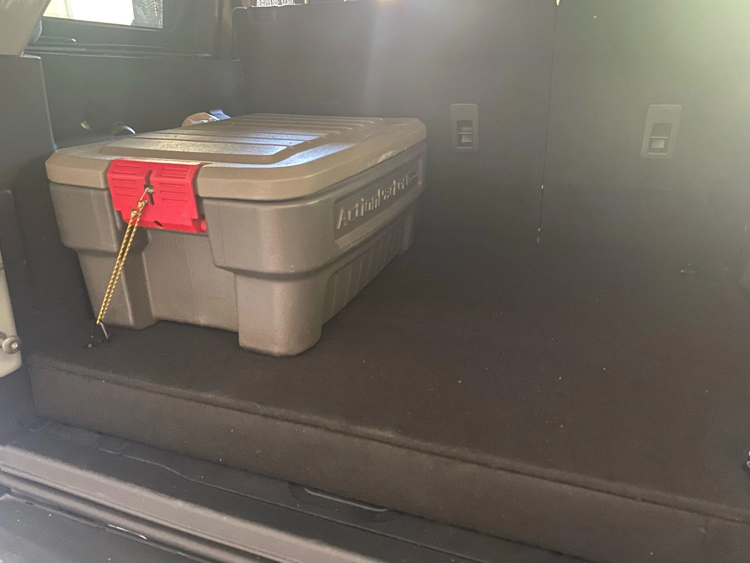

Everything all closed up and a storage bin held in place with the tie down points.
