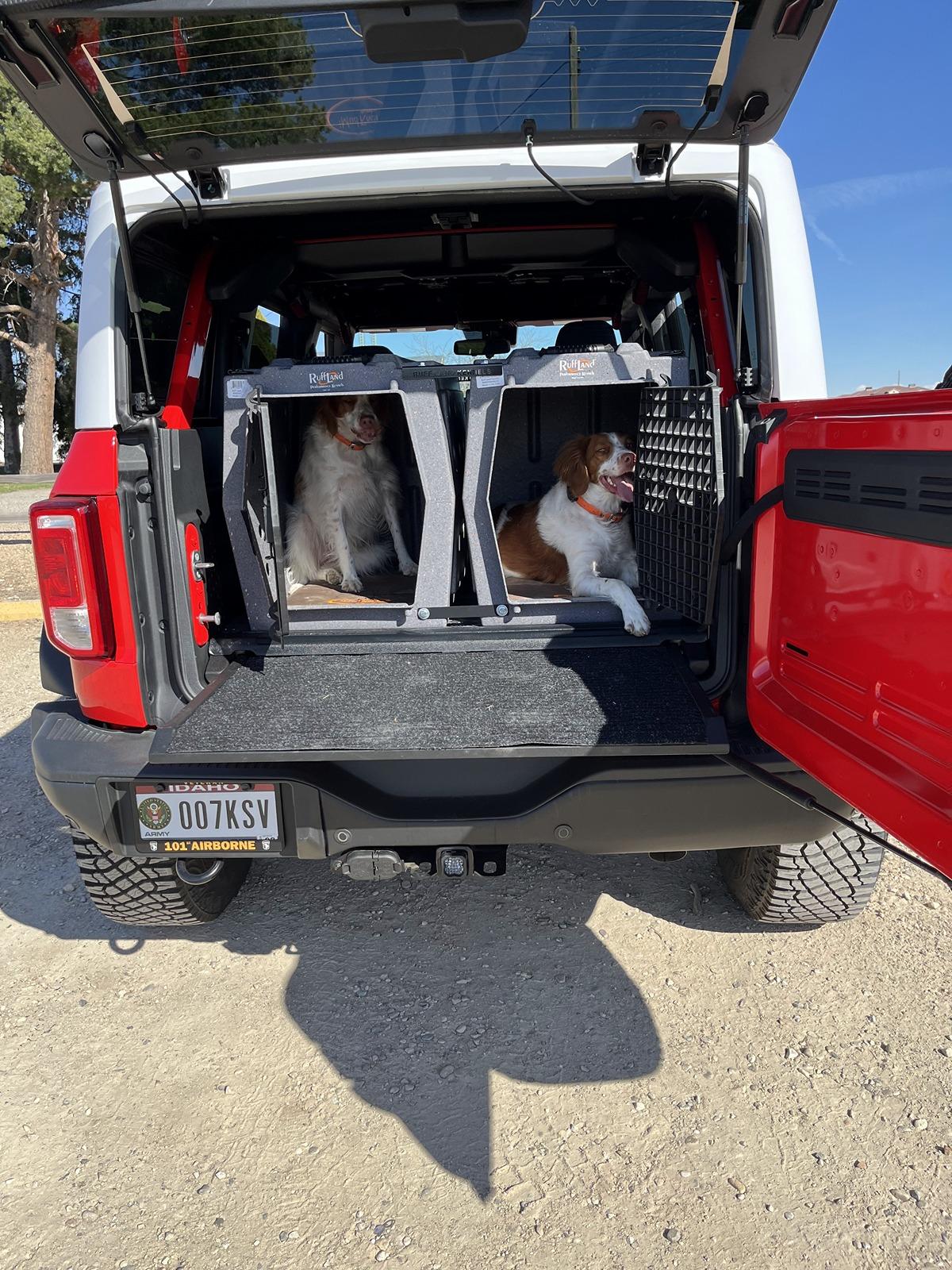

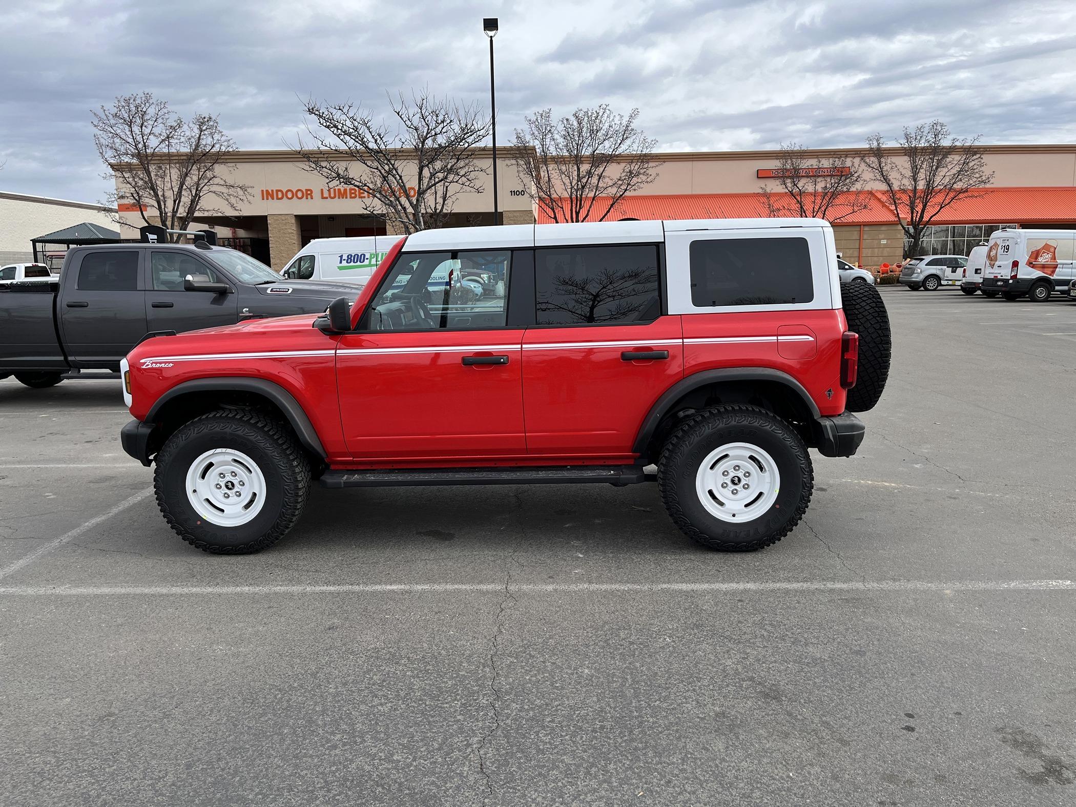

As the 2024 HE’s come with the slide out tailgate, my first stop was Home Depot to get rubber flooring and indoor/outdoor carpet to protect it from my two hoodlum Brittany’s. I cut the rubber mat to fit and added strips of Velcro to the carpet to keep it in place. It is easy to remove and can be hosed off as needed.

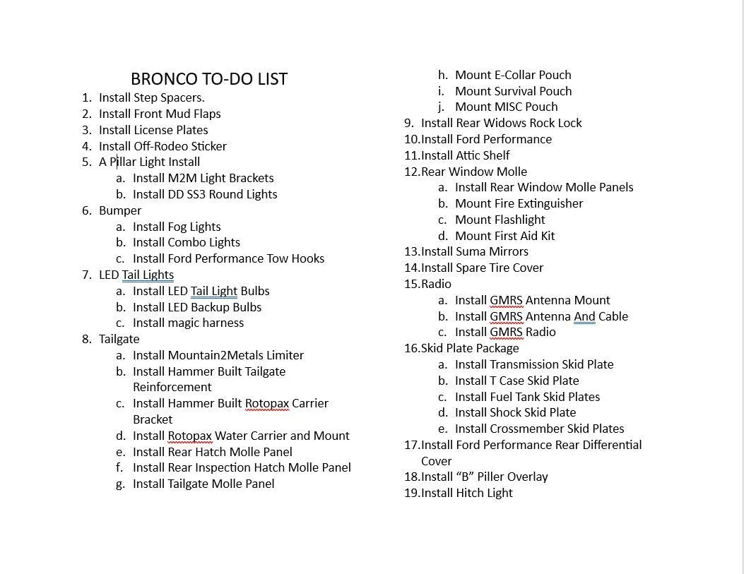

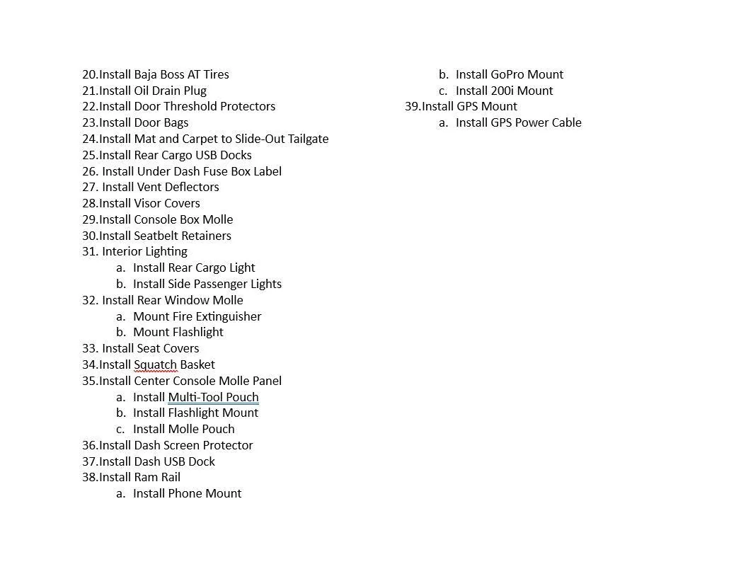

Next order of business was to set down and think about what modifications were needed to the Bronco to transform it into my ideal bird hunting vehicle. I did not put my ideas in any particular order but I did list what was going where as there is not of lot of extra room with two dog crates taking up the majority of rear cargo area.
Ford Bronco My Race Red Heritage Edition 2024 Bronco Build & Story 1719148039615-20
Ford Bronco My Race Red Heritage Edition 2024 Bronco Build & Story 1719148147038-ns

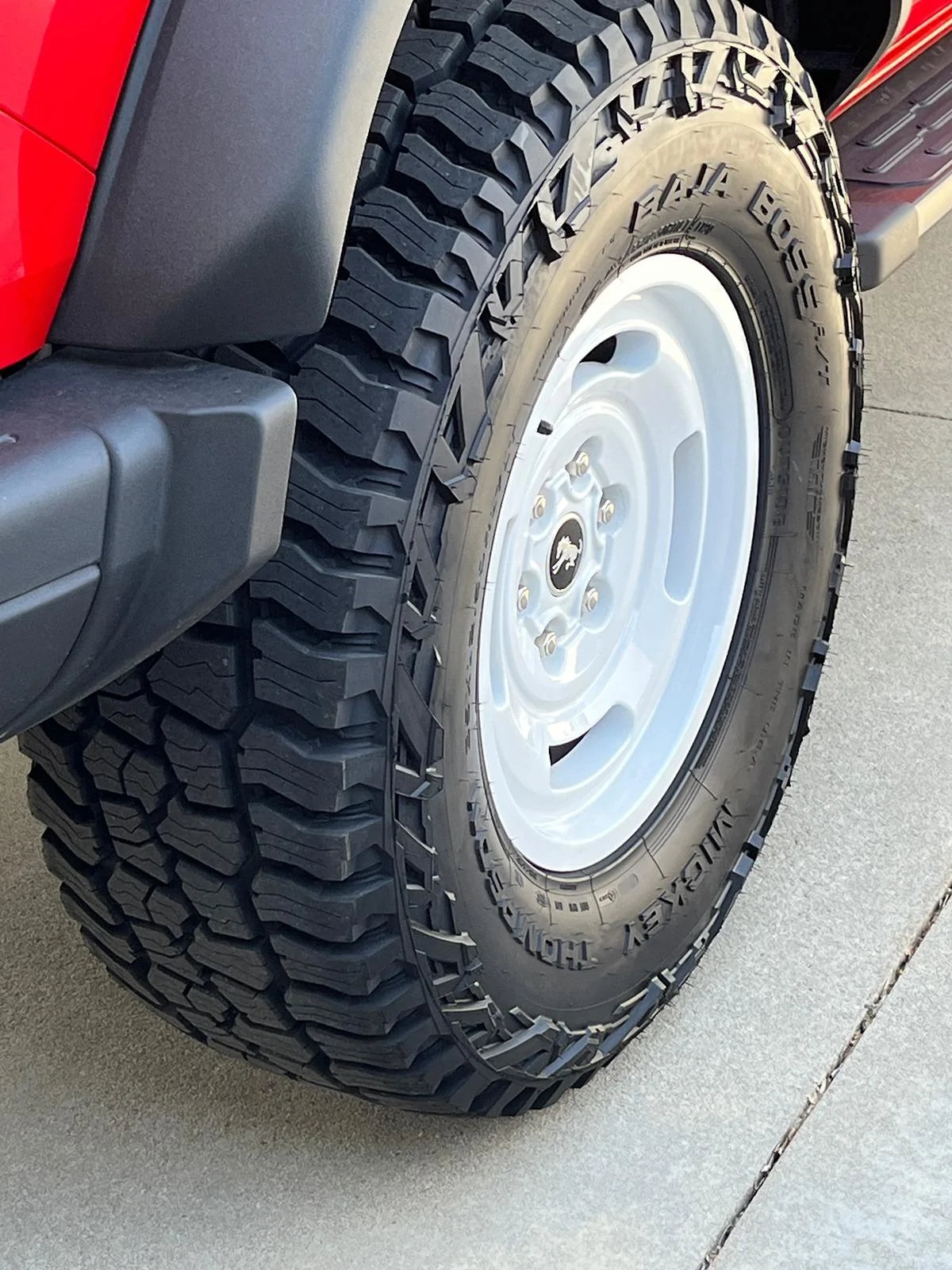

I primarily hunt on BLM land where there are a few thousand miles of ORV trails. The trails are not maintained and go from relatively smooth to rocky with off camber ruts. The stock Territory tires were not going to survive. Pointy lava in the area had destroyed my ATV tires in the past so switching the Territory’s to MT Baja Boss AT’s was a no brainer.

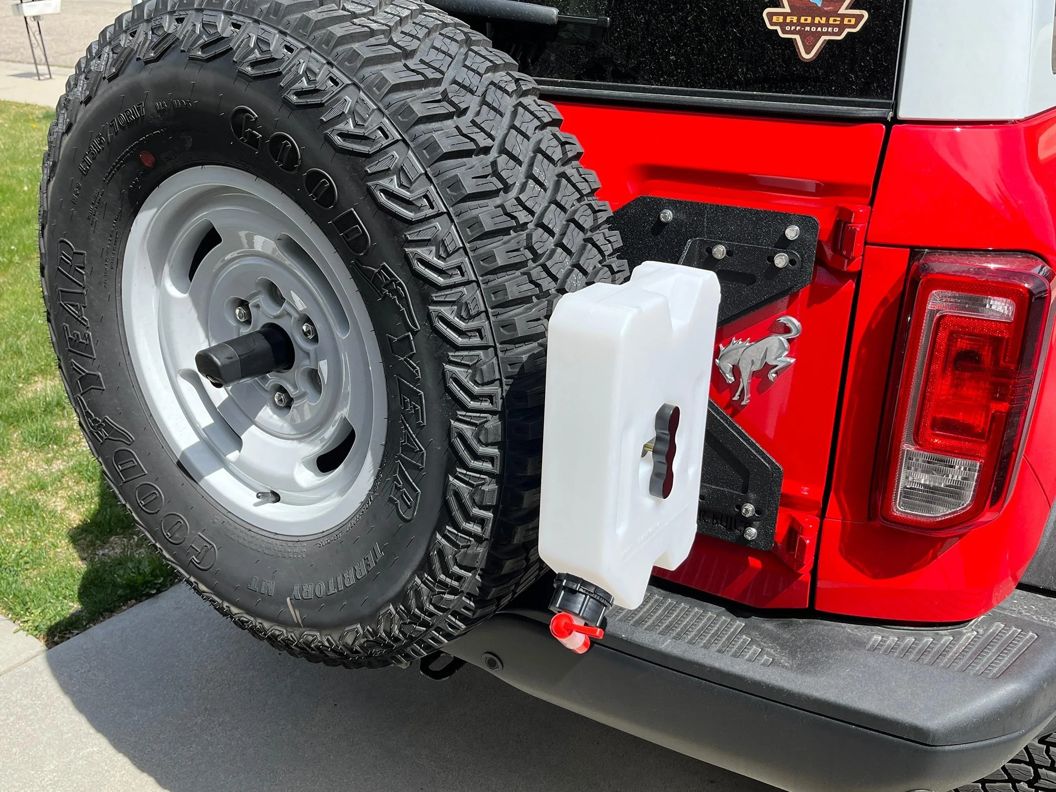

My two puppies drink an average of 64 oz of water a day each so I needed to be sure I have plenty of water for them when we are out and about. I like the Roto-Pax containers with the spout mod but their brackets are, in my opinion, way overpriced and their locks have a nasty habit of needing to be drilled out. I ordered a less expensive mount from Amazon and changed all the hardware to stainless steel. For a lock I went with the Gorilla Clamp and use a stainless steel padlock. All in its still less than the Roto-Pax mount and I don’t have to worry about a frozen/corroded lock.

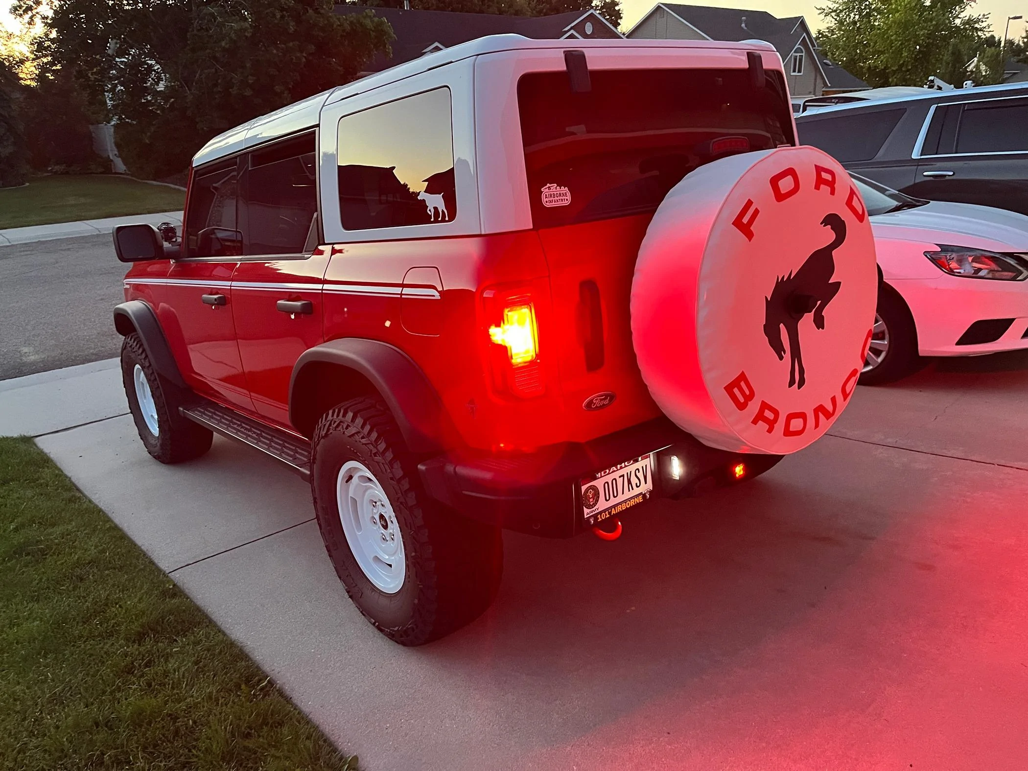

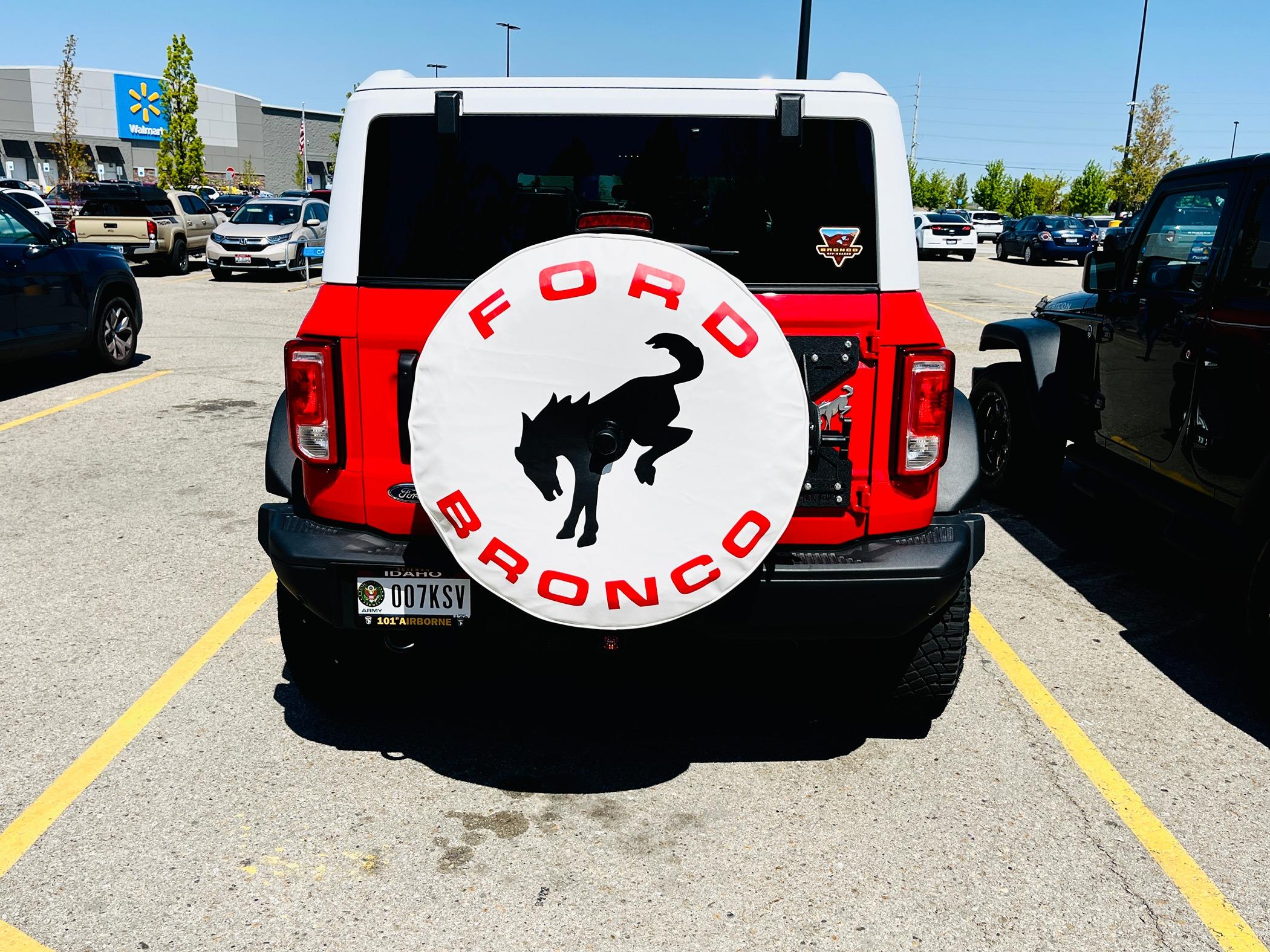

With the new spare mounted, it was time for a cover..

Glad they put the Everglades wheel wells on the HE. Are those intermediate size Ruff-tuffs?
No, they are Back Seat Riders. I had the intermediate's but they were 3 inches too long. I had a discount code at the time and bought the two Back Seat Riders for what I sold the intermediate's for.

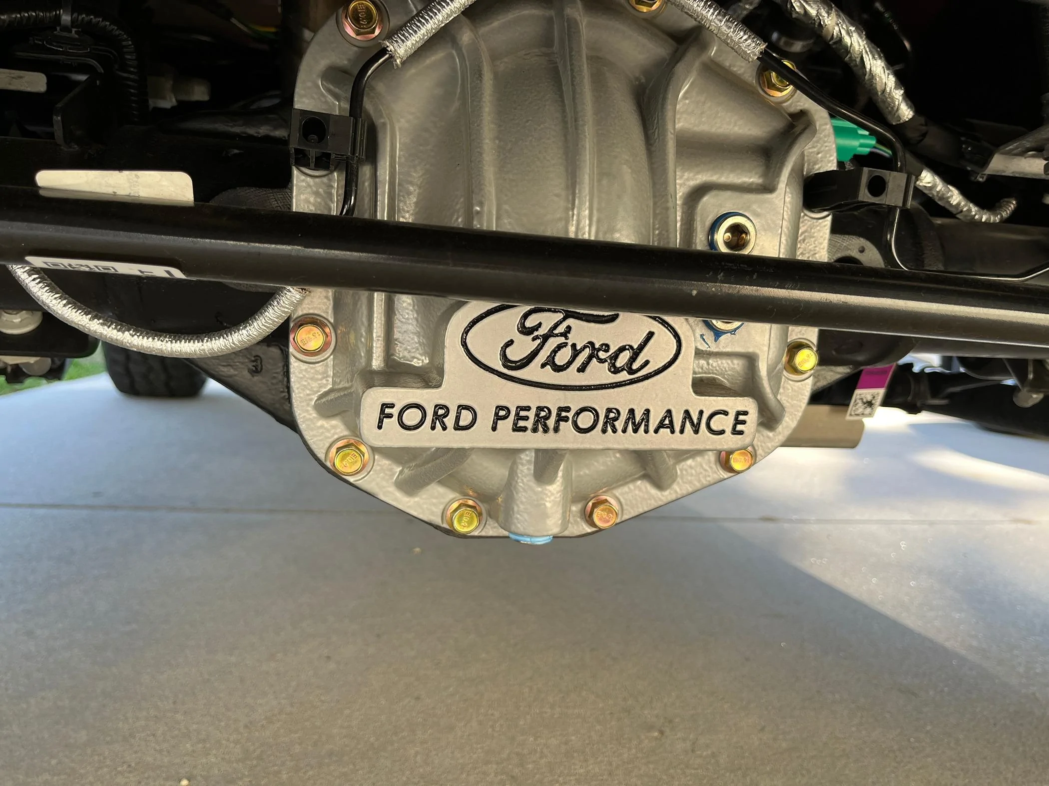

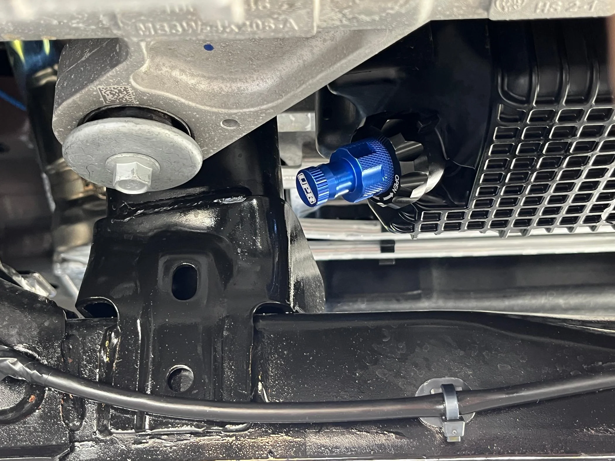

As I was close to 1K on the odometer, it was time for a fluid change. Front diff was a little dirty but not bad. Engine oil was still decent, and I added the UPR drain to make future changes easier and cleaner. T-Case had a lot of shiny metal and to my surprise, the drain plug did not have a magnet. I purchased the Ford Performance rear diff cover and utilized the bolts and magnetic drain plugs suggested by CarbonSteel during the install. The T-Case now has the stock magnetic drain plug that was in the rear diff.
Ford Bronco My Race Red Heritage Edition 2024 Bronco Build & Story IMG_8032.JPG
Ford Bronco My Race Red Heritage Edition 2024 Bronco Build & Story IMG_8100.JPG

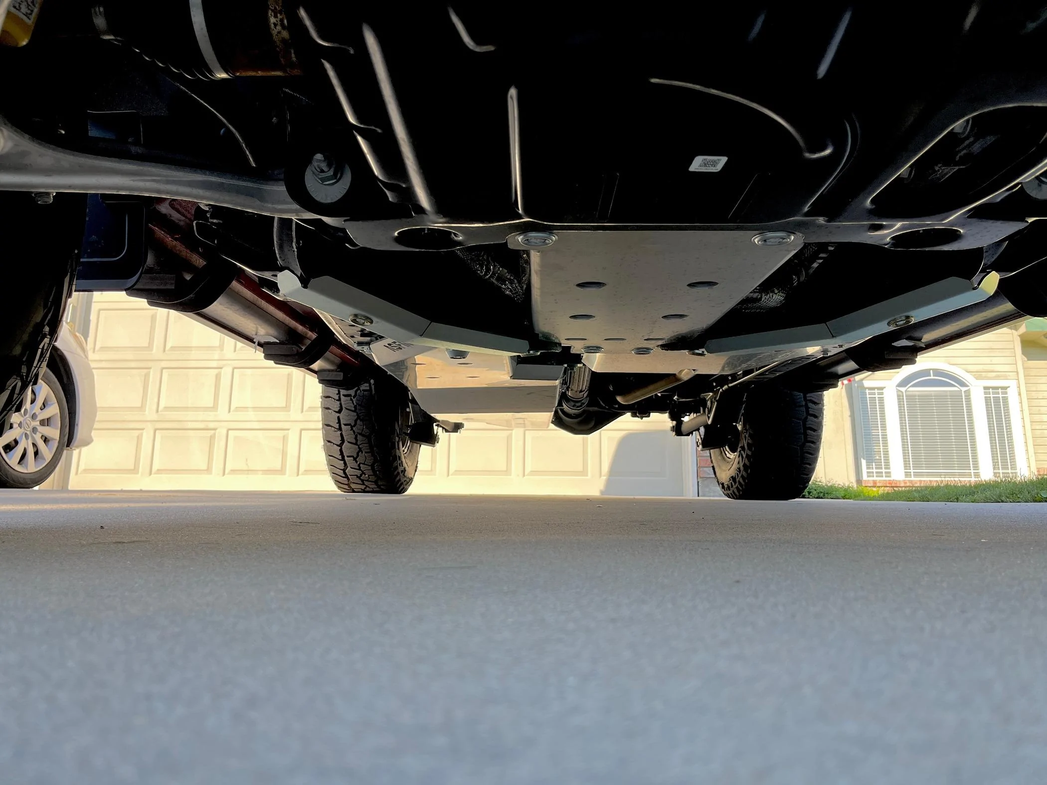

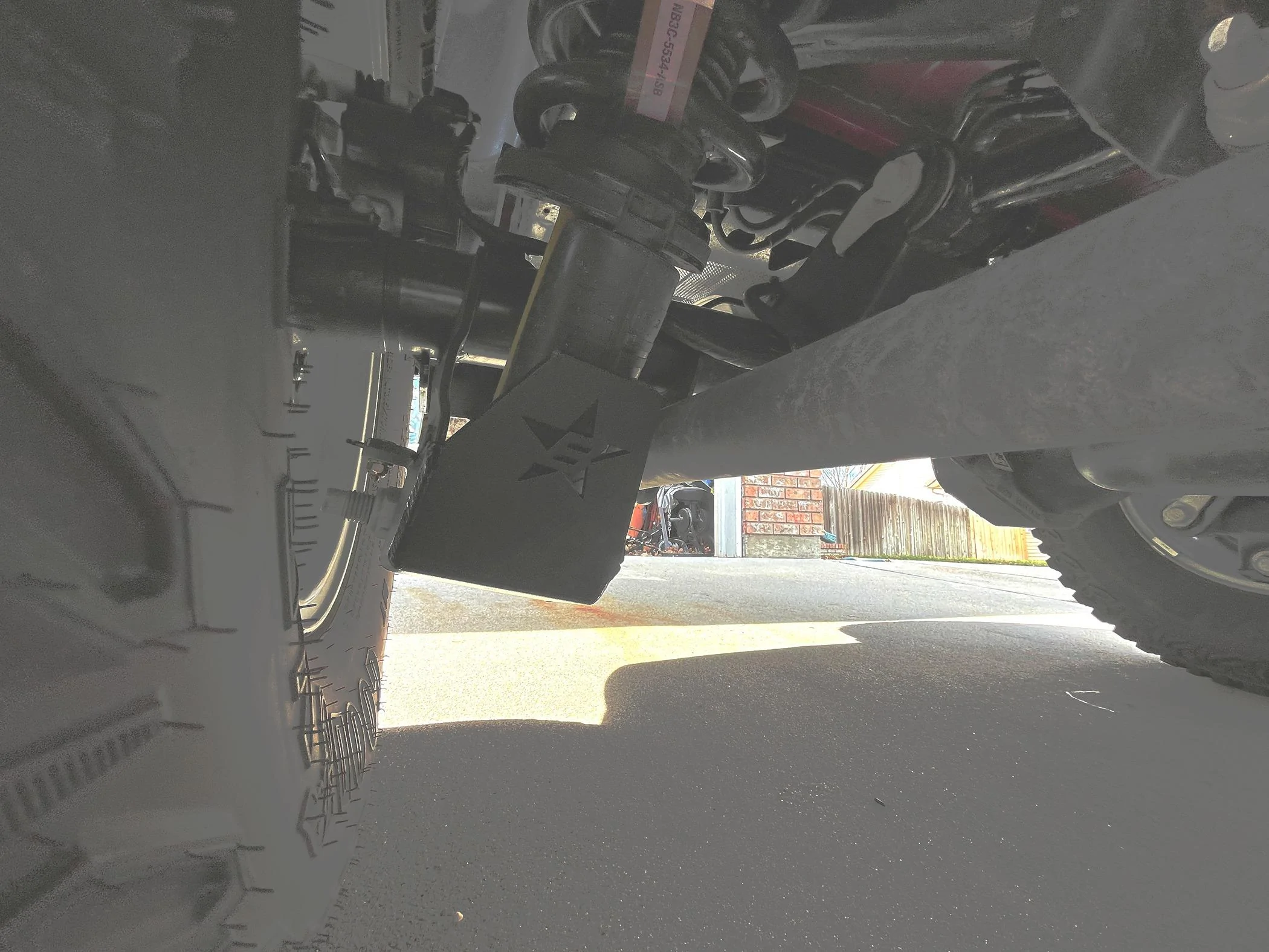

Ford decided that payload was more important than protection, so a skid package was in order. As SW Idaho has decided to go away from sand and start throwing Mag Chloride/Salt Bine in the winter and being that I’m not a serious rock crawler, aluminum skids seemed the most logical choice. After looking at the different MFG’s, ASFIR’s package was the most attractive and the ease of the fuel tank skid sealed it for me as I would be doing most of the installations by myself. For the shocks I choose Barns rear shock skid plates.

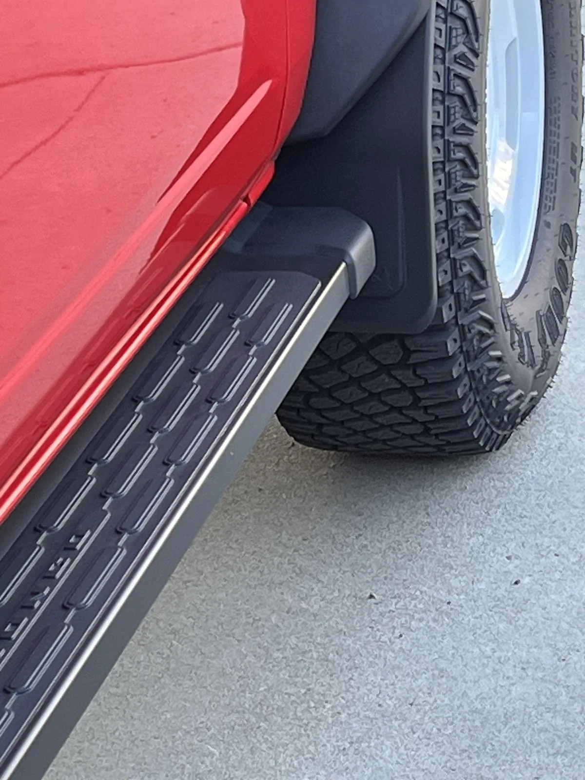

I did the step mod to raise the steps 1” and installed IAG front mud flaps to hopefully keep the slush out of the door handles.
Ford Bronco My Race Red Heritage Edition 2024 Bronco Build & Story IMG_7951

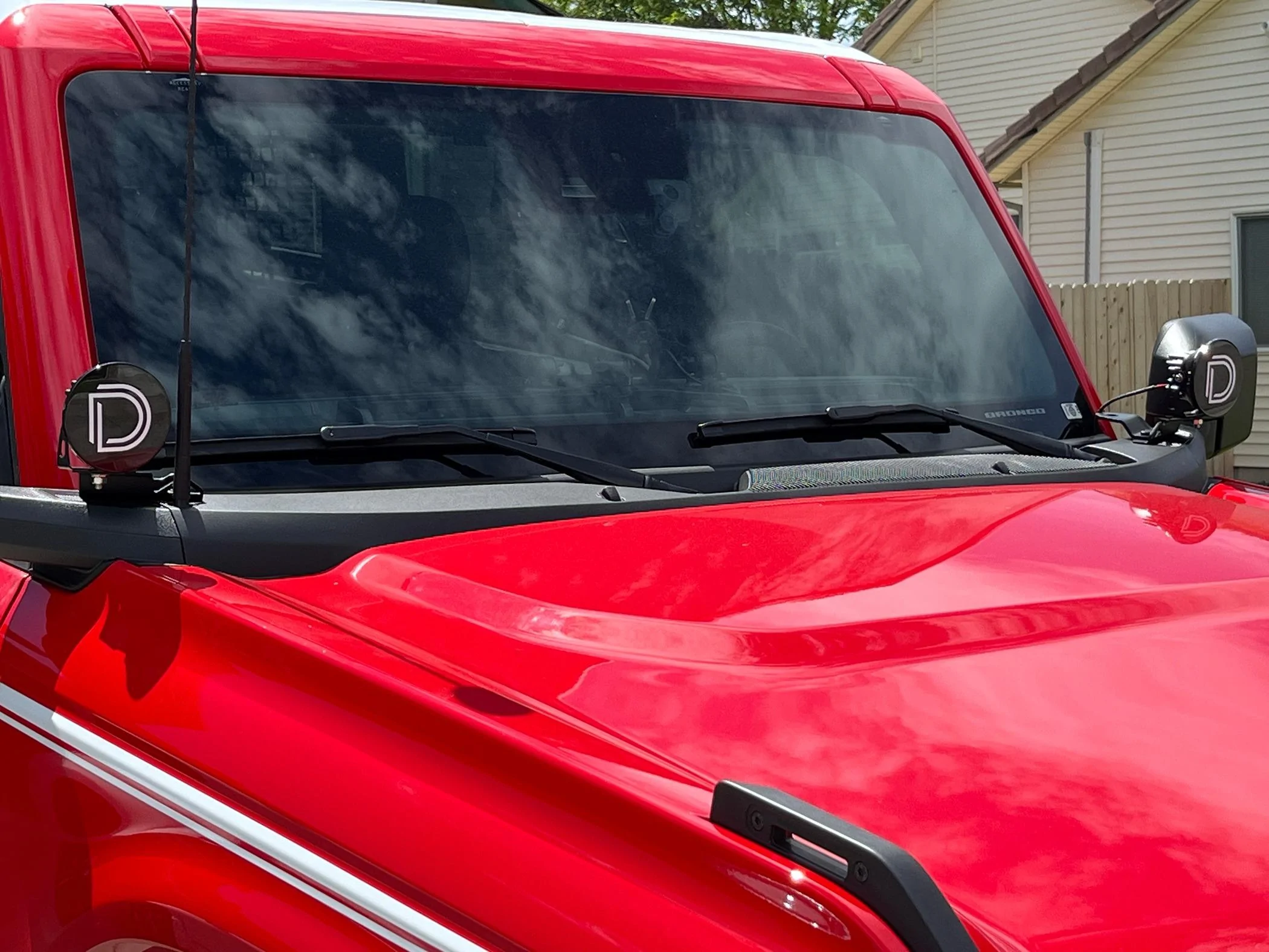

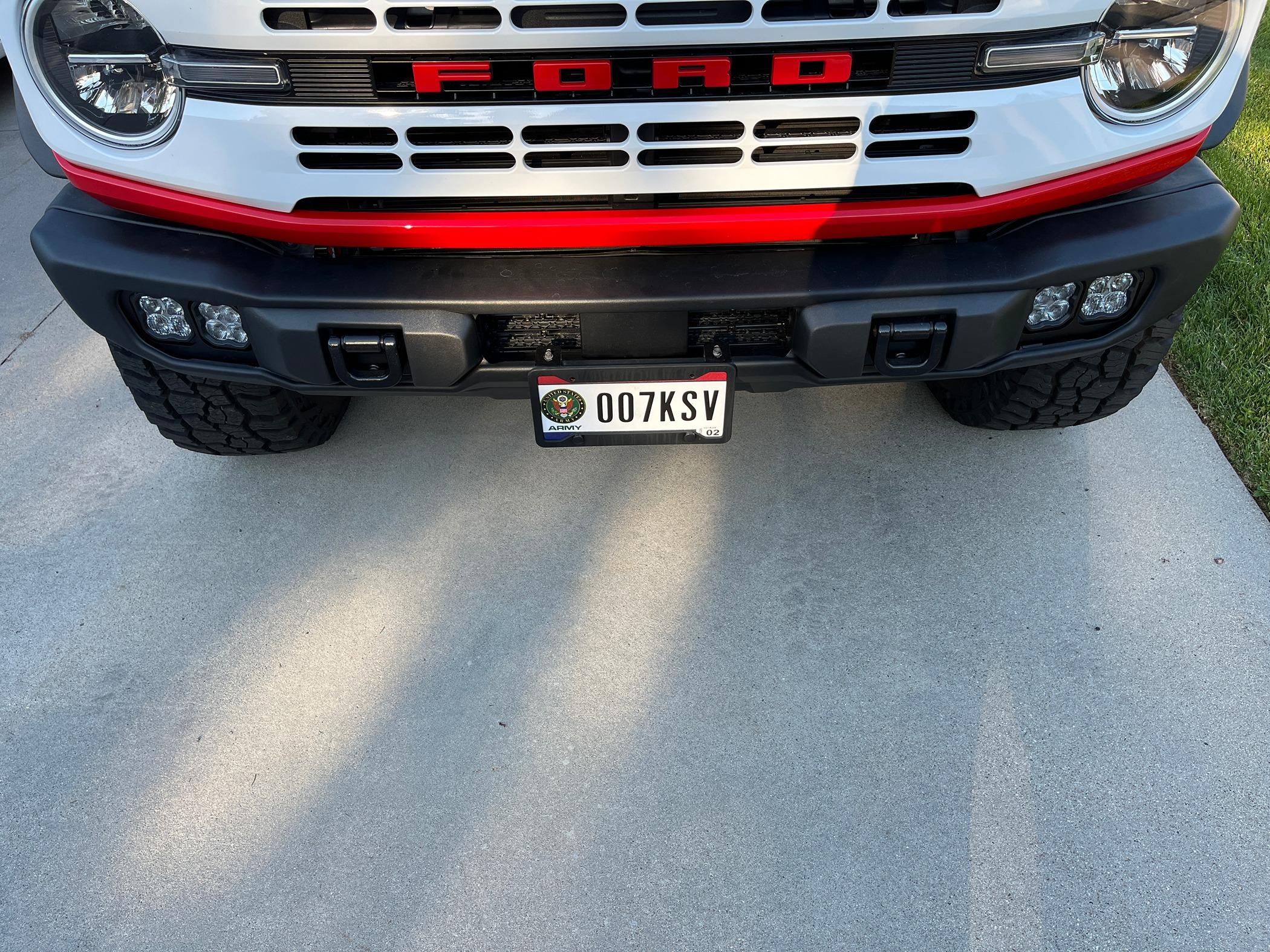

As I mentioned, I chose the standard lighting package, but I need off road lights as days are short during Chucker and Hun season and it gets a tad dark in the Owyhee’s. I went with Diode Dynamics SS3 MAX driving on the A-Pillar’s mounted on Mountain 2 Metals brackets, SS3 MAX Fog and SS3 MAX Combos in a 4X4LED’s bracket in the bumper. The Fog lights are wired to the stock fog light switch and the Combos and Driving lights and switched.
Ford Bronco My Race Red Heritage Edition 2024 Bronco Build & Story IMG_8084.JPG
Ford Bronco My Race Red Heritage Edition 2024 Bronco Build & Story IMG_8095.JPG

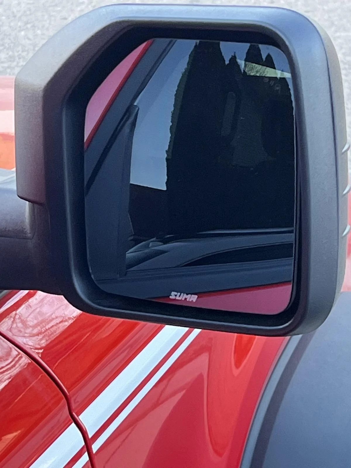

I was fortunate enough to get in on the Suma mirror group buy and though it took a bit to get used to how dark the standard gray is, I’m very happy with them.

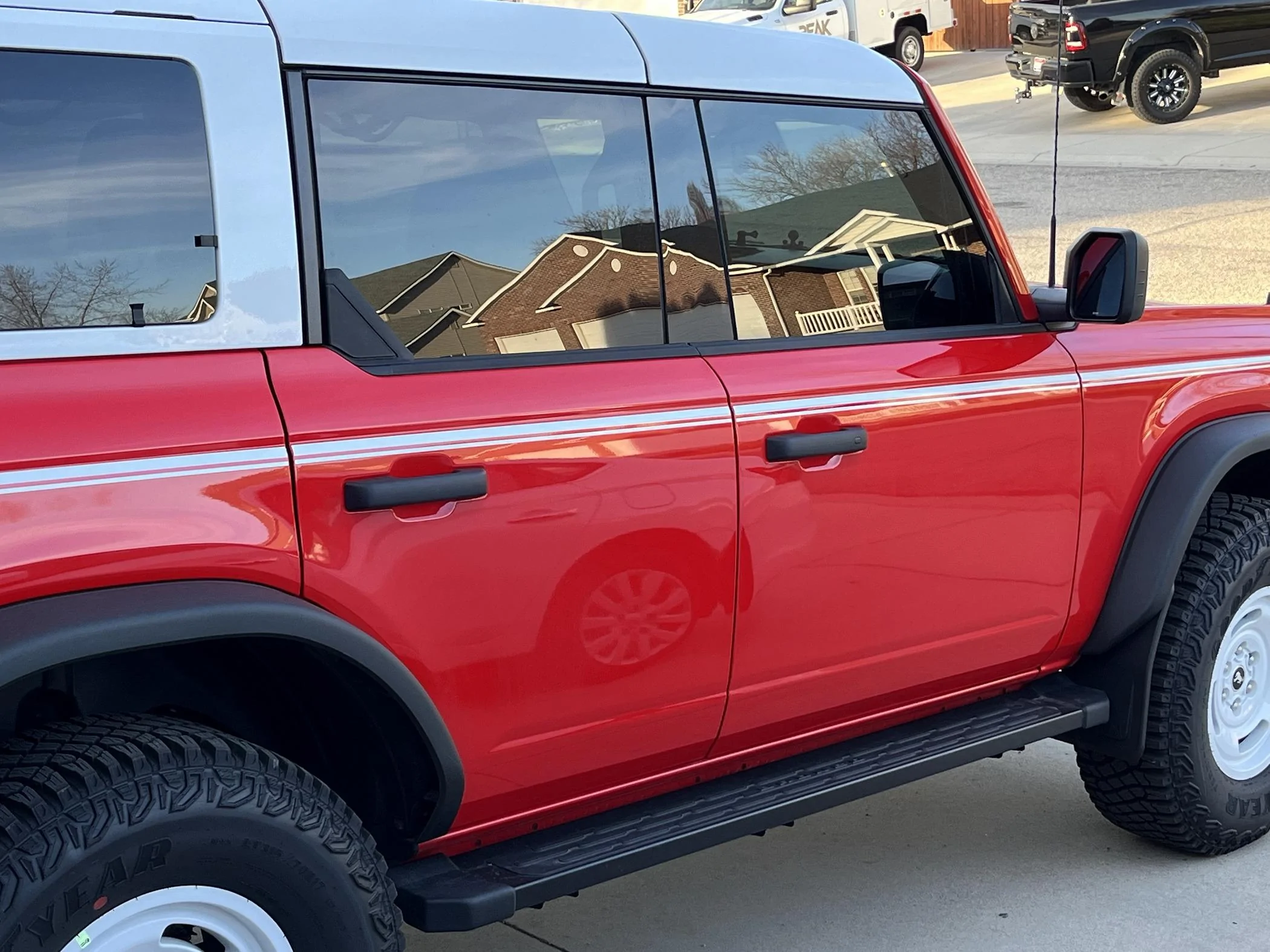

Before summer hit, I decided to have the driver’s and passenger’s front widows tinted to match the rear. In addition, I added high gloss B pillar trim covers to match the tint.

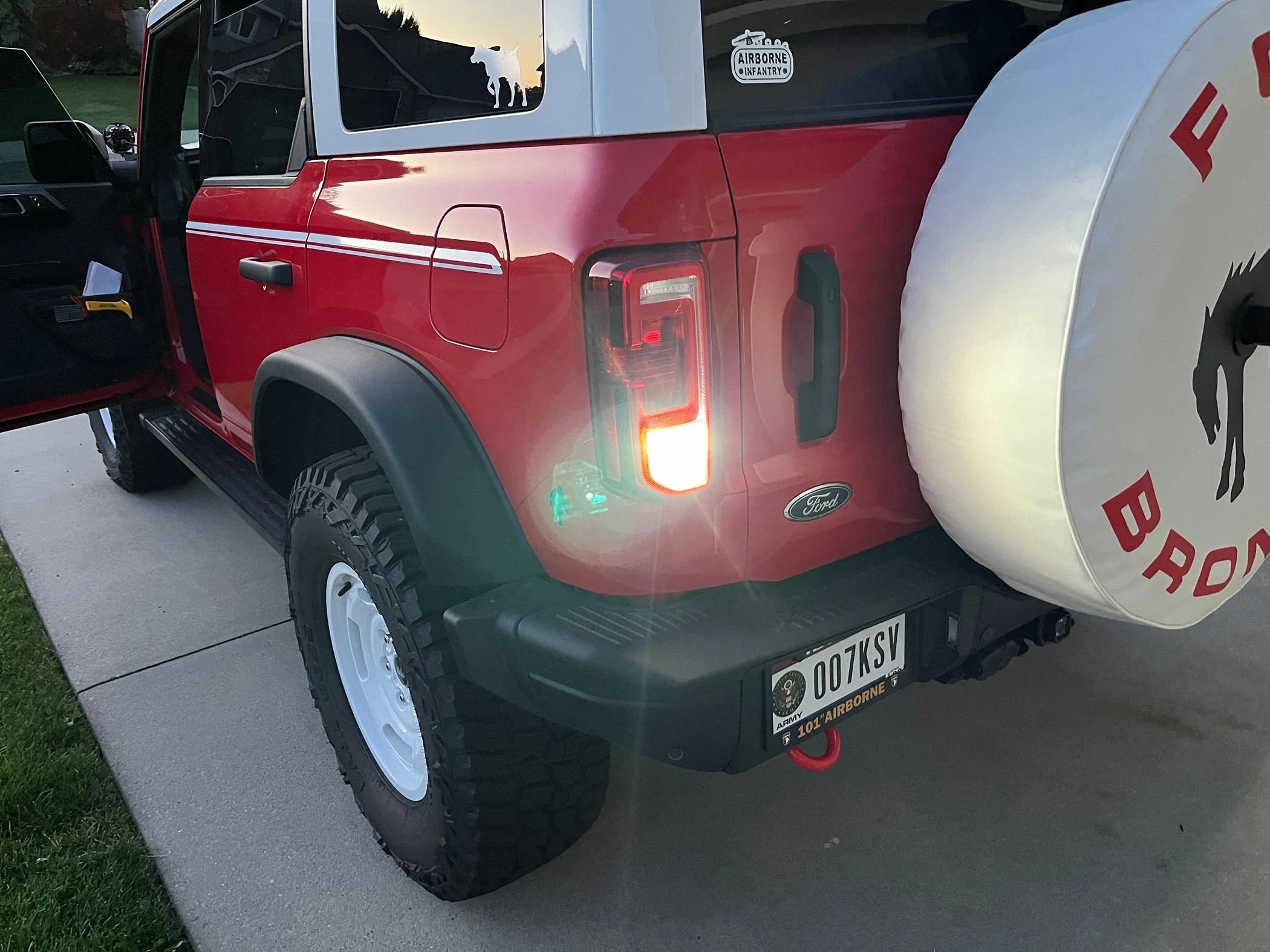

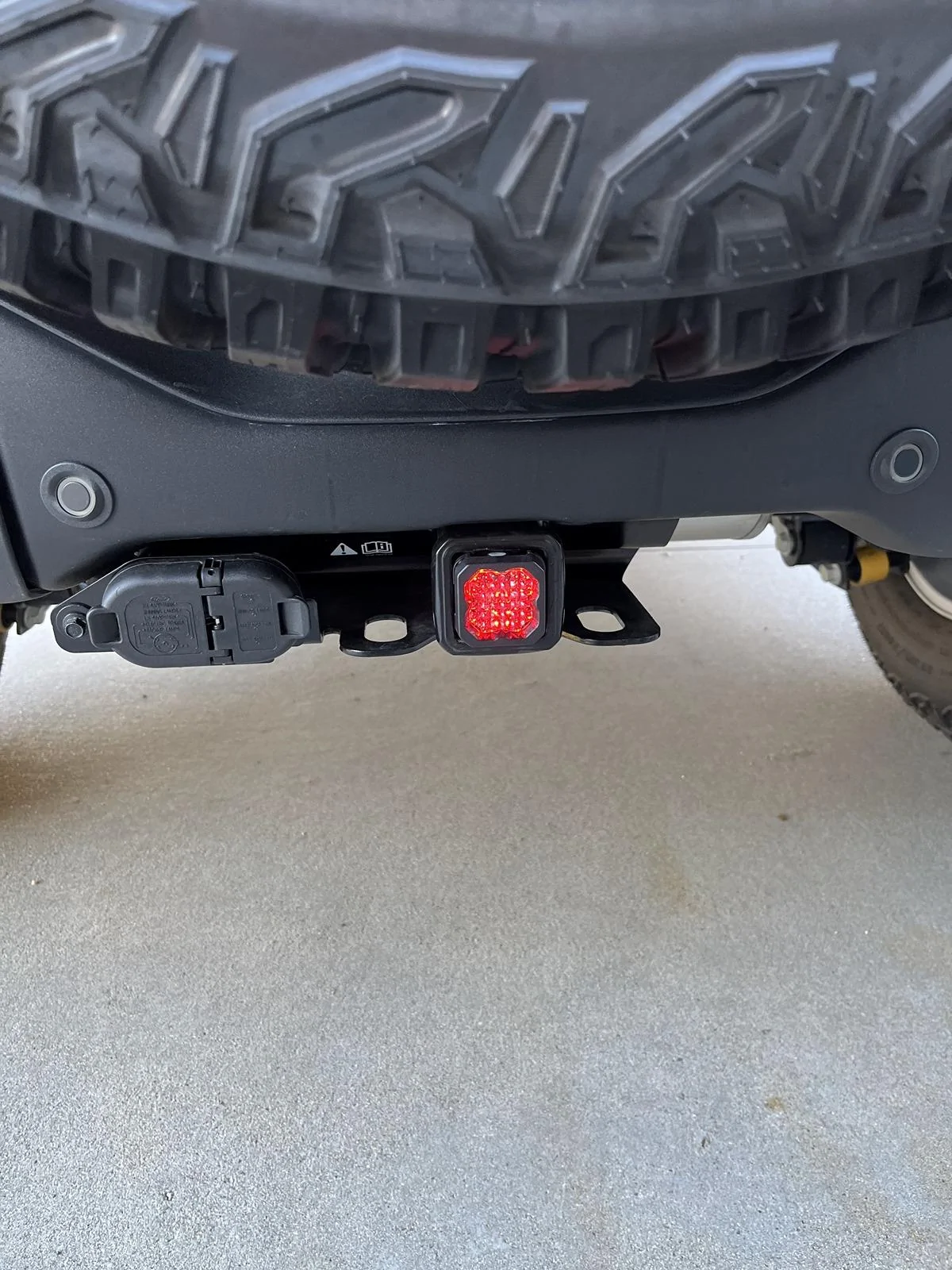

The stock rear taillights are abysmal at best, and the backup lights were even worse especially with the Tint/Suma mirrors. I installed the Diode Dynamics hitch light and LED backup bulbs from F150LEDs and it made a world of difference without washing out the camera. I used the Magic harness to put the backup lights on one of the factory auxiliary switches.
Ford Bronco My Race Red Heritage Edition 2024 Bronco Build & Story IMG_8112.JPG
Ford Bronco My Race Red Heritage Edition 2024 Bronco Build & Story IMG_7950
Bulbs from F150LEDs replaced the stock tail/brake/turn bulbs. I used 3M double sided tape to mount the resistors. One thing that I always do is use a heat gun on the tape as it helps the adhesion considerably.
Ford Bronco My Race Red Heritage Edition 2024 Bronco Build & Story IMG_8111.JPG

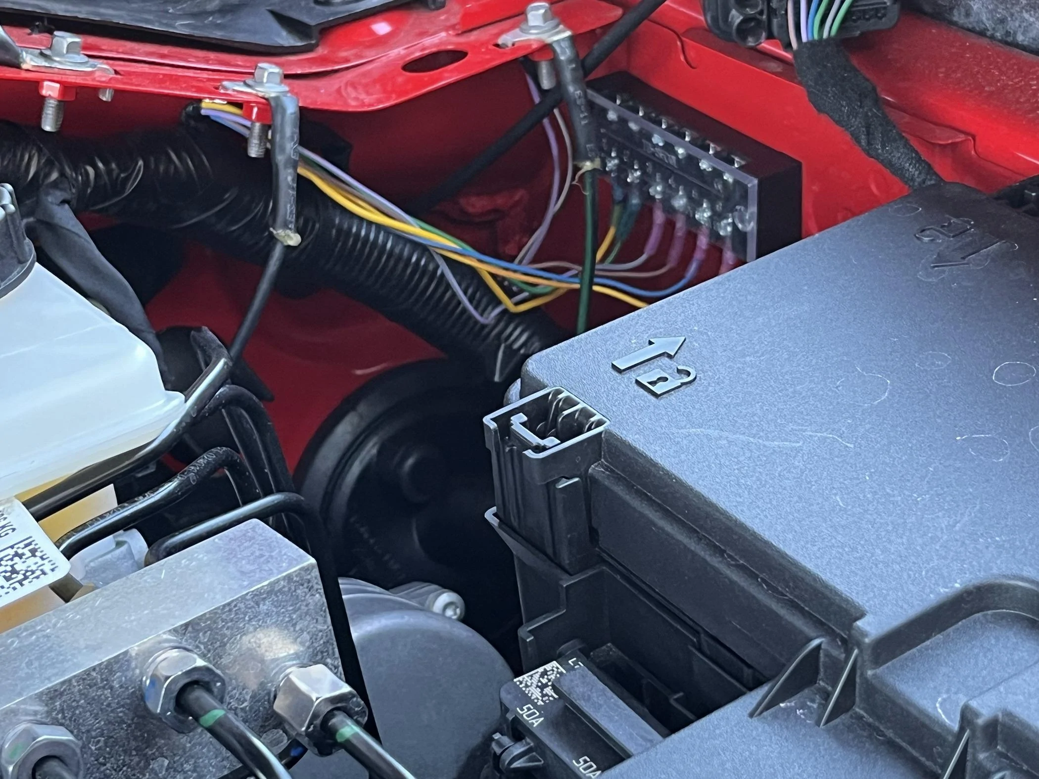

As I mentioned, my list was in no particular order, and neither were my upgrades. I decided to wait until I had most of it done before starting a build thread and show the exterior and then interior modifications.
I did add a 6 position terminal strip for the factory auxiliary switches. I made it much cleaner and simpler to wire.

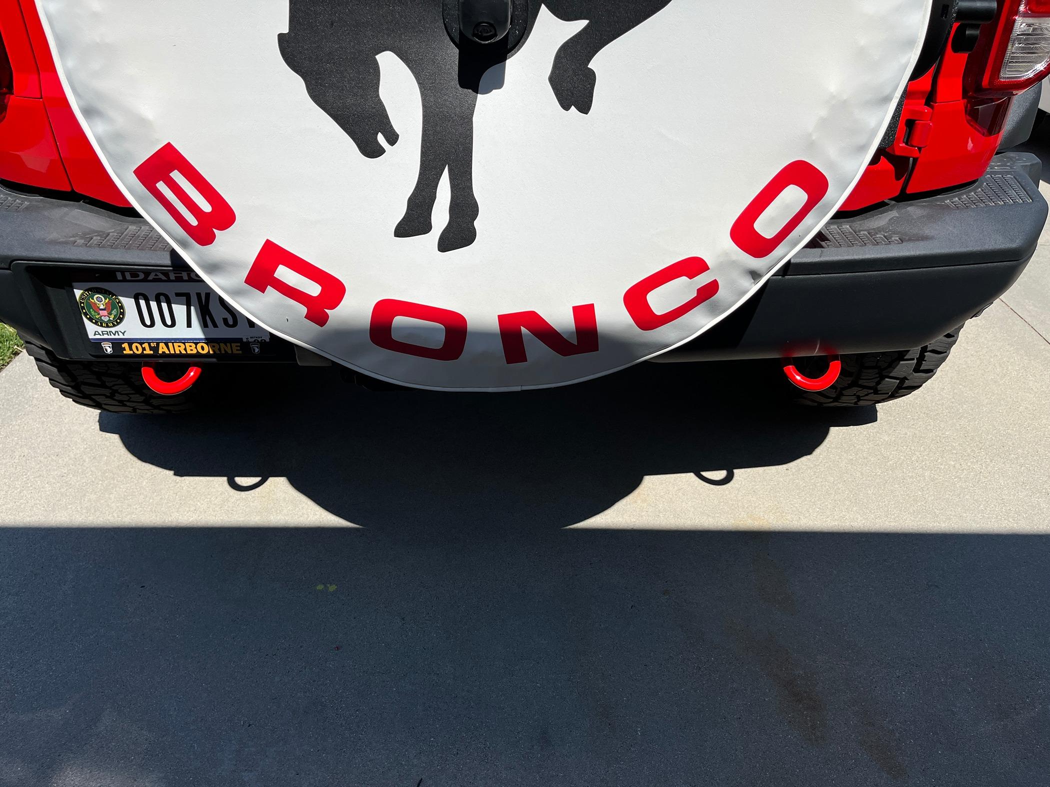

Last on my list for the exterior is tow hooks. I removed the standard single black loop and replaced it with a pair of Ford Performance Red tow hooks. I have a pair of the Ford Performance front tow hooks currently on order and will post them after the install which I trust will be next weekend.
