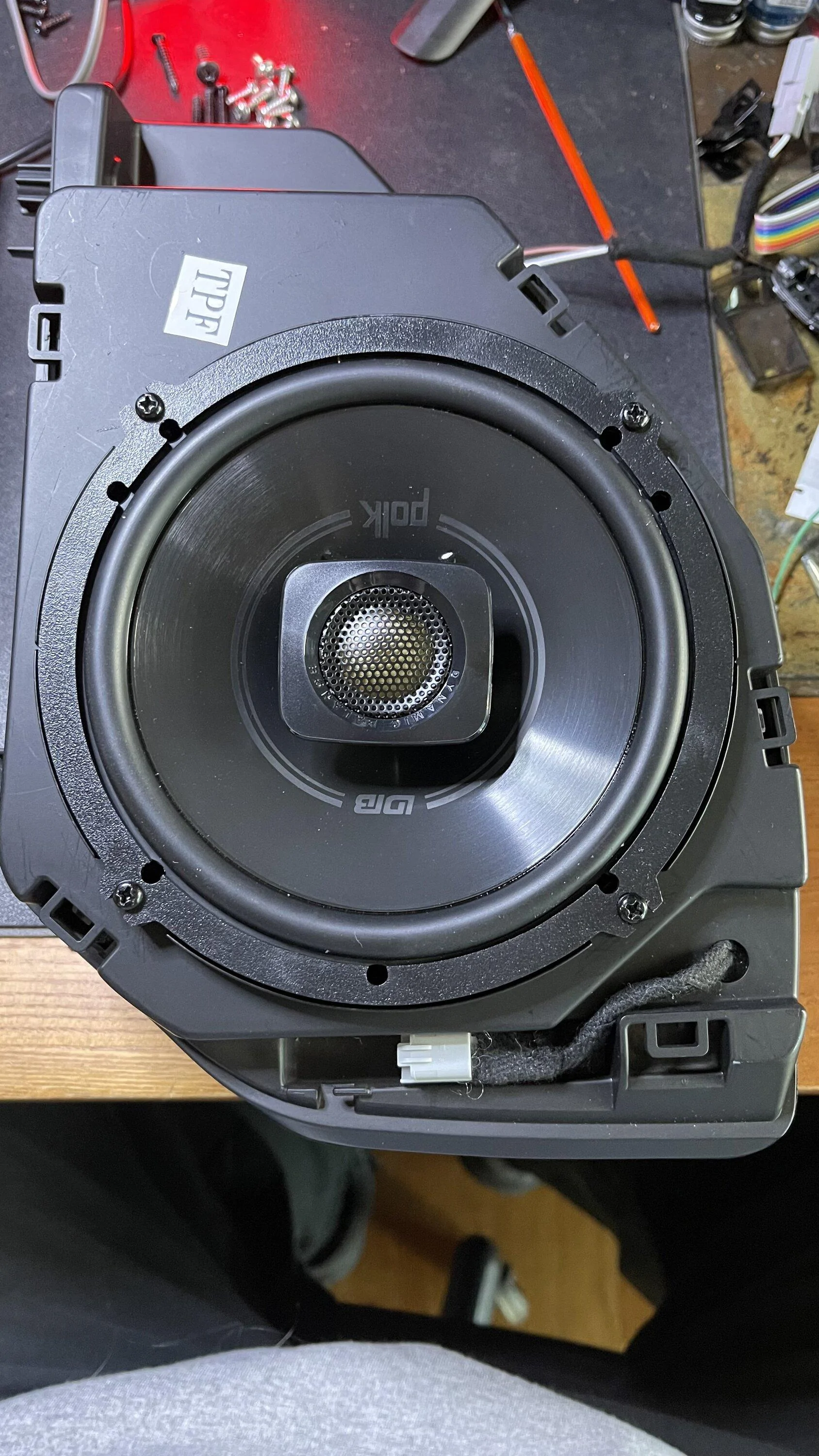

I had no troubles with the PlugNPlayKit harness, despite their not including any instructions. I mounted the Kicker Key on the backside of that metal bracket under the steering wheel- the one you see when folding the dash trim down. The Key and the speakers were pretty smooth sailing. The footwell speakers being the only hassle. The mounting holes in my Polk speakers weren’t aligned with the three holes the factory speakers use. Polk includes a plastic adapter ring to accommodate the three factory screw points, and it wasn’t any kind of issue in terms of fitting flush behind the speaker cover, but if I’d used nuts and bolts to secure the plastic ring to the speaker frame, they’d have scratched the underlying metal, and so I decided to JB Weld them to the speaker frame. Time will tell if that is a good idea, but so far I’m pleased with the fit and nothing rattles or scratches. What CAN’T JB Weld do? :)

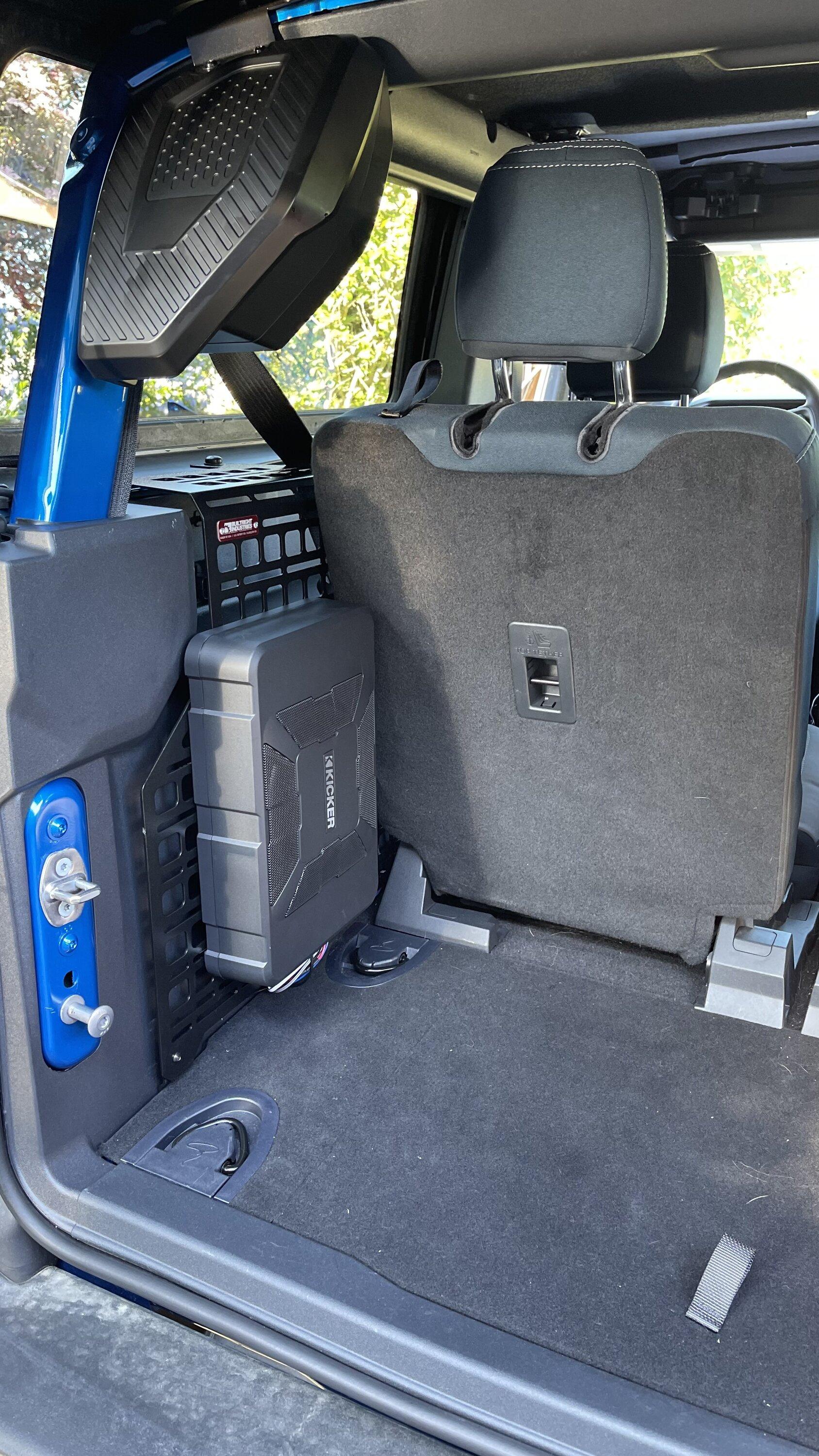

On to the subwoofer, I wasn’t wanting to mount it to the back door for a few reasons- I’m going to eventually find wheel and tires that I like, and I expect they’ll weigh more than stock, and I’m not sure adding more weight to that tailgate door is helpful. Also, if I jack-rabbit a start from a light or something, I don’t want my dog or groceries or whatever to slide back into the subwoofer. I was looking for a side mount, and ended up using a MOLLE panel on the drivers side. The woofer fits (just) without interfering with the rear seat. It might be overkill, but nothing rattles, and it’s really solidly in place.

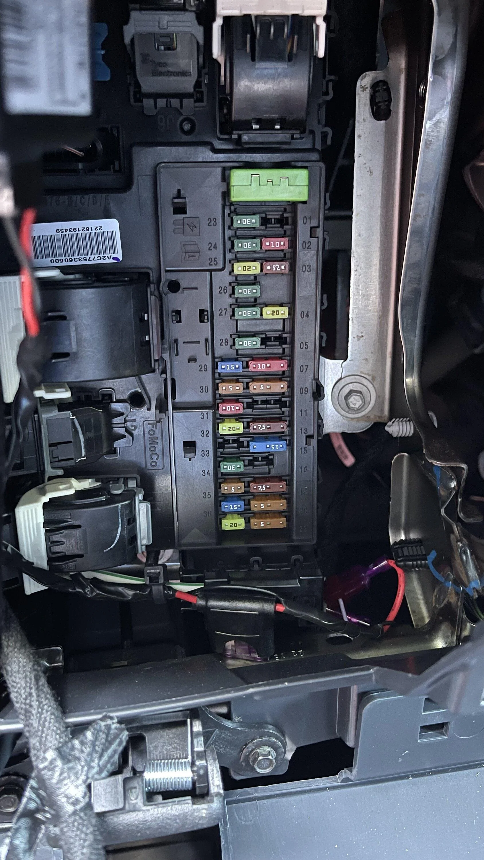

I reached out to both Kicker and PlugNPlayKits, and only Kicker ever responded. They asked, where does the blue wire go? Huh? The blue wire that doesn’t attach to anything? THAT blue wire? Heh. Yeah. I misunderstood the Kicker documentation and thought the speaker signal was what would tell the sub to turn on/off. No, it needs a 12v switched circuit connected to that blue wire, so I read in another thread here about where I might find a good candidate. That feels like the kind of thing that would have been in my missing instructions. I read a thread from user SPITmadFIRE [https://www.bronco6g.com/forum/threads/tutorial-wiring-accessories-to-interior-fuse-box-with-add-a-fuse-tap.32486/ ] about tapping the window fuse (fuse number 2) for the switching signal, and thought that was a really good choice. This way if I arrive somewhere and turn off the car, it stays live until I open a door. I ended up buying an assortment of taps to get the “Micro 2”, so if any of you are near Tacoma and need one, I have spares I’ll likely never need or use- give me a holler.

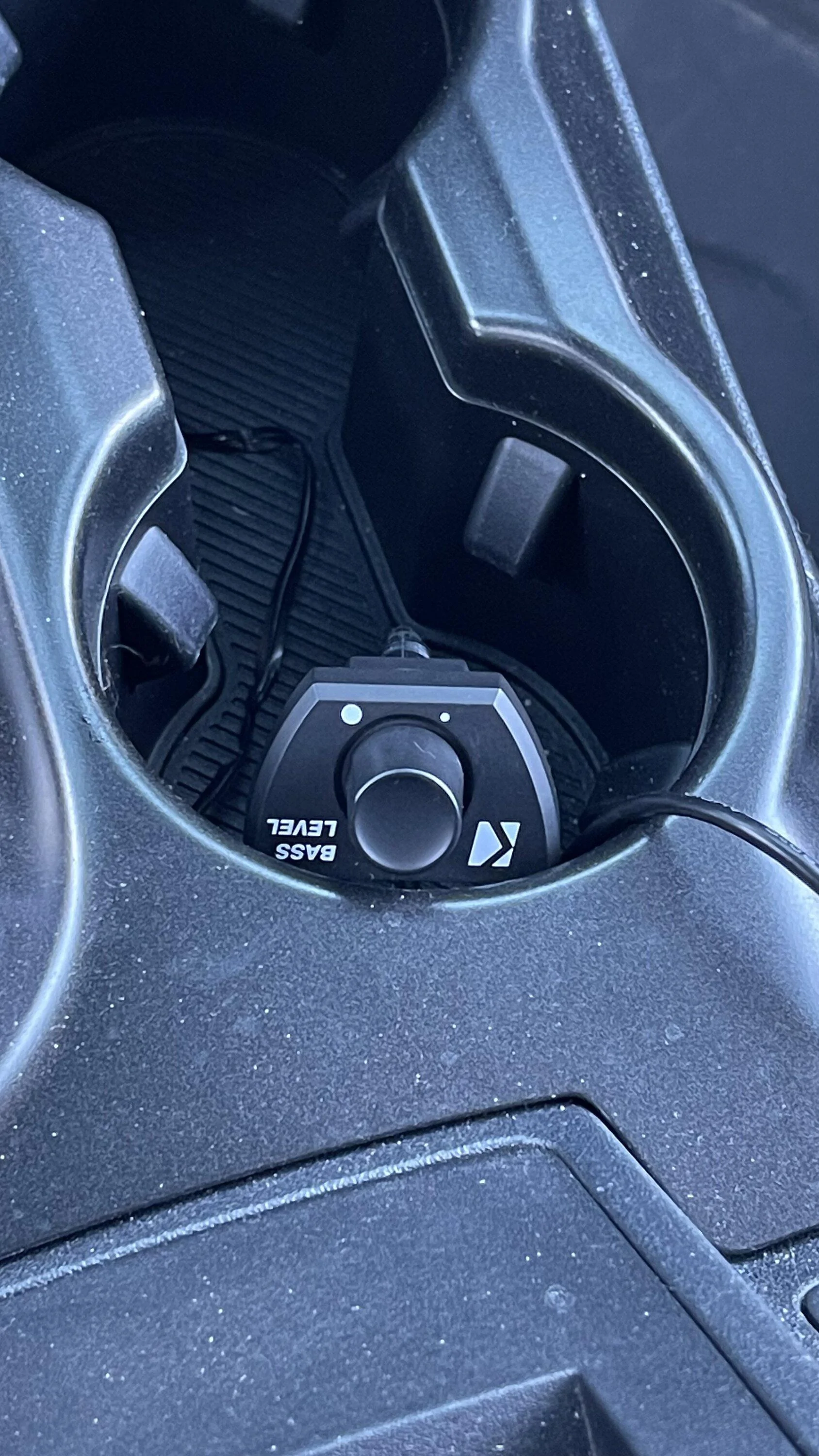

How does it sound? Fantastic! There is so much more… “oomph”? Yeah, but that’s not the entirety of it. The factory sound is not just weak, it’s losing detail- things that I know are in the song from other listening experiences are now audible in the Bronco. Soundstaging was never great, but it’s better. Initially I was going to leave the factory footwell speakers, but I’m so glad I didn’t. Those were anemic as hell. “12” is now a reasonably loud sound level, and while I haven’t measured a frequency response, the improvement is immediately obvious. The last little detail is where to mount the bass control knob. I have it loose in a cup holder at the moment, as I think about it and tinker. I don’t think it’ll be a thing I need to adjust often, so I’m thinking an out of the way place is probably the answer. Maybe in the arm rest cubby? I’ve seen others mount this to the dash, but I’m not convinced that real estate suits the occasion.

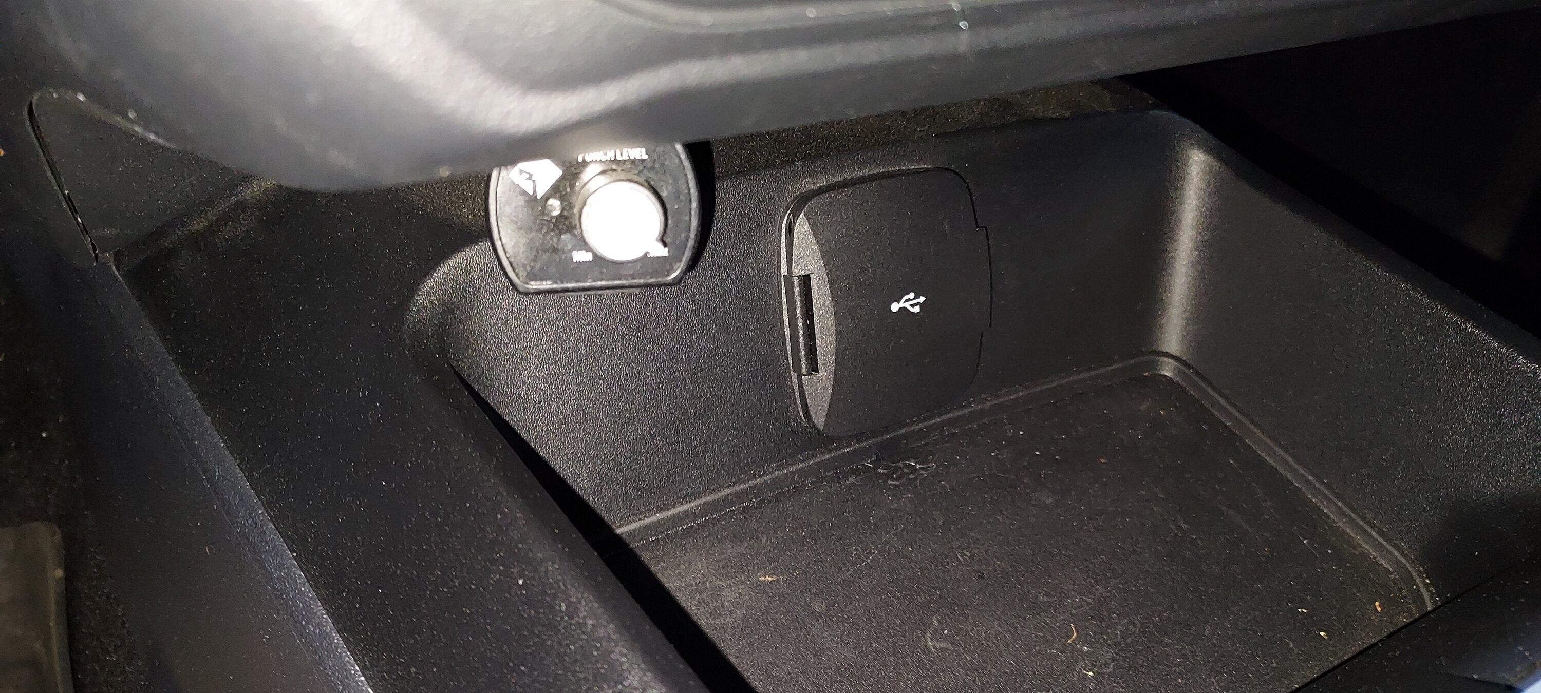

Oh, forgot to mention, bass control is mounted with double sided tape velcro under the dash where the phone jack is. Drivers side obviously for easy access.
This is where I have mine too. Nice & clean.
How much bass are you getting back there from the HS8 Sub?

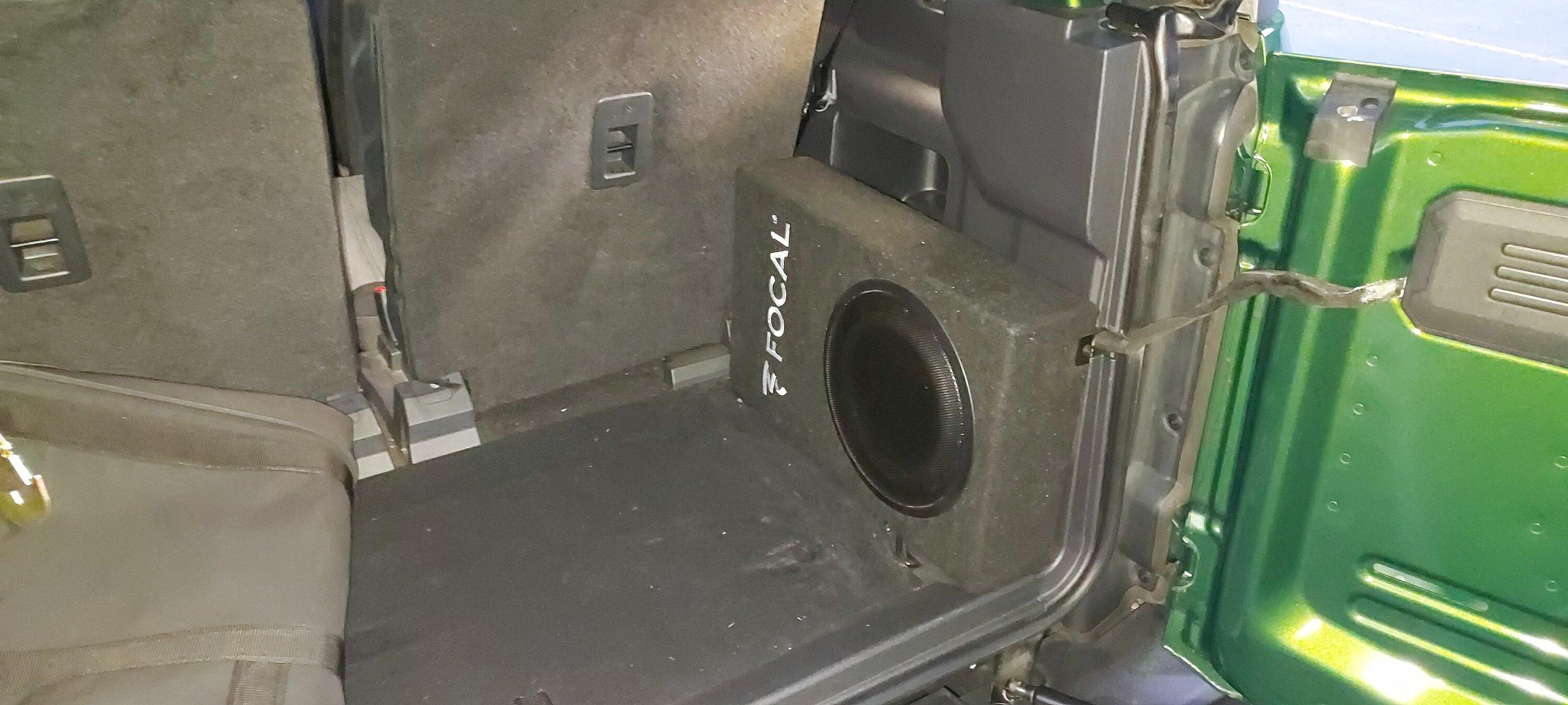

Hey Kevin. The parts and install cost me about $2300. Super clean.
Couple pics of bass and control.
Ford Bronco My stereo upgrades -- very pleased with results using PlugNPlaykits, Polk, Kicker 20230609_054419
Where did you get the sub, what's the size, and do you have it mounted/secured?

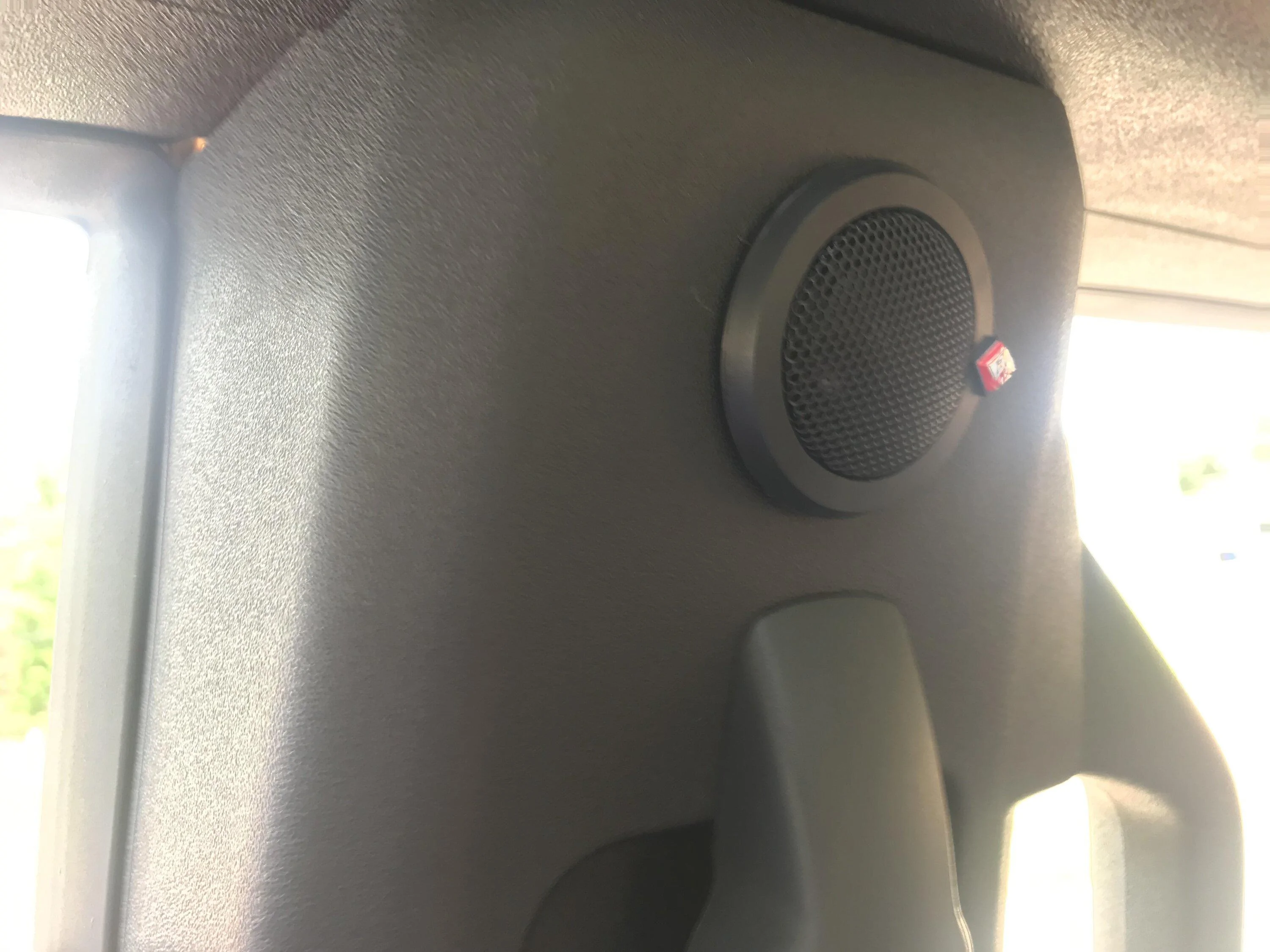

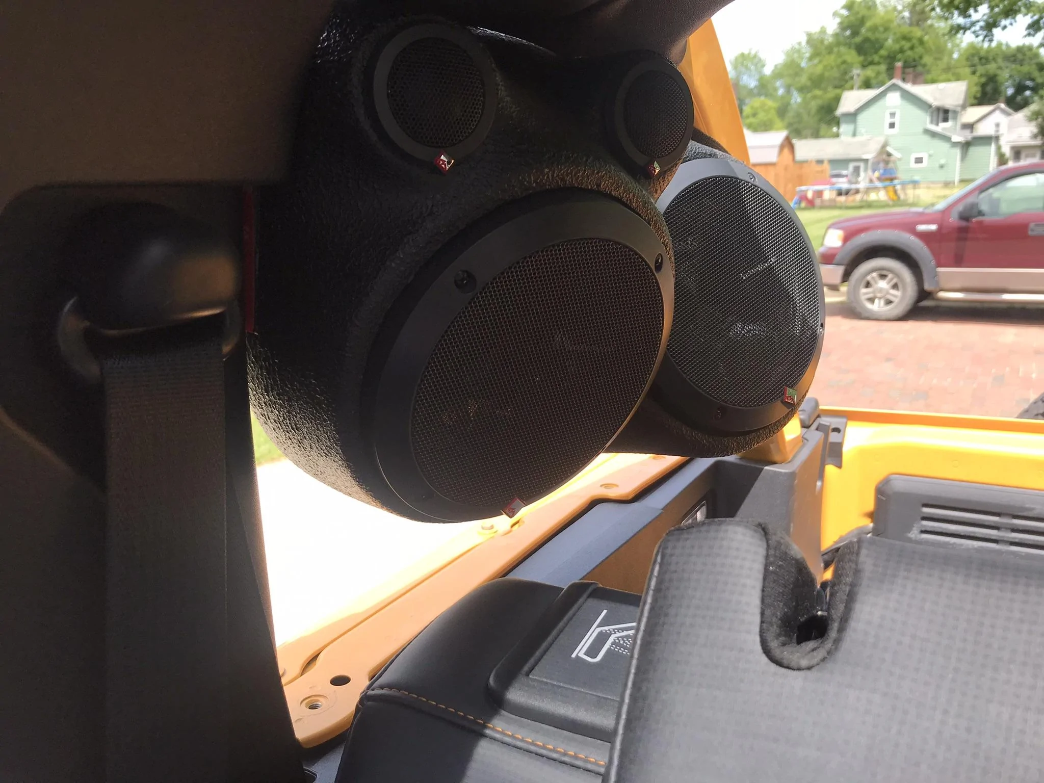

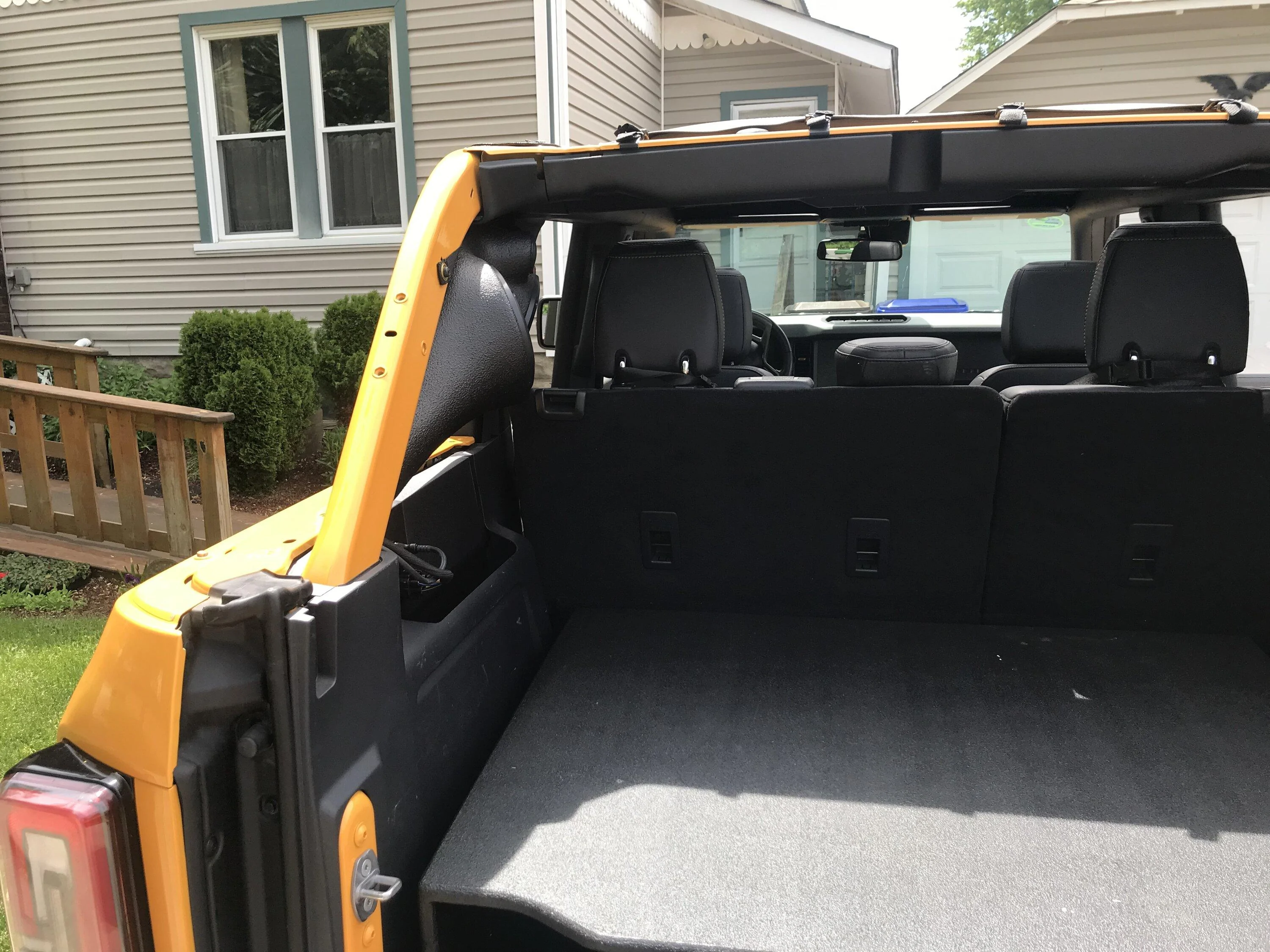

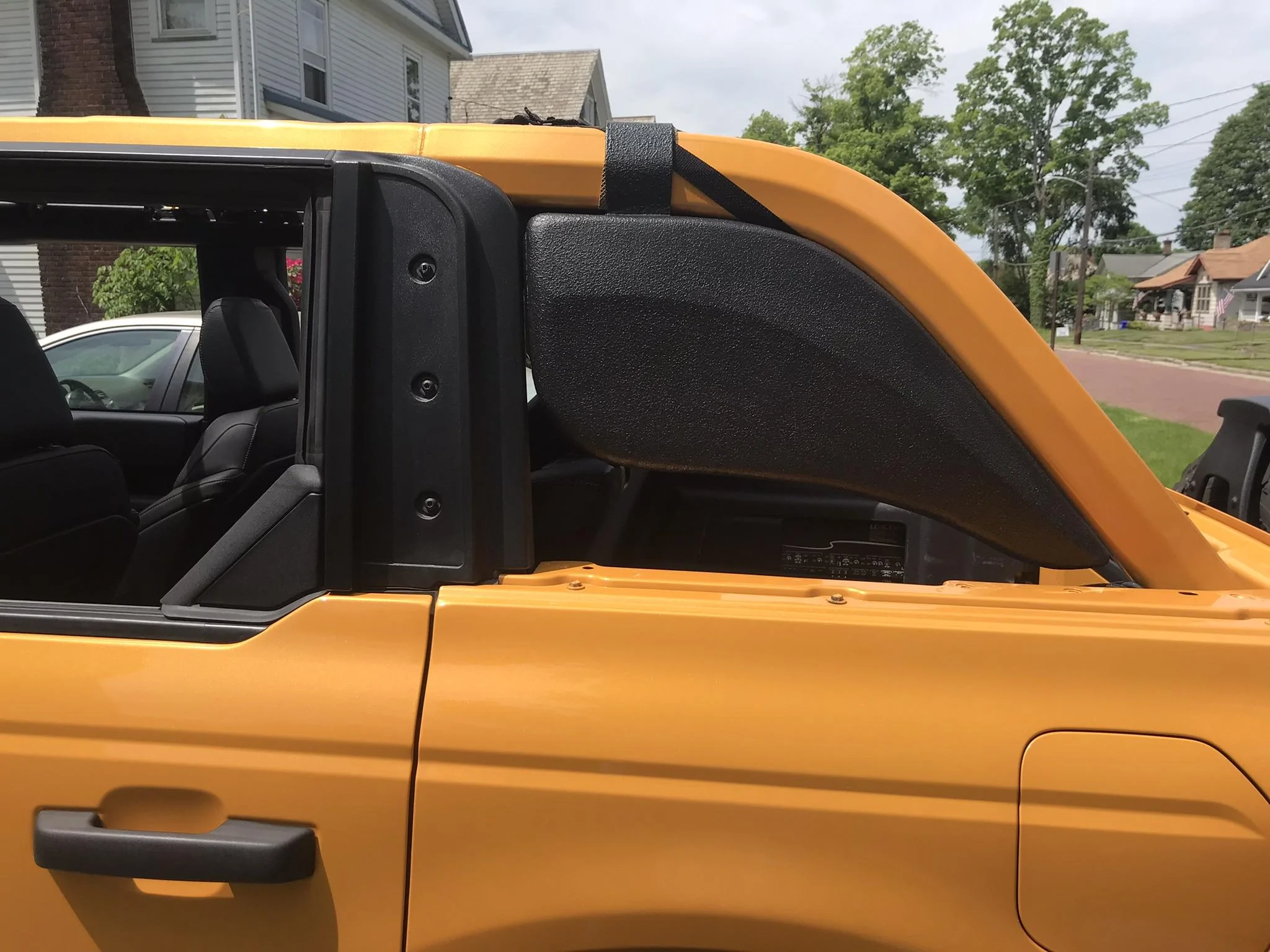

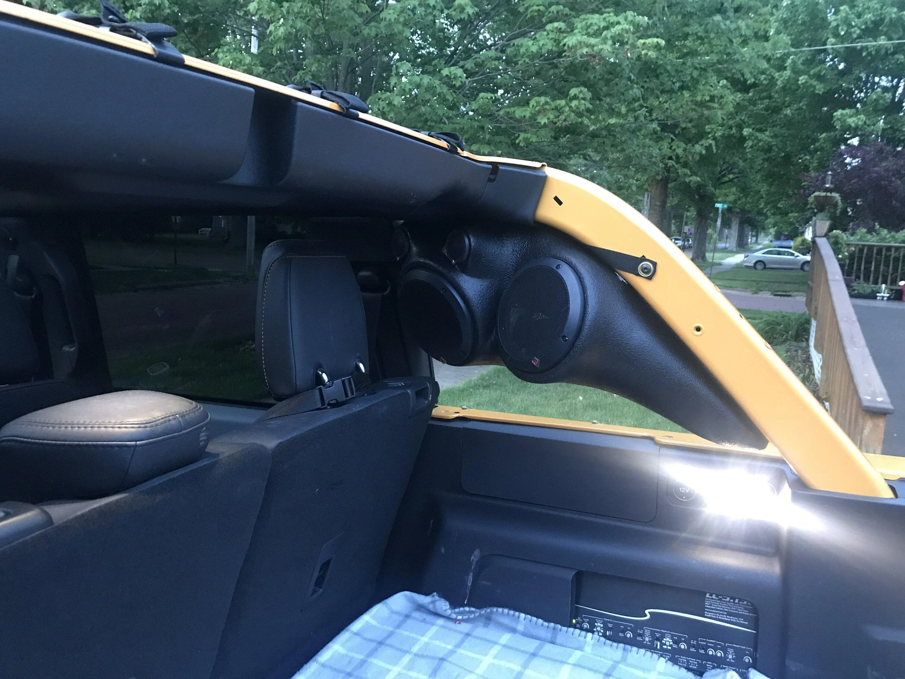

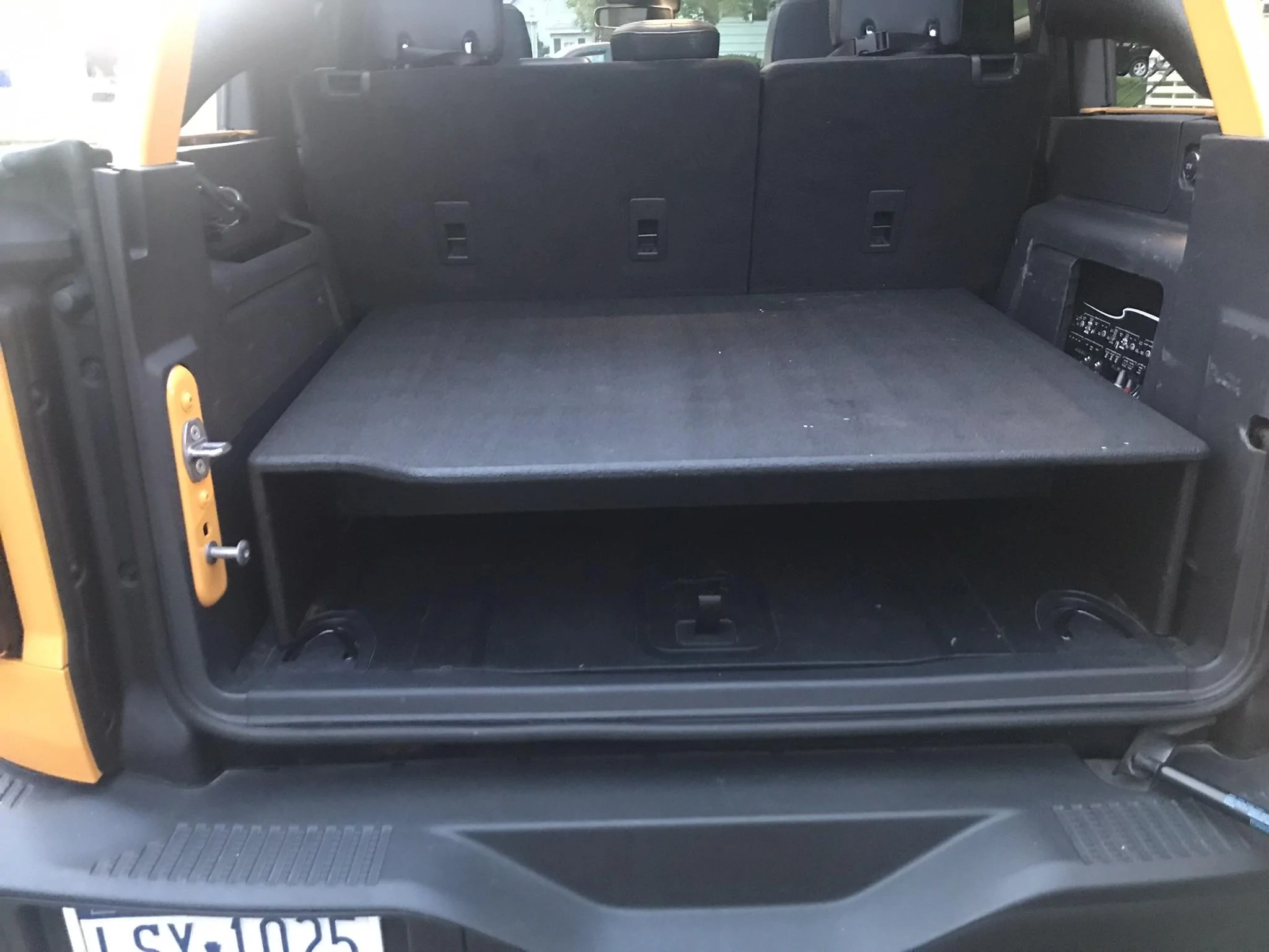

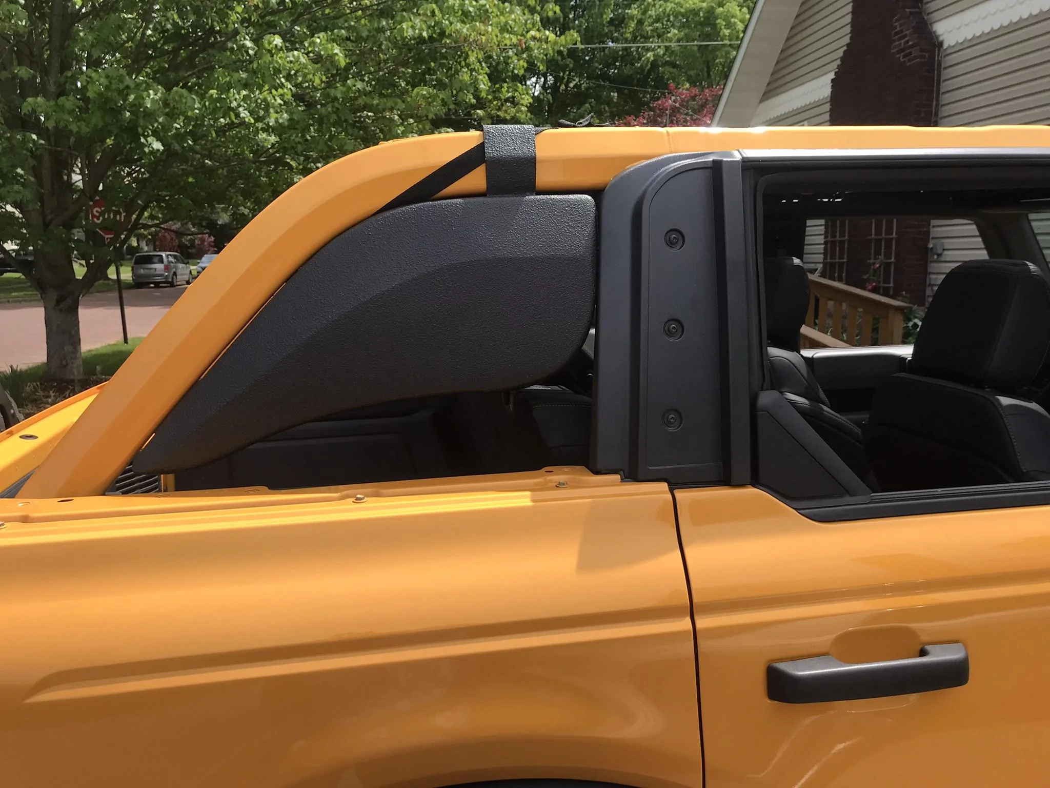

Looks great I have been working on my since I have received my bronco. Plug and play kit is awesome with an epicenter and all rockford Fosgate speakers 4.5 two way in dash 6.5 componant speakers in kick panel and tweet in door post up by ear. Made pods to fit in roll cage with 4 6.5 and 4 1” tweeters hooked to a audio control lC 5.1300 then 2 12 p3s in down firing box on a audio control LC 1.1500 it sounds great
Nice!!
Part of me wants to do something like that but trying to force myself to stick to my original budget. There is other stuff I'd like to buy for the Bronco... and if I dont stop myself I could easily sink a few thousand dollars into it.

Yes but it sounds so good I love to listen to clear music it adds up fast I’m glad i can make and do all the work my self

Wow! Those pods you made are amazing! Do you have a vacuum forming machine, or are these 3D printed?
