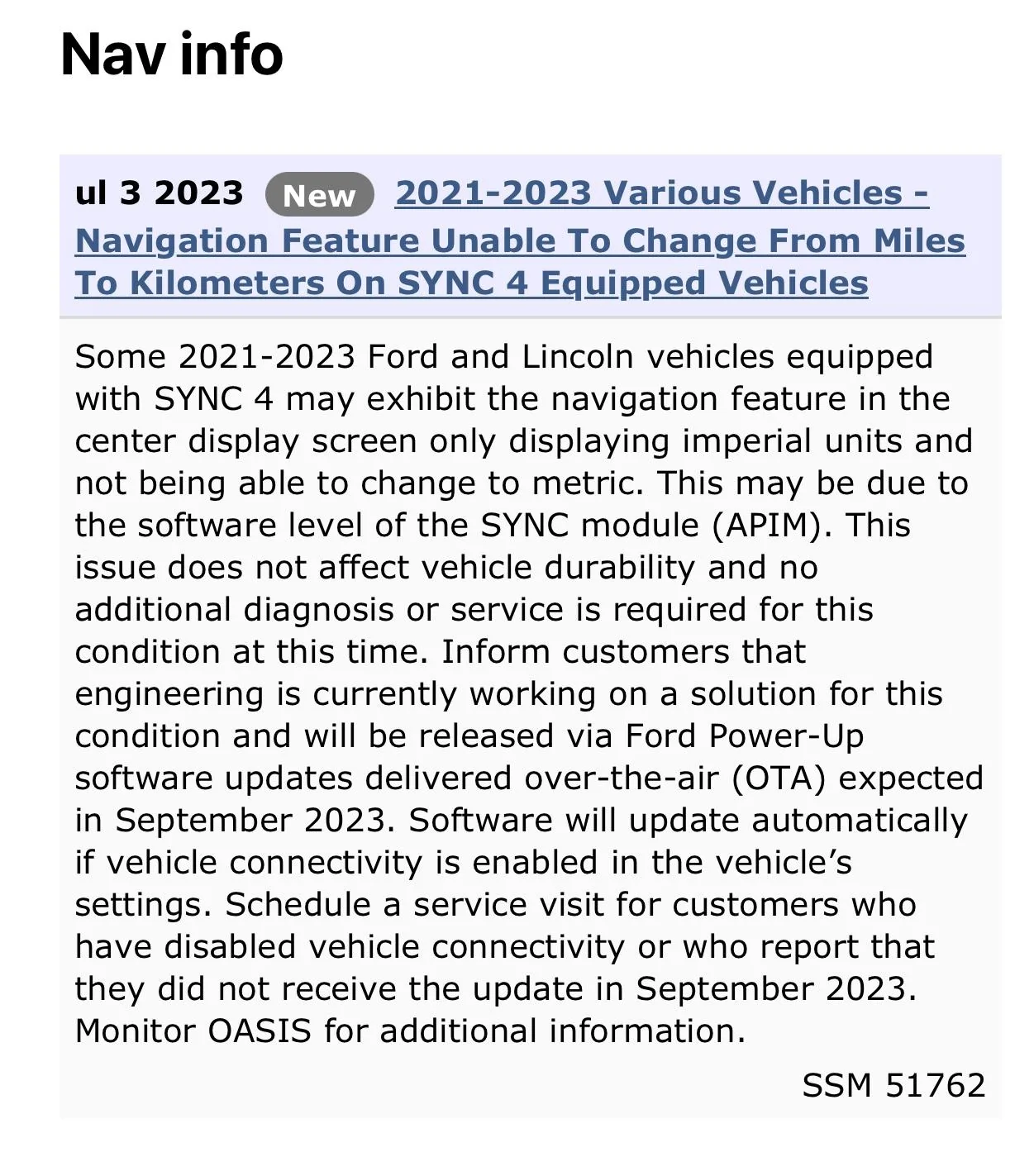

I had asked my dealer about this a while ago.. got this info today:
Ford Bronco Nav in miles? IMG_4460
Thanks for the update. I’ve been using my nav a lot lately and I was wondering if Ford was ever going to fix the issue.

I can confirm that the newest Ford Power Up resolves the issue. I had 4.2.2 installed overnight and now its no longer in miles.
