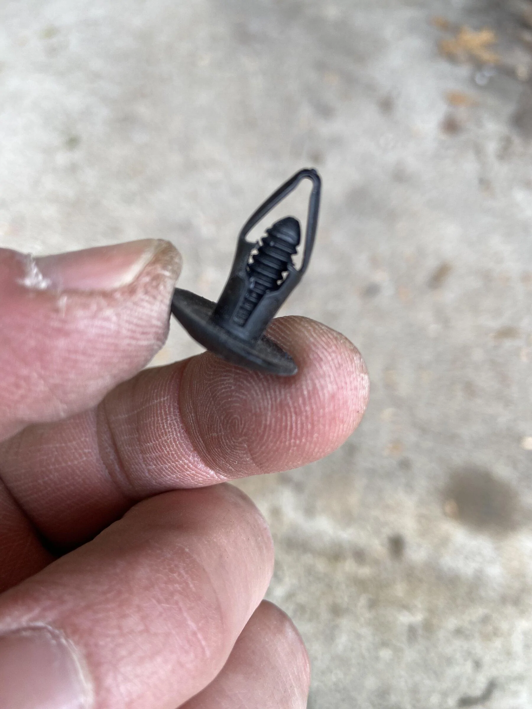

That’s a factory push pin from the wheel well that goes through the liner…. I removed one too many in order to install my front mud flaps and would like to get it back in…. Is there a trick to doing so? I’m missing something here…:ROFLMAO:

you have to remove that screw that is in the middle, then it will go in.

Ha! And come right back out!
well, then the screw goes back into it, after you push that outer sleeve in the hole. ;-) You probably already did that and Im just stating the obvious, just trying to be a helper :)

No, he's right. Back the screw out, push the clip in, then tighten the screw back in so the clip expands.

Ok. I apologize. I’ve been humbled. I’m literally the dumbest person on this forum today. I had no idea this pin worked that way. I thought the Phillips pattern was just for design.
Seriously, I stand corrected, and thank you.
