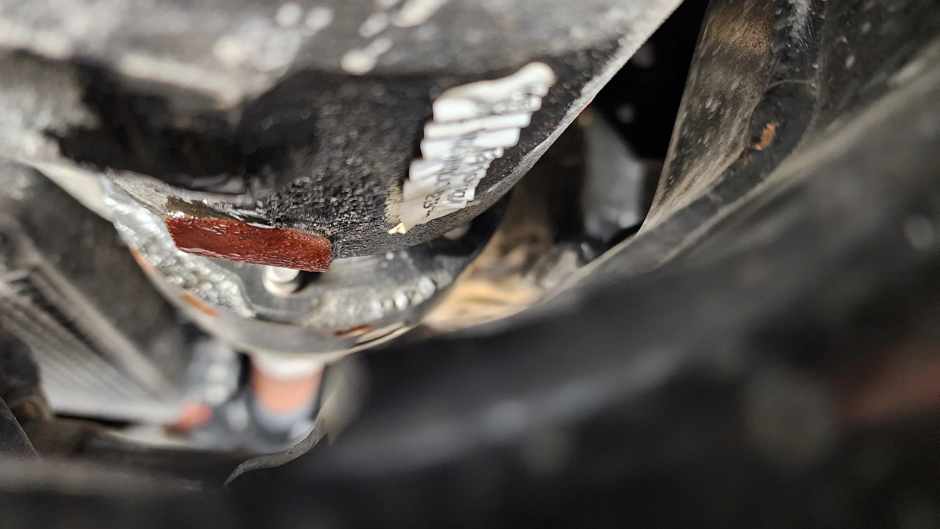

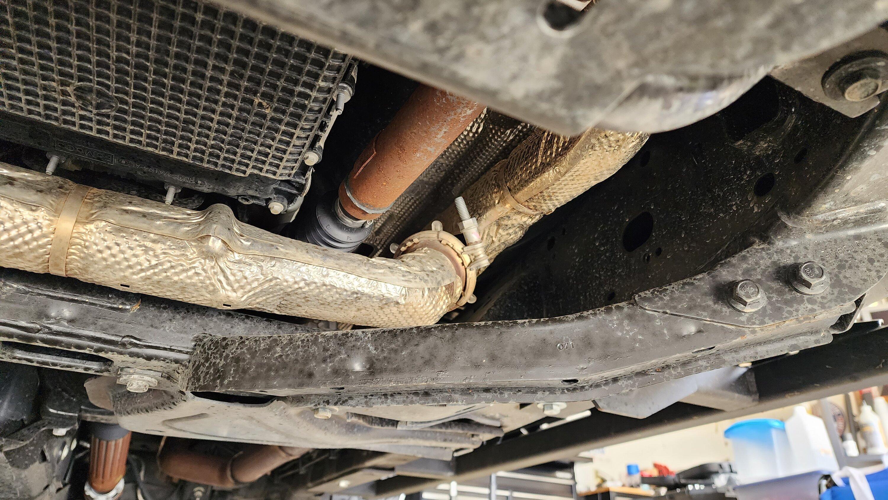

Dealership has had mine for over a week now and hasn't been touched to address the seal leak. Unresponsive to email asking for update. Went by because they close at 7 and it was closed at 6.
Here is image of leak in first picture.
Second picture you can see splatter from gear oil hitting cross member.
