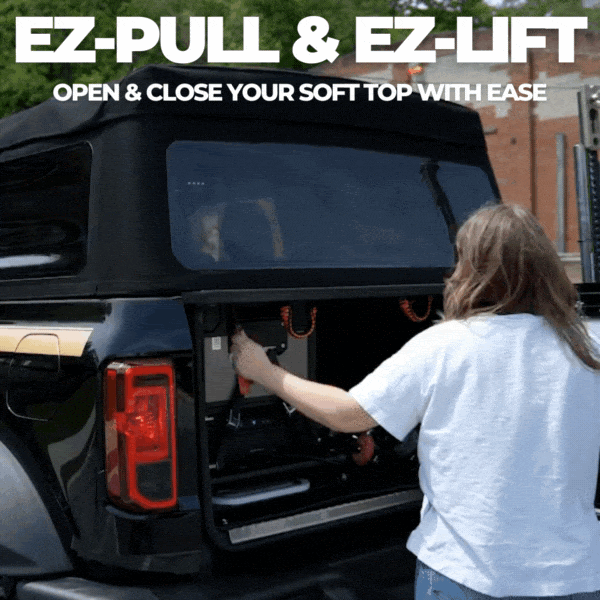

EZ-PULL & EZ-LIFT
2021+ Ford Bronco 4 Door with Soft Top
Save $50 When You Purchase the Combo Instead of Individually
$369.99
$319.99
*Free Shipping!​

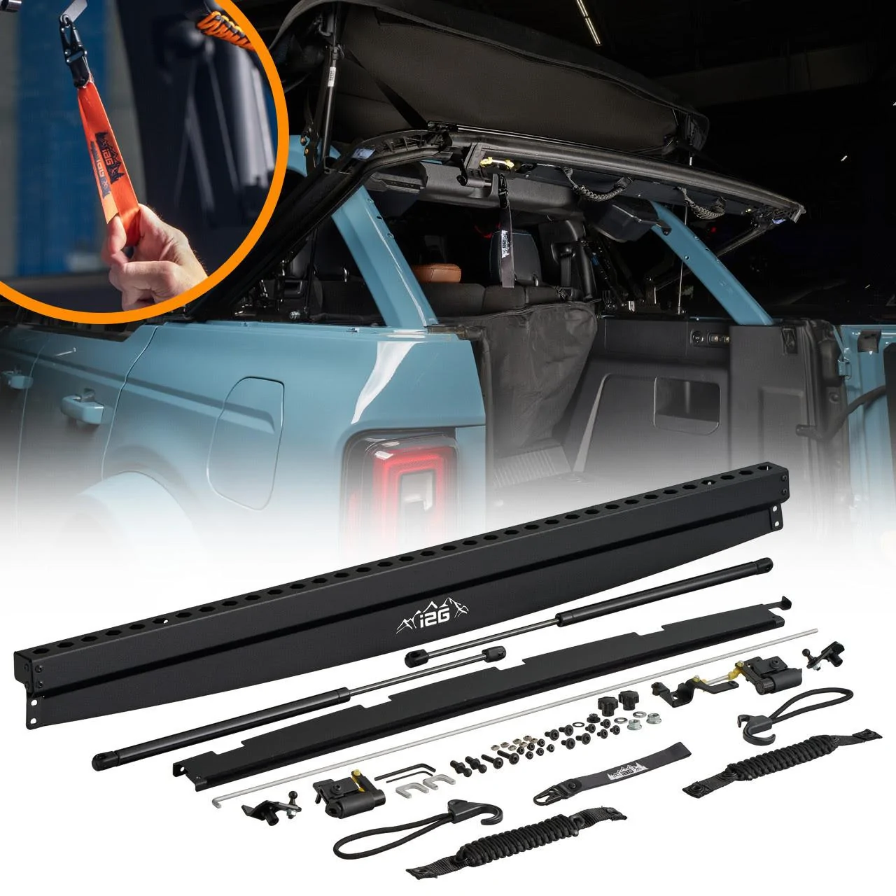

EZ-Pull & EZ-Lift Combo Kit

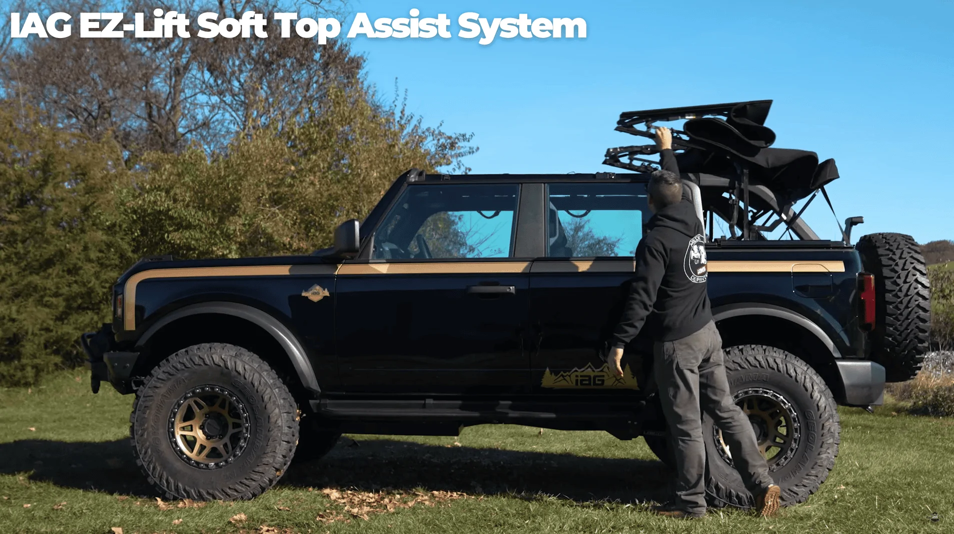

EZ-Lift: Single-handedly open and close the top from the side of the vehicle without having to get help or climb into the back of your Bronco

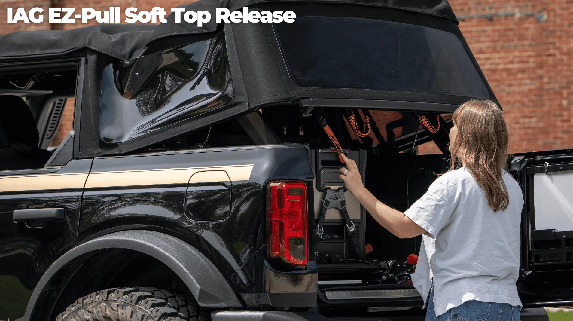

EZ-Pull: Features a single-point release mechanism that allows you to effortlessly open your soft top using only one hand. Your choice of orange or black IAG paracord grab handles.
Easy Installation: Bolts directly into pre-existing mounting points and includes all hardware
Proudly made in the USA with a Lifetime Warranty​

I installed mine over the weekend. Seems really stable and solid, and it's a huge improvement over my own attempt at a solution.
But an important warning to existing EZ lift owners: the YouTube video instructions have you disconnect the EZ lift struts at the very beginning and then reconnect them at the end of the install. However, I was not able to reconnect mine because the decompression added a couple of inches to the length of the strut. It no longer mates up with the connection point on the soft top and it requires WAY too much force to re-compress.
You may want to hold off on your install or get in touch with IAG first, if you do already have an EZ lift installed. I'm eagerly awaiting the response on my support request.

There are a couple of ways to re-compress the struts if you have one of the earlier models that are a bit longer. They definitely have some force behind them, however I find the easiest method is to remove the windows and stand up in the trunk with your head out of the rear window area. From there, use your entire body weight to compress the strut slowly. Once you get over the initial force, it won't take as much to compress them the rest of the way. Alternatively, if you haven't removed the strut yet, wrap a ratchet strap around the strut before removing it so that it doesn't expand once released from the ball stud.

I was able to recompress the struts with my neighbor's help. The amount of force it needs is no joke!
Now I just need to tweak the latch positions - I guess the upward pressure from the struts slightly changed how the soft top frame sits.
I hope to finish the Slipstream lid this weekend.
