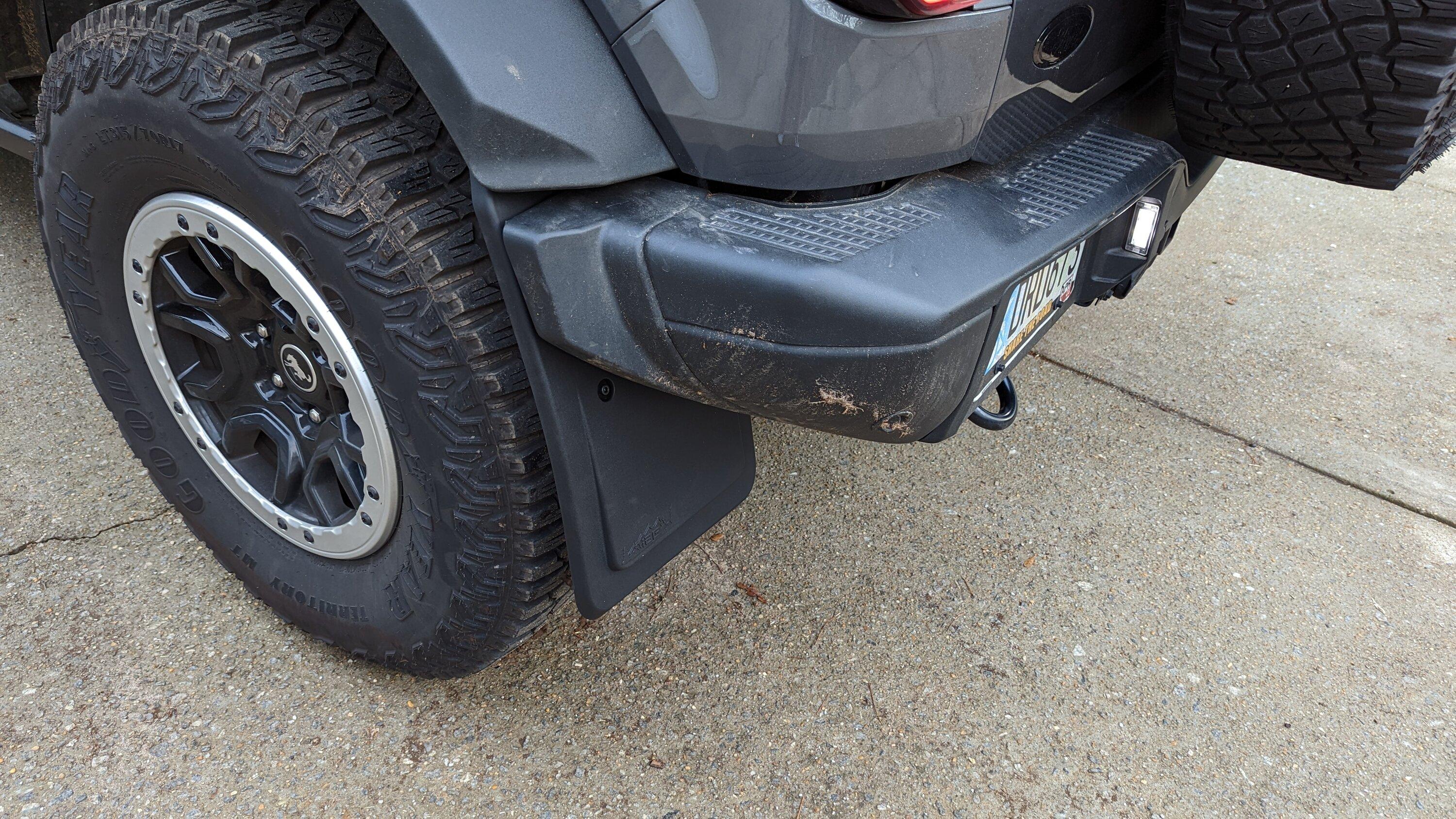

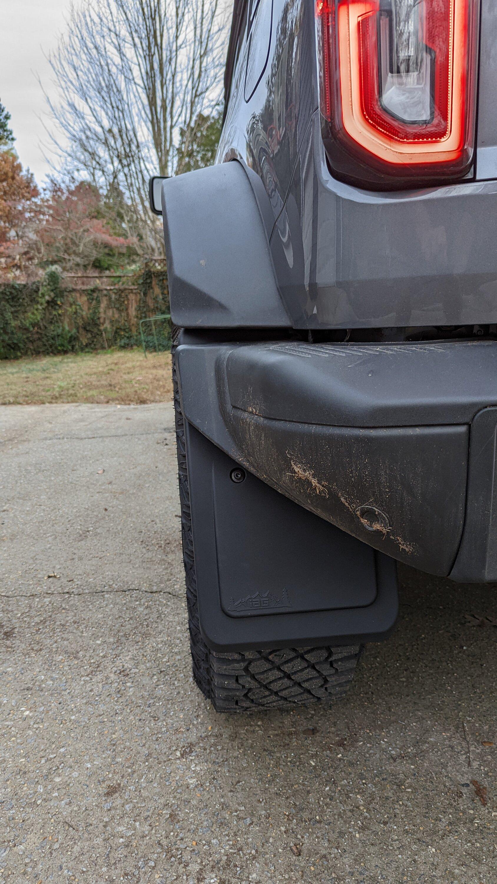

Have you found any? My OBX will have 35s with a +35 offset (and a little poke) so the sticking out is probably for the best, but I sure wouldn’t want that if I had factory +55 offset.
I have not found any that are made for a standard flare. All I have seen is for a SAS flare and that sticks out to far. The search continues.

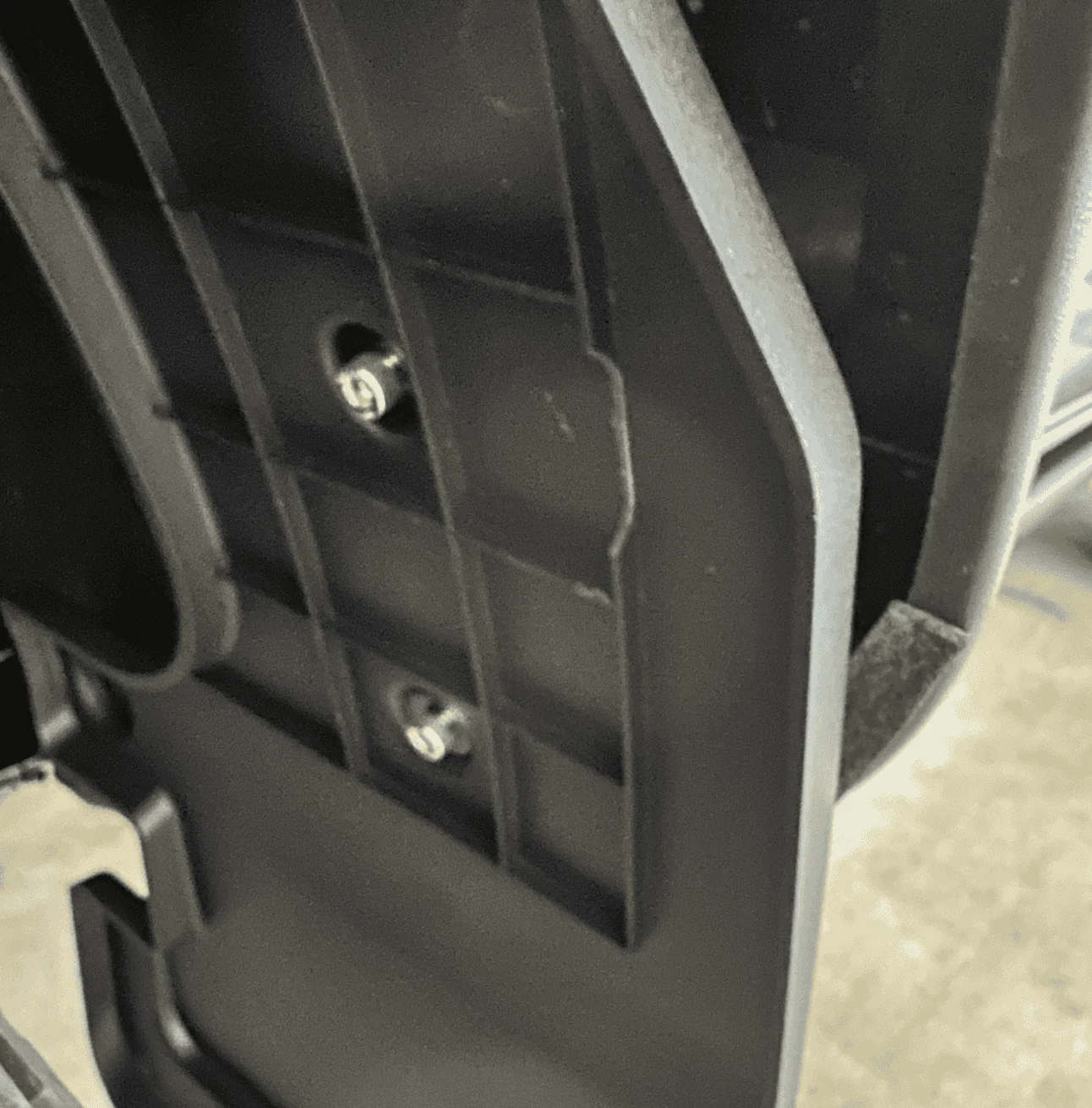

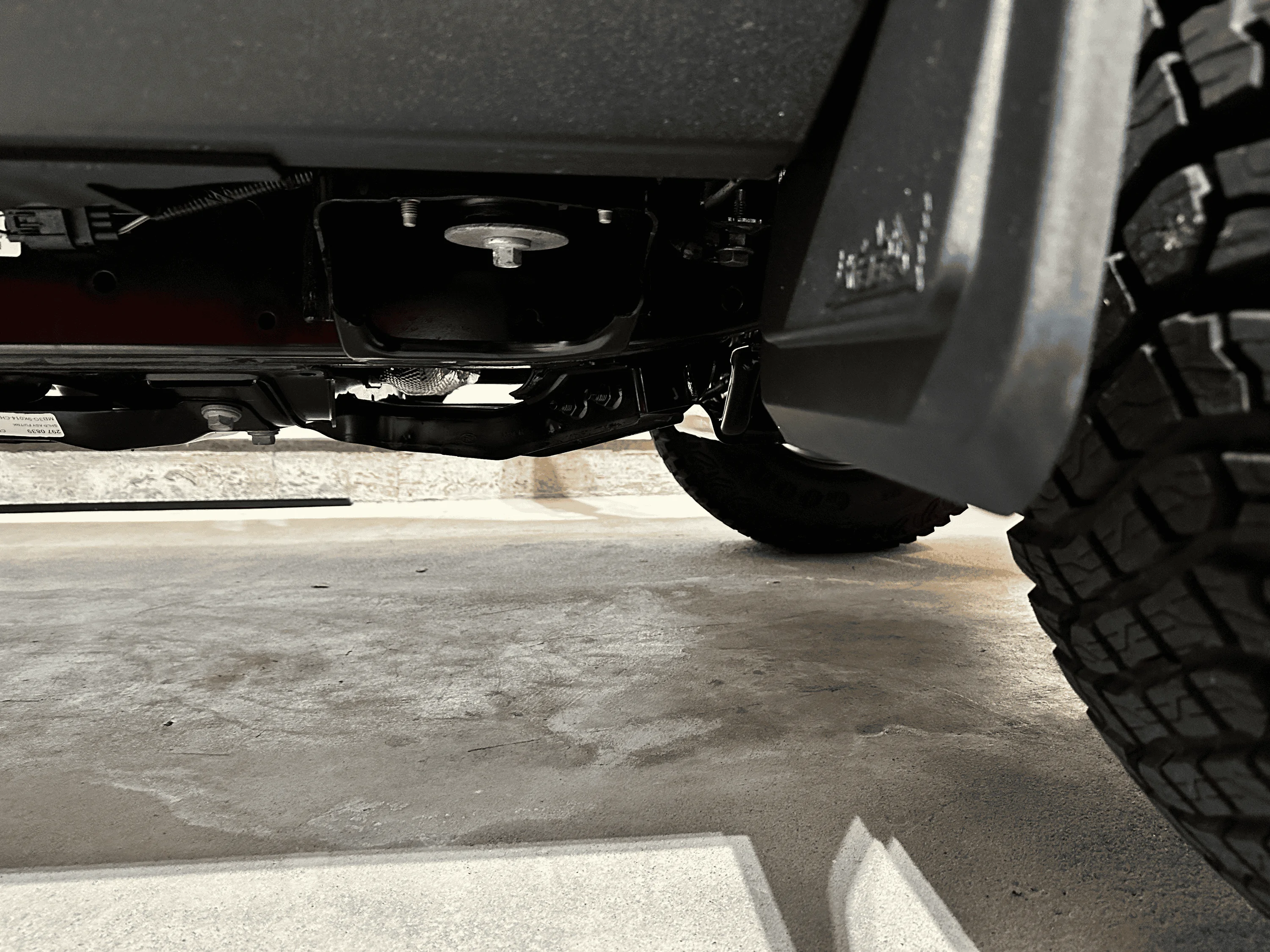

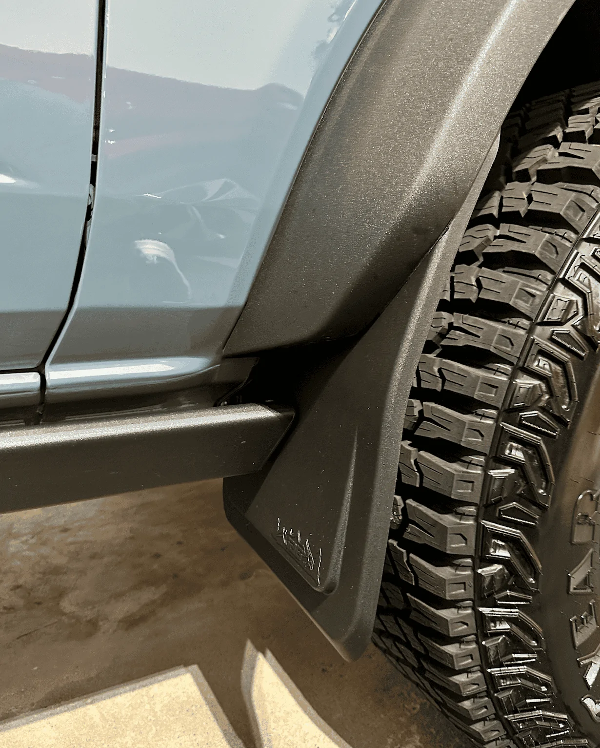

Just completed the fronts and my experience is similar to others. The rear will be next, but here are my notes regarding the front install. Also one of my flaps came damaged on the rear side in the area with the plastic boxes (braces). Will have to follow up with it, but I installed it anyway since it more of a cosmetic issue.
1 - Taking the fender flair off is a changeling the first time you attempt it but when I got to the second side it was easier since I knew the quirky process.
2 - The paper directions that come with the kit are absolute crap and should be used as fire starter. The YT online video from IAG should act as reference and the two contradict each other in a few ways. My only gripe is that the screws are silver and not black as shown in the video.
3 - The plastic retainers provided are junk, the stock ones actually worked better for me for the one that holds the inner side down. There have been comments on other threads that it would't hold for long under pressure but it appears it will.
4 - The directions show the plate between the inner well padding and the video shows it against, I went with against. The video does not show the front cushion / buffer being applied to the flair but the paper does. I cut the small strip like it tries to show in the really bad picture.
5 - The gold retaining clips are very tight and would take some paint off if just slid on, so I used some electric tape to prevent that.
6 - The flair lock that is close to the screws is tight to re-lock but doable.
I seen a post about the length of the flap which to me looks inline with the lowest part of the underside. This makes sense, as one wouldn't want it to be the lowest point.
My only gripe and it's about timing is that now they are on sale, I got them a few weeks ago.
Wish the screws were black and better plastic clips, aside from that I am a happy customer.
IAG thanks and good job considering the price point.

Thank you for your feedback! I wanted to address a couple of your points just so that you are aware, as well as anybody else looking at this. But we will certainly take any feedback provided to help continue to improve.
Feel free to reach out to [email protected] with your order information regarding the damaged mud flap. We pride ourselves on having domestic, friendly customer service reps, that actually answer emails and phone calls on concerns or questions.
The screws are silver because we switched them all with stainless hardware. The black steel hardware that is included with most of the other kits on the market was rusting almost immediately and that just wasn't acceptable. We'd love for it to be black, but black-coated stainless hardware is astronomically more expensive than silver stainless and would push these into a price point that puts us out of the competitive market.
We created our own PDF paper instructions that are much better and use the same process as the video. That can be found HERE.
Beyond that, thank you for your honest review!

Sent an email and thanks for the response. Product for the cost is spot on and I'm sure we all want better screws so that is much appreciated.
I suggest just going with a card in the box that has a QR code which takes you to the manual that you linked. The updated manual is very professional and much better!

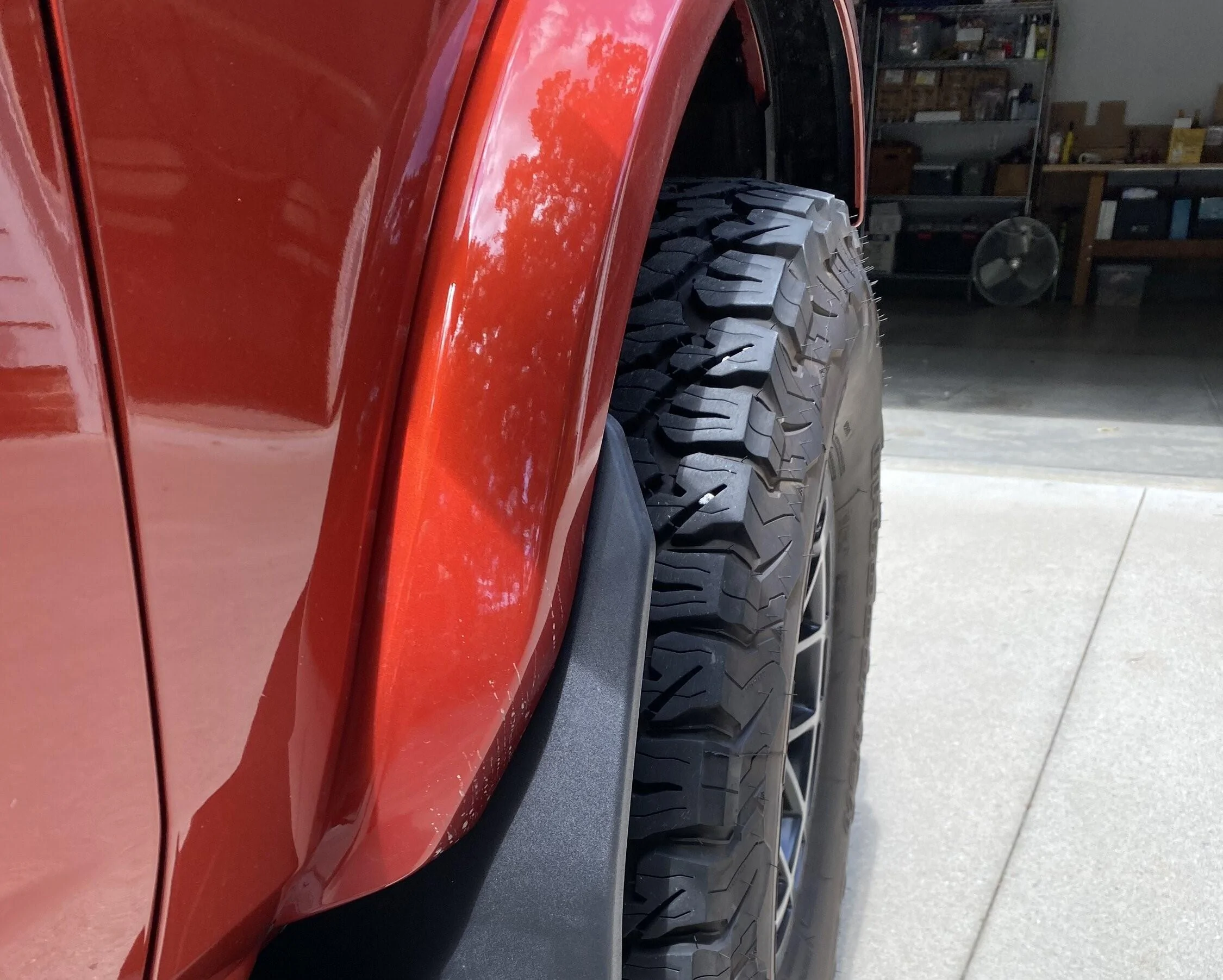

The remaining question is will these work on a non-sasquatch Badlands with the more narrow flare? I don't want the mud flap sticking out further than the flare. If I get confirmation these will work I'll order ASAP. Thanks

They will work on the non-sasquatch fender flares, but they will stick out a little bit. See the picture below for an idea of what they will look like.

They are a great looking flare at a great price but they are really made for a SAS in my opinion. I would like to find a company that makes them for the smaller flare.
