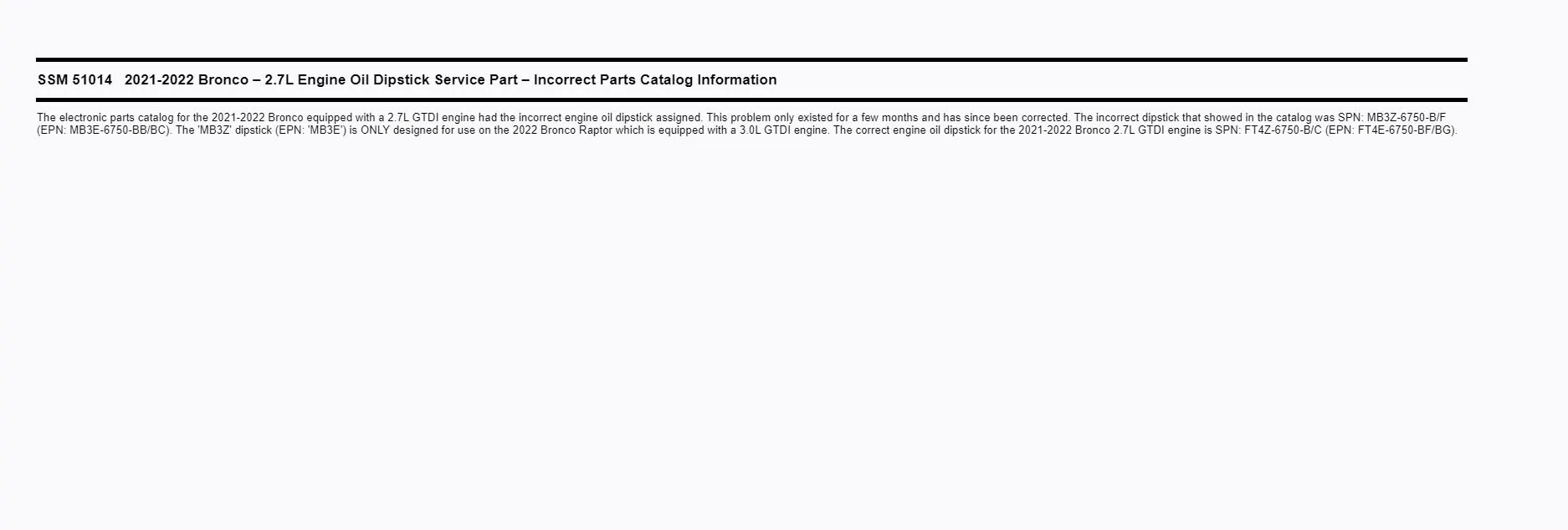

As the title says, Ford just released a new SSM yesterday to hopefully clear up some of the confusion about the incorrect oil dipstick for the 2.7 that some people were ordering.
Ford Bronco New SSM 51014 released by Ford explaining 2.7 engine dipstick confusion SSM 51014

How come they can clear that up but not the amount of oil?
They already cleared that up in a different SSM about 2 weeks ago. Its 6 quarts
