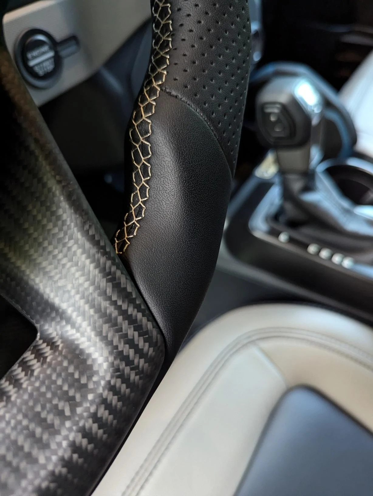

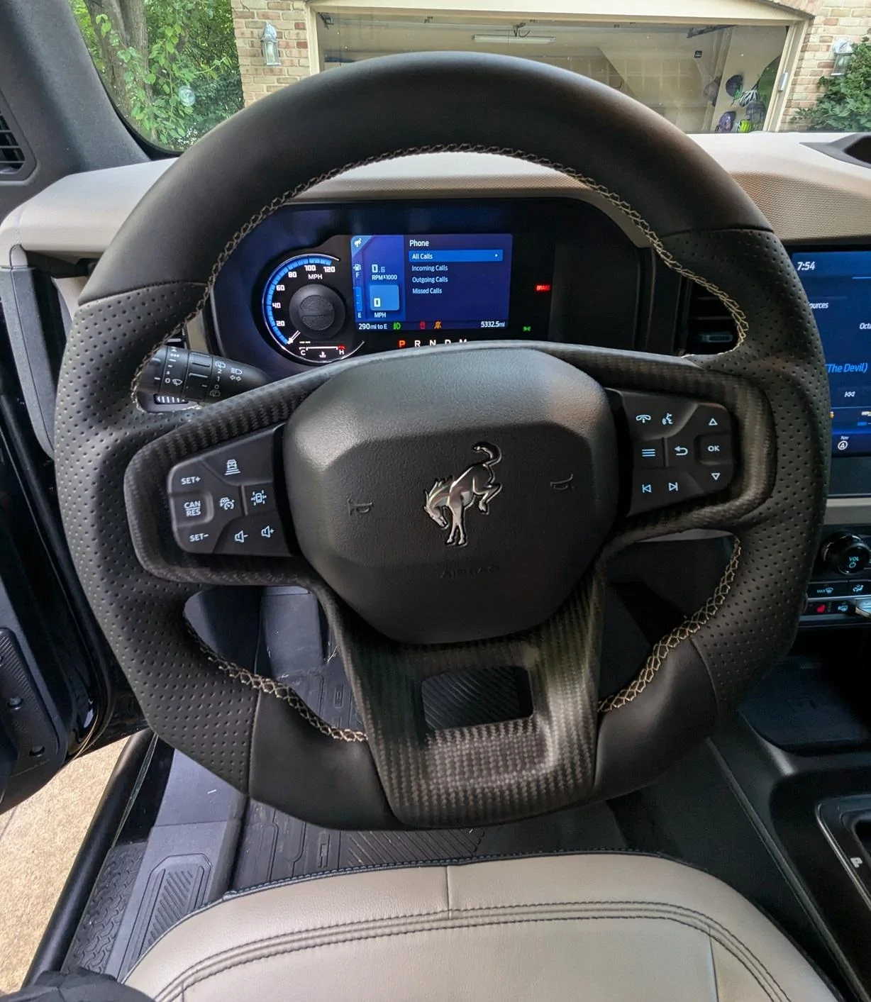

Sat in a Bronco Raptor a few months ago and was immediately jealous of the chunkier steering wheel. These guys at Carbontastic did a really nice job. I wasn't looking for a bunch of carbon fiber or alcantara, just went with perforated leather on sides, thicker leather all around and a slight flat bottom. The stitching looks brigher in the pics than in real life, it really does look like a good match with the Wildtrak sandstone interior.
Took about 10 weeks from when I ordered, but generally they say 6-8. I gave up my heated wheel, which was never that warm IMO (yeah, could have used forscan I guess). They offer a heated option but I wasn't sure what kind of wiring they use or if it would be compatible with the OEM connector.

Looks great, AND I see the LED option xP
Looks like my plans for christmas are out the window 🙃

How difficult was the install on this?

Looks great! I’d like to go with this look but I like my heated steering wheel. That puts all the options out of range for me unfortunately.

Very easy, you can find a couple of videos on YouTube.
The most annoying part is getting the airbag unit to disengage, you have to slide an allen wrench through a small hole on either side of the wheel to get the retention clips to pop open. You need to position the allen wrench at a certain angle to get enough of a "push" on the clips... again, not hard, just kinda annoying until you get a feel for it.
There is a single bolt holding the wheel down, uses a TP50 torx bit, torque it to 46 ft lbs.

Yeah I hear ya...I was on the fence for awhile because I didn't want to lose the heated option either...but sometimes looks > function, LOL

So do you send them your current steering wheel and they modify it (then you're left with no steering wheel for weeks), or are you buying an all-new steering wheel to swap out?
