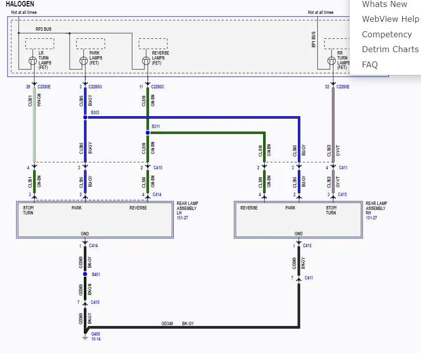

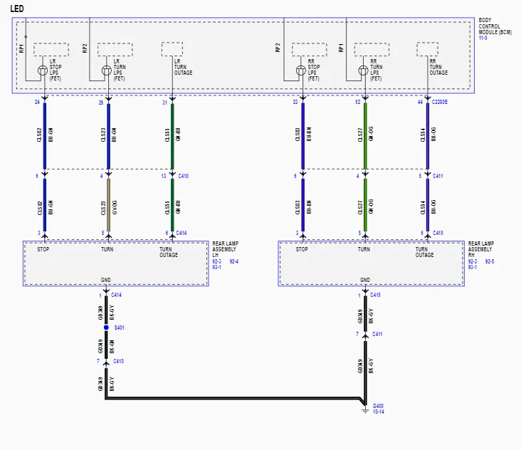

Signals are combined turn/brake on halogen, and separate signals for LED, so this makes sense. I wonder if the wiring is there and you can make FORSCAN changes to get the turn signal sent separately from the BCM?

Yep, this is what the engineer on Archaic's side basically said. Because of the halogen sharing turn and stop on the same line, the delay is because it is trying to determine whether brakes or a turn is being asked for.
I haven't verified, but I believe I read that the wire is not there if it came with halogens from the factory. So using FORSCAN won't be helpful here without running that wire as well.
Not an ideal situation, but I'm living with it. At least the 3rd brake light still comes on instantly, letting those behind me know. Also, with the manual I'm used to engine braking and slowing down without brake lights coming on anyways.
