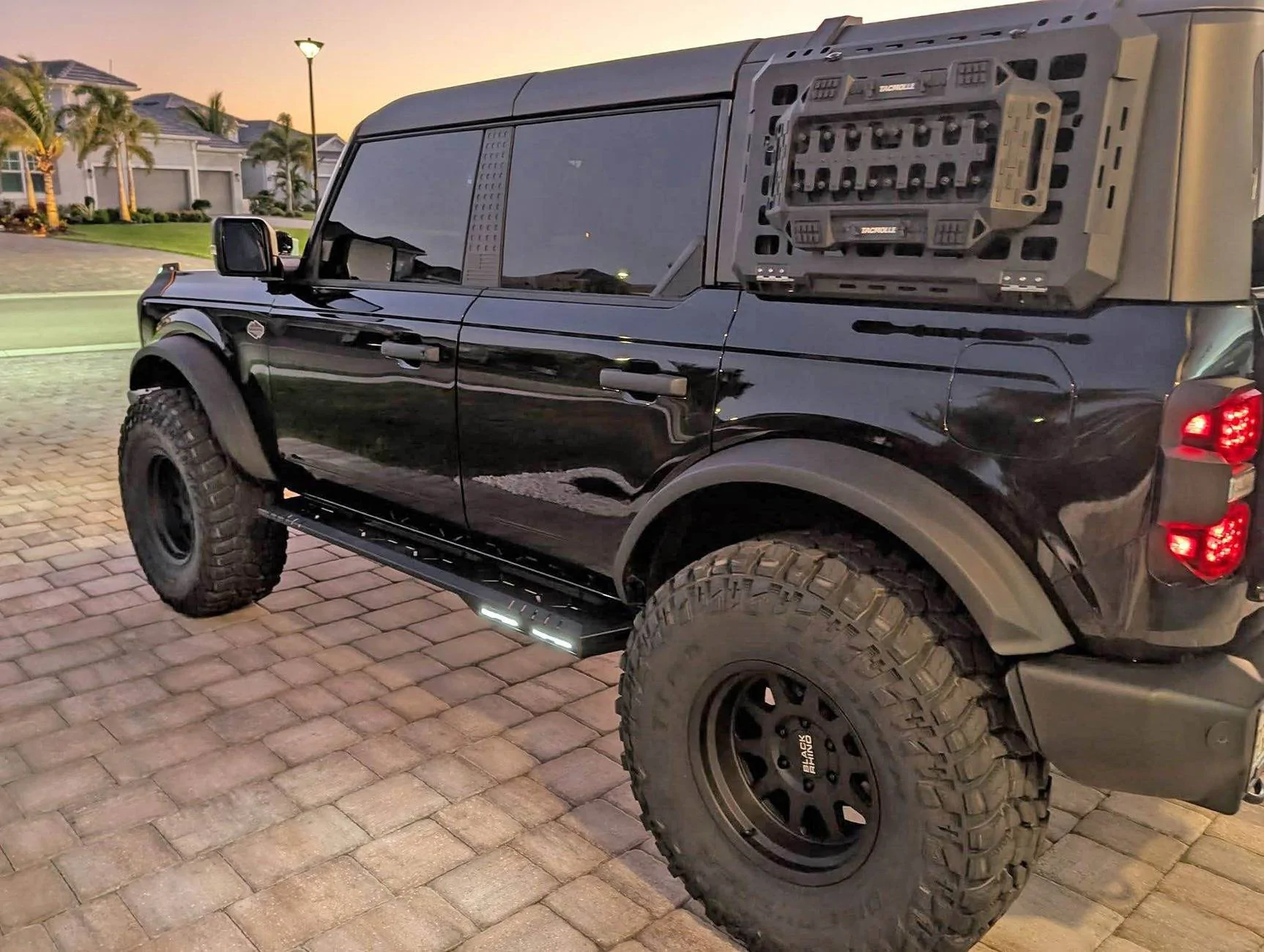

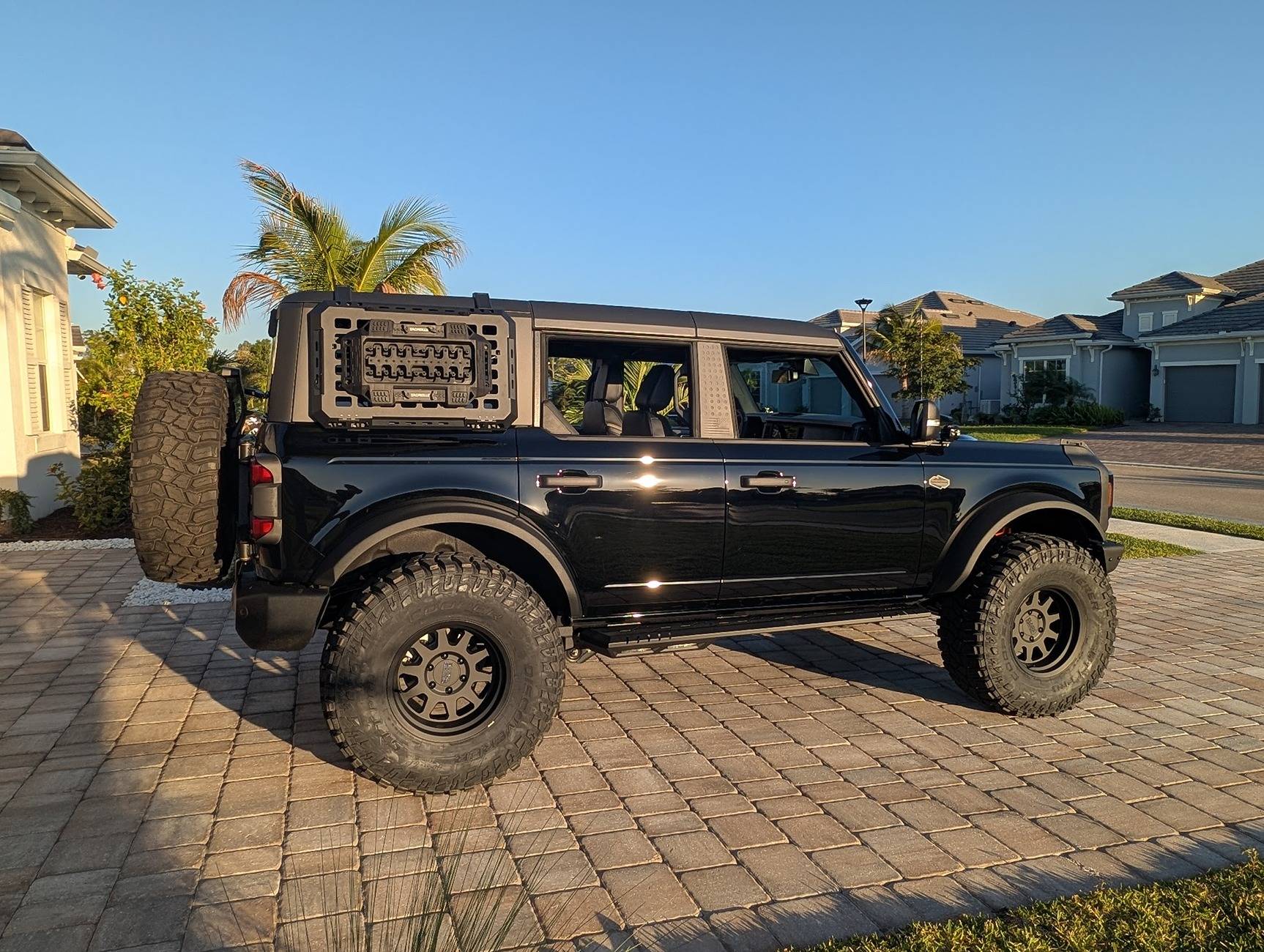

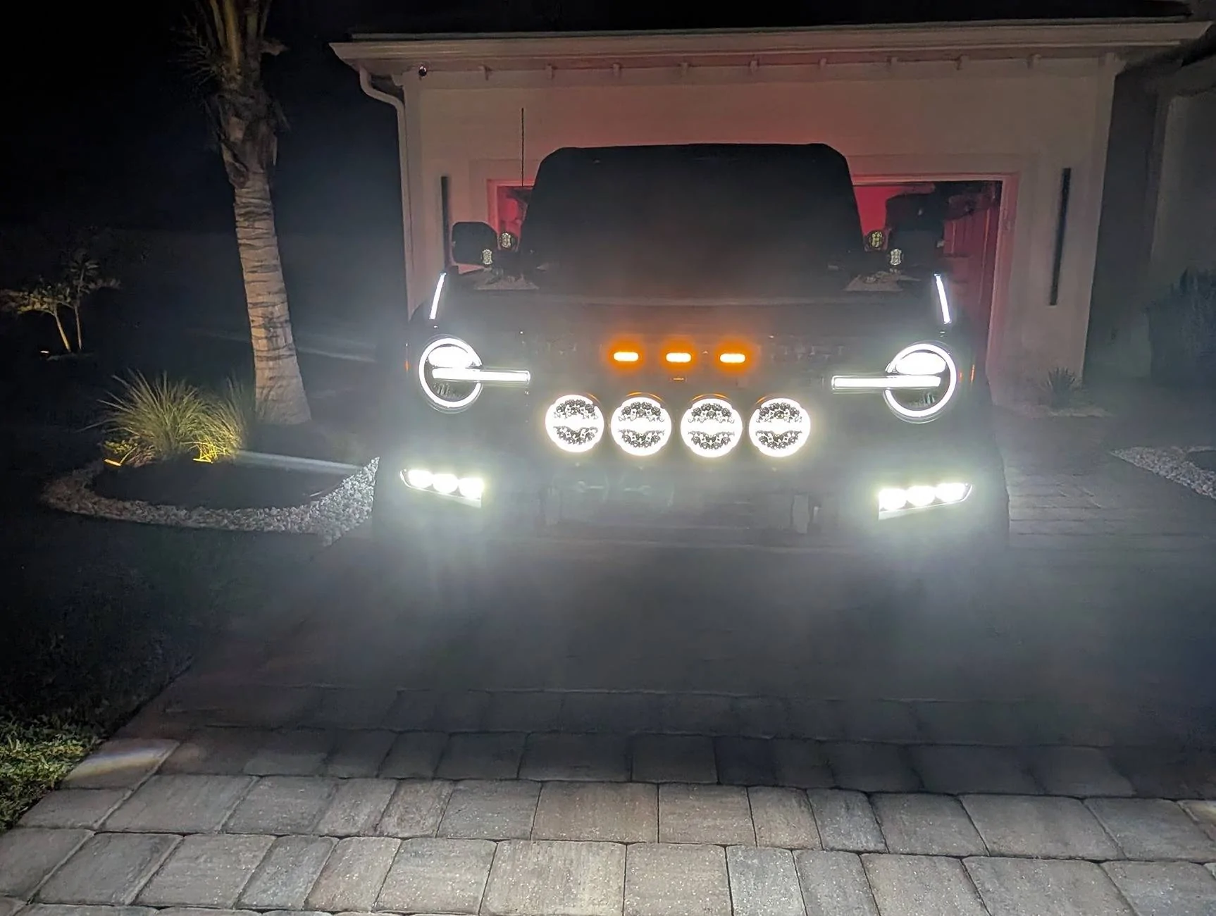

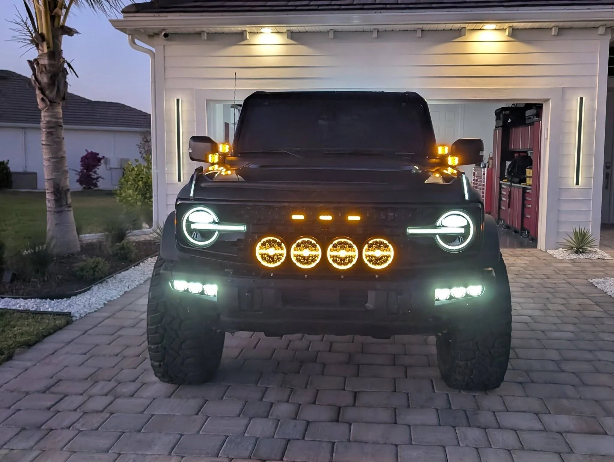

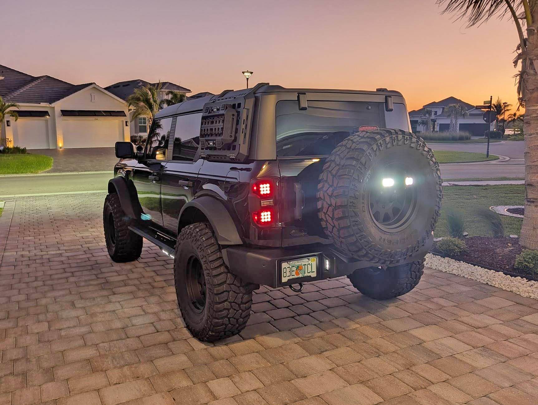

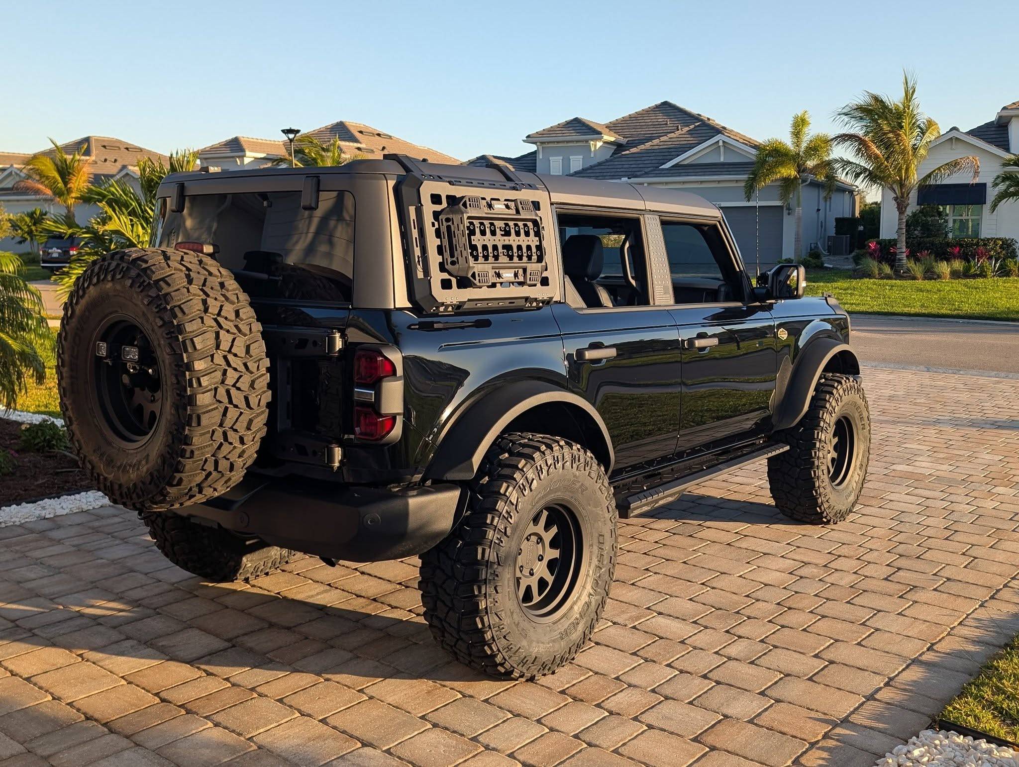

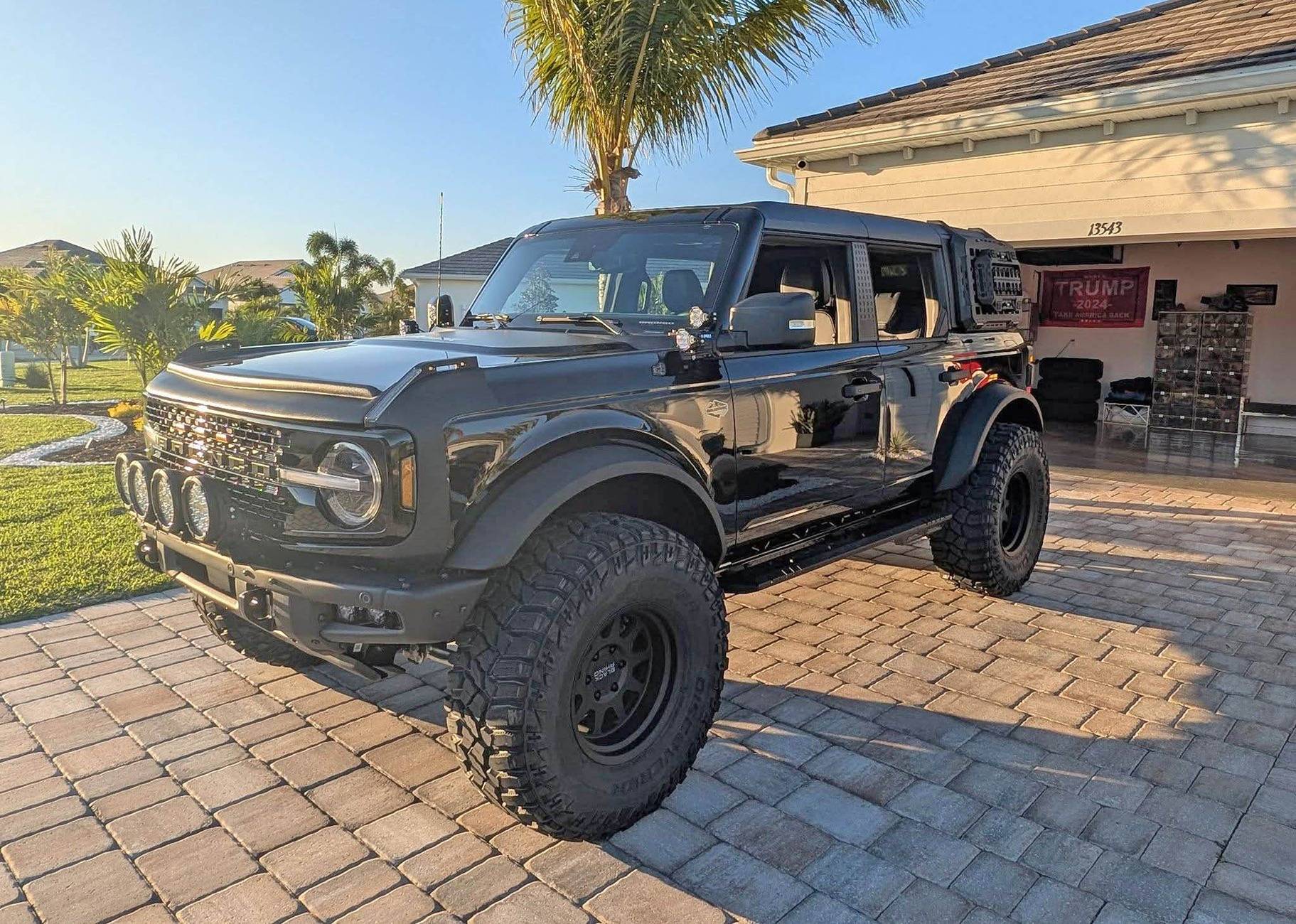

After doing nine different extensive Jeep builds (5 JL's/4 JK's), and now living in the flattest place on planet earth (Florida), I have made the switch to a new Bronco. I got tired of driving a wet noodle on 40's down the freeway, and since I don't need a rock crawling rig anymore, the Bronco is perfect. There is absolutely no comparison in ride on the streets. The inside is MUCH roomier and more comfortable, and the 2.7 has tons of power. Very happy with this new rig!
Mods list:
RPG Collars (3"/2.25") and Billet Arms
- JKS Max tire
- 37.13.5x17 STT Pro
- 17x9.5 (-18) Black Rhino Stadium
- Morimoto Fogs
- Four Auxbeam 7" on bumpers and four 3" on A pillars
- Wild horses Mount on bumper, OMU mount of A pillars
- Maiker exterior Window Molle Panels
- Diaode Dynamics rear chase lights
- Attica frontier steps
- Trunk tire carrier
- Wolf review camera
- etc...

Very nice! Are those gullwing windows on the back?

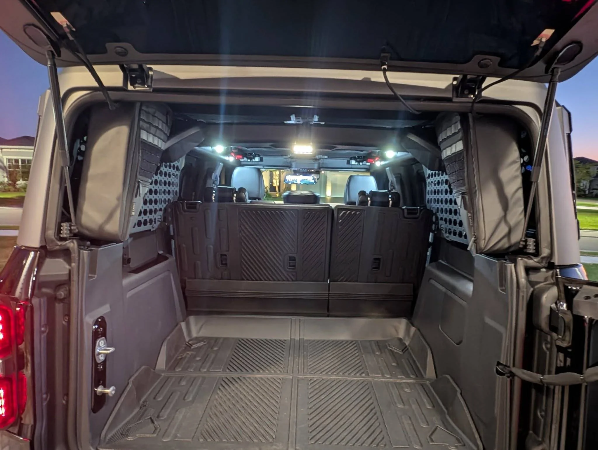

What suspension, interior molle panels and side steps did you go with?
Vettethret
Vettethret
Mar 17, 2025
64
SW Florida
2024 Wild Track / 2023 ZL1 1LE
The main stuff-
- RPG Collars (3"/2.25") and Billet Arms
- JKS Max tire
- Morimoto Fogs
- etc...

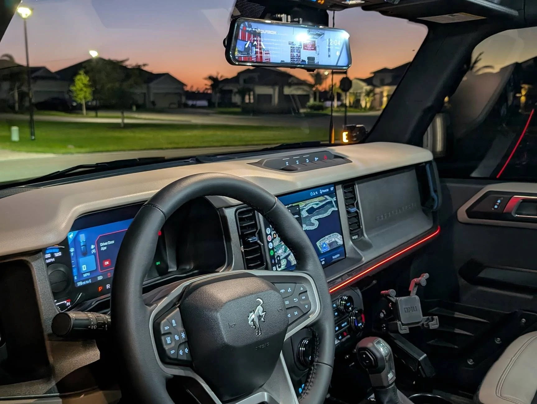

I like the red strip in your dashboard, is that the Oracle one? Only thing stopping me from getting one is that it looked like a major PITA the install. Was it worth it?
Vettethret
Vettethret
Mar 17, 2025
64
SW Florida
I got it off Amazon I believe. Makes a major difference to me in interior ambiance, well worth it in my opinion. Install isn't bad at all.

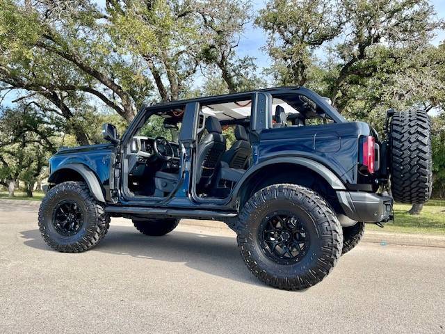

Question on the 37's. I am running 37x12.5x17 Nitto's on 17x9 with zero offset and 1/2 inch spacers with a 3" BDS, 1/2 inch body and 6100 Bilstein's that gave a tad, at full lock depending on the angle I will rub a hair. Do you have any rub with a -18 offset and 13.5 wide tires on a 9.5 wheel with only the RPG collars? I wanted to run the same tire you had but no way I could pull it off with my setup, just curious!
Great looking rig! No rub at all, I did the JKS kit as well for extra insurance.

Thanks, appreciate it. I don't rub in the front just the back on the driver side at full lock a tad on a good bump, not sure the JKS would help that but maybe, I'll give it a try!
