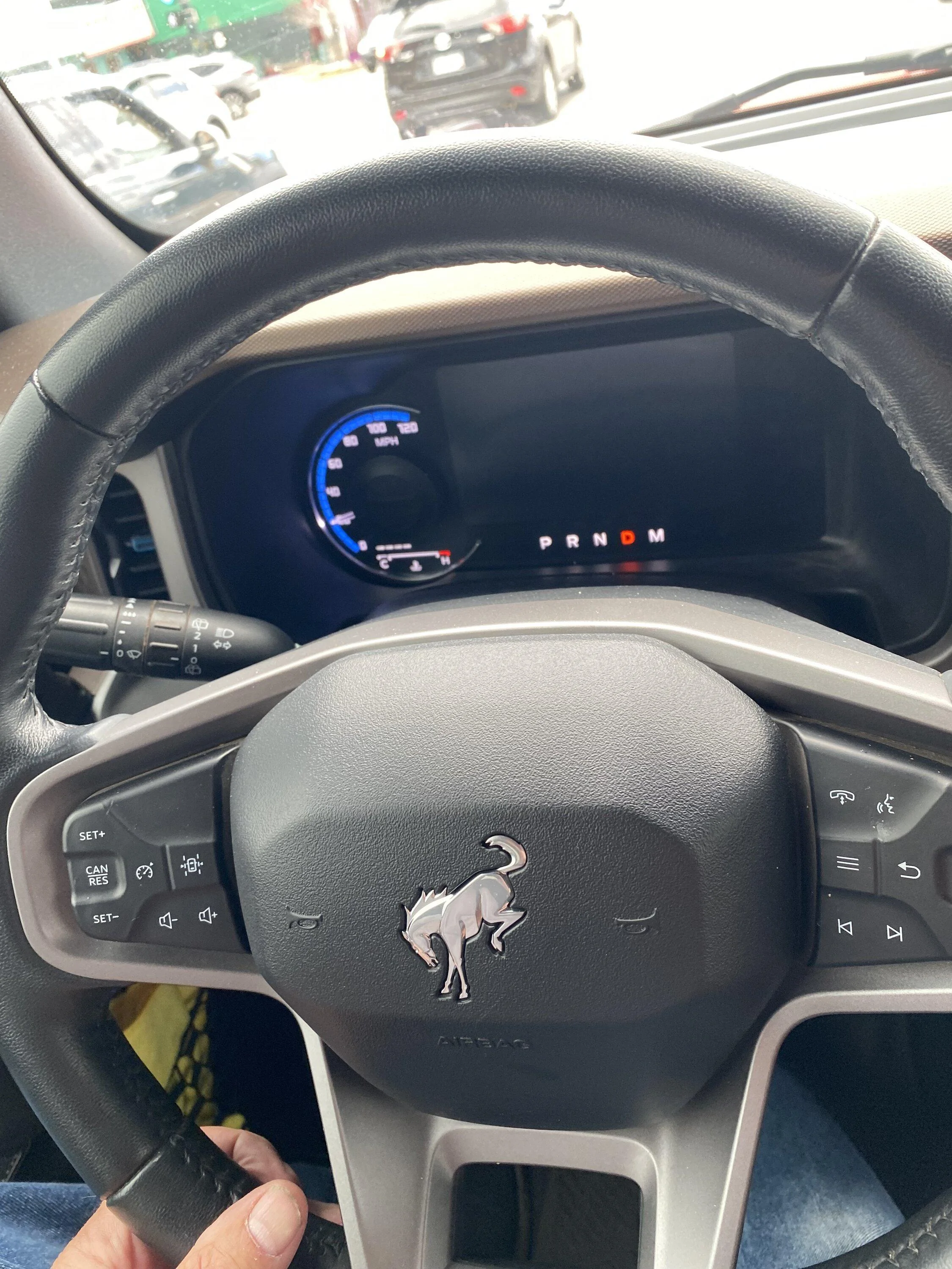

Just happened to me with my 2021 OBX. Drove it cross country this past weekend with no issues, and now - blank! Help!

Ok this is based on another thread here , but my instrument cluster went blank after a disconnect of the neg terminal while wiring aux switches. Checked all connections. Everything good , still no screen .
searched here and high and low and found a solution I tried, here it is.
1. pull down panel under steering wheel, itā€™s just clips and hinged at the bottom
2. Look on left side of now exposed area, this is another fuse box ( might be covered by a plastic card listing default door codes, odd because mine doesnā€™t have the didgital combo on the doors). Take this card out if present to expose fuses.
3. Pull number 13 fuse and examine it ( three prong fuse). Tested with multimeter all good.
4. reinstall fuse 13 if good and button it back up.
5. start truck
this fixed my instrument cluster and all is well, it did throw a check engine code about fuel and I reset with my scanner, though others have stated it reset on its own after a short drive.
I canā€™t take credit and my google-fu is weak right now so I canā€™t credit the guy that originally posted.
hope this works for you like it did for me.

Thanks so much for this post. This exact same occurrence happened to me. I followed this post and can attest that it worked and fixed my black dash. šŸ‘šŸ‘šŸ‘
