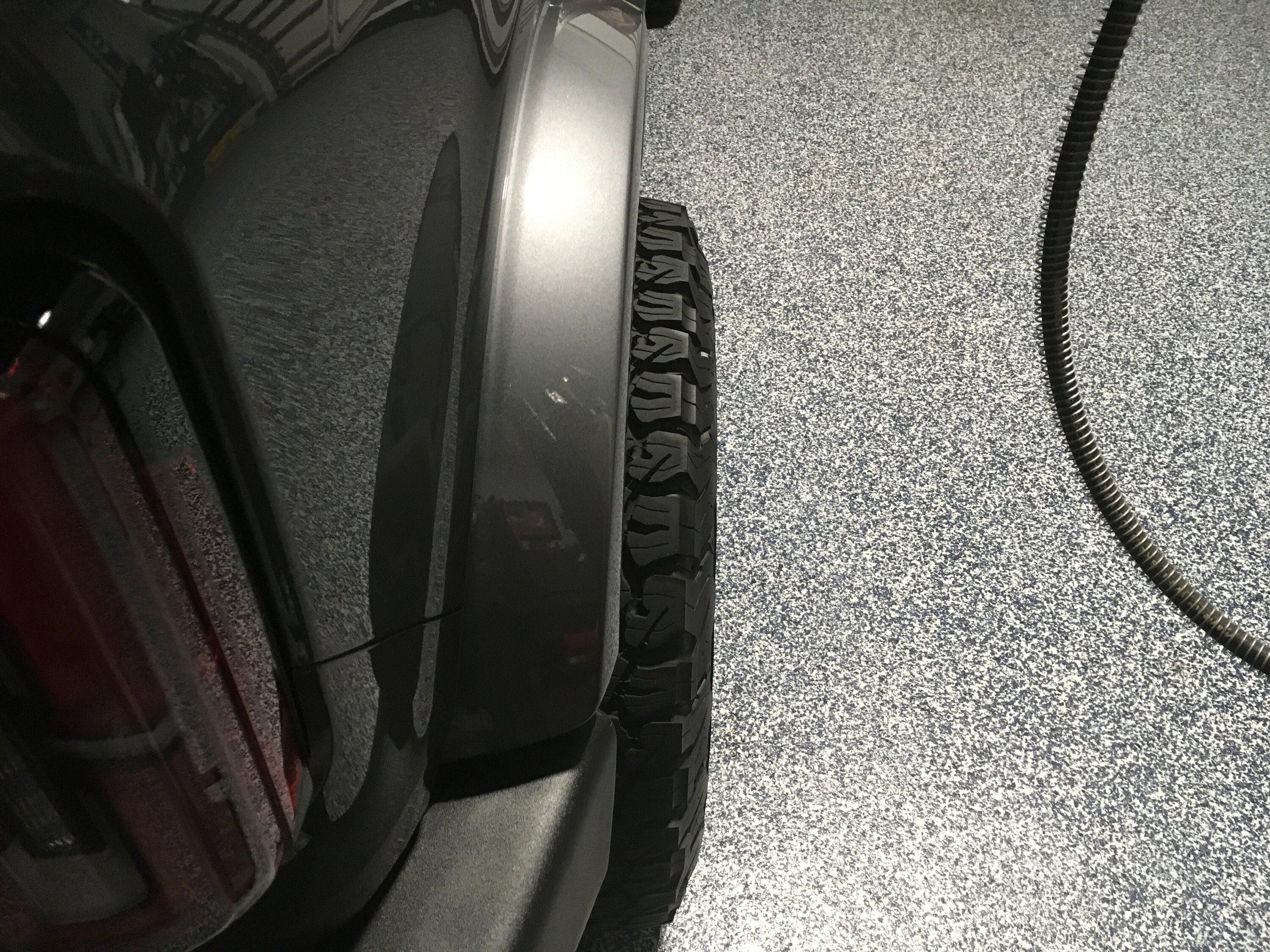

The 255 Duelers run very narrow, mine measured 7" at the Tread. I went to 265s which should only be 1/2" wider but measure 1 1/2" wider, a little size and more aggressive Tread makes a huge difference on anything that came with Bridgestones

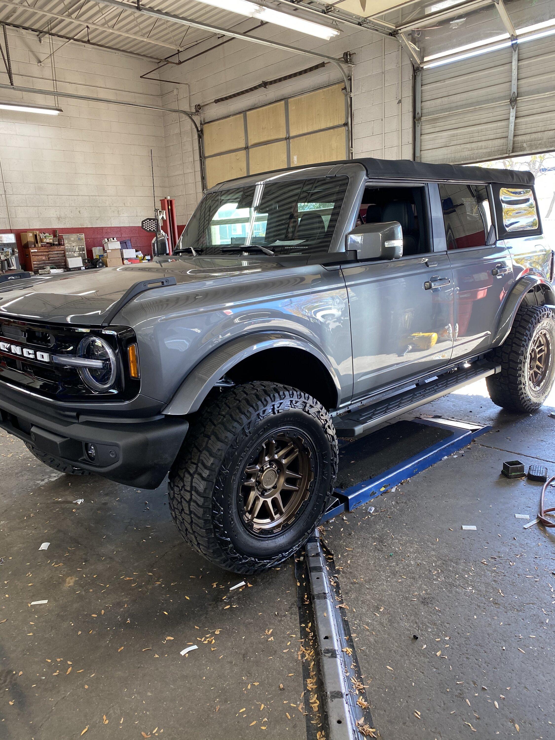

I looked at that exact wheel. Settled on a +12 black rhino. I’ve got 2” tread poke which is a stance I’m fine with. No rub w/bars removed.

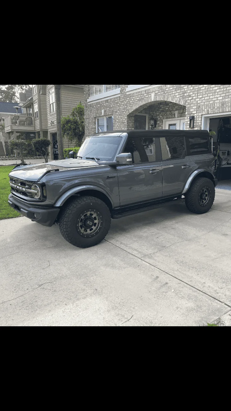

My set up,crash bars had to go.
-12 offset

Looks great, good wheel choice. What is the size of the wheel and also the tire size. I assume you have no lift. Thanks

Looks great, good choice of wheels. What is the rim size diameter and width. Thanks
