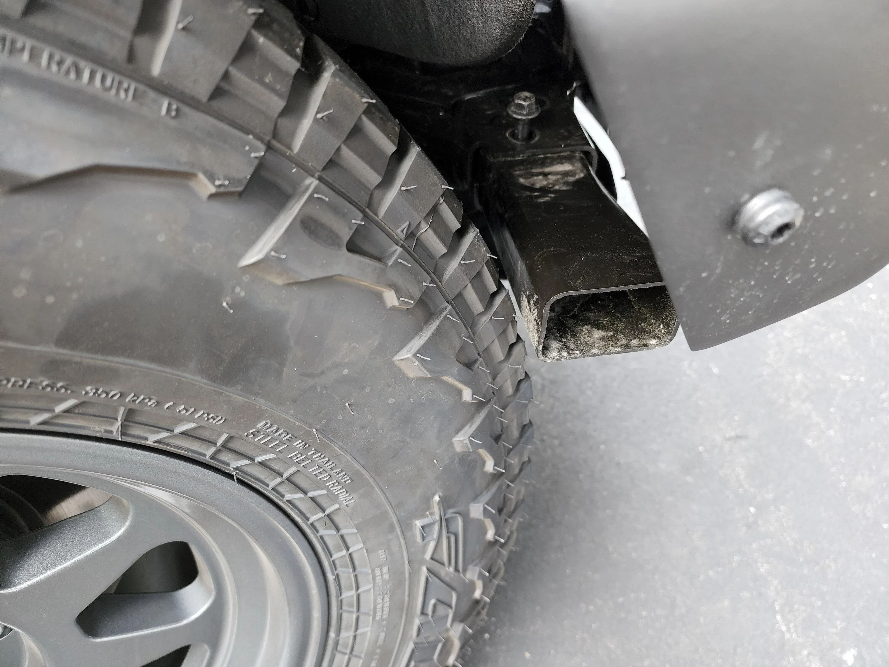

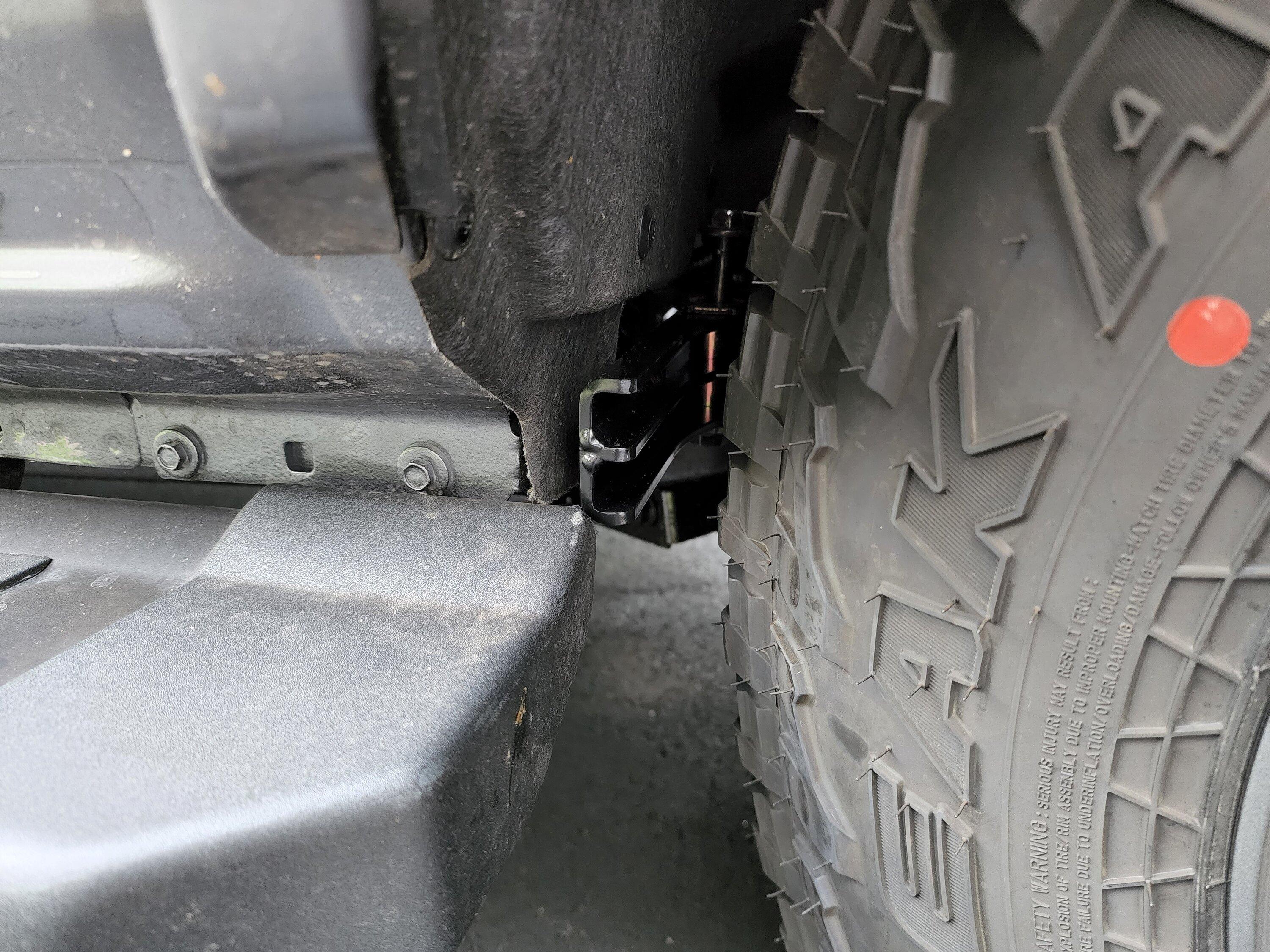

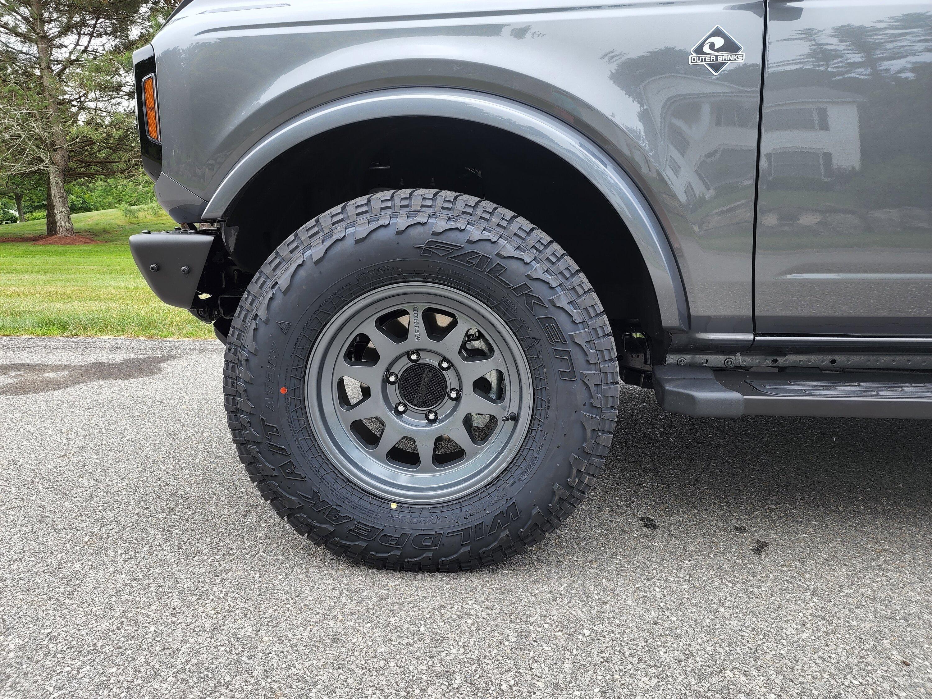

Well maybe. Depends on what kind of wheels (offset) you have. I have the OBX (non-SAS) and I just put 85/70R17 Falken Wildpeak A/T on Method 17x8.5 (0 offset) on it. There was rubbing against the crash bars (steering wheel turned both directions). Had to remove them. I was surprised. Thought I did my homework but missed something along the way.
Ford Bronco OBX to Badlands Stance 20220616_115857

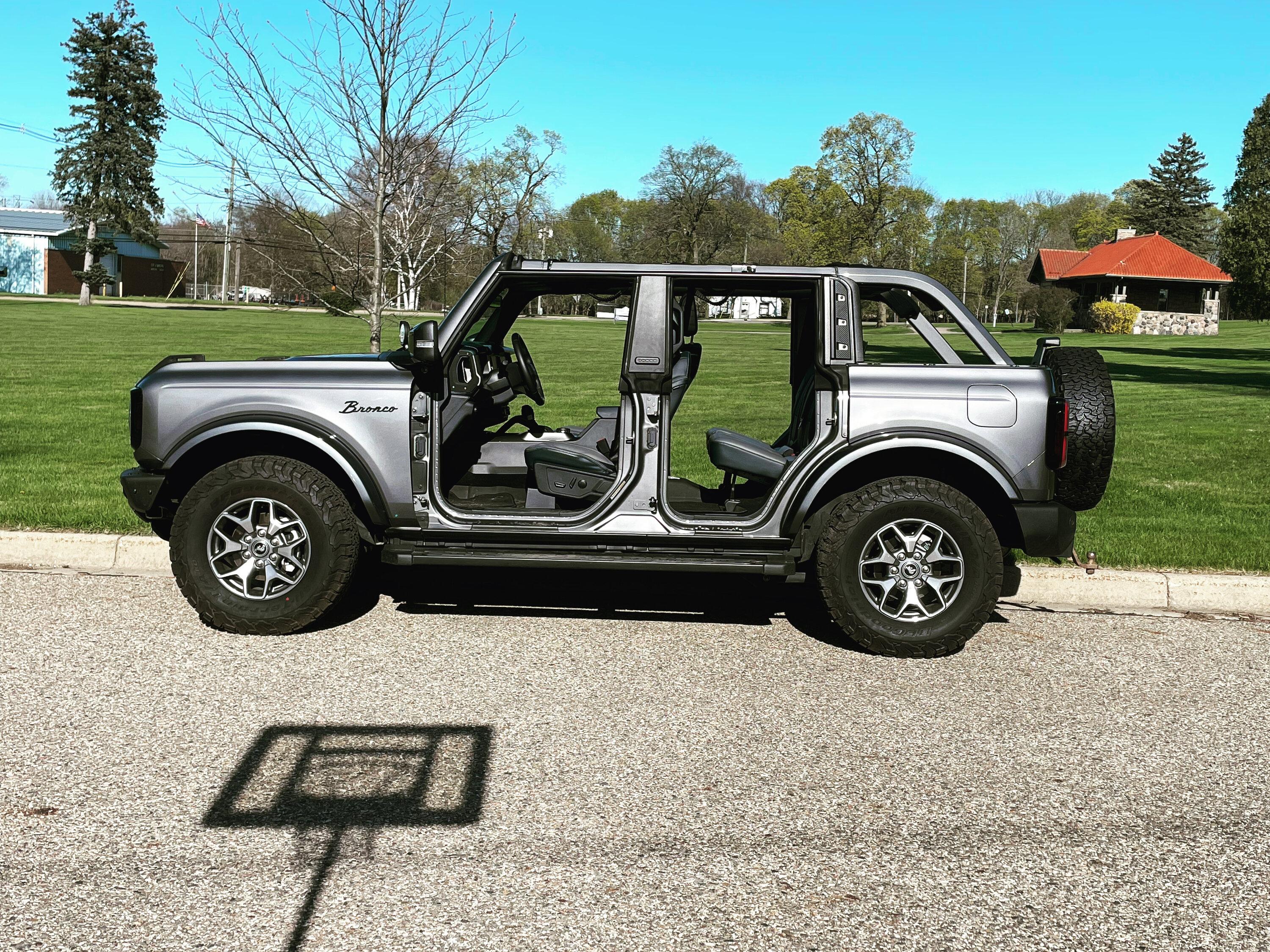

The easiest way would be to buy a set of takeoff badlands coil overs. $1200 ish bucks but you get the .6” lift and better shocks so not a bad value. Here is a pic of the stock badlands wheels on my OBX. The tires come about flush to the flares and no poke.
Ford Bronco OBX to Badlands Stance E9F4FA39-6473-4B25-80C2-A02108CEA51E
Ford Bronco OBX to Badlands Stance AAF4A3CB-94EC-46E5-A4AE-9B4989A25B6D

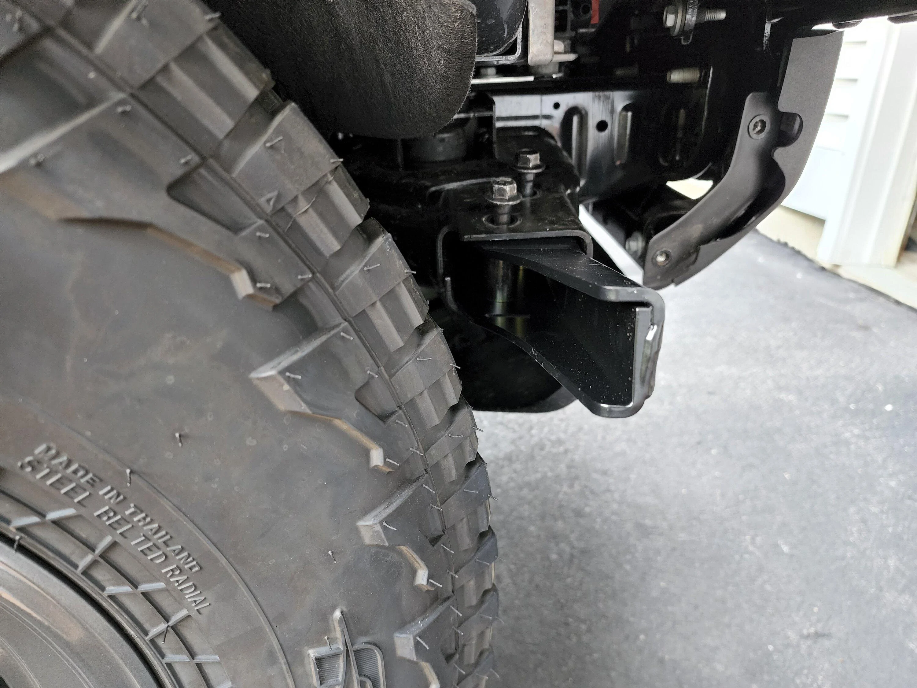

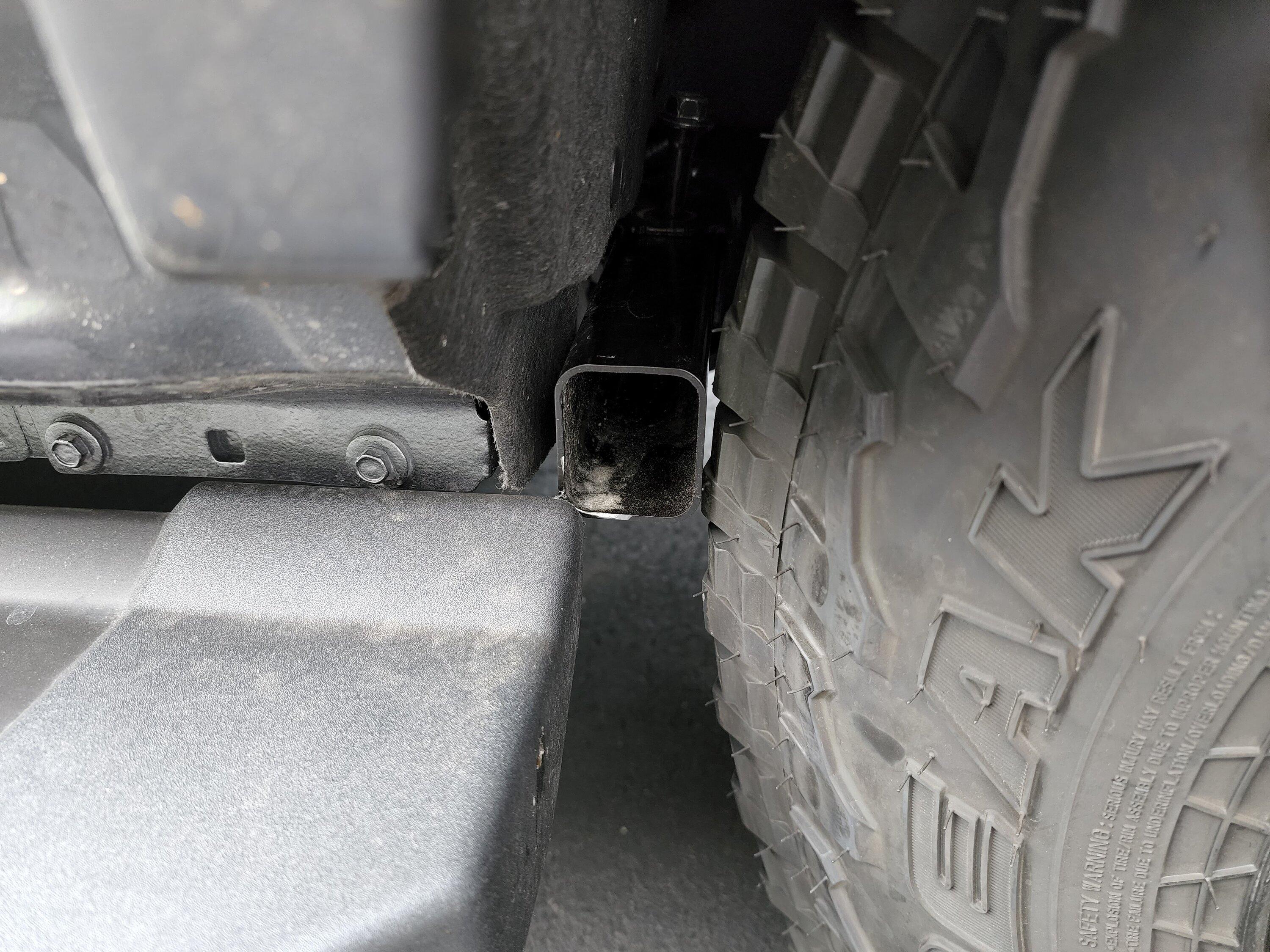

Here are some pics with the OEM crash bar and this wheel/tire combo that was a problem with full steering wheel deflection.
Ford Bronco OBX to Badlands Stance 20220623_181601
Ford Bronco OBX to Badlands Stance 20220623_181621
And the replacement crash bar.
Ford Bronco OBX to Badlands Stance 20220623_183008
Ford Bronco OBX to Badlands Stance 20220623_182952

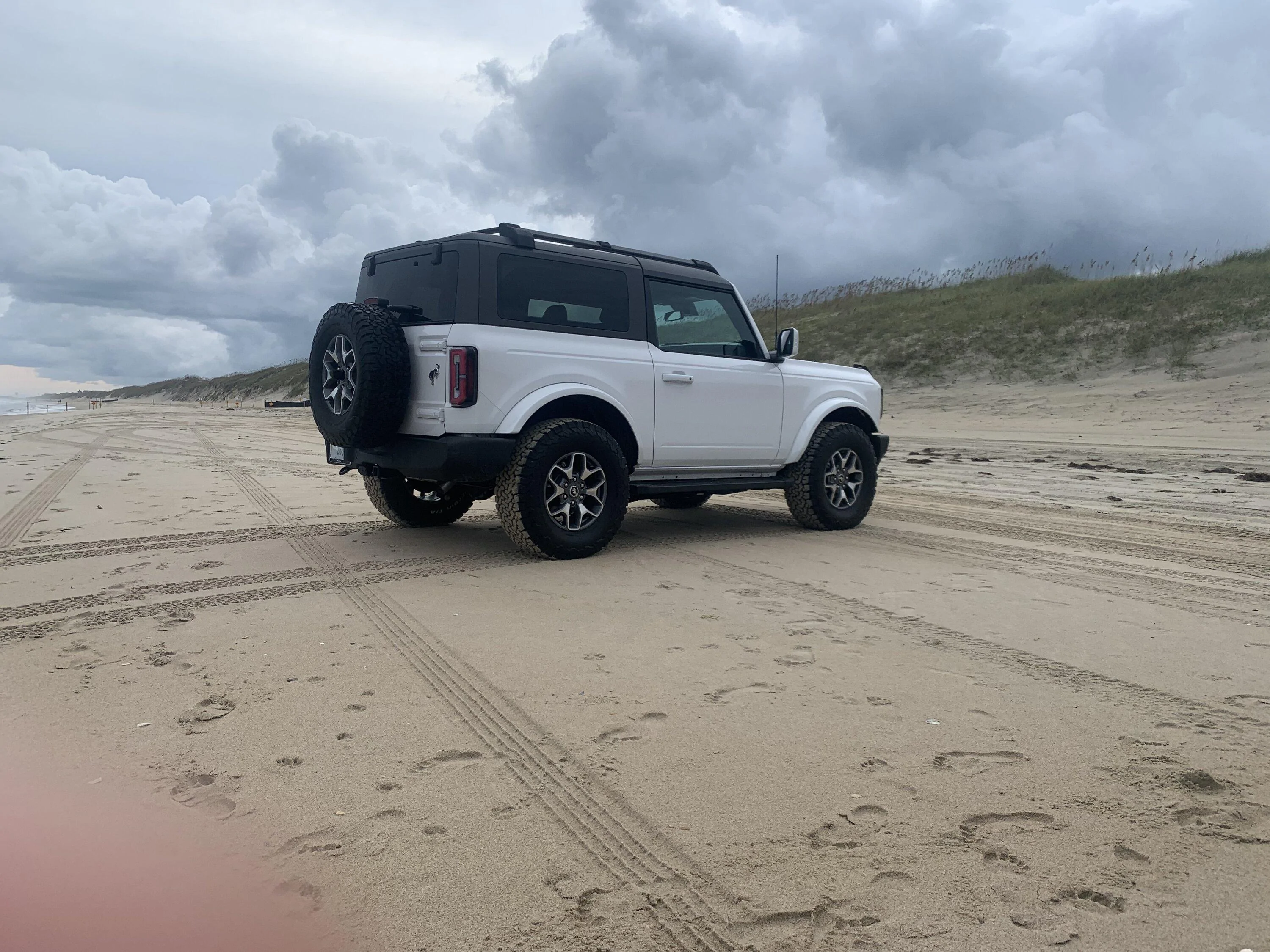

295/70/17 on stock OBX with Badlands rims.
JustinZ- might be interested in your rims/tires. I’m in VB
Ford Bronco OBX to Badlands Stance BF3CED94-41F1-4537-BF7A-86E8A42A21E3
