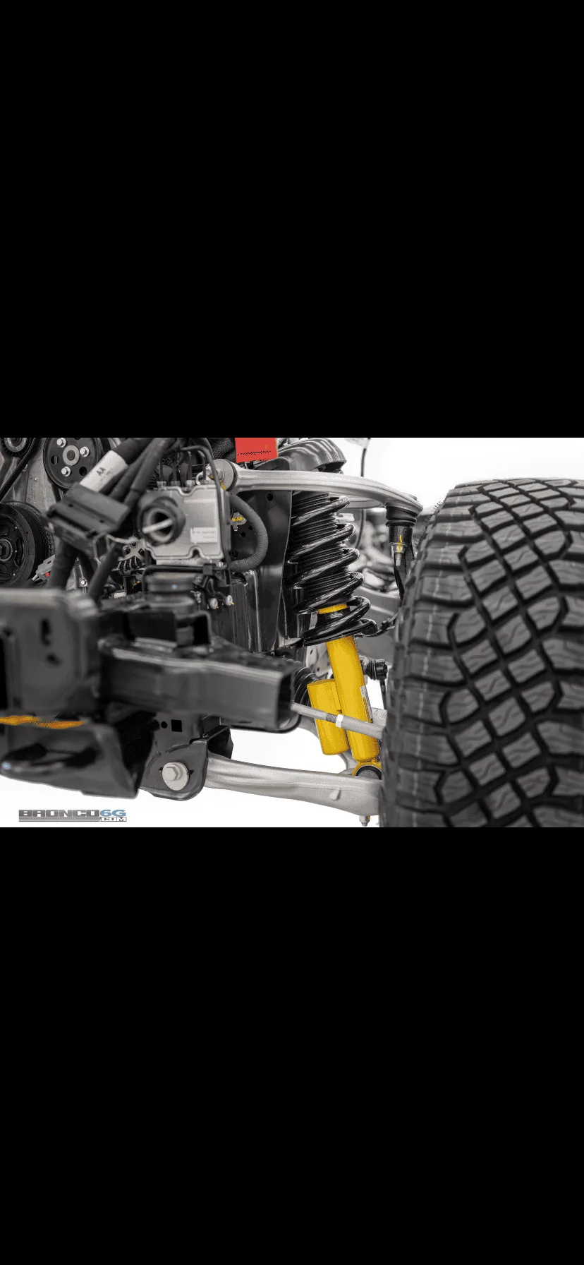

Although we still need to double check to confirm how much the upper control arm protrudes. We were about to get a better idea from @LEGEND but we slipped into Xmas. Legend any chance you could snap a photo (ranger below for example)... or if you’re uncomfortable doing that, getting a sense for where the upper control arm is relative to the back and top of the OBX tire? Here’s a sample ranger photo. Imagine a tire sitting a half inch higher and a half inch closer to the steering knuckle. Thanks again.

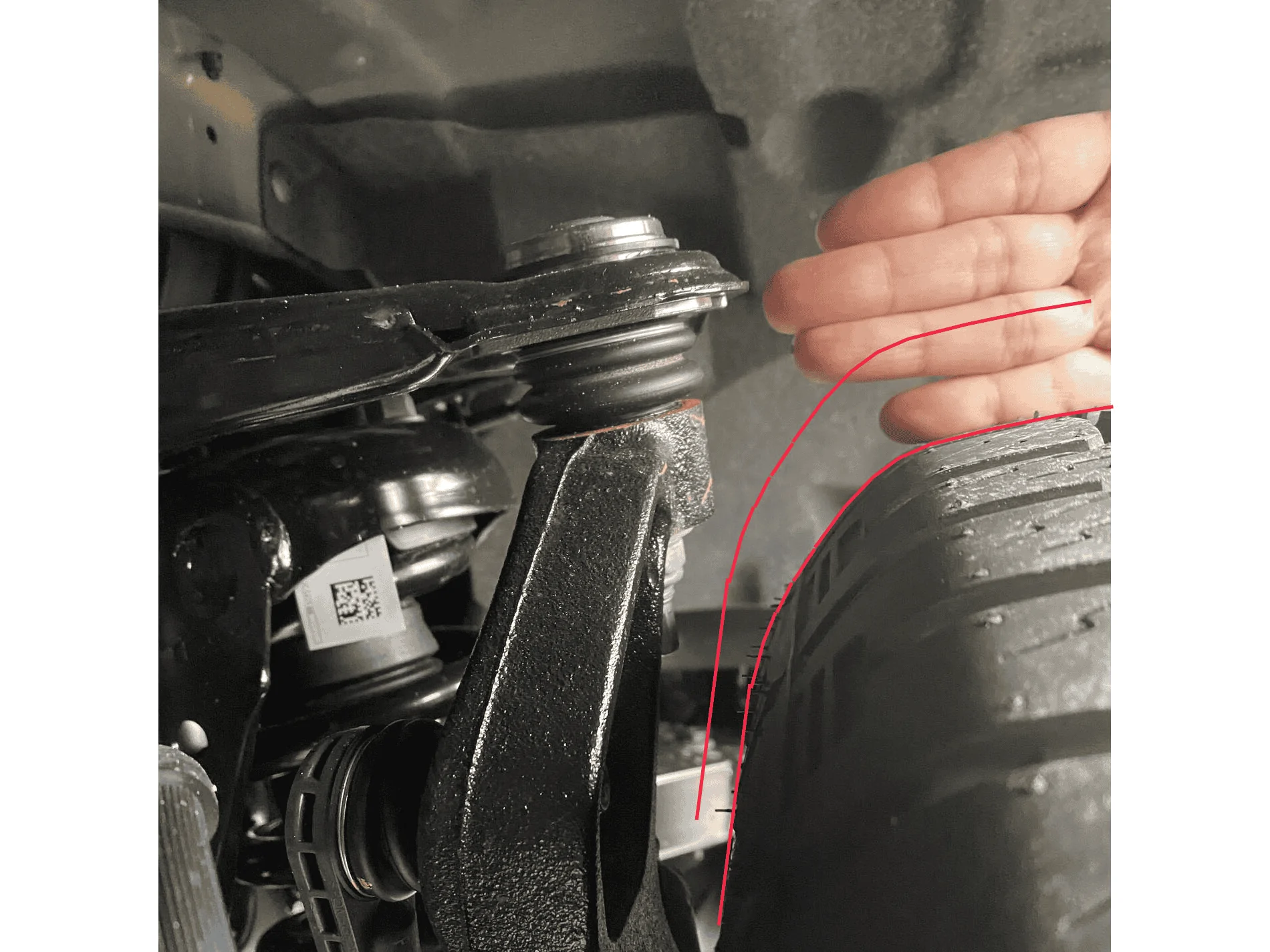

Thanks for confirming! Great news. I was confused at first and deleted/edited this response.
So the upper control arm really has no bearing here.
We were thinking the max distance to steering knuckle on an OBX was 1.1” to the backside of the tire. The upper control arms gradually protrudes ever so slightly. Maybe a quarter inch if I had to guess. its probably hard to see behind there, but that likely why 1.1” becomes your cited .75” at the tights where the upper control arm is located.
Ford Bronco OBX with 33s do we know how yet? 63898590-0F48-4F5C-B2C9-36AC974381A9
that’s implies
1. a 11.2” width tire on an OBX rim still has .25” clearance from steering knuckle/upper control arm. FYI stock OBX tire is 10.2” wide. this is similar to what you would find on a badlands (although that wheel is 8” wide not 7.5”, also with a 55 offset). So the clearance on the BL would be a little higher at .45”
2. since upper arm doesn’t really protrude, then skies the limit on a bigger diameter tire (sticking to 11.2 width). Obviously crash bars will need to be modified as you get closer to a 34” tire and up.

I think the width of the tire plays into it more. Stock OBX tire is narrow and only 10.2” wide

That makes sense. In any regard, it sounds like a 275/70/r18 mounted to the stock OBX rim should fit, no problem. Basically swapping out a 32.1x10.2" tire with 33.2x11.2". It sounds like picking up a half inch on the backside of the stock tire still gives us a remaining 0.25" of 'comfort' zone to the steering knuckle, and the taller tire really doesnt come into play in regards to the sterring knuckle.
