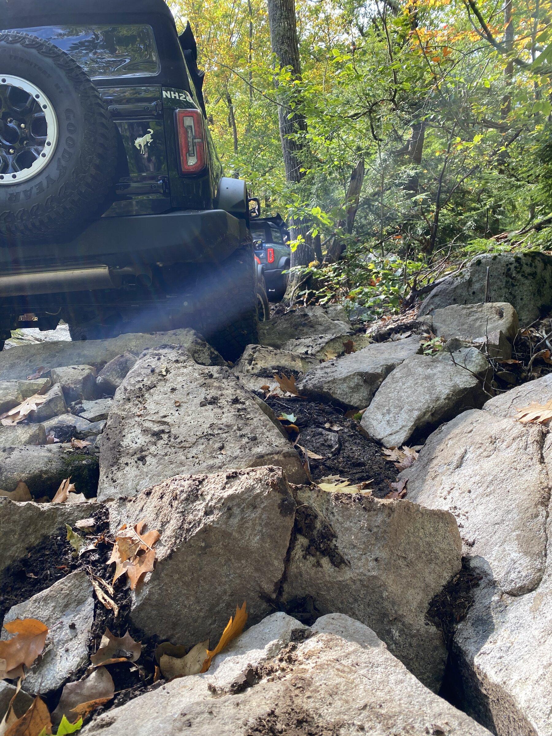

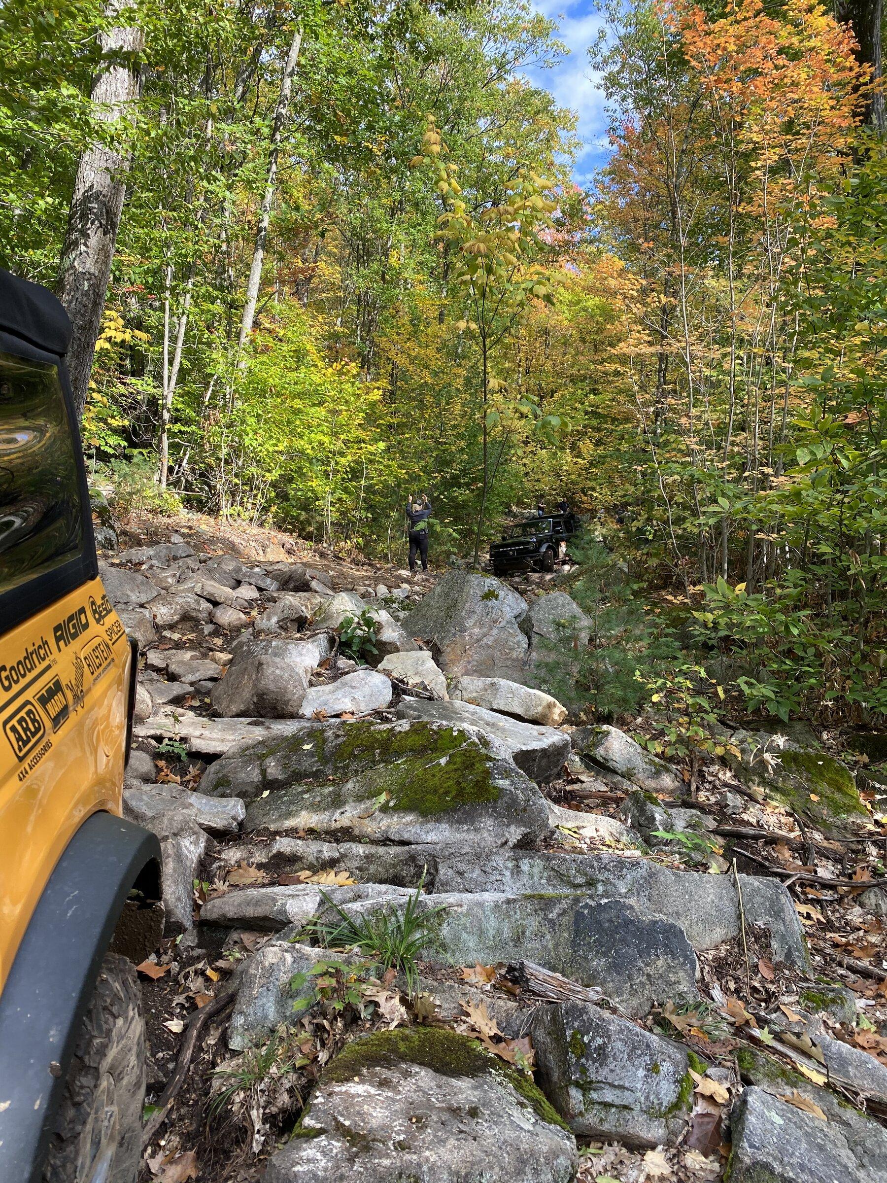

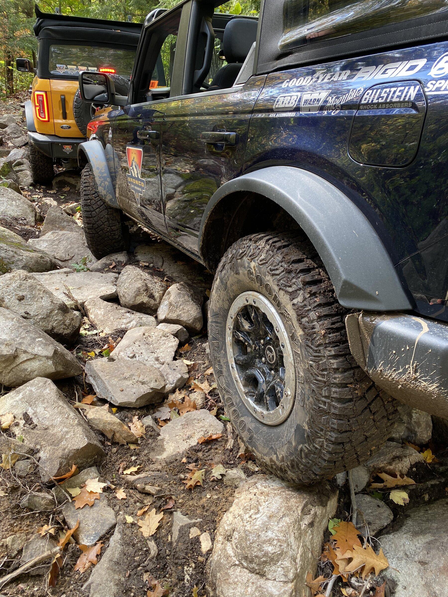

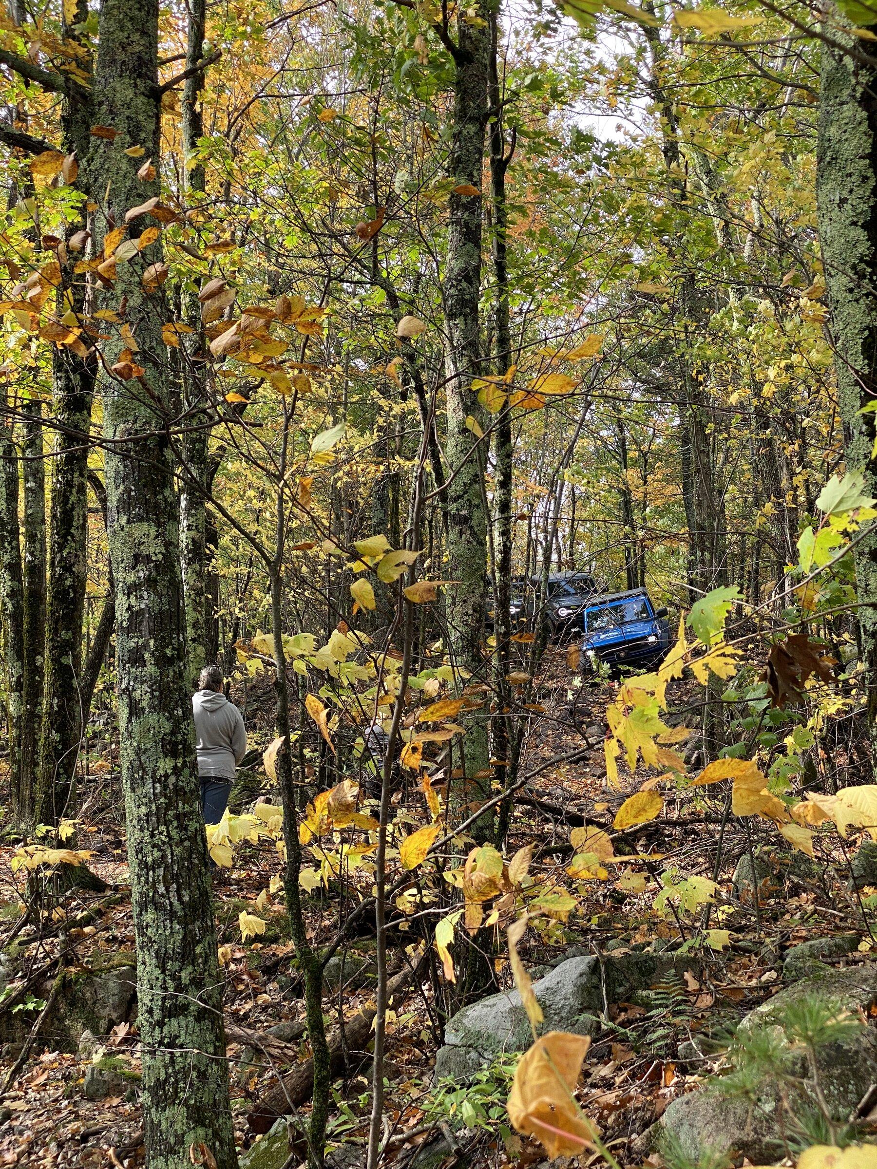

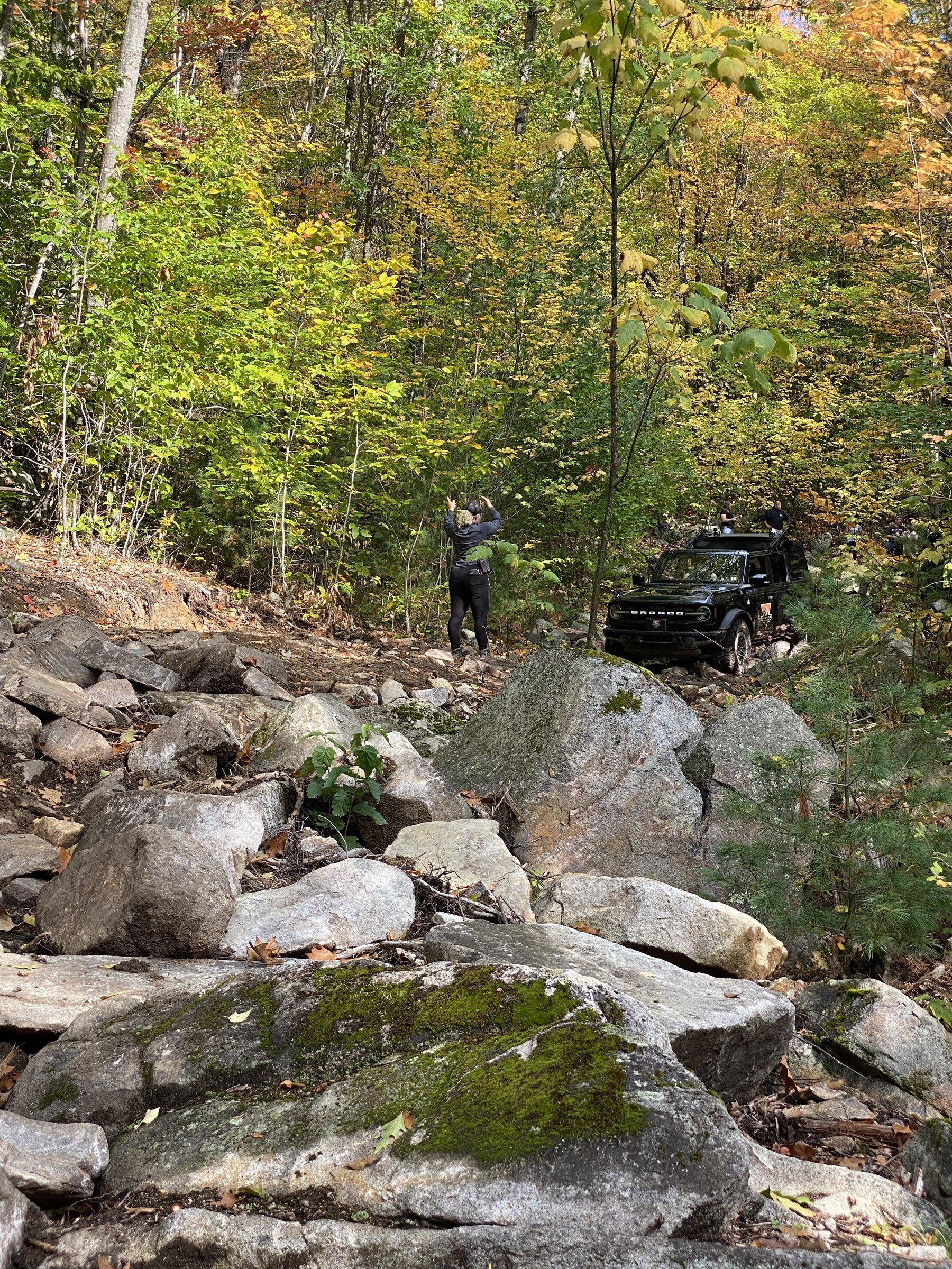

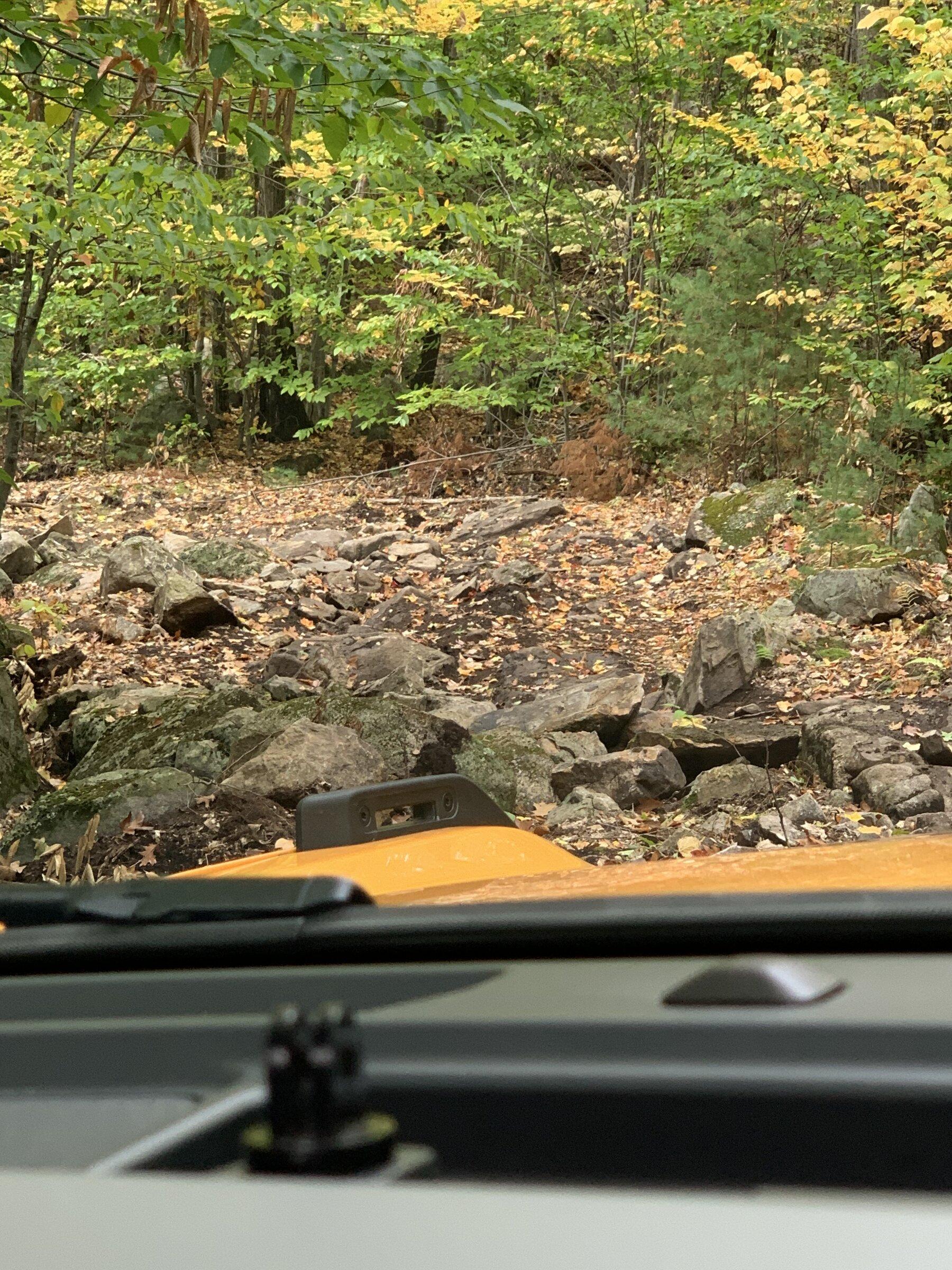

At the NH off-rodeo they ran 18-20 psi on the GY and KO2 and we ran some pretty aggressive rock crawling trails. I’ve include some pictures.
