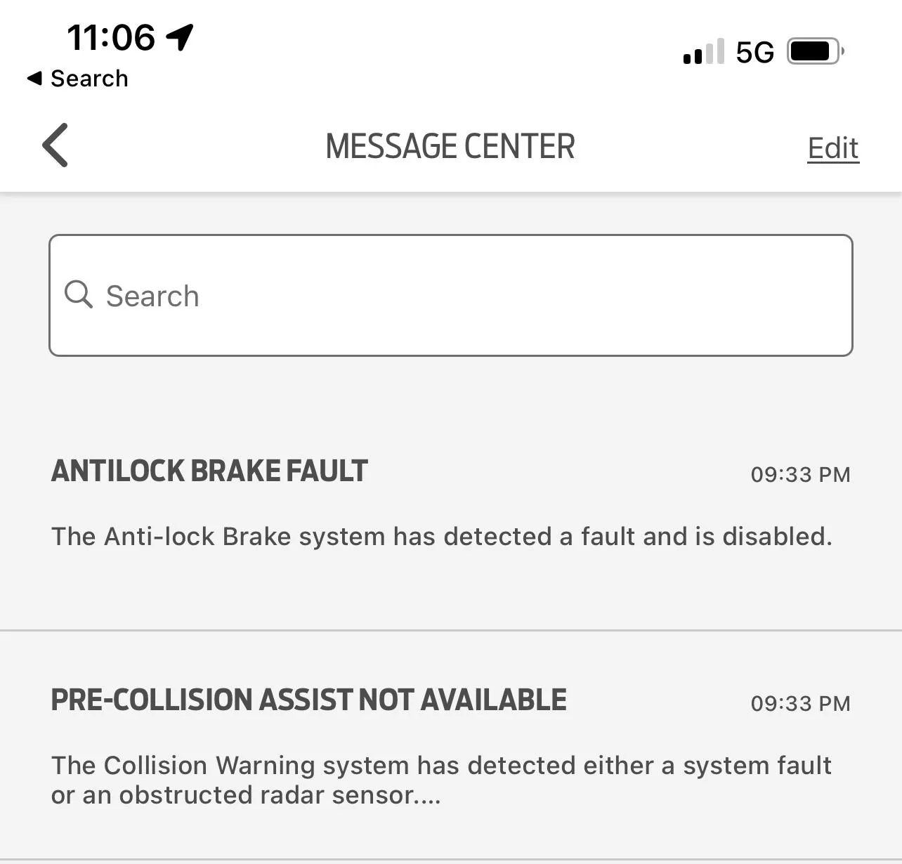

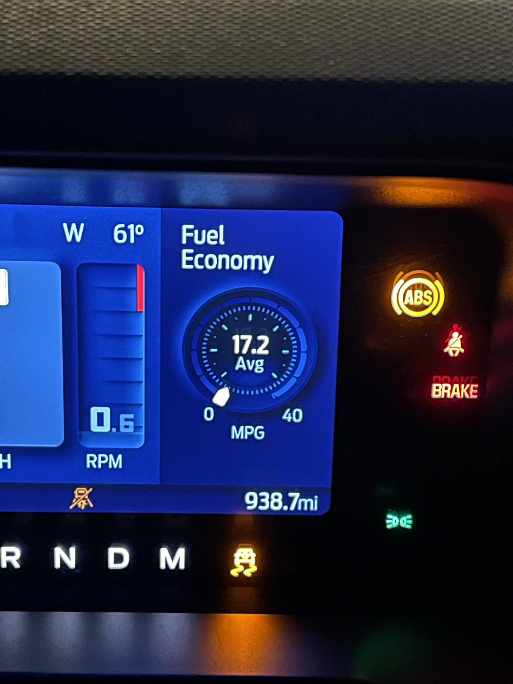

900 miles and I get this???
what have I done to deserve this???
anyone have any insight on this?

1) Take a deep breath
2) open the hood
3) push down on every fuse in the fuse box
4) use a socket wrench tighten the bolts holding the fuse box to the body
5) make your way around the engine compartment with that socket wrench and tighten every ground point
6) disconnect the negative terminal from the battery for a few minute, reconnect and tighten
7) see if the issue goes away after driving for a few miles. if not, take it in, you’ve gone above and beyond already.

Mine comes and goes. Seems to dissappear when jiggling around off road fwiw.

Did you happen to have the doors off and start it? Mine freaks out if the seat belt isn’t buckled and I start it with the doors off.

Happened several times to forum members.
Wheel speed sensor. 80% chance the sensor is good, but the plug isn't seated well or got debris in it.
