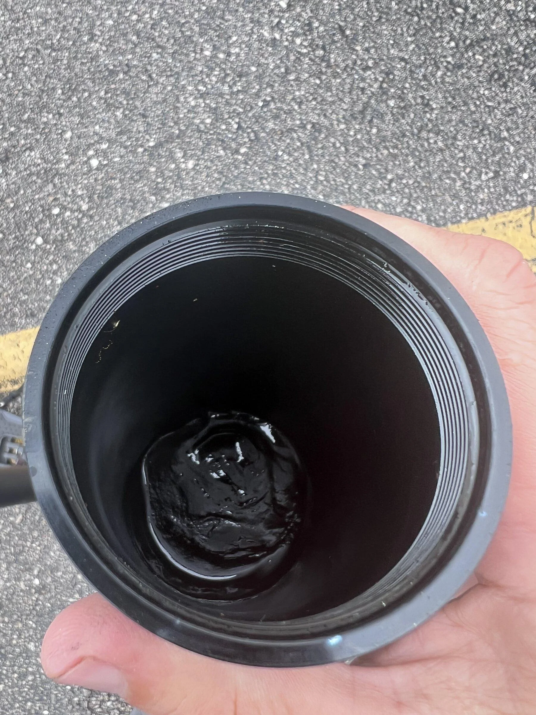

We installed the UPR catch can kit and in my opinion it's definitely worth it. I just removed ours to see how much oil was in it after about 9k miles and it had a bunch of sludge in there. Better to see it captured in the can than to be recirculated through the intake.

Mishimoto ships to CA...you just have to indicate by checking a box on the website that it's for "off-road use" only. Regardless of the opinions on the interwebs, If you actually have a catch can on your Bronco the proof of effectiveness is pretty simple. If oil comes out of it, that is oil that would have gone into the intake. Injection ahead of the valve will dilute the oil and most likely prevent it from forming any deposits on the valves, but that still is a fuel mixture diluted with a hint of oil...a catch can is not intended only to keep your valves clean. Any oil (or other combustion byproducts) in the fuel (even if it's diluted) is still going to potentially have an impact on octane and combustion. If someone installs catch cans and never is able to get any oil out of them, then yes a catch can wasn't necessary or useful...but even on the 2.7 anyone who's ever installed a catch can will get oil out of it. Necessary? Absolutely not...beneficial? If you don't want any oil in your fuel mixture, yes. Adding a catch can on both sides (for not only ideal but also boost) can also reduce oil mist in the intercooler/air box).
