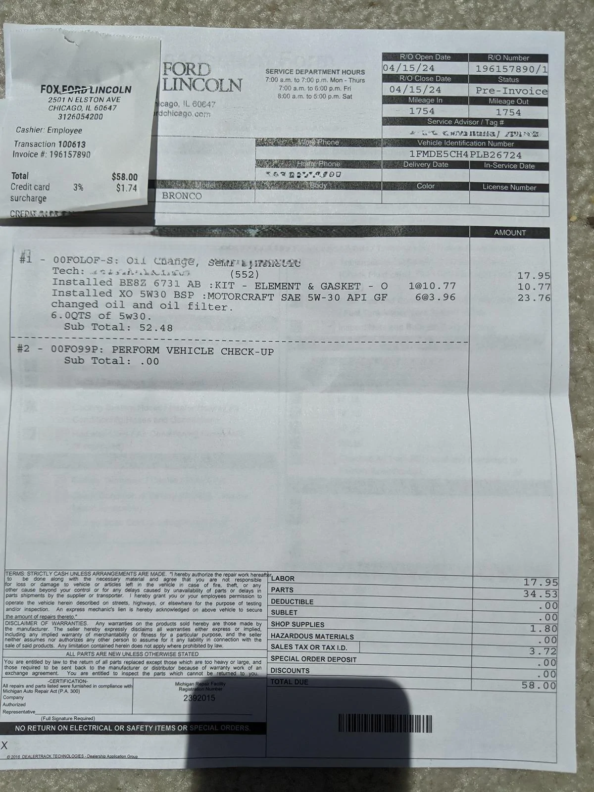

Just a data point - a couple weeks ago, on a Saturday, my "change oil" indicator popped up (I'd been waiting) for my first oil change. Booked at my local dealer through the FordPass app on my phone that day for Monday when they opened at 7 AM. Got there about 7:05 (traffic sucked) so had to wait a bit for an available advisor, hung my "Do Not Wash" placard on the mirror and mentioned same to service tech/advisor, then went to waiting room for coffee and Kindle. Around 8 AM they were done and my truck was ready right outside the door (unwashed, as per request).
No issues then or since and the price, with tax, was $58. I had never even visited this dealer before and only had a couple email convo's back when I was placing my order but they weren't interested in dealing and required me to physically come in (during pandemic) to initiate an order. I passed and ordered from Granger (no regrets there).
Engine bay is clean, nothing dripping under the truck, no issues at all.
BTW I ran the numbers on what they charged me for oil on the receipt ($23.76) and it was less than the per quart price for 5 gallon jugs at Wal-Mart; filter and gasket were $10.77.
It's just one visit but, so far, I'm more than happy with being in and out in less than an hour for $58. Coffee wasn't as good as at my Acura dealer but it was still decent. :)

Was that for full synthetic?
