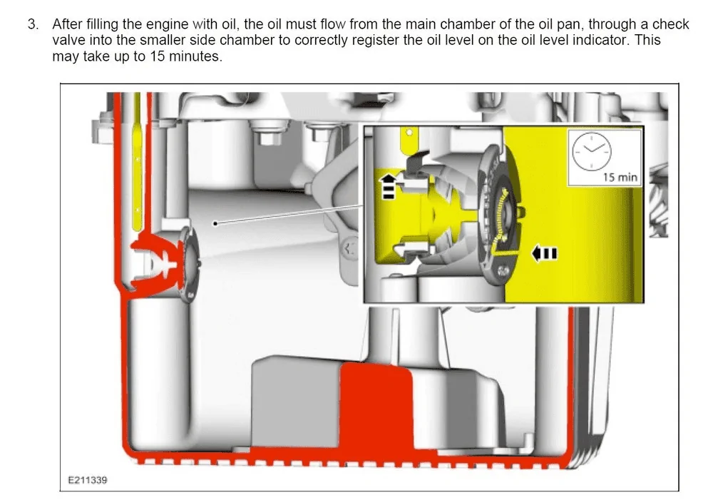

There is a thread in here, i will post the link if I can find it, where I asked the same question. Apparently the 2.7 is engineered in such a way that the dipstick does not directly enter the oil pan. It sits in a tube with a hole in it to the lower portion of the pan, and then drops another inch or two and the extractor cannot get to that chamber. Therefore it looks like you will probably miss like 2 quarts of oil, just guessing. I have an extractor also and thought it would be ideal to never have to get under the 2.7 to do the oil change as the filter is on top. Looks like that approach may not work very well.
Here is that image:
Ford Bronco Oil change via extraction method vs. drain plug 1638452879894

Portapot - Thank you for the information - so looks like extraction is a no-go.
I may still do extraction to get out ~4-5 qts so I won't have the volcano-blast like eruption when the drain plug is removed.

Interesting that they call that a check valve. My guess is that it is just a flow restrictor. If it were in fact a check valve, oil would flow into the dipstick tube, and never go down. You could be driving around with no oil in the pan and it would still read full...
Having said that, a plumbed extraction port would sure be nice on a vehicle with skid plates.
